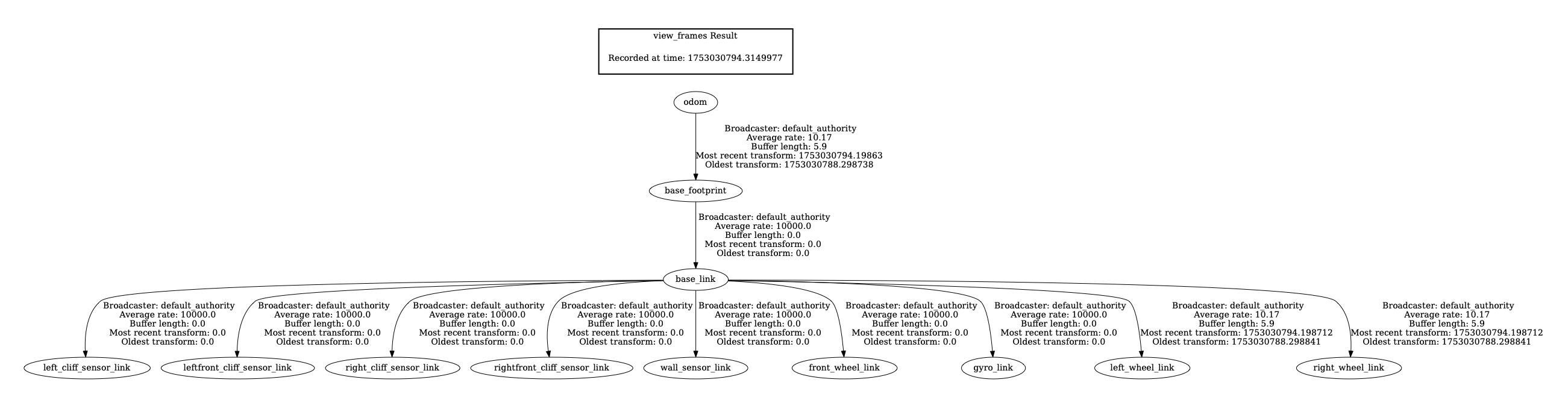

My SLAM system showed classic drift symptoms that pointed to deeper issues:
Laser Scans Moving with Robot: In RViz, the pink laser scan dots moved with the robot instead of remaining fixed in the map frame.
Frame Separation: I noticed three distinct coordinate origins — the robot, odometry frame, and map frame — all offset from each other.
Transform Extrapolation Errors: RViz logs were filled with timing-related errors.
Map Distortion: The map looked okay when stationary but warped during motion.
What confused me most: laser scans drifted during straight-line motion but partially realigned during rotation. Initially, I mistook this for working loop closure. But after deeper analysis, I realized loop closure is not functioning properly yet. The system is trying — but it isn’t successfully closing loops or correcting long-term drift.
I inspected the transform tree:
Key Finding: The transform chain (map → odom → base_footprint → base_link → laser) was structurally correct, but timestamps were often misaligned, causing extrapolation errors.
# Check TF tree structure ros2 run tf2_tools view_frames # Monitor specific frame relationships ros2 run tf2_ros tf2_echo map odom ros2 run tf2_ros tf2_echo base_footprint base_link ros2 run tf2_ros tf2_echo base_link laser
I measured the topic rates and confirmed mismatches between TF publishing and sensor data timestamps.

I improved the startup order and transform publication frequency, which eliminated most extrapolation errors.
# Correct startup order # Terminal 1: Start robot first, wait for full initialization ros2 launch perceptor launch_robot.launch.py enable_camera:=false # Terminal 2: Start SLAM after robot is ready ros2 launch slam_toolbox online_async_launch.py \ params_file:=/home/pi/Roomba/slam_dev_ws/src/perceptor/config/mapper_params_online_async.yaml \ use_sim_time:=false # Terminal 3: Start RViz last ros2 run rviz2 rviz2 -d src/perceptor/config/map.rviz
I had incorrectly set both input and output of twist_mux to /cmd_vel, creating an infinite feedback loop. Separating them fixed the phantom motion issue.

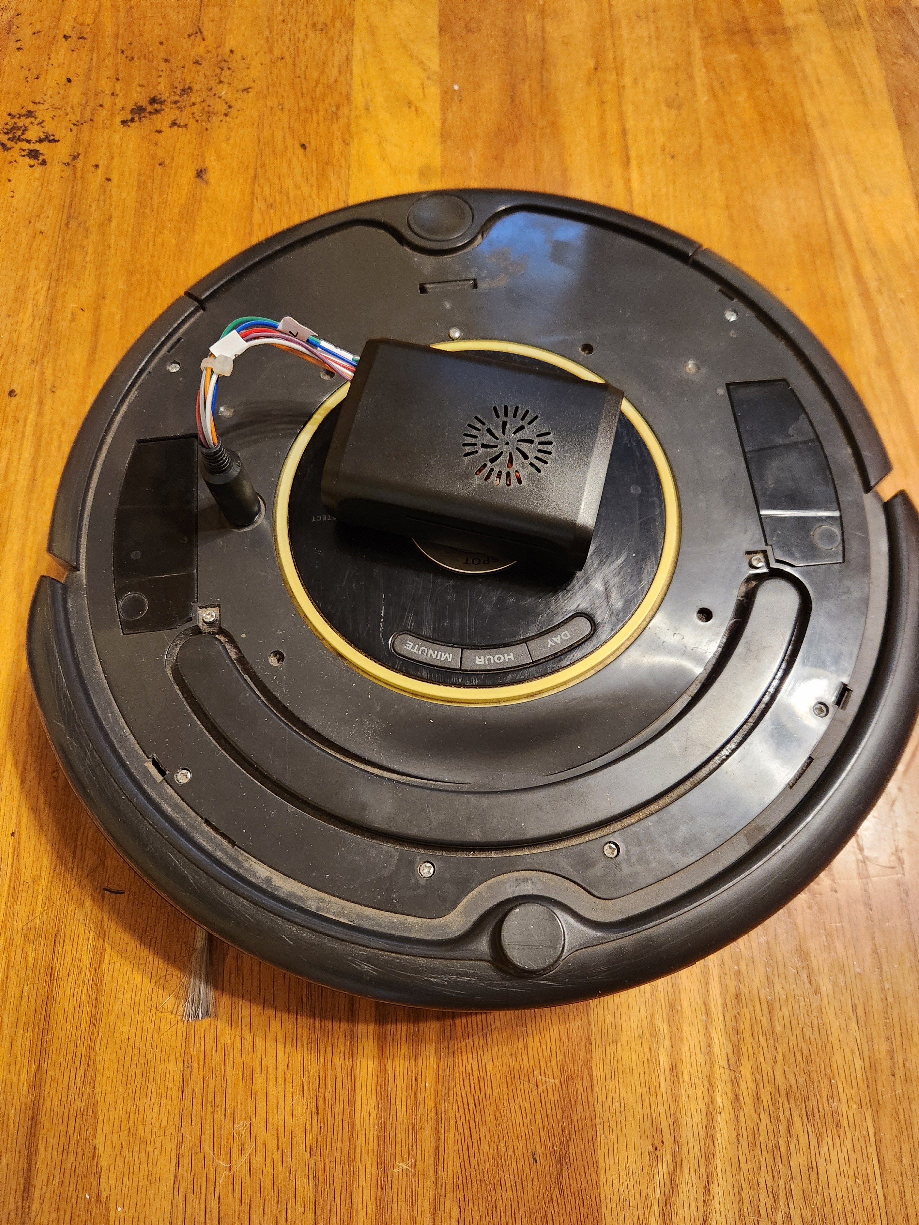

Read more »The journey to transform a Roomba 650 into a fully autonomous SLAM robot continues with some significant hardware and software upgrades. This update covers the migration from Raspberry Pi 3 to Pi 5, the transition to ROS 2 Jazzy, power management challenges, and getting gamepad control working.
The original plan involved using a Raspberry Pi 3 with Ubuntu 22.04 Core and ROS 2 Humble. However, this setup proved problematic due to missing ROS components and the limitations of Ubuntu Core's snap-based package management. While Ubuntu Desktop isn't officially supported on Pi 3 due to its 1GB RAM limitation, the constant troubleshooting was becoming a distraction from the core SLAM development.
Given the project's eventual goals of heavy-duty image processing and AI integration, I decided to future-proof the system by upgrading to a Raspberry Pi 5. This decision came with its own cascade of changes:
The migration to Ubuntu 24.04 and ROS 2 Jazzy on both the Pi and development machine was necessary to ensure compatibility across the entire development pipeline.
The Pi 5's higher power requirements (up to 5A at 5V) created an immediate problem. The Roomba's serial port can only source 200mA before triggering its PTC resettable fuse. This meant the original power-over-serial approach was no longer viable.
The solution involved modifying the custom cable by removing the voltage regulator circuit. Now the Pi 5 runs on external power while maintaining serial communication with the Roomba. When externally powered, the Pi 5 actually sources 5V to the level shifter rather than sinking it.
The current "tethered" approach is temporary. Future plans include:
Until then, the Roomba sports a power "tail" for development work.
Unlike previous Pi models, the Pi 5 doesn't have UART pins enabled by default. This required:
dtparam=uart0 to /boot/firmware/config.txtThese changes ensure the GPIO pins 14 (TX) and 15 (RX) function properly for serial communication.

The project began with a deep dive into the iRobot Create Open Interface (OI) specification to understand the Roomba’s serial communication requirements. From there, the Roomba's 7-pin mini-DIN port was mapped to identify the relevant pins for TX, RX, and power.
It became clear that the Roomba's serial interface operated at 5V logic, while the Raspberry Pi's UART is 3.3V tolerant. To bridge this, I built a custom cable incorporating a level shifter. A DC-DC voltage regulator was also added to power the Raspberry Pi directly from the Roomba's onboard battery.
The initial attempt to communicate between the Pi and Roomba was unsuccessful. To debug, I replaced Roomba with an Arduino Uno, attempting a loopback test through the Arduino itself, but that too failed. I then created a local loopback on the Pi (jump TX to RX), which succeeded and reassured me that the Pi GPIOs were not fried. Returning to the Pi, the correct serial port abstraction was identified—/dev/ttyAMA0 or /dev/serial0—which had been part of the earlier confusion.
This progress made it worthwhile to improve the hardware connections, so a custom header was fabricated for the Raspberry Pi’s 40-pin connector to secure the wiring and facilitate swapping Pis without rewiring. With renewed confidence, I returned to the Pi to successfully establish communication with the Roomba.
With the hardware connection sorted, the next step was to develop basic Python scripts to:
Start the Roomba’s OI
Drive forward, reverse, and rotate
Query sensor data including bump sensors, battery status, and distance traveled
This formed the first real confirmation that the Roomba was responding properly to commands issued from the Raspberry Pi.
Next, I turned to the create_robot ROS 2 package from AutonomyLab. After cloning and building the package on the Raspberry Pi, the create_driver was launched:
ros2 launch create_bringup create_driver.launch.py serial:=/dev/serial0 baud:=115200
Once running, several topics became available:
/odom for odometry
/cmd_vel for velocity commands
/battery/voltage
/bumper
/wheel_drop
/cliff
/light_bumper
/ir_opcode
/dock
/buttons
To control the robot, I started with teleop_twist_keyboard, a ROS 2 package that allows controlling via a keyboard. While exploring options for more intuitive control, I discovered two existing controllers at home: a Flysky RC transmitter used for drones and a Nintendo Switch controller. The latter was stolen from my son's stash and the former is something that both of use when we go out for flying drones and foamies.
