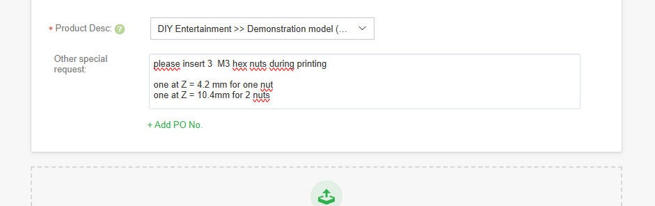

    I decided to try the 3D printing service @PCBway.
    Ordering was quite simple as I chose standard PETG filament and came very soon to the Request For Quotation button!
    However, for the bottom part of the enclosure I wanted to insert 3x M3 hex nuts during the printing time.
    This should be done just before "closing" the top of the hex nut foot print with a "fake" color change at these Z height:
    3 nuts should be inserted.
    One at Z = 4.2 mm for one nut
    one at Z = 10.4mm for 2 nuts
    A sentence was added for this into the "other special request" at the bottom of the form
    This of course was not a standard order and almost immediately I received a mail to ask for explainations.
    This was on a friday evening... and all the mail discussions and further audit of my request were handled during the week end and even during night hours in China.
    Later I got the explaination : "In order to provide faster services for customers, we have some staff scheduled on weekends, and some operate on a three-shift system"
    This quality of service is simply impressive, my enclosure could jump into production on monday morning after payment!
    And here is the result : perfect !
