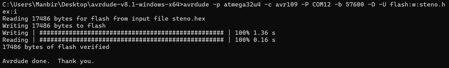

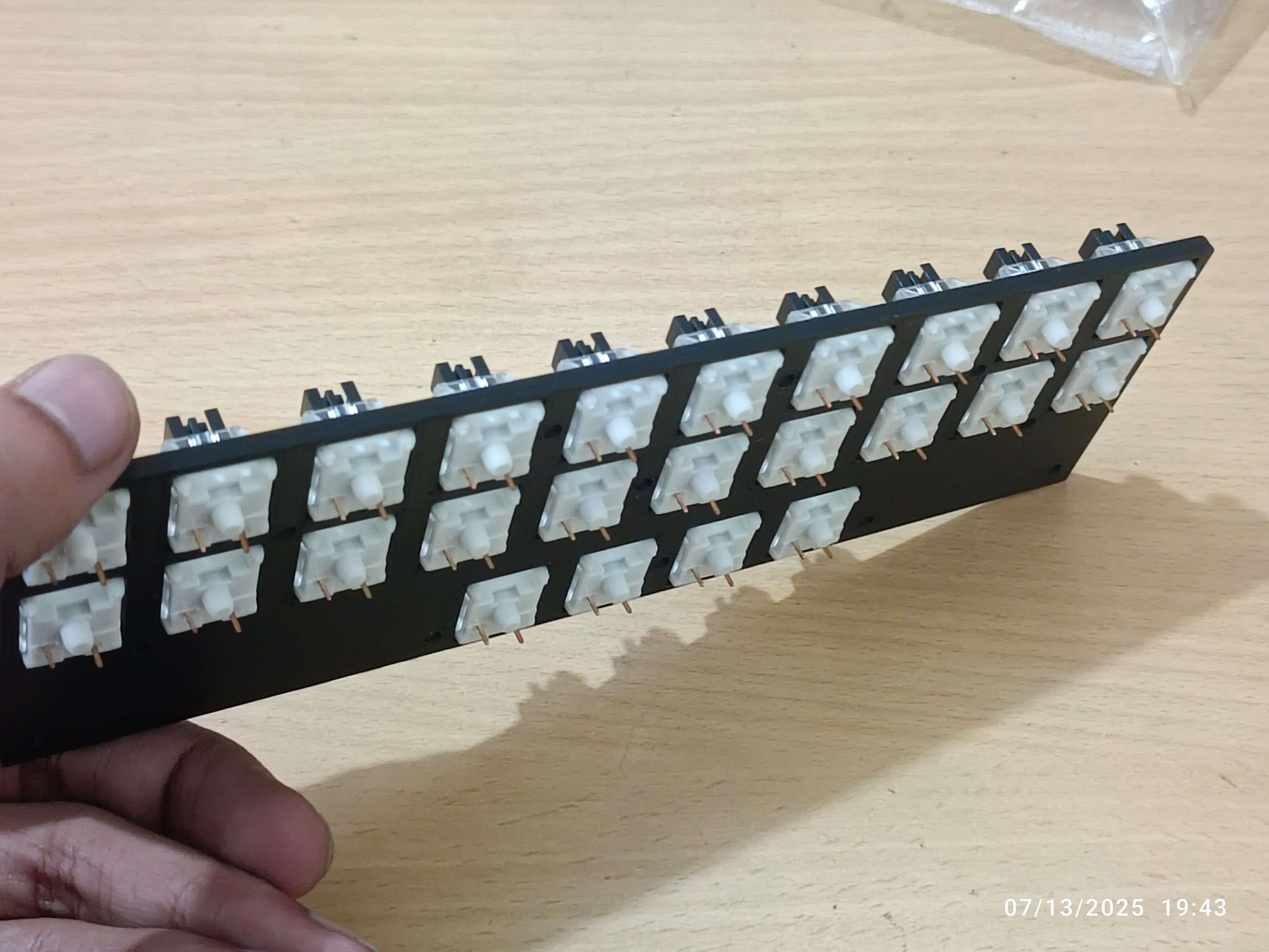

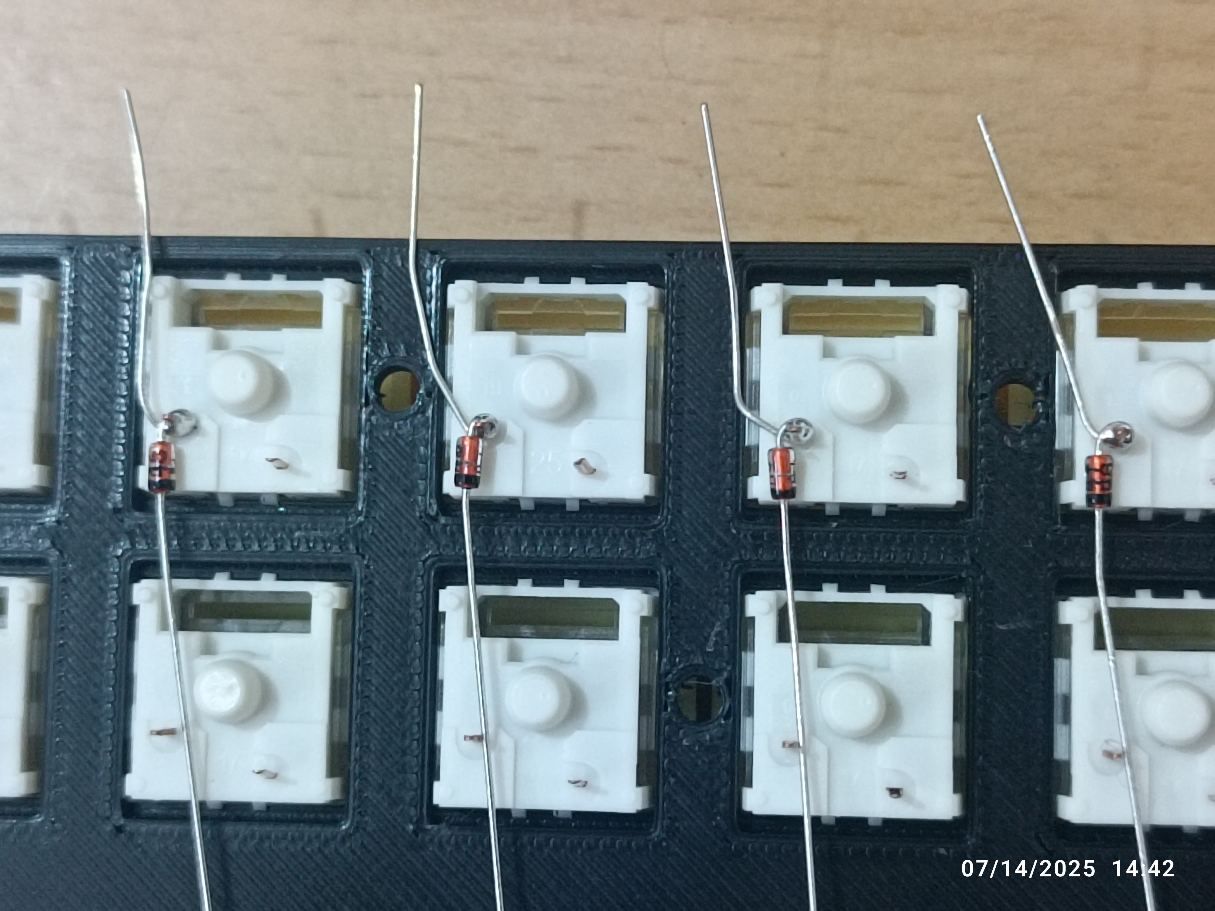

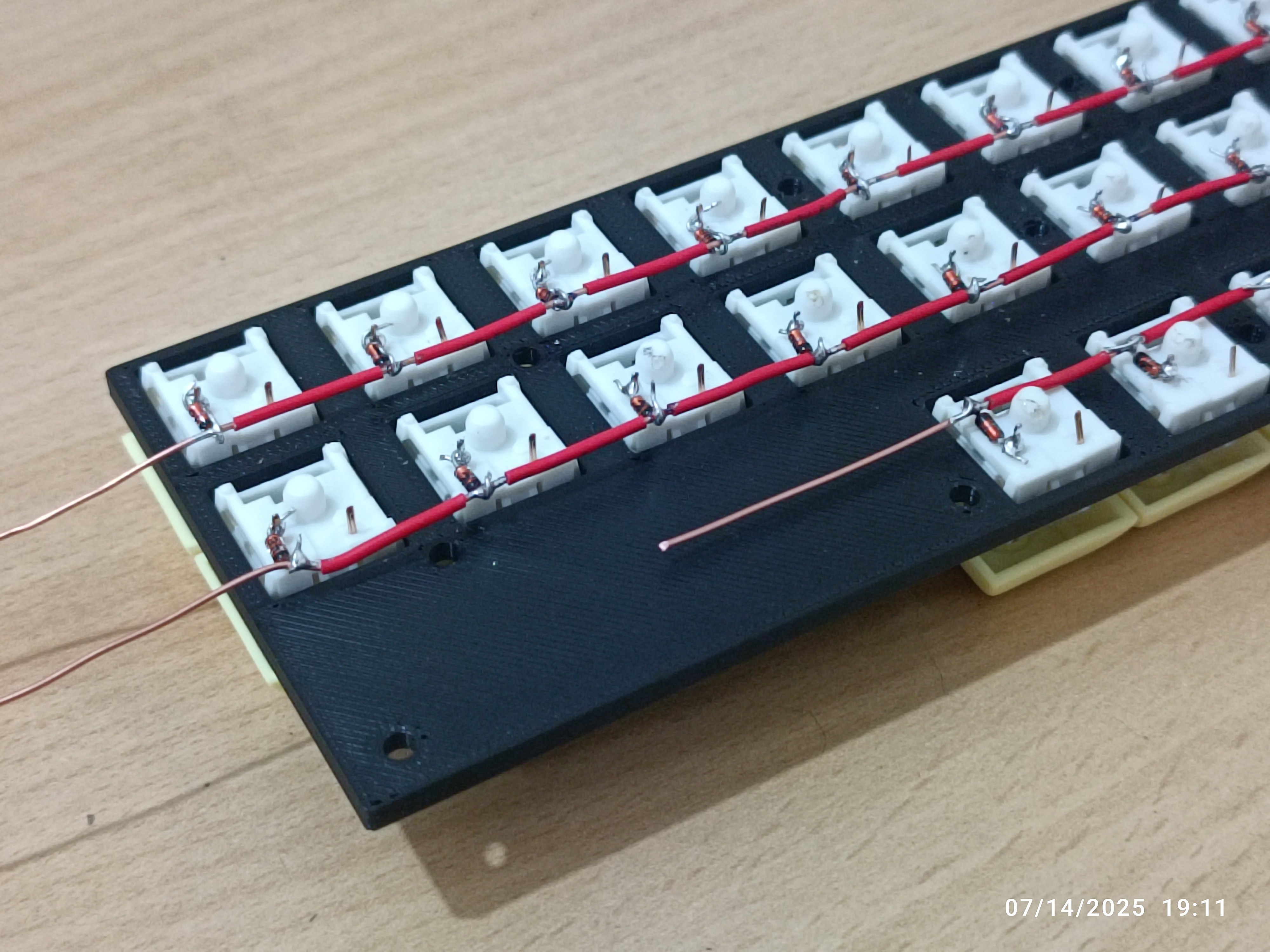

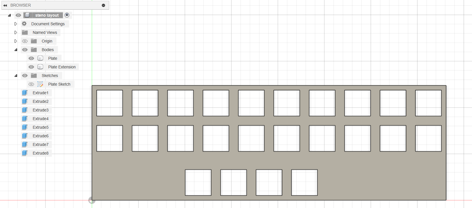

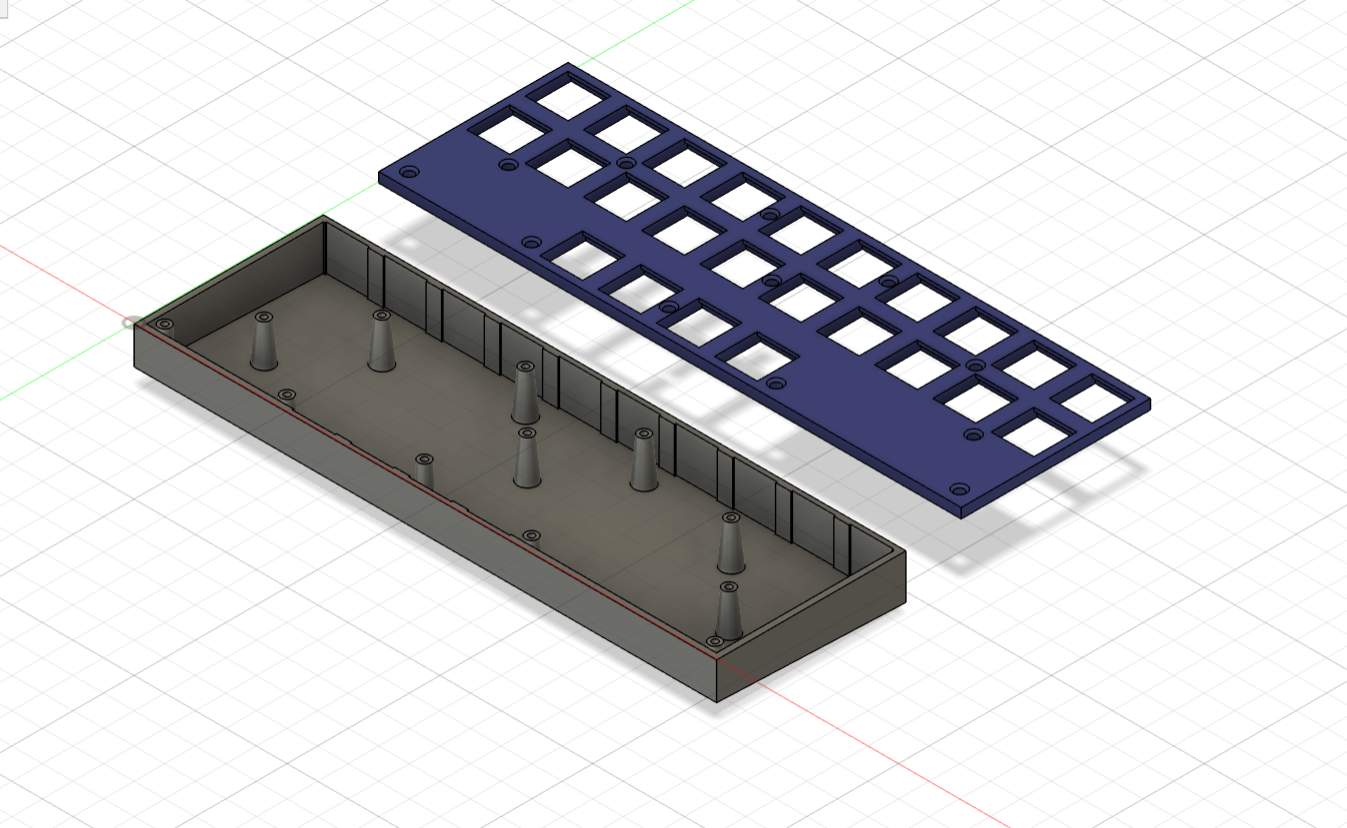

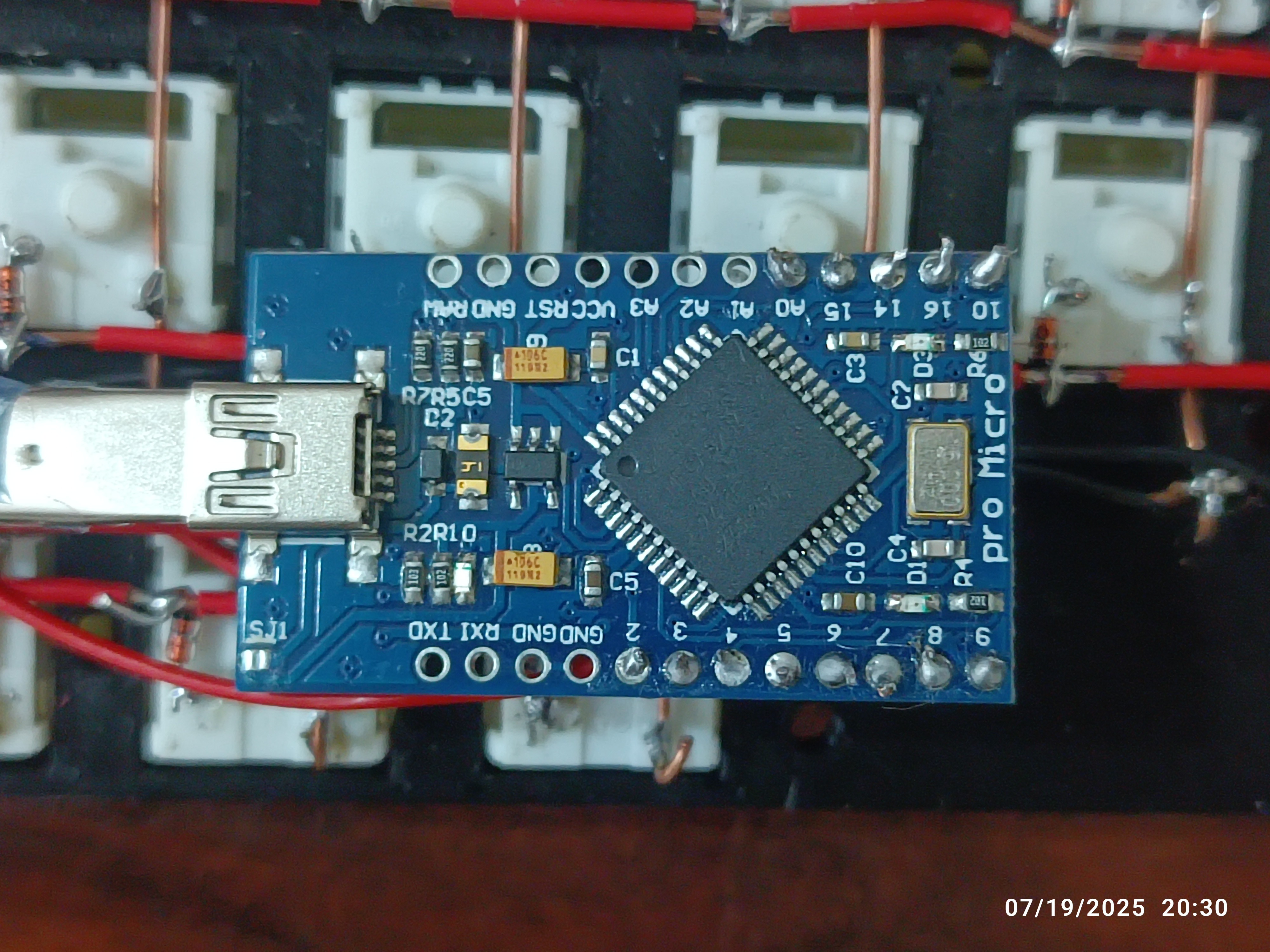

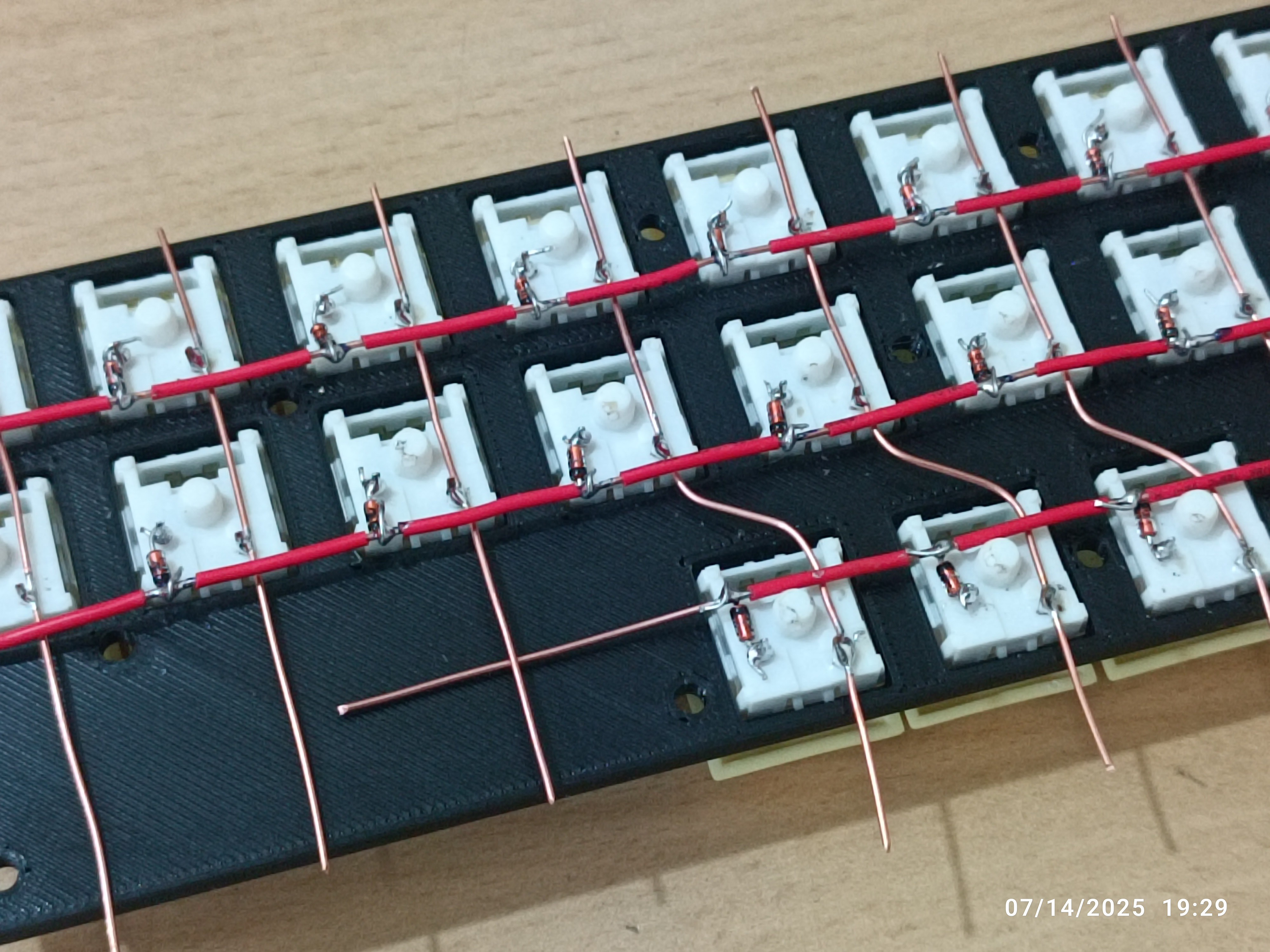

• generating firmware
    manbir07/22/2025 at 15:03 0 comments
    download and setup qmk.
    create a new keyboard:
    creating a new keyboard using qmk
    create a new keymap:
    generating a keymap for your keyboard
    customize the keymap to fit your keyboard and its wiring. my files are attached below.
    keyboard.json
      "manufacturer": "Manbir Singh",
      "keyboard_name": "stenokeyboard",
      "maintainer": "0-manbir",
      "development_board": "promicro",
      "diode_direction": "COL2ROW",
      "features": {
        "bootmagic": true,
        "extrakey": false,
        "mousekey": false,
        "nkro": false
      "matrix_pins": {
        "cols": ["F7", "B1", "B3", "B2", "B6", "B5", "B4", "E6", "D7", "C6"],
        "rows": ["D1", "D0", "D4"]
      "url": "",
      "usb": {
        "device_version": "1.0.0",
        "pid": "0x0000",
        "vid": "0xFEED"
      "layouts": {
        "LAYOUT": {
          "layout": [
            { "matrix": [0, 0], "x": 0, "y": 0 },
            { "matrix": [0, 1], "x": 1, "y": 0 },
            { "matrix": [0, 2], "x": 2, "y": 0 },
            { "matrix": [0, 3], "x": 3, "y": 0 },
            { "matrix": [0, 4], "x": 4, "y": 0 },
            { "matrix": [0, 5], "x": 5, "y": 0 },
            { "matrix": [0, 6], "x": 6, "y": 0 },
            { "matrix": [0, 7], "x": 7, "y": 0 },
            { "matrix": [0, 8], "x": 8, "y": 0 },
            { "matrix": [0, 9], "x": 9, "y": 0 },
            { "matrix": [1, 0], "x": 0, "y": 1 },
            { "matrix": [1, 1], "x": 1, "y": 1 },
            { "matrix": [1, 2], "x": 2, "y": 1 },
            { "matrix": [1, 3], "x": 3, "y": 1 },
            { "matrix": [1, 4], "x": 4, "y": 1 },
            { "matrix": [1, 5], "x": 5, "y": 1 },
            { "matrix": [1, 6], "x": 6, "y": 1 },
            { "matrix": [1, 7], "x": 7, "y": 1 },
            { "matrix": [1, 8], "x": 8, "y": 1 },
            { "matrix": [1, 9], "x": 9, "y": 1 },
            { "matrix": [2, 3], "x": 3, "y": 2 },
            { "matrix": [2, 4], "x": 4, "y": 2 },
            { "matrix": [2, 5], "x": 5, "y": 2 },
            { "matrix": [2, 6], "x": 6, "y": 2 }
    rules.mk
    # Base
    MCU = atmega32u4
    BOOTLOADER = caterina
    # Enable Steno
    STENO_ENABLE = yes
    STENO_PROTOCOL = geminipr
    EXTRAKEY_ENABLE = no
    MOUSEKEY_ENABLE = no
    CONSOLE_ENABLE = no
    COMMAND_ENABLE = no
    NKRO_ENABLE = no
    UNICODE_ENABLE = no
    BACKLIGHT_ENABLE = no
    AUDIO_ENABLE = no
    keymap.c
    // Copyright 2023 QMK
    // SPDX-License-Identifier: GPL-2.0-or-later
    #include QMK_KEYBOARD_H
    #include "process_steno.h"
    const uint16_t PROGMEM keymaps[][MATRIX_ROWS][MATRIX_COLS] = {
        [0] = LAYOUT(
            STN_S1, STN_TL, STN_PL, STN_HL, STN_ST1, STN_FR, STN_PR, STN_LR, STN_TR, STN_DR,
            STN_S2, STN_KL, STN_WL, STN_RL, STN_ST2, STN_RR, STN_BR, STN_GR, STN_SR, STN_ZR,
            STN_A, STN_O, STN_E, STN_U
    compile the firmware
    flash the firmware using AVRdude or QMK Toolbox
    download and install Plover. set the machine to Gemini PR.
    go to configure, and select the right port.
  • wiring the switches
    manbir07/22/2025 at 14:50 0 comments
    putting in the switches
    soldering diodes to one leg of each switch
    wiring rows using a 16-gauge copper wire
    wiring columns
    connecting each column (10) and row (3) to the dev board
  • building a case
    manbir07/22/2025 at 14:37 0 comments
    software needed
    • autodesk fusion 360
    building the plate
    open any 3d modeling/cad/cam software. i used fusion 360. load the .dfx file (find sample in the files section). extrude to form a plate.
    building a case
    build a case to hold the plate.
  • planning the layout
    manbir07/22/2025 at 14:26 0 comments
    software needed:
    designing the layout
    i designed the layout for my steno keyboard using Keyboard Layout Editor.
    steno keyboard layout
    raw data (or click here):
    ["S","T","P","H","*","F","P","L","T","D"],
    ["S","K","W","R","*","R","B","G","S","Z"],
    [{y:0.25,x:2.5},"A","O","E","U"]
    generating the plate
    copy the raw JSON data from KLE and paste it into 'plate layout' in swillkb. export as a .dxf file.
    swillkb keyboard plate properties
