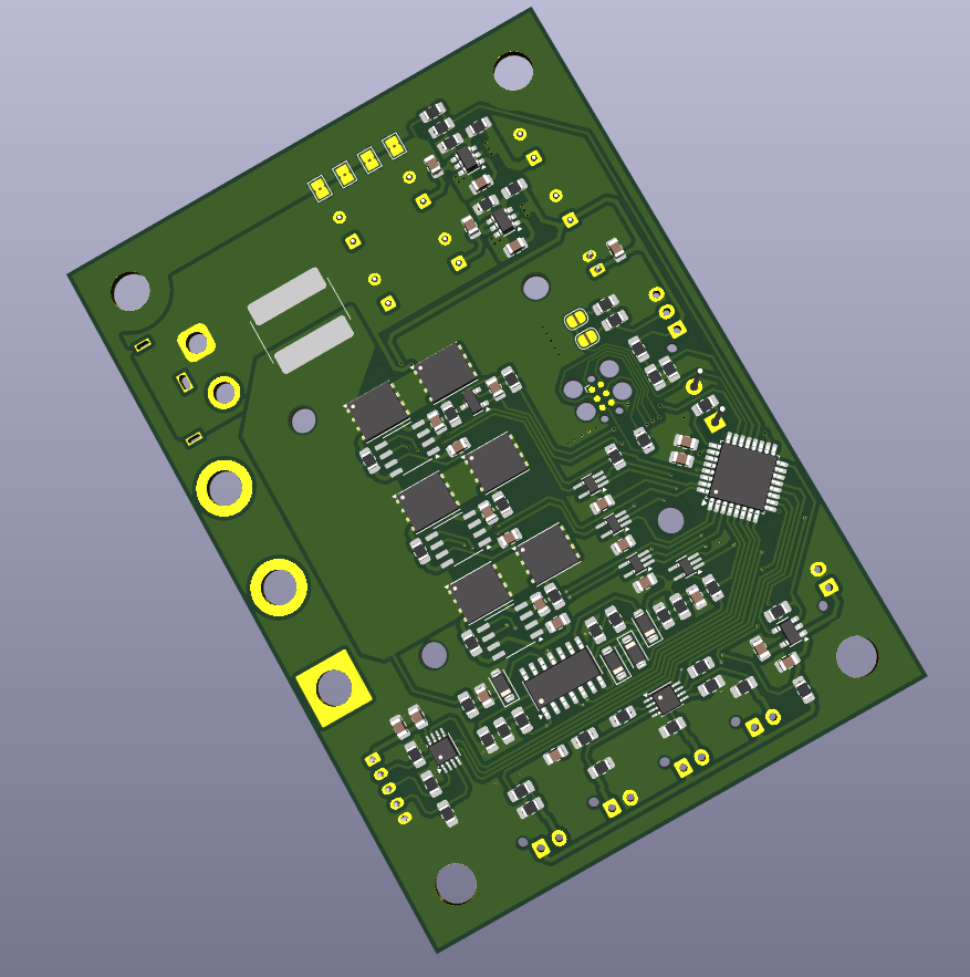

    I stil was quite unsatisfied due to the little wasted space left. Also i noticed going to a 4-layer pcb while getting smaller is also not much more expensive.
    So i redesigned it with the premise to use a 4-layer pcb and went down to a nice credit-card format
    85x55mm BABY!
    And the fun part ...... somehow i still managed to stay on a 2-layer pcb XD
    Ok but no more redesignes now ..... time to order

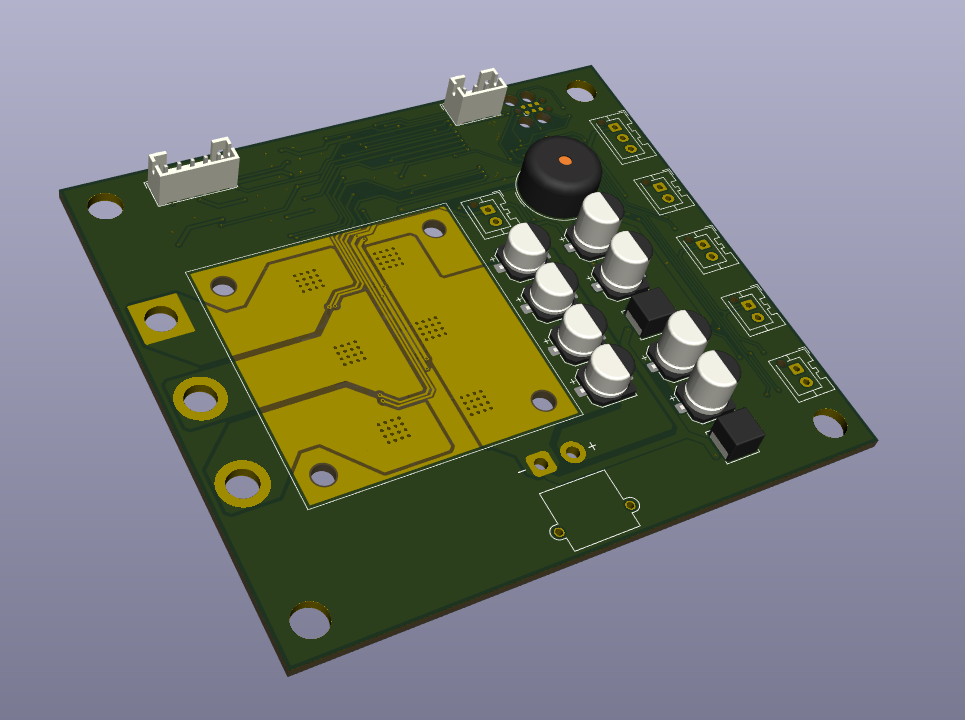

  • Redesign
    Phil Weasel • 08/04/2025 at 07:34 • 0 comments
    I changed up some things and managed to get it smaller
    Everything is now in a neat 95 x 67mm form. Plan still is to have the heatsink + optional fan on the top side, along with "large" components + conectors. Since i will have an enclosure as well, all SMD components will be on the bottom side :

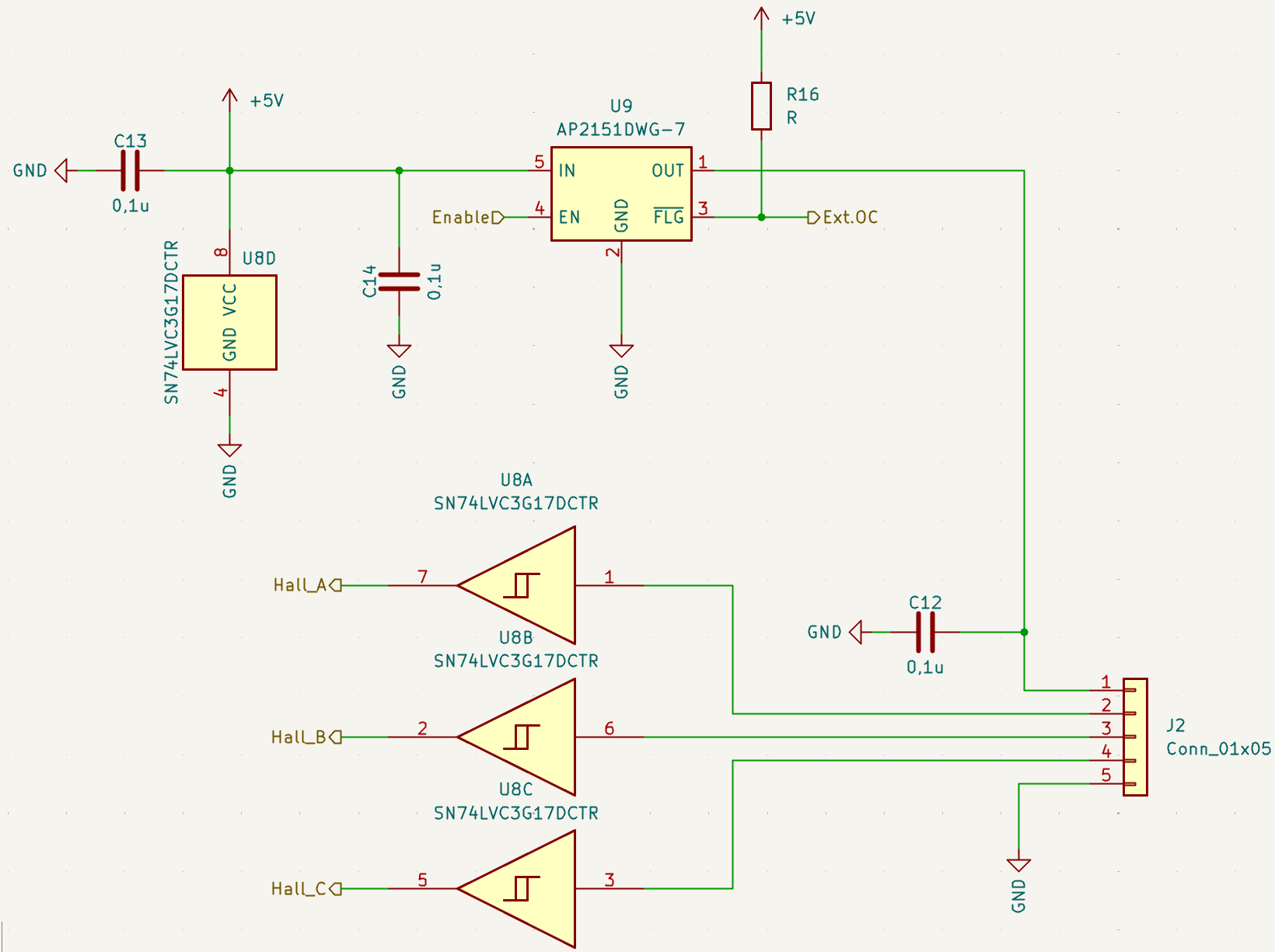

  • External sensor input
    Phil Weasel • 07/23/2025 at 15:27 • 0 comments
    Another important part. The connection to the sensors.
    I opted to buffer the input with a triple-schmitttrigger just to make sure....
    The 5V output must be protected against a shot circuit at all cost. Problems on the 5V line can break the rest of the logic and/or shutdown the controller.
    For this i use a powerswitch from USB-devices.
    U9 turns off when 500mA is exceeded and also can be dis/enabled by the controller.
    Convenient

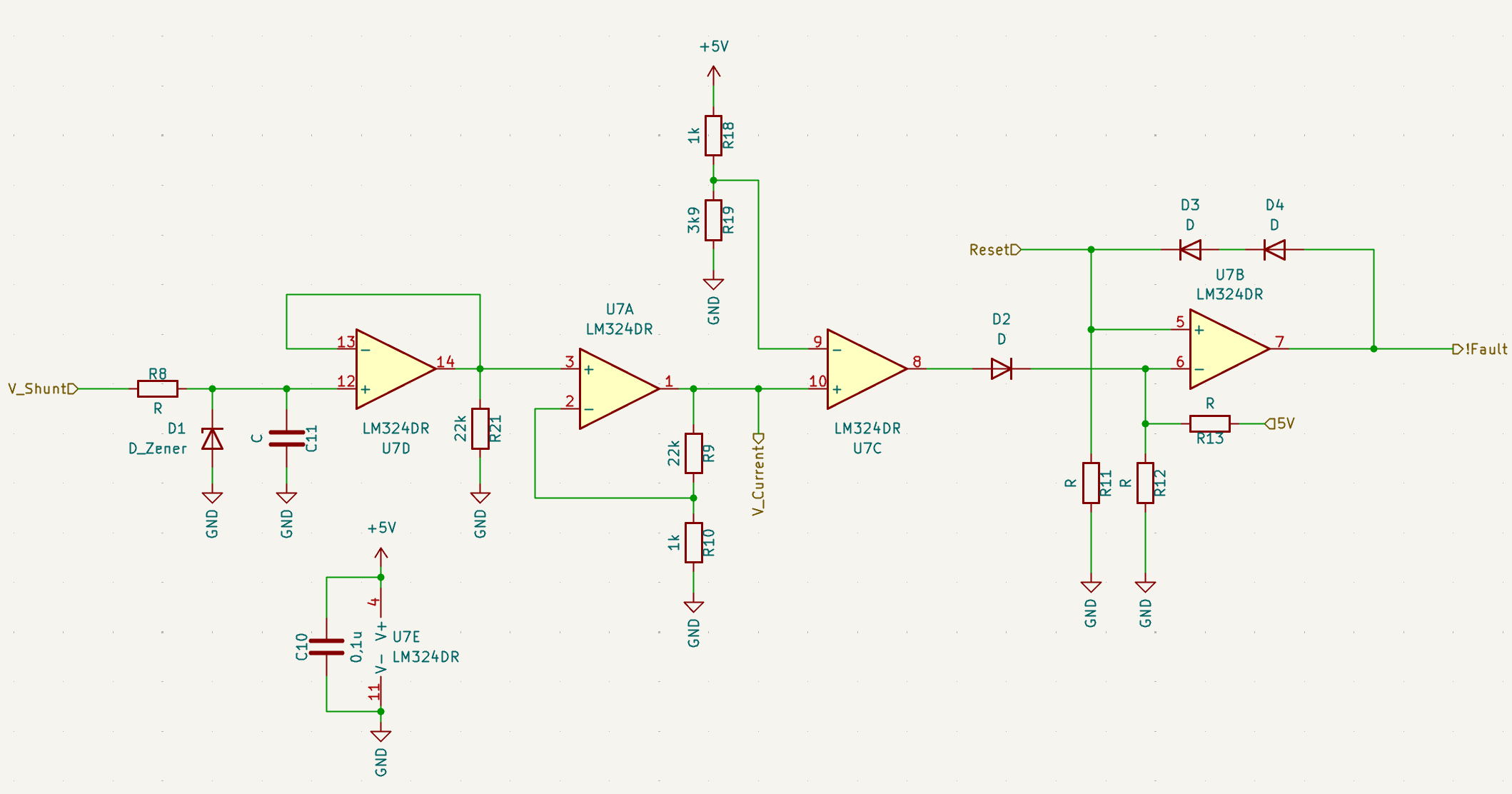

  • Overcurrent and shutdown
    Phil Weasel • 07/23/2025 at 15:16 • 0 comments
    So for this i use a quad opamp -> LM324DR
    Because i have a bunch of them from the 1Hz challenge project.
    From left to right:
    • A zener diode for safety, and a RC-filter. This is useful to filter fast spikes or allow short OC´s .... lets keep the values open for now and see at the first prototype.
      Also i decouple the input.
    • The amplifier. I want to get to a trigger voltage of ~4V
      The shunt (which is the weakest link in the chain) is 3W max -> ~17A = 170mV
      4V/170mV -> A=23
      Using 22k and 1k from the E24 line we get exactly 23 ... convenient
    • Shutdown trigger. The moment the voltage from the amp is above V-, it triggers.
      Unfortunately, getting the reference voltage precicely is not (cheaply) possible. i opted for the 3,98V ... close enough.
      So the shutdown threshold is a bit below 17A ... ok
    • The flipflop .... so you can use a opamp as a RS flipflop ... nice
      When the shutdown is high, the flipflop will output a LOW signal ... so a active low fault .....
      This can be reset by a high-flank on the reset input ....
    This feeds into the Shutdown lane which is just a bunch of AND-gates.
    First gate outputs high when the enable and fault is high. The other 3 gates forward the highside signals, but only if the first one is also HIGH.
    Fault active or Enable LOW = no signals to the driver = no switching of the high side fet´s = no output power.

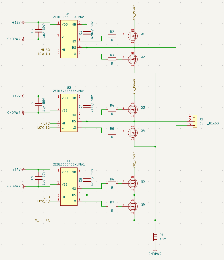

  • Output stage
    Phil Weasel • 07/23/2025 at 14:45 • 0 comments
    As the main switches i opted for an BSC110N06NS3GATMA1 from infineon
    60V VDS max, 30A seems promising enough. Also my plan is to cool if on the bottom side of the PCB and those things have a massive drain-pad. 10mOhm and 50W loss max should be enough to play with. We will see.
    Qg ~ 80nC, ton ~60ns
    -> Idrv ~ (80/60)x2 = 2A
    -> Rg = 6Ohm @12V
    Note: you can always change the gate resistance if necessary
    Also from infineon the driver: 2EDL8033F5BXUMA1
    This one can deliver 3A, so it should be OK with the max 2A.
    Boot capacitance is said to be 10x input capacitance
    -> Cboot = 10x1,5nF = 15nF
    -> Opted for 470nF for easier supply
    Current shunt is a 10mOhm/3W type
    Simply because i somehow have a reel of those things .....
    15A max -> 2,24W max .... yeah should be ok. 15A is an absolute max anyway ... will be more around 10A so it´ll be fine

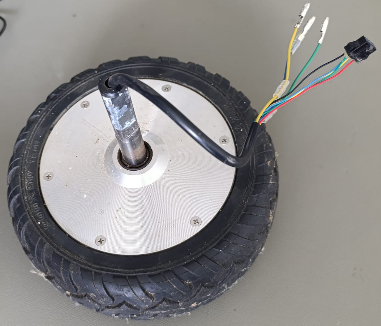

    Before i can do anything, lets find out what we are dealing with.
    These (propably chinese) hubmotors dont have any useful marking that would let us find a datasheet or anything so we need to make some assumptions.
    The one i got has a 36V battery. Appearently these things run around 200-400W (thanks google).
    So lets take 400W max. = 11A + reserve = 15A
    The connector is a 5pin with red/black and 3 colors. Im about 80% certain it is 3 hall-sensors. I always assumed these things needed a more precise position sensor..... Appearently this is accurate enough for the usecase.
    So lets summarize, our controller will have:
    Vmax: 36-38V
    Imax: 15A
    5V external for sensors
