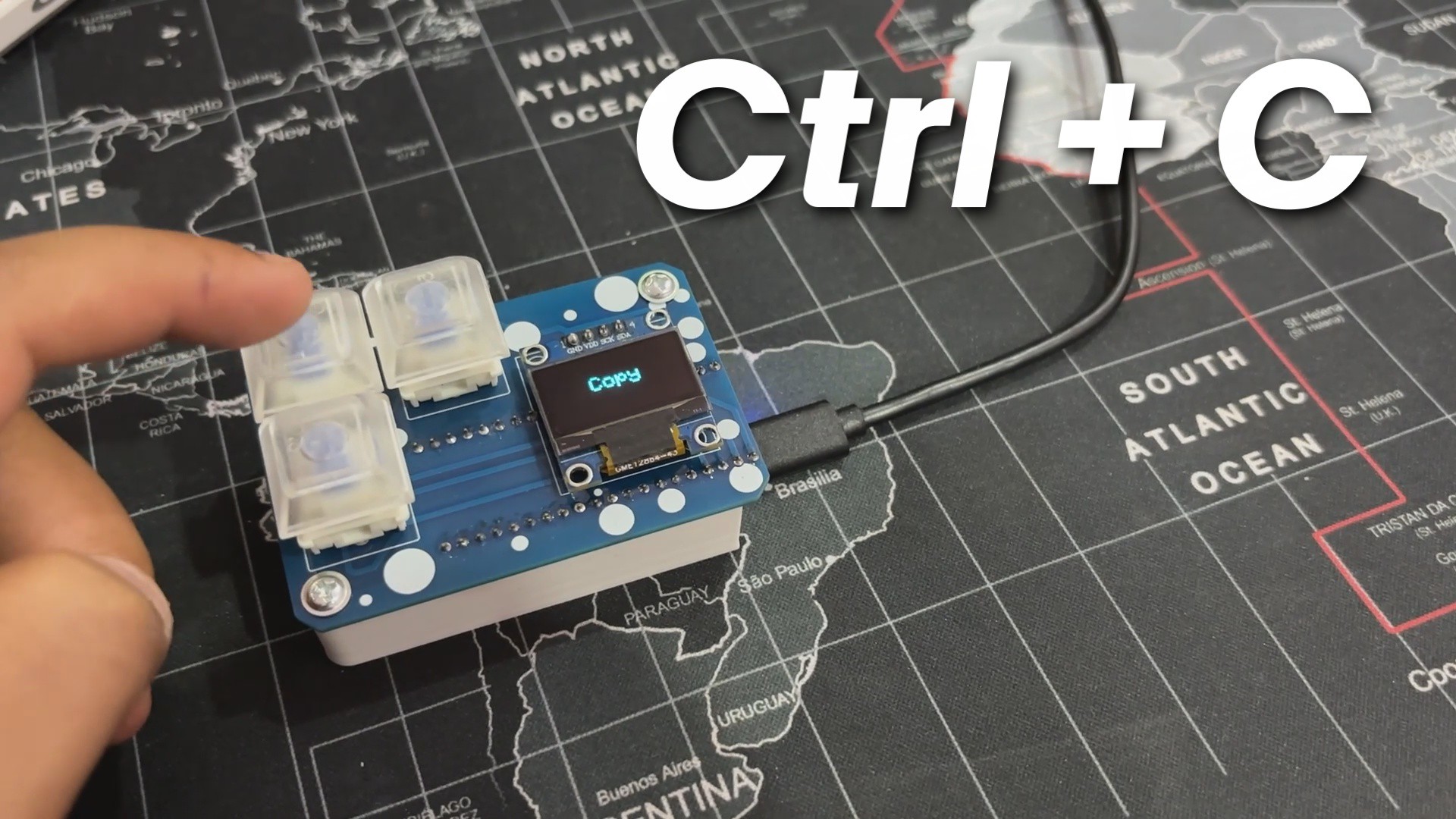

Next, from the top side of the PCB, we place the SSD1306 OLED, followed by the three mechanical switches.
We solder the switch and OLED pins from the bottom of the PCB.

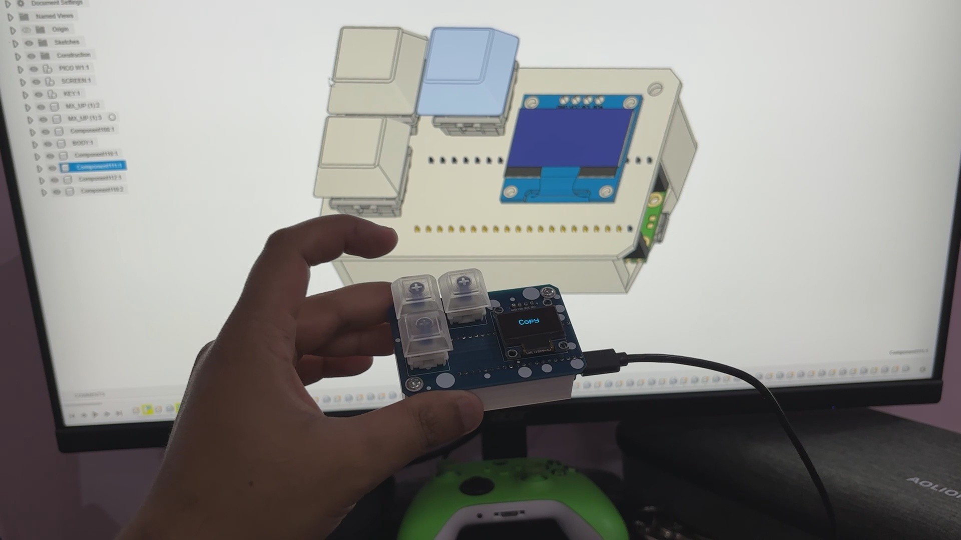

This tiny yet practical build culminated in a macropad capable of performing copy, paste, and delete commands. When you push the copy button, the OLED screen will confirm your action. The paste button allows for seamless pasting, while the delete button provides instant removal functionality. Simple, efficient, and designed for simplified input.
Using this Macropad, I was able to use my preferred design software, Fusion 360, without having to press the Control plus C button; instead, I simply pressed one button to copy and another to paste, and things became slightly easier.
Overall, this project is completed and requires no revisions.
