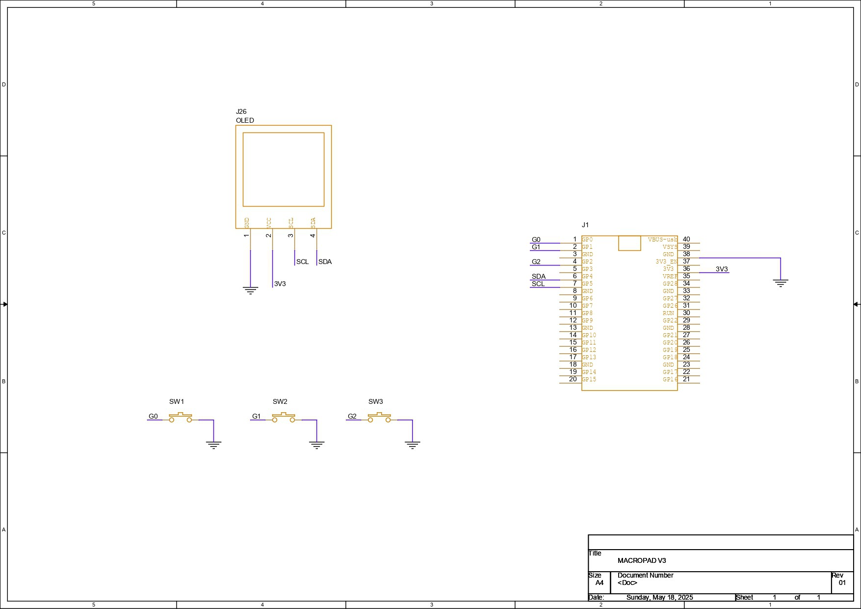

For the schematic of this project, we initially created a small setup consisting of a Raspberry Pi Pico, an SSD1306 OLED screen, and three mechanical switches. We connected the OLED's VCC to the PICO's VBUS pin, GND to GND, the SDA pin to GPIO4, and the SCL pin to GPIO 5. All three switches are connected to GPIO0, GPIO1, and GPIO2.

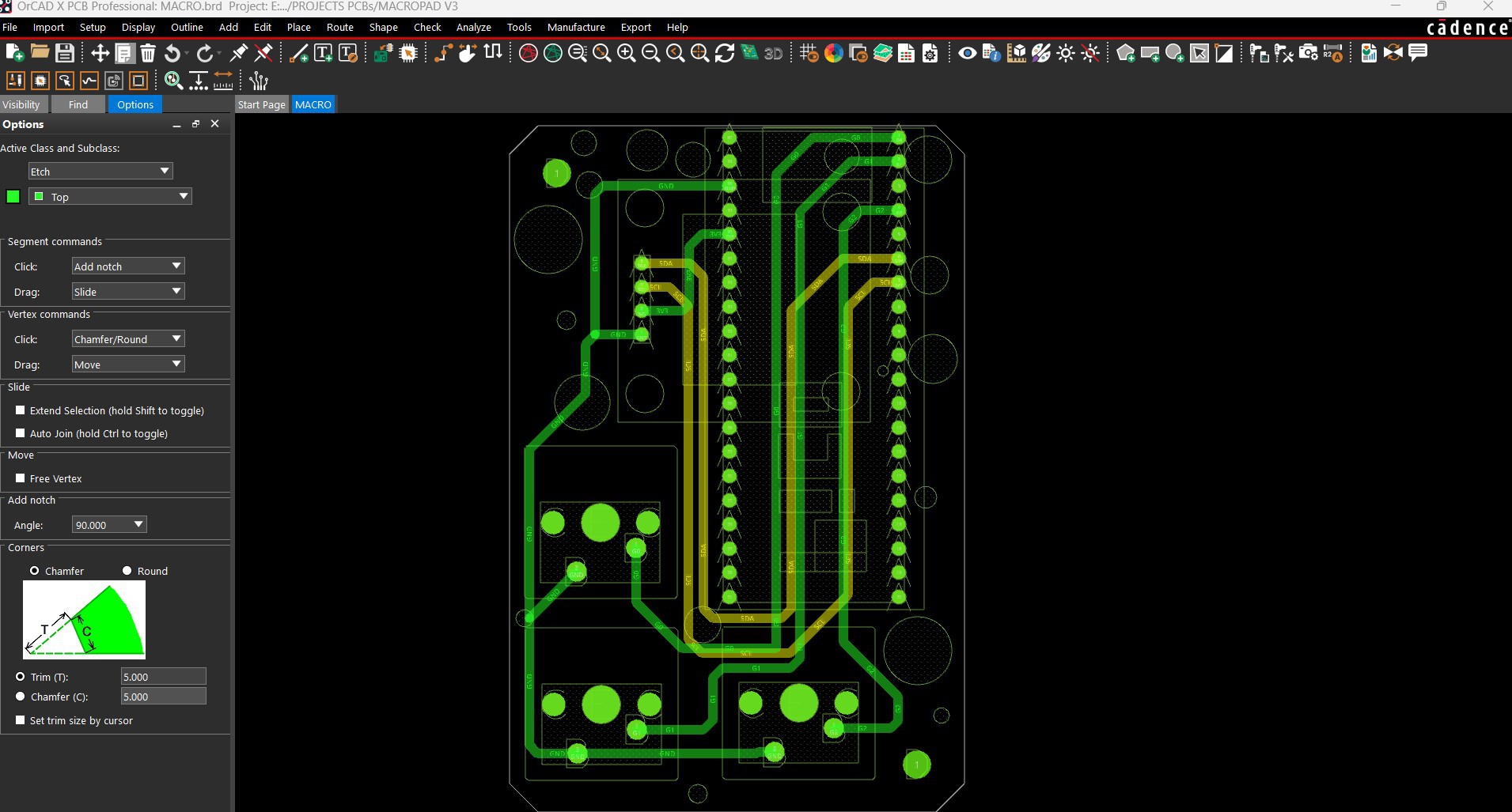

Using the dimensions from the cad file, we created the PCB layout and the board outline and placed components in their proper locations. PICO 2 is located at the bottom of the board.
NextPCB PCB Service
Gerber Data was sent to HQ NextPCB, and an order was place for Blue Soldermask and white silkscreen.
After placing the order, the PCBs were received within a week, and the PCB quality was pretty great.
