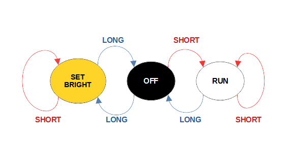

The device provides one button to turn the device on/off and to adjust the brightness. Refer to the state diagram below.

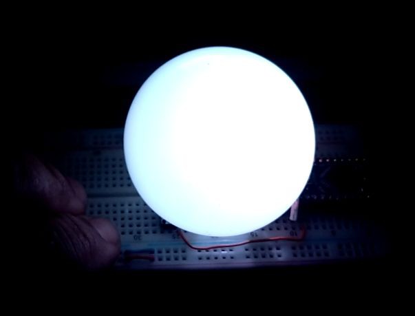

When in OFF state, a short press will start the timing and the device will flash once per second.
When the device is counting time, a long press will turn it OFF and a short press will skip to the beginning of the next interval.

From OFF state, a long press will enter the brightness adjust mode. In this mode, a short press will cycle through 5 different levels. A long press will return the device to OFF state.

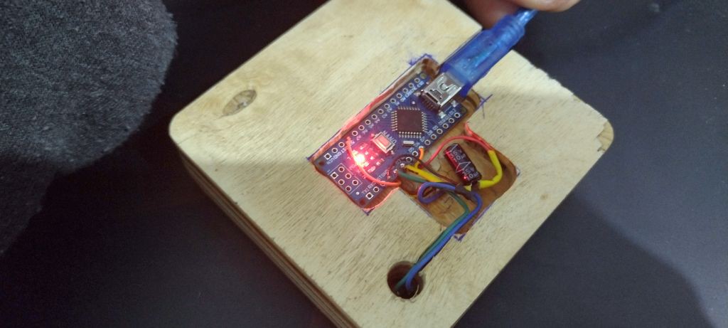

    danjovic08/10/2025 at 02:50 0 comments
    The circuit was assembled on the plywood case and tested. The bottom will receive a felt sheet to protect the circuit and soften the contact with the surface of the table where I will leave the pomodoro timer. I will do it later because my glue gun broke.

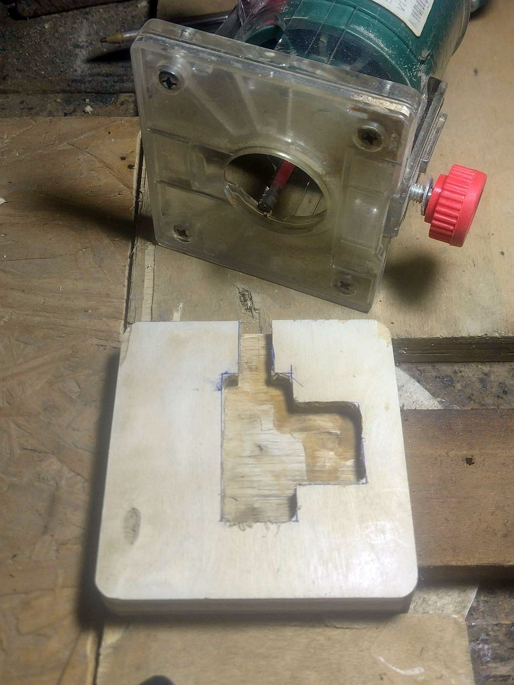

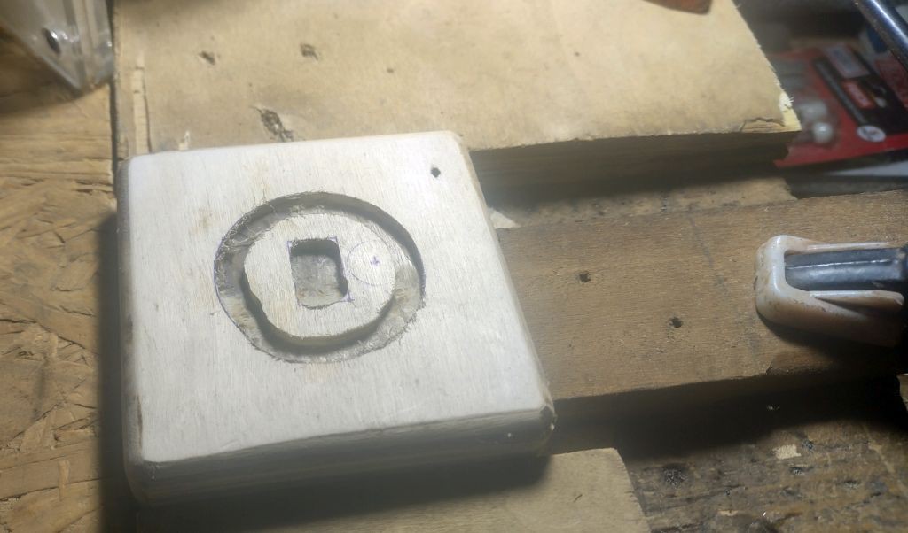

    danjovic08/10/2025 at 02:43 0 comments
    I have built a plywood case for the project. The cuts were manually routed. The case was sanded and covered with carnauba wax.

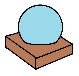

    Planning to make a case using plywood and the dome of a LED lignt bulb

  • Short video of the prototype
    danjovic07/24/2025 at 00:21 0 comments
