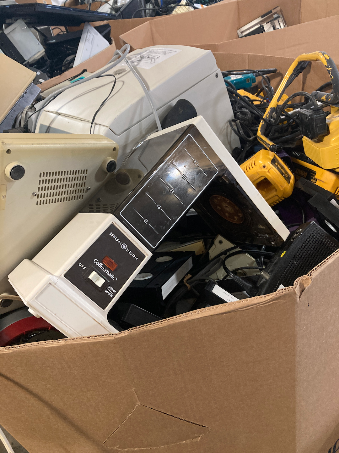

    Coffeematic PC's components were largely sourced from thrift stores and electronics recycling centers.

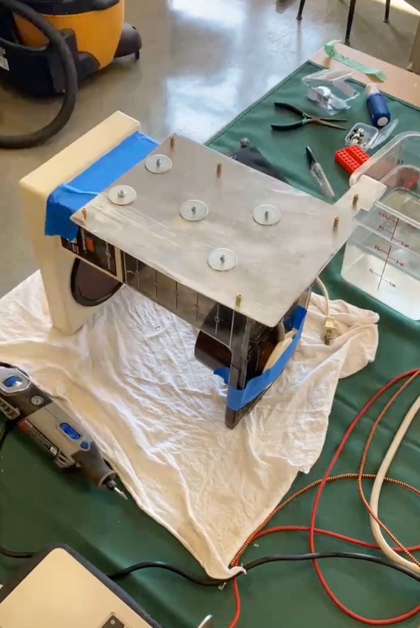

    Coffeematic PC was built with the help of a Dremel, angle grinder, drill, 3D printer, and laser cut parts. I avoid glue as much as possible...
  • 3
    Mounting the computer to the coffee maker
    A stainless steel plate was mounted to the back of the coffee maker to hold the motherboard, and waterproof sealant was used to prevent leaks from the coffee maker's reservoir.
