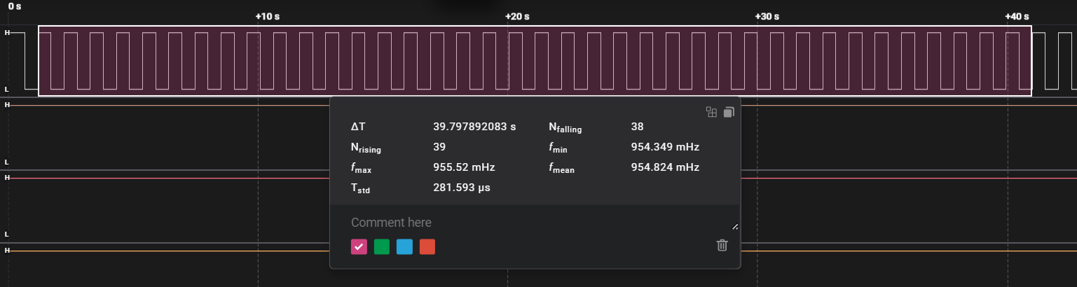

delay_blinky_09 uses a delay value of 2097152 (2^21 or say 1<<21) to be compared against counter for toggling the LED. This value was chosen as it is a natural power of 2 and hence allows immediate load instruction to keep size below 50 bytes. Below is the waveform at Red LED (PD14) for this example (taken using 24MHz logic analyzer).
Hence, with reference to logic analyzer's 24MHz clock, this blinky is 0.955Hz (0.954824 Hz). This is approximately 0.045Hz error, small but significant.
