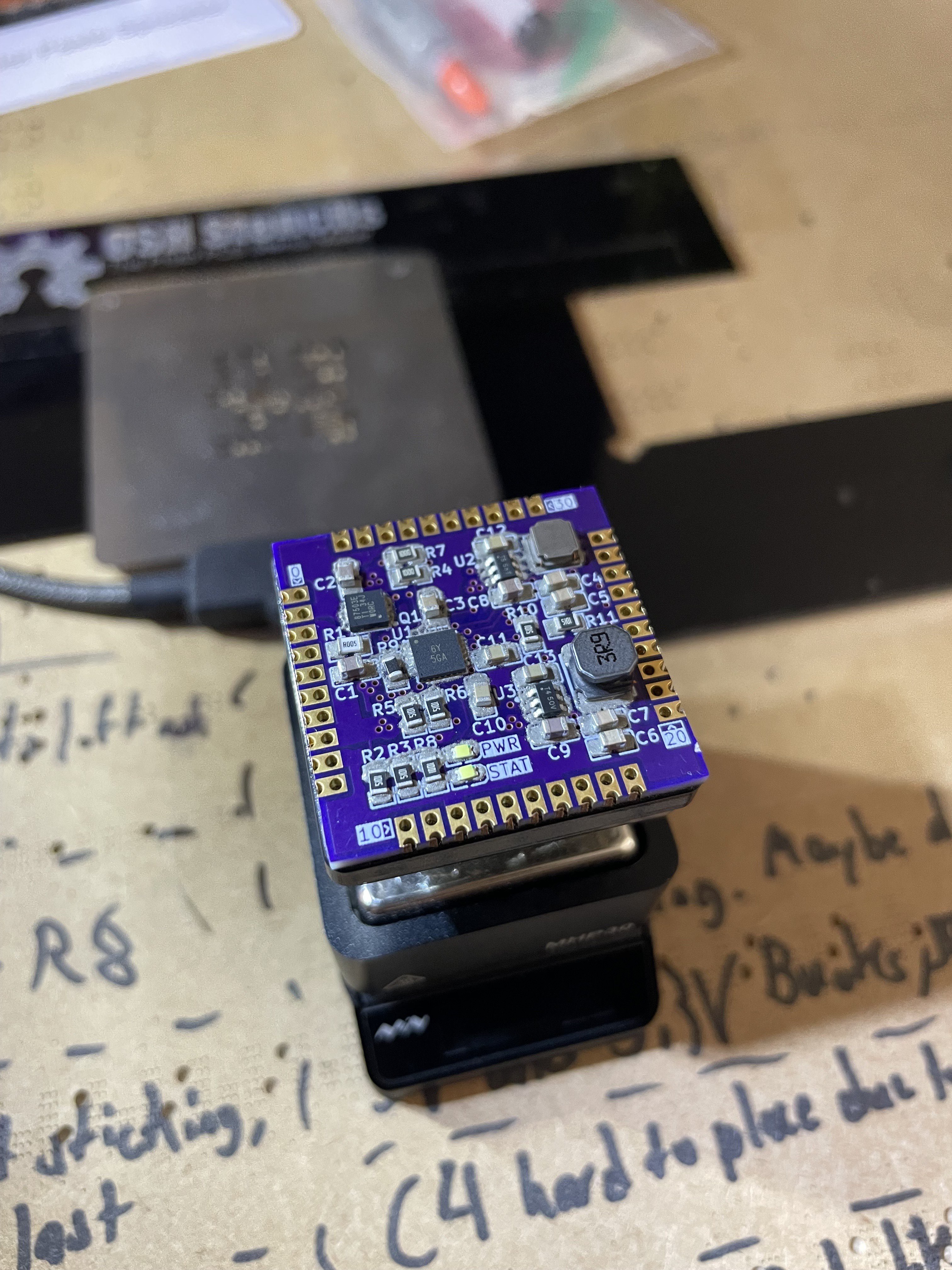

    Hello all!

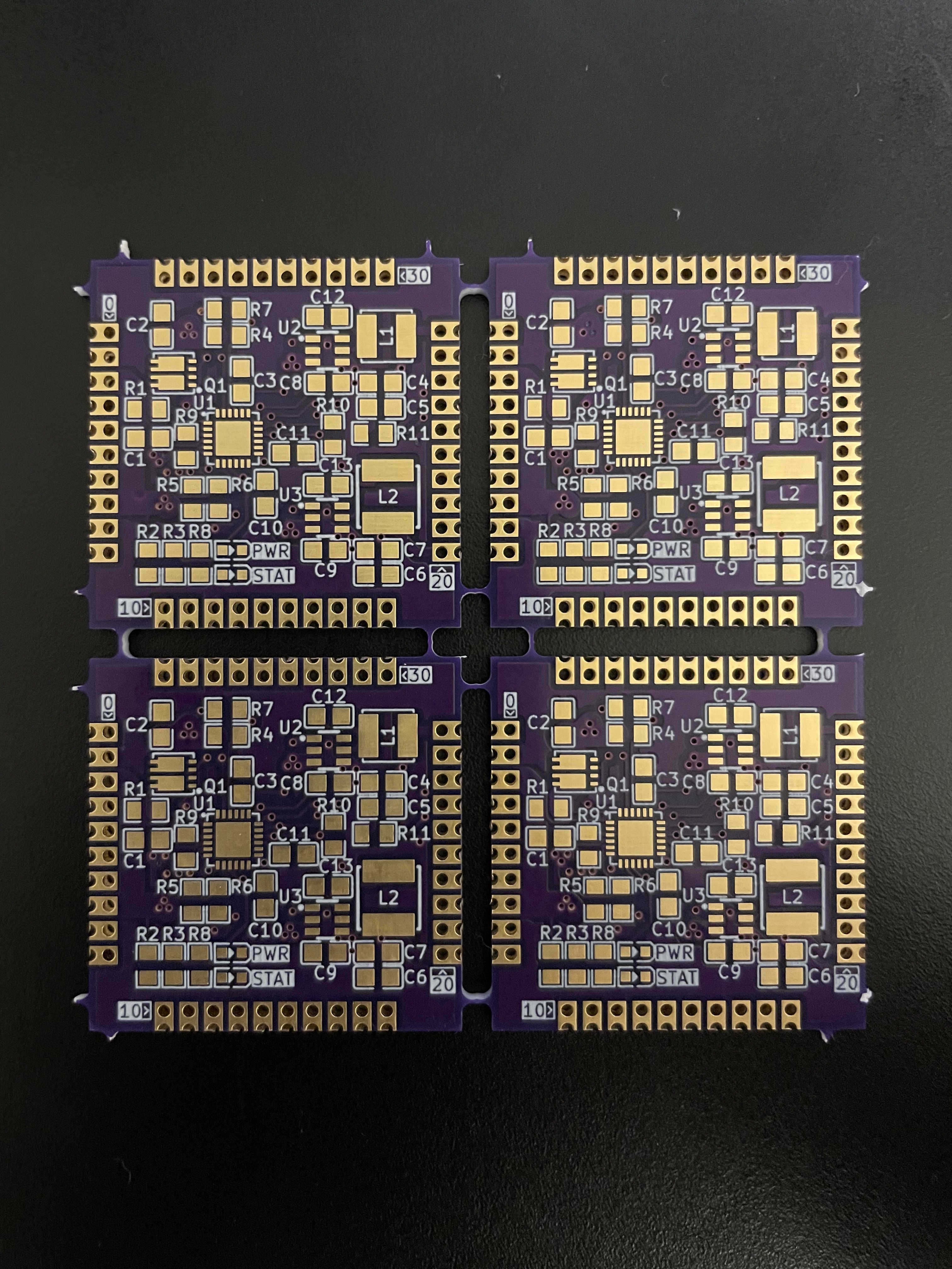

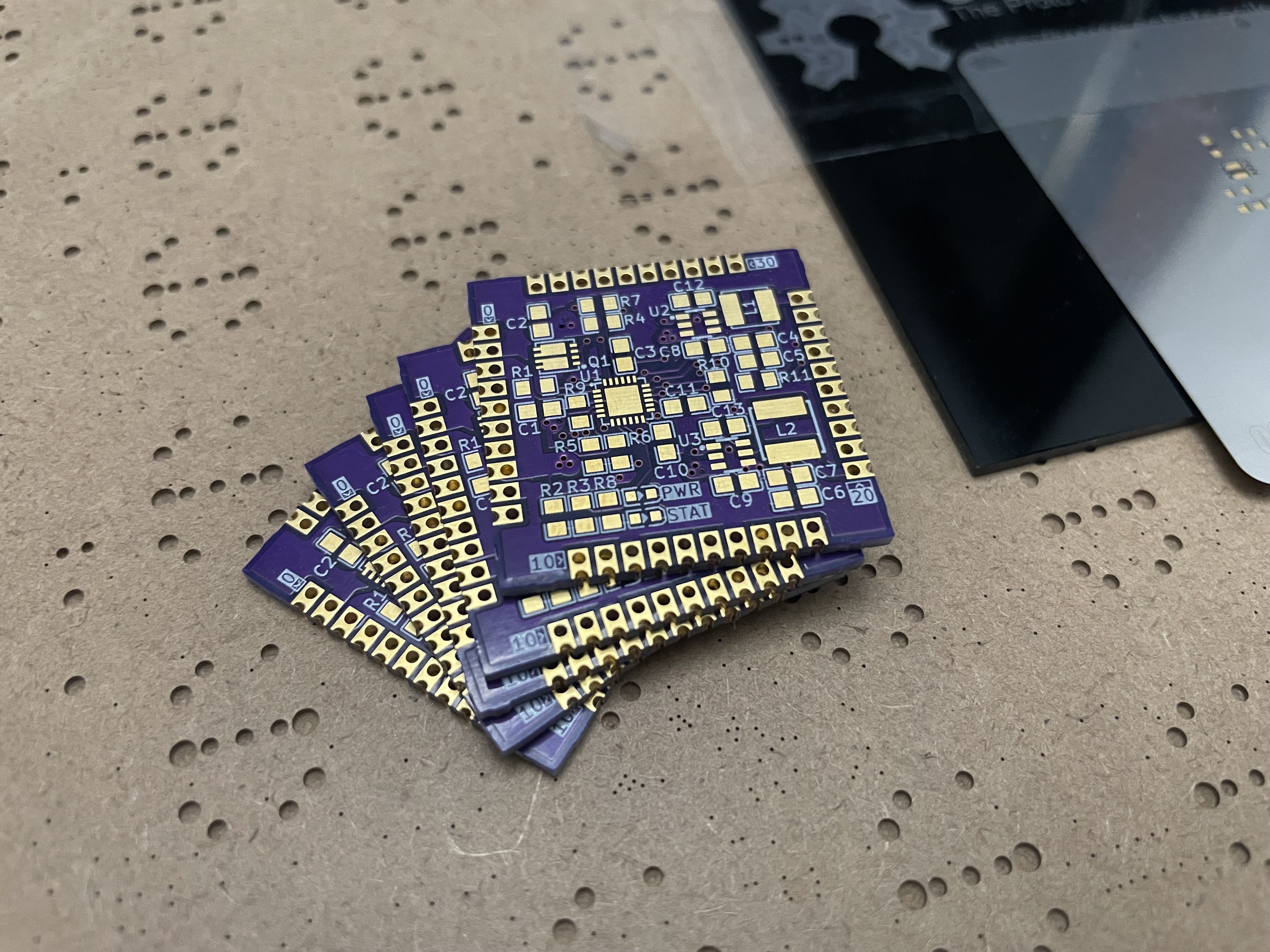

    In this log I'll show some pictures of the build process for the EVT PCB's, go over the set of notes I wrote down about things I noticed in the EVT PCB design that were weird, wrong, hard to follow, or just future advice for me. I'll also list a set of changes that I will enact to improve the design.

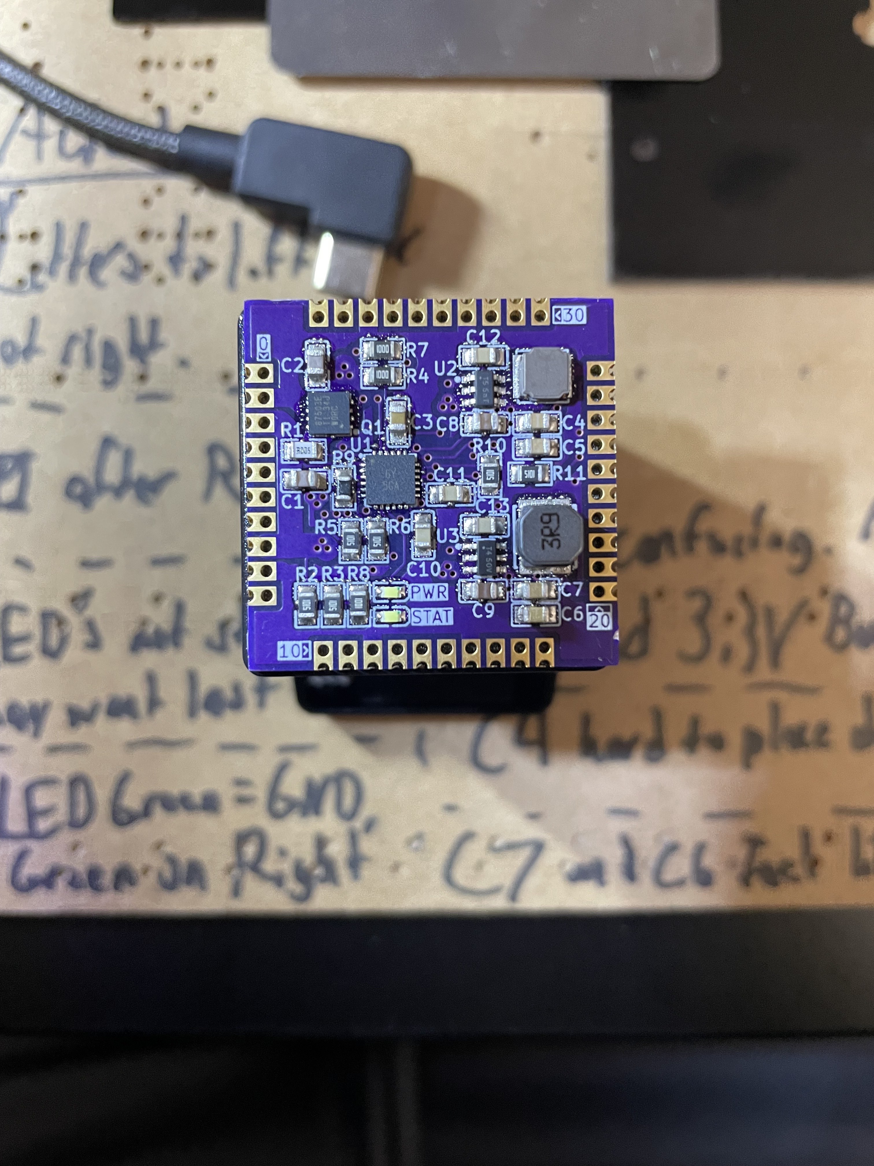

    PCB Assembly Notes
    • There was too much solder paste across the entire PCB. This caused some shorts, especially on the IC packages
    • The solder paste was too warm for Q1 and U1
      • The paste spread out too far, causing some of the IC pins to shorts
    • Component Silkscreen text having inconsistent placement on the right or left side of the component is confusing
    • All components should be placed from left-to-right to prevent accidentally bumping components while placing others
      • Components should also be placed top-to-bottom, though left-to-right should be prioritized
    • The LED's did not like to stay in the solder paste
      • Likely partially due to the solder paste temperature
    • Ground orientation indicator for LED pads should be more clear and pronounced as its hard to see
      • Note for future me: Green = Ground on LED Component
    • Placement of C13 silkscreen text is confusing
      • Easy to confuse with either C11 or R10
    • May be best to assemble 3.3V and 5.0V buck components one after another due to their component density
    • C4, C5, C6, and C7 components are hard to place due to L1 / L2 blocking their placement
    • C6 and C7 silkscreen text seems like they should be reversed as C6 should be above C7
      •  For reference, above C4 and C5 components are correct
    • U1 orientation silkscreen dot is not easily visible due to proximity of U1, Q1, and R9 silkscreen text
    PCB Change List
    • Silkscreen Text will be re-ordered from left-to-right and then top-to-bottom
    • All components silkscreen text should attempt to be on the left side of the component
    • LED's should be given special care during placement due to their smaller size and polarity requirements
    • LED ground orientation indicators will be enlarged and moved to not be under the component
    • C13 silkscreen text needs to be moved to a different location
      • Unsure where to move it currently
      • May require adjustments to other silkscreen text placements
    • U1 orientation silkscreen dot will be enlarged and moved away from other silkscreen marking
    • L1 and L2 components should be placed last in the 3.3V and 5.0V buck converters due to their placement blocking other components
      • Violates left-to-right and top-to-bottom rule
      • This is ok as they're easier to place due to their larger size
    • Solder paste will be applied at a colder temperature
    • Less solder paste will be applied to the PCB
      • Especially for Q1 and U1 which had shorts across pins

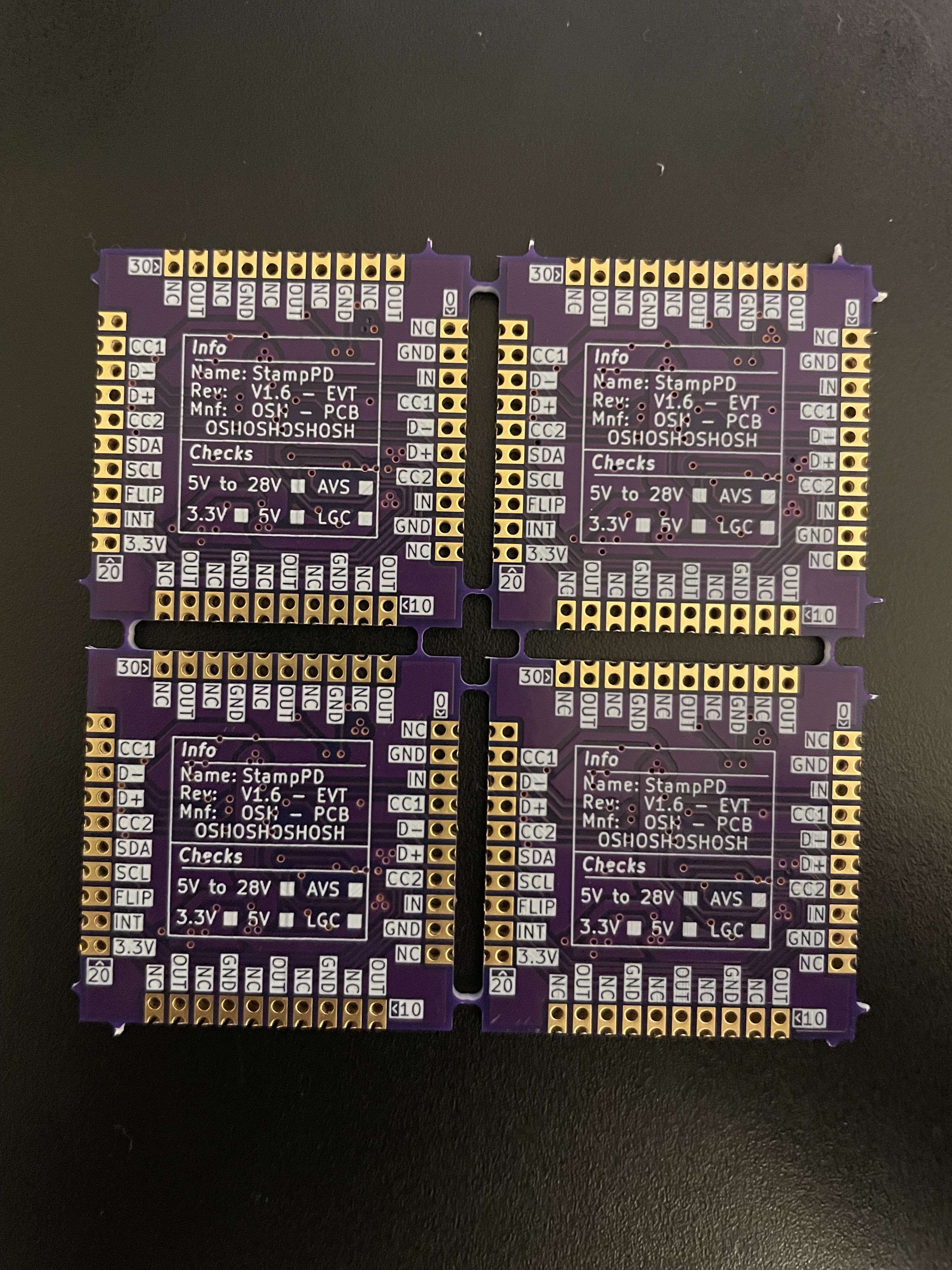

    In this log I'll go through my methodology when ordering EVT (Engineering Validation Test) Components and PCBs, reasoning for chosen Component Suppliers and PCB Fab, and some changes to the PCB as a result.
    Sneak Preview of the PCBs!
    EVT Decision Methodology
    My goal for EVT is to test the PCB and Components to make sure StampPD works correctly. I also want to validate some cost cutting decisions for the PCB that will be explained below. For the EVT iteration I will be hand assembling PCBs to get an understanding of component assembly issues, silkscreen confusion, and to make any necessary PCB fixes easier. My target quantity of StampPD EVT boards is 10 working prototypes but I ordered Components/PCBs for 12 boards to account for mistakes, broken components, and potential destructive testing.

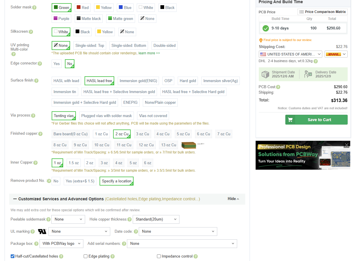

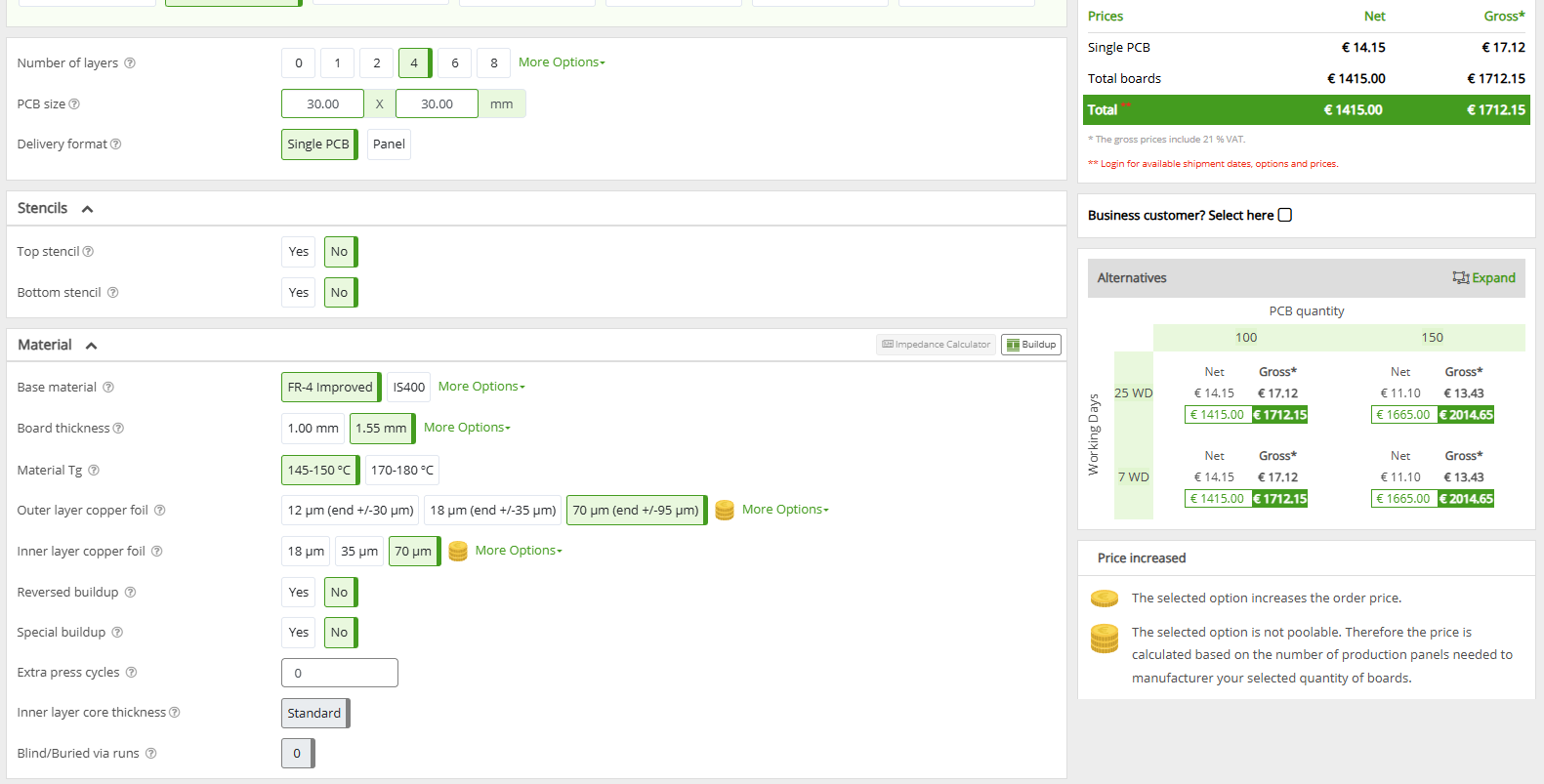

  • PCB Fab Cost Comparison
    Alec Probst11/25/2025 at 16:02 0 comments
    Hi all,

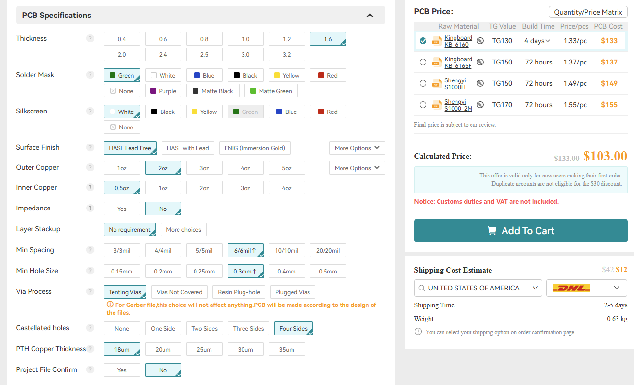

    In this log I want to go through the cost estimates for a couple PCB fabs. The routing for the PCB is far enough along now that I can put in all the settings we need to get cost estimates. This helps to give me an idea of what costs to expect for the final product.
    I am targeting 100 boards as it is an ideal target for hitting cost savings when buying components in bulk and seems like a reasonable amount of boards to make that they wouldn't sell out instantly.
    PCB Requirements
    StampPD is initially designed around JLCPCB as the PCB manufacturer. This is due to 2 reasons: I have experience with them in the past and I wanted to try JLCPCBA service. If any specs seem a bit arbitrary, it is likely that this is JLCPCB's default capabilities. For some specs like the Copper Weight, please see the last log. For all PCB Fab quotes, I will select the following specifications:
    • Size - 30mm x 30mm
    • Layers - 4
    • Quantity - 100
    • Board Type - Single PCB
      • Possible that panelizing the PCB's will reduce costs but that is for future me to find out
    • Base Material - FR-4
    • Outer Copper Weight - 2 oz/ft^2
    • Inner Copper Weight - 0.5 oz/ft^2
      • 1 oz/ft^2 would give more safety margin for the power layer
    • Castellated Holes - Yes, all 4 edges
    • Minimum Via/Plated Through Hole (PTH) Copper thickness - 18um
    • Minimum Drill Hole Size - 0.3mm (12mil)
    • Minimum Trace Spacing - 0.2mm (8mil)
    • Minimum Trace Width - 0.16mm (6.5mil)
    • Product Number - Location Specified
    Any specifications not listed above are not very important to the StampPD design at this time. That means specs such as these will be selected to be as cheap as possible: Surface Finish, Layer Stackup, Via Process/Covering, PCB Thickness, PCB Color, Silk Screen Color, and Board Outline Tolerance.
    PCB Fabrication Companies

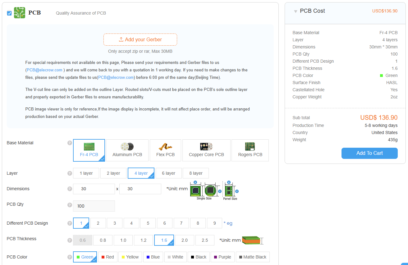

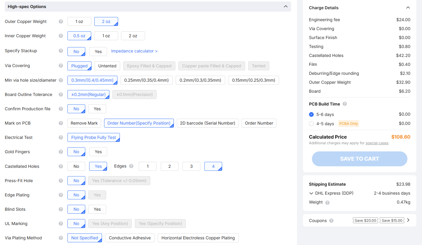

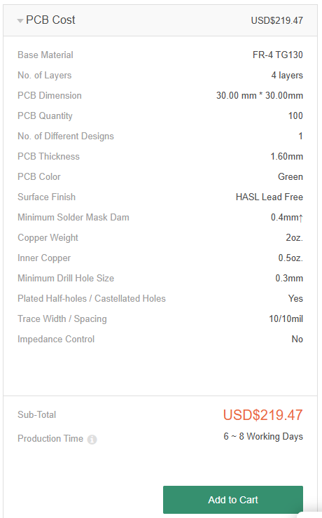

    A website which lists PCB fabs for small batch production can be found at BuildList.org. I filtered this list to Fabs that allowed me to select the above settings. This removed some Fabs, such as OSHPark, as they did not have settings for 2 oz/ft^2 Copper Weight for 4 layer boards or Castellated Holes. I also removed any discounts given as these may not be repeatable on subsequent orders. Note that prices may fluctuate depending on the time and place of your order. This leaves us with the resulting quotes as of 11/25/2025:
    • JLCPCB - $108.60,
    • All PCB - $133.00
    • Elecrow - $136.90
    • PCBWay - $290.60
    • SEEEDStudio - $219.47
    • Eurocircuits - $1,984.74 ( €1712.15 )
    As you can see JLC, AllPCB, and Elecrow are the cheapest. PCBWay and SEEEDStudio are more expensive but still somewhat reasonable while Eurociruits is completely unreasonable. For now, I plan to stick with JLC unless prices change drastically.
    Below are screenshots of the prices given above:

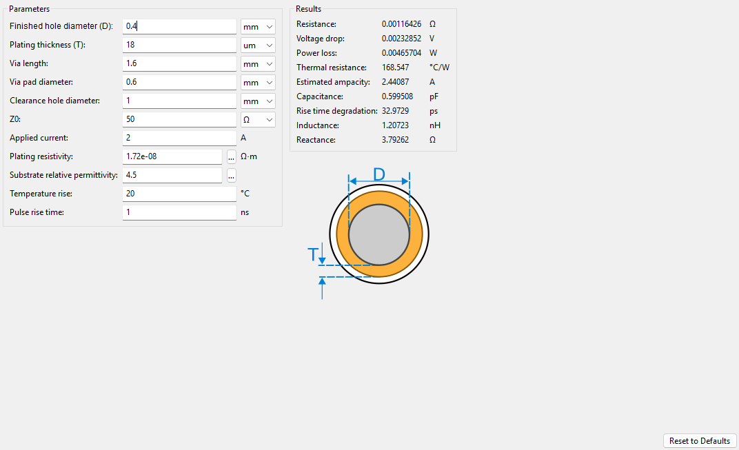

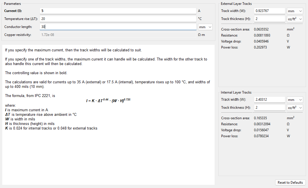

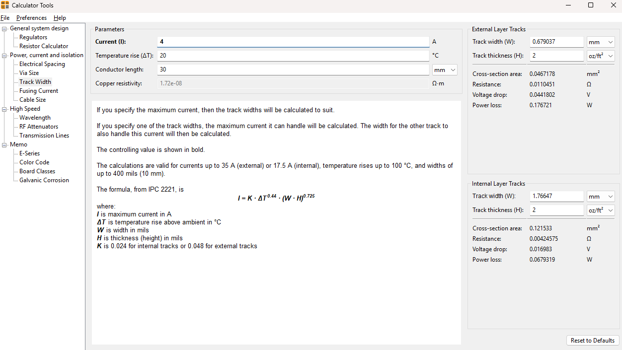

  • PCB Trace/Via Calculations and 2 vs 4 Layer PCB
    Alec Probst11/24/2025 at 22:54 0 comments
    Hi all,

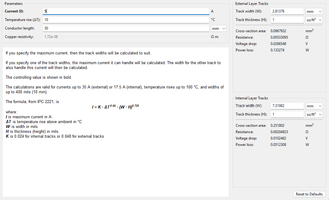

    This log will go through the calculations required to size the traces and vias for the StampPD PCB as well as the decision to move from a 2 layer board to a 4 layer board.
    High Current Domains
    We need to calculate what copper weights are required for the PCB based on the max expected current through traces and vias. For StampPD, we have 4 power domains that have significant current. These are:
    • USB PD VBUS domain: 5A
      • Determined by USB PD spec
    • 3.3V Output domain: 2A
      • Determined by buck converter max output current
    • 5.0V Output domain: 2A
      • Determined by buck converter max output current, and
    • Input current to combined 3.3V and 5.0V buck converters: 4A
      • See calculation below
    Buck Converter Input Current Calculation
    While the buck converters for 3.3V an 5.0V can output up to 2A of current each, they require a different amount of input current. To calculate each buck converters input current, we multiply its Max Output Voltage by the Max Output Current then divide that by the Minimum Input Voltage times the Efficiency.
    The minimum Input Voltage for both buck converters will be 5V as this is the minimum voltage defined by USB. The efficiency can be found in graphs for the AP63200 but no 5.0V input voltage line is given. For now I'm taking the 12V input voltage efficiency at 2A which is around 90% for both buck converters. The actual efficiency is likely higher than this as efficiency in a buck converter increases as the input and output voltages are closer in value. By replacing the equation values and adding both buck converters input current requirements together, we get the below solution:
    This gives us 3.7A which I round up to 4A for safety margin.
    Trace Width Calculations
    KiCAD has built-in "Track Width" and "Via Size" calculators that I'll show here. To start with, lets look at the 5A domain with default 1oz copper weight at 10C temperature rise for around 30mm conductor length ( length doesn't change track width much here so we'll default to 30mm since this is the length of the PCB ).
    This gives us a 2.81mm trace width for external layers. For a 30mm x 30mm board, this is huge! This trace alone will take 1/10th of our board space in a single axis at a minimum! Reviewing the data sheets for all IC's, we can increase the temperature rise to 20C safely for all of our components with minimal loss in efficiency to get a trace width of 1.85mm. This is still quite large and doesn't provide enough routing flexibility. This leaves one last thing to change which is the Track Thickness, also known as Copper Weight. By changing this from 1 oz/ft^2 to 2 oz/ft^2, we get a track width of 0.92mm.
    Rounding this trace width up to 1mm gives us a bit of a safety margin and is easier to keep track of. Increasing our Copper Weight to 2 oz/ft^2 will increase the price of the PCB but there isn't much choice if we want to support 5A. Note that a 1mm wide trace width for 5A is only valid for PCB layers that are external ( top and bottom layers ). Internal layers will need much thicker traces as they usually have lower Copper Weight, usually 0.5 oz/ft^2, and can't remove heat as easily.
    Since the temperature rise and copper weight are set by our 5A traces, we can calculate the trace widths needed for 4A and 2A as 0.7mm and 0.3mm as seen below:
    Via Size Calculations
    When calculating the Via Size, we can use the 20C temperature rise from the above calculations. We should be careful to not confuse the 2 oz/ft^2 copper weight with the plating thickness of the Via. Using JLCPCB's default capabilities, we can see that the "Average Hole Plating Thickness" is 18um. Keeping all other parameters default in KiCAD, including the default Via Hole Size of 0.4mm, gives us a Via that can support up to 2.4A:
    While this will be sufficient for the buck converter 3.3V and 5.0V 2A output domains, the VBUS 5A domain will need larger Vias. Going up by 0.1mm steps, we can arrive at a 1.2mm Via Hole...

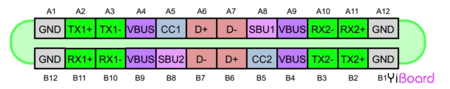

    Pin Orientation
    The logic used to determine which side of the PCB pins should be on is to go from left-to-right when looking at the PCB from top down. The logic/power input is on the left side while the logic and 5.0V/3.3V power output is on the right side. The variable USB-C Power output is on the top and bottom. You can see this in the schematic diagram below:
    Pinout Reasoning
    Input Pins (Left Side)
    As this stamp will use USB-C for power and data input, the most logical pin input routing should match the expected pinout for a USB-C Female Receptacle. Based on the image below, you can see that this leads to ground on the outside, then power (VBUS), CC Pins, and finally USB D+/- .
    Output Pins (Right Side)
    The right side output pins on the stamp do not have a likely output order like the left side Input Pins do. As such, they are organized based on ease of routing and part placement. The 5.0V and 3.3V power output pins flank the top and bottom due to the placement of the buck converters for the associated voltages. Next are the communication pins for SDA and SCL and the PD Controller INT and FLIP logic pins. The SDA/SCL pins were placed on the top due to their necessary components needed for the SDA/SCL pins being located on the top while the INT and FLIP pins were closest to the bottom side of the PD Controller. Finally, the CC and USB D pins simply route from left to right across the PCB.
    Output Pins (Top/Bottom Sides)
    The top and bottom pin placement alternates between power output and ground pins, separated by a No Connect (NC) pin in-between. The NC pin was included to make it more unlikely that the power output pins and ground pins could be accidentally shorted when soldering StampPD. Its unclear if this is an optimal power pinout setup and would love feedback on this design choice.

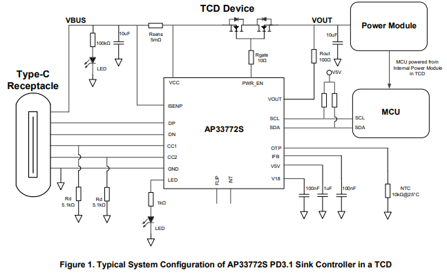

  • USB PD Controller Component Choice
    Alec Probst09/25/2025 at 03:08 0 comments
    Hi all,
    In this log I'll go over the specific component selection for the USB PD Controller.
    USB PD Controller Sink Selection
    A USB PD Controller Sink is an IC that communicates with the USB PD standard to set a voltage and current from a USB PD source for downstream devices. The selected USB PD Controller for StampPD is the AP33772S. This IC comes in two variants , the AP33771C and the AP33772S. The C variant is a version which uses resistors to select the desired current and voltage while the S variant uses I2C to communicate with a microcontroller to select the voltage and current. In StampPD, we will use the S variant for its ability to change and request different voltages and currents. The controller selection was inspired by controller in the PicoPD which used an older version called the AP33772. This controller is Not Recommended for New Design (NRND) by the manufacturer, Diodes, and is only compatible with the USD PD3.0 standard. The AP33772S is compatible with the newer USB PD3.1 standard. I compared a couple differences between these two controllers in the Design Objectives log if you wish to see why this version was chosen. I attempted to research USB PD3.2 controllers that were similar to the AP33772S but was not able to find any, likely due to the standard being more recently released. Some reasons I've selected the AP33772S were:
    • Evaluation Board (EVB) User Guide
      • Direct reference on how to implement the AP33772S on a PCB
      • Known components and component values to start from
    • Detailed Reference Circuit Diagram ( image below )
    • Decent Datasheet Documentation
      • Explains all pins and their functions
      • Functional Descriptions of all features
      • Missing PWR_EN pin voltage / current abilities ( more details below )
    • Small Package Size
      • While the side pins are likely hand solderable, it's unclear how one would solder the bottom exposed pad for thermal dissipation
    • Lots of built in safety features
    • Support for many types of PD (EPR, AVS, SPR, PPS)
    • Wide Voltage and Current Control up to 140W (28V, 5A)
      • No 240W support :(
    • Easy I2C control

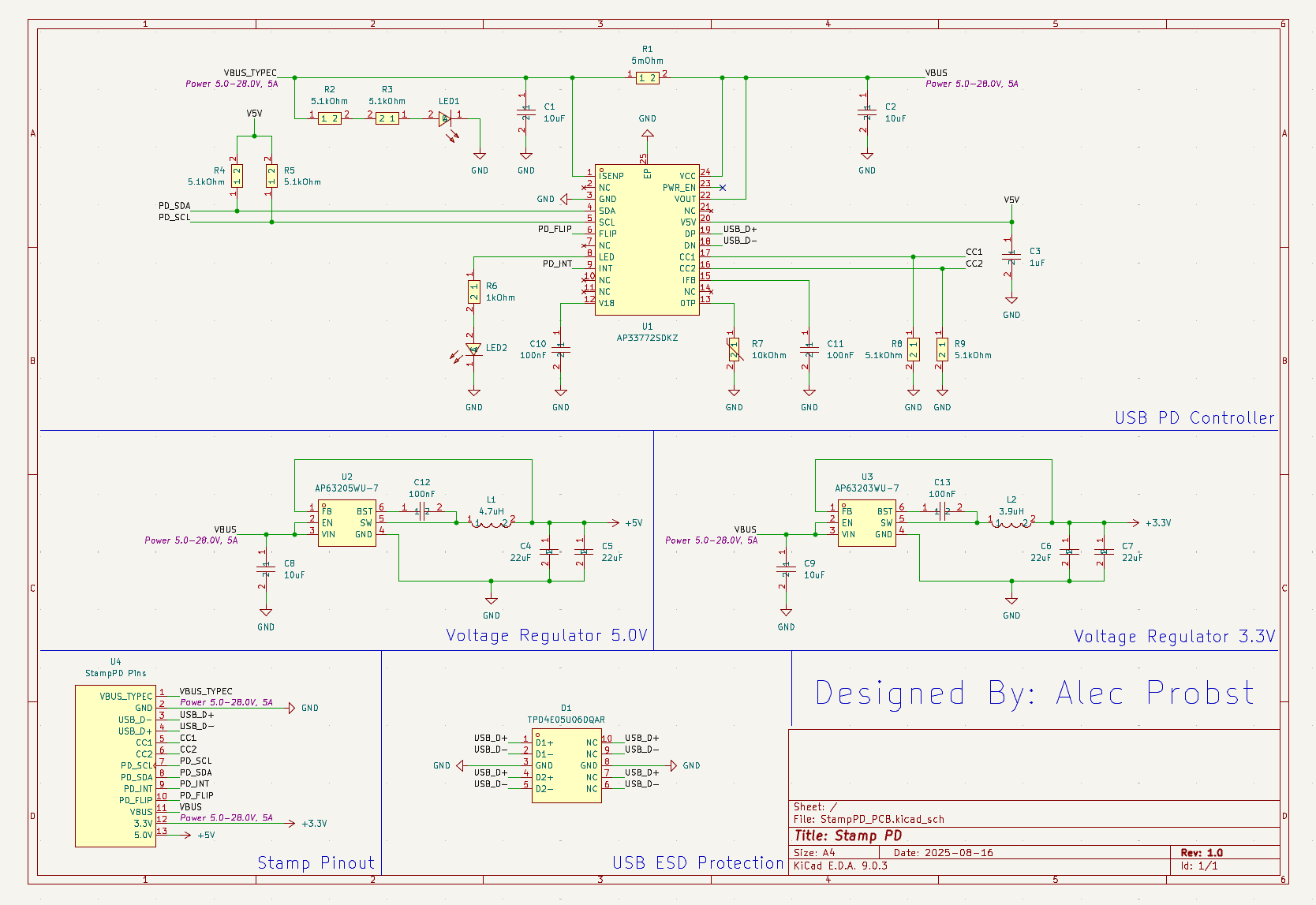

    Recommended Components
    Below, an example circuit, called Figure 1, shows what an implementation of the AP33772S should look like with some specified component values. A table called Pin Descriptions describe the functions and voltage / current for pins of the AP333772S. Since the circuit diagram + table gives us a good idea of what to implement for this IC, I'll describe the more important/complicated components and only put component values in a list for the others.
    Input Current Sense Resistor
    This resistor sits between ISENP (Current Sense Pin) and VCC. It is used by the AP33772S to determine the amount of IR drop through VBUS for overcurrent protection. Since VBUS supports 5A and the recommended resistance is 5mOhm, this resistor needs to support at least 5A^2 * 5mOhm = 0.125W ( P = I^2 * R ). We'll want to give around a 50% power margin here so our target resistor power rating is 0.125W * 1.5 = 0.1875W. We should also limit the resistance tolerance to within 1% to reduce variability and power loss.
    IC LED
    This pin is described as outputting up to 5.33V, 2mA. If we use the suggested 1000Ohm resistance value, we should look for a LED with a Forward Voltage (Vf ) = Voltage Source - Resistor * Forward Current. Vf = 5.33V - 1000Ohms * 2mA = 3.33V. This means if we keep the suggested 1000Ohm resistor and assume 2mA of Forward Current, we should look for a LED with a Forward Voltage of 3.33V. This will likely be a blue or white colored LED.
    Over Temperature Protection (OTP)
    This resistor is used to detect the temperature around the IC. When NTC resistors heat up, their resistance decreases. This can be detected to determine overheating conditions. For this IC, it's calibrated for a NTC resistor that has a resistance of 10KOhm when the temperature is 25C.
    VBUS LED and Resistors
    For the VBUS LED and Resistors, I'm ignoring the values suggested in the circuit diagram. Instead,...

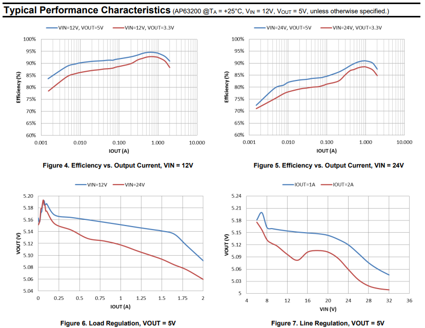

    Below are the efficiency, load, and line regulation curves for the AP6300. Figure 4 shows the efficiency at different output current for 12V, Figure 5 shows the efficiency at different output currents at 24V. The blue line is 5.0V output, the red line is 3.3V output. Figure 6 shows the expected output voltage at different currents. The blue line is input voltage of 12V, the red line is input voltage of 24V. Figure 7 shows the expected output voltage with different input voltages. The blue line is output current of 1A, the red line is output current of 2A. From these we can take away a couple things:
    • Ideal current draw is between 0.2A and 2A for >85% efficiency
      • This is true for both 12V and 24V input and 3.3V and 5.0V output
      • I expect most applications of StampPD to be within this range
    • Output voltage for 5.0V will likely be between 5.06V and 5.19V for different output currents
      • There will be lower output voltage as output current increases
      • Trend between the lines shows that likely closer to 5.19V at lower output currents and voltages
      • No data for 3.3V
    • Output voltage for 5.0V will likely be between 5.03V and 5.20V for different input voltages
      • There will be lower output voltage as input voltage increases
      • Trend between the lines shows that likely closer to 5.20V at lower input voltages
      • No data for 3.3V
    I expect that for the 5.0V AP63205 I should see around 5.20V at low input voltage and low output current. As the input voltage and output current increase, I expect the output voltage to drop to just above 5.0V.
    Using the efficiency trends in Figure 4 and Figure 5, I will guess that voltage for the 3.3V AP63203 will likely be worse (higher voltage at lower output currents and input voltages). Using the efficiency percentage difference of around 5% in Figures 4 and 5, and the voltage difference of around 0.2V from Figures 6 and 7, assuming this IC outputs 3.3V at around 2A 32V input, I calculate an output voltage around 3.3V + 0.2V * 1.05% = 3.51V.
    I expect that for the 3.3V AP63203 I should see around 3.51V at low input voltage and low output current. As the input voltage and output current increase, I expect the output voltage to drop to just above 3.3V.

    • Castellated Holes
      • Since this is a solderable stamp, the PCB will need to have Castellated Holes on the edges
      • Castellated Holes are through whole vias that have been cut horizontally in half through edge cuts on the sides of the PCB. This exposes the inner copper of the via, making it easier to solder to a pad
      • This will increase PCB cost. JLCPCB shows an additional cost of $39.30 for 5x 100mmx100mm for 4 edges without a gerber file. Changing the number of edges does not change the cost very much ( < $2).
