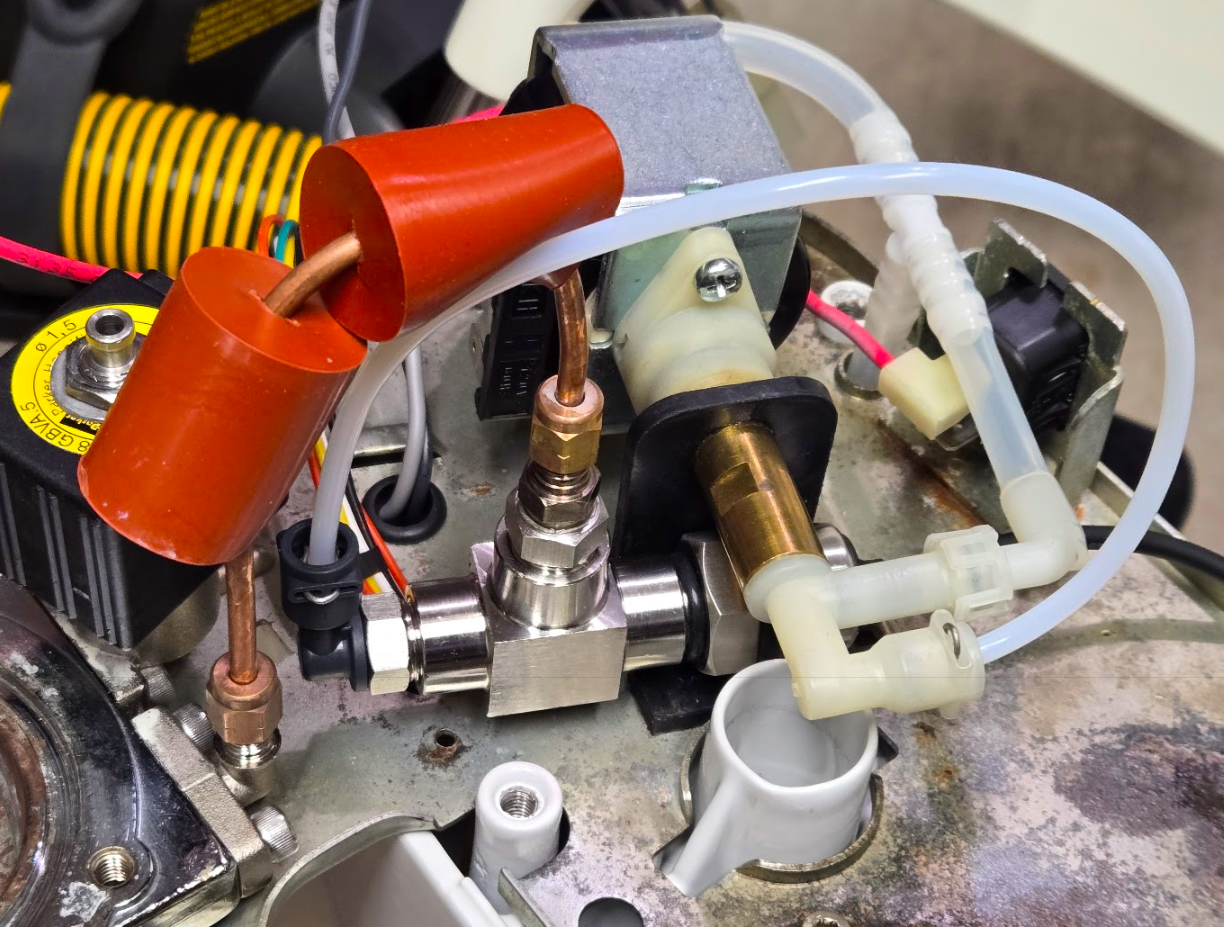

    Pump piping
    OPV is DeLonghi 7313219431
    270mm tube is DeLonghi 5513212881

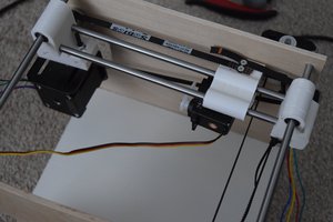

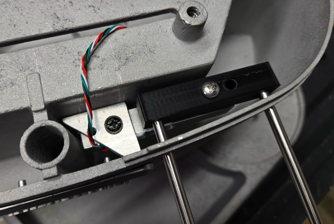

    Scales
    Scales are experimental, it remains to be seen how they will hold up.

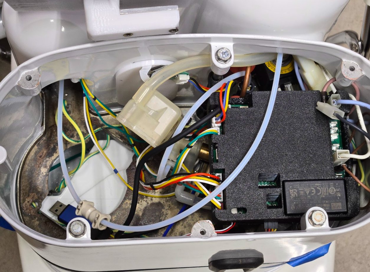

    Gaggiuino
    PCB v2 was used for Gaggiuino, mounted on a remixed bottom.
    DeLonghi 5513219851 connected to 5513219841 with a coupler from Amazon.
    3WV exhaust is tamed with DeLonghi 5513216891 box.
