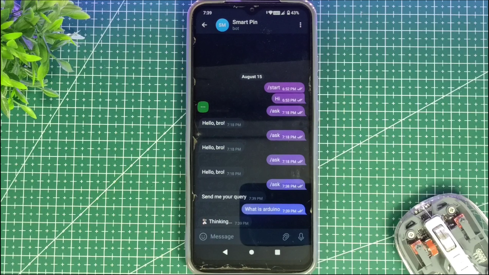

4Step 1: Part 2: AI Model
About this step:
We’ll upgrade that same code so the bot can use an AI model to reply with intelligent responses.

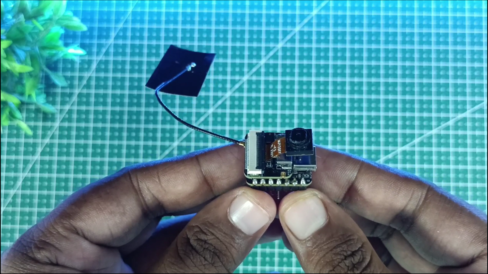

5Step 2: Image Capture
In this step, our goal is to capture an image when the bot receives a command, then convert it into Base64 format, and finally, send back the first 50 characters as confirmation.

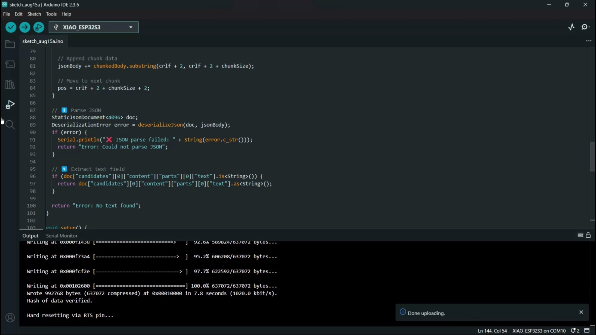

- Connect your XIAO ESP32S3 board to your computer.
- Click the Upload button in the Arduino IDE to flash the code.
- Once uploaded, open the Serial Monitor (set baud rate to 115200).
- Watch the output to confirm that the XIAO ESP32S3 connects to Wi-Fi and starts the bot.
6Step 3: Final Match
Now it’s time to combine everything. This new code merges Step 1 (Part 2) and Step 2.
Here’s how it works: The bot first asks for a query. Once the user sends it, the XIAO ESP32S3 captures an image, converts it into Base64, and, along with the user query, sends it to the Gemini API. The API processes both inputs and returns a detailed reply.

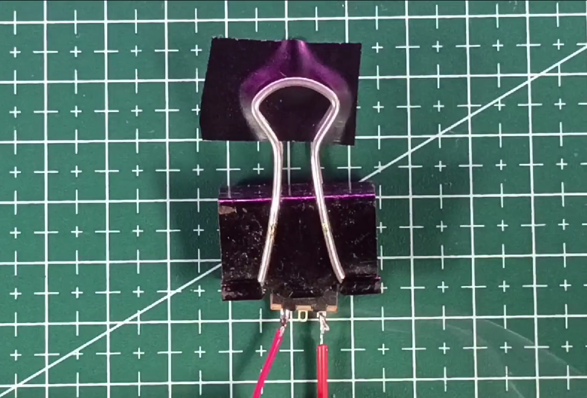

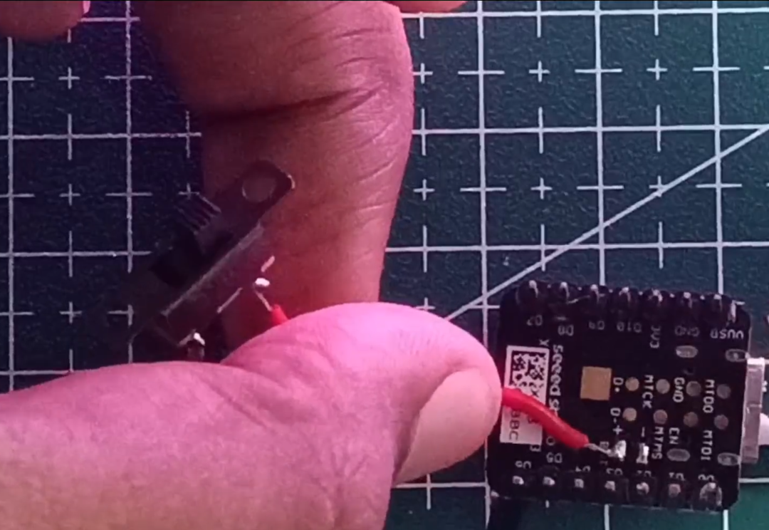

7Step 4: Wiring the Circuit - Making It Portable
To make our AI Pin portable, we’ll need a few additional components: a 3.7V Li-Po battery and a small switch. These will power the XIAO ESP32S3 Sense board.
Connect the Battery with a Switch
- Solder the negative terminal of the battery directly to the GND pin of the XIAO ESP32S3 Sense board.
- Take the positive terminal of the battery and connect it to one side of a switch.
- From the other side of the switch, connect a wire to the 3V3 (or VIN) pin on the board.

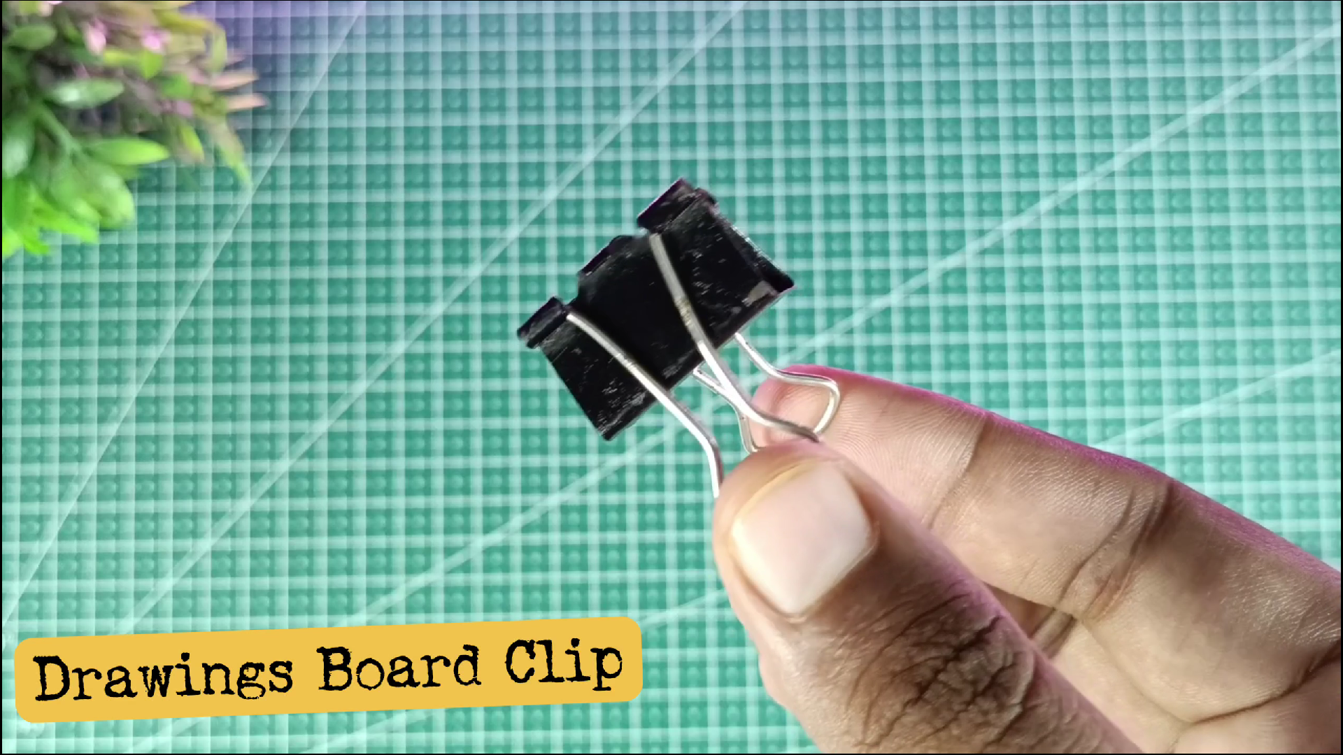

8Step 5: Enclosure for It
To construct the case, I will use cardboard, but you can use any material, such as acrylic sheet/sun board, etc., as per your requirement. The PDF file containing the cutout templates is attached below. Please refer to the accompanying images for guidance on assembling the case for this project.
