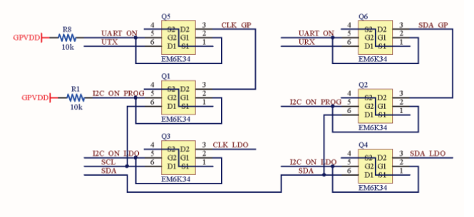

    I2C_ON_PROG pin is set up as a open-drain NMOS. This means that if this pin is HIGH it will sink the VDD/EN of the target PCA9306, turning it off.
    I2C_ON_LDO pin is set up as a normal output pin. Now we need to look at the schematics again.
    The LDO level-shifter can not be turned off in this configuration? It shouldn't matter if I2C_ON_LDO is HIGH or LOW? It's powered through VDD anyway.
    Looking at the GSD Rev 1.0 level-shifters
    It fits the logic much better. Notice the level-shifter UART pins. NC is UART_ON.
    Look at the output here.
    There is a 6 pin header there. But with 2 extra GND. Probably where UTX and URX would have gone if they had added UART.
    Here is a board view of the GSD Rev 1.0
    The final design doesn't include the 2 UART level shifters. So the UART lines are probably not routed at all. The schematic is not updated to fit the final design which is weird. I guess the schematics, board design and documentation was managed by different people. It's only way to explain this.
    Looking at this it confirms that the OTP memory logic of the SLG46582 on my GSD Rev 2.0 is the GSD Rev 1.0 design. They probably had a lot of preprogrammed chips to use. Now does this mean that the device is reconfigured by software before it's used?

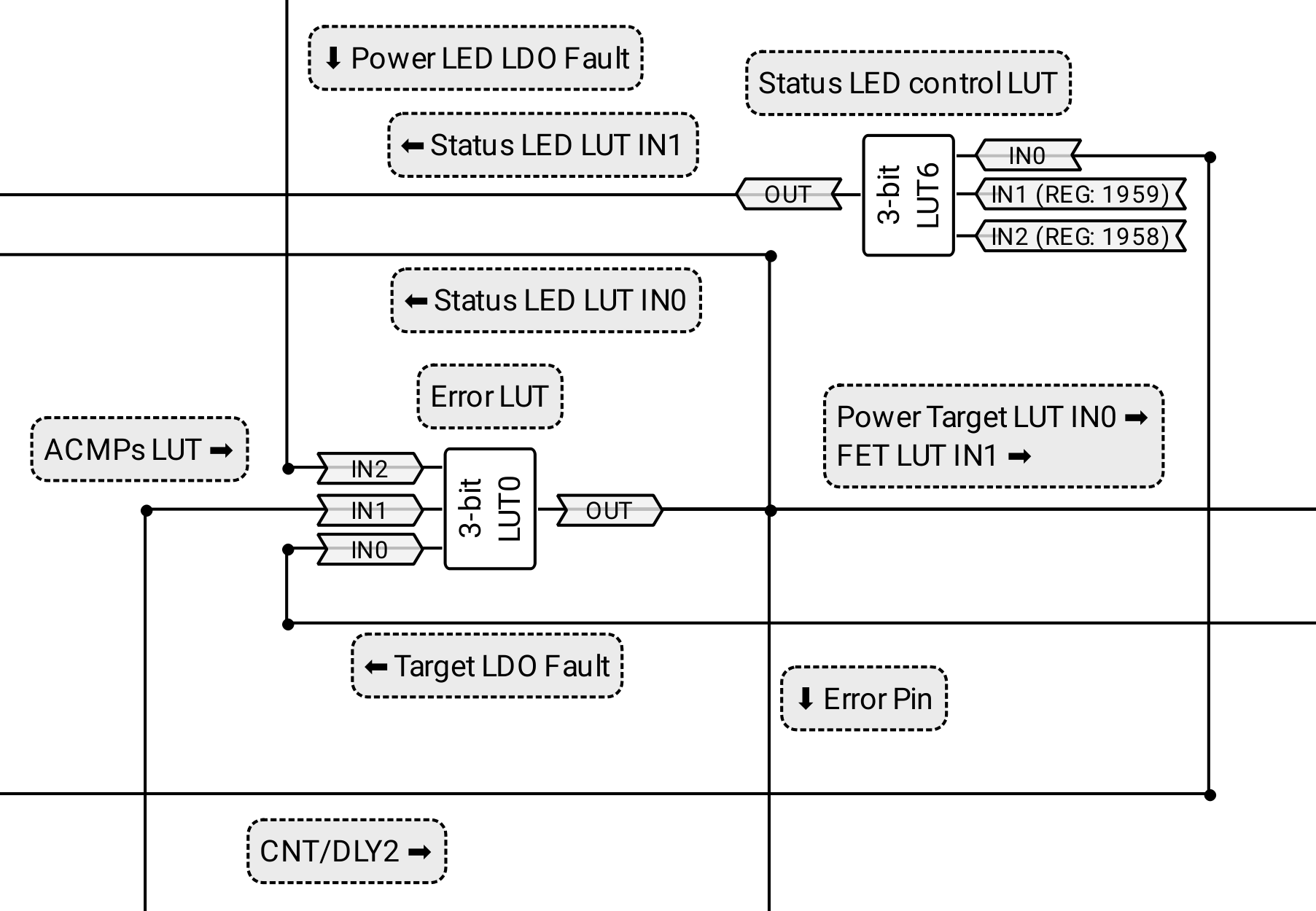

    The Error pin

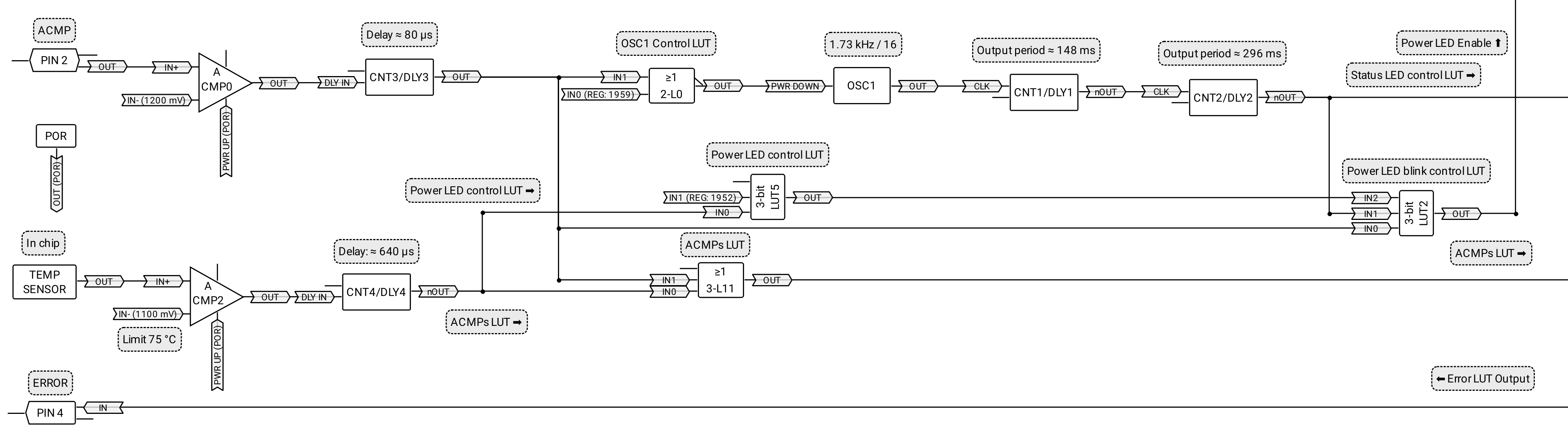

    This probably has the most logic connected to it. Let's start from the error pin and go backwards to the source of the logic.
    The output of the Error LUT (3-L0) goes to the Error pin (Pin 4), Status LED LUT (2-L2) and the FET LUT (2-L1).

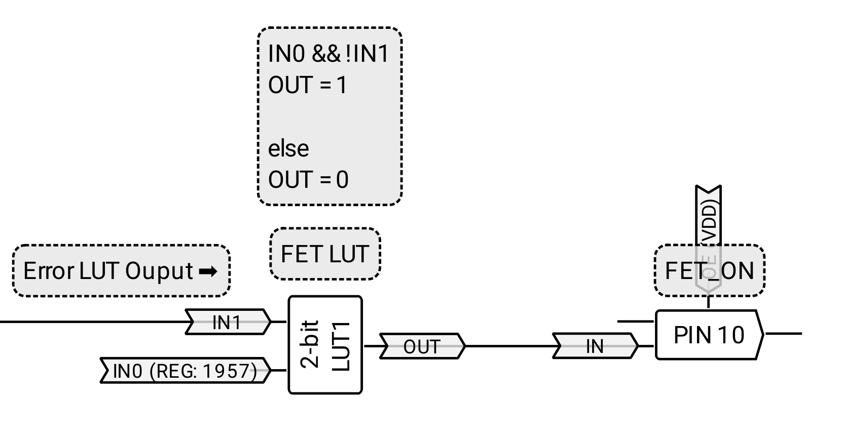

    Let's look at the FET LUT (2-L1) First.
    If there is an error, FET LUT output is turned off, FET LUT is controlled directly by the I2C Register 1957.
    Next the Status LED.
    Here an error turns off the Status LED.
    Next is the Error LUT.
    The Error LUT (3-L0). When an error is detected by the logic both the Power target LDO and Target power FET are turned off. The error signals comes from the LDO's themselves (IN0 and IN2) and the ACMPs (IN1). Both overvoltage (ACMP0) and the set temperature limit which is 75 °C (ACMP2).
    The status LED control LUT (3-L6). The CNT/DLY2 signal controls the status LED blinking speed. There are two I2C registers connected to it 1958 and 1959.
    The I2C register 1958: This controls if the status LED indicator should be on or not.
    The I2C register 1959: It controls two things when it's turned on. It releases the powerdown of the OSC1 and enables blinking of the Status LED.
    The rest
    ACMP0 is use for overvoltage...

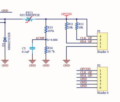

    Not sure what is going on or if my calculations are correct. I'm sure I set the voltage to 3.3 volts in the greenpak software. Perhaps there is some calibration? I'll figure it out later with some more testing.
    The maximum voltage the ADC in this case see handle is
    (1023 / 1023) * 4.096 * 4.666 = 19.11 Volts.
    Now why is the voltage divider set like this wasting precision?
    There is no input protection before the voltage divider, so to protect the inputs of the MCP2221A and PowerPAK from overvoltage the voltage divider is set up like this.
    The maximum voltage the PTC can handle is 16 volts.
    So if you by accident feed 12Volts into the GSD VDD_OUT it will probably not release magic smoke. The zener will sink the current, the PTC trip and the device will most likely it...

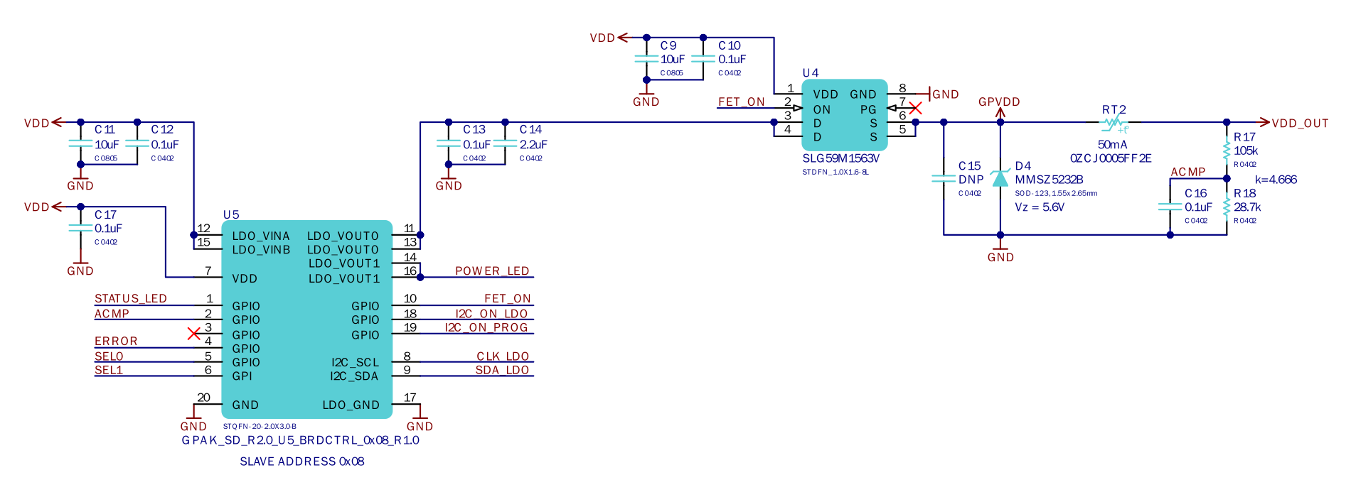

    The GSD is more advanced than my MCP2221A + Level shifter design. The user manual for the GSD contains a schematic it tells you quite a bit how it works.

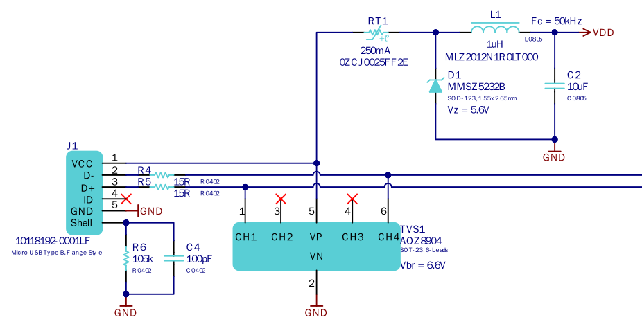

    I'll start with the USB side it looks like this.
    The USB connector shield is connected to a 105 kΩ resistor in parallel with a 100 pF capacitor to provide a controlled ground reference, improving EMI suppression and diverting ESD without creating ground loops.
    The D− and D+ lines pass through 15 Ω series resistors for impedance matching with the MCP2221A, improving signal integrity and reducing reflections. A TVS diode is used for additional ESD protection. D- and D+ lines are connected to the MCP2221A (not in image).
    VCC goes through a PTC to limit the current to 250mA, a zener-diode clamps any overvoltage, and a LC filter is used to reduce noise before going to VDD.

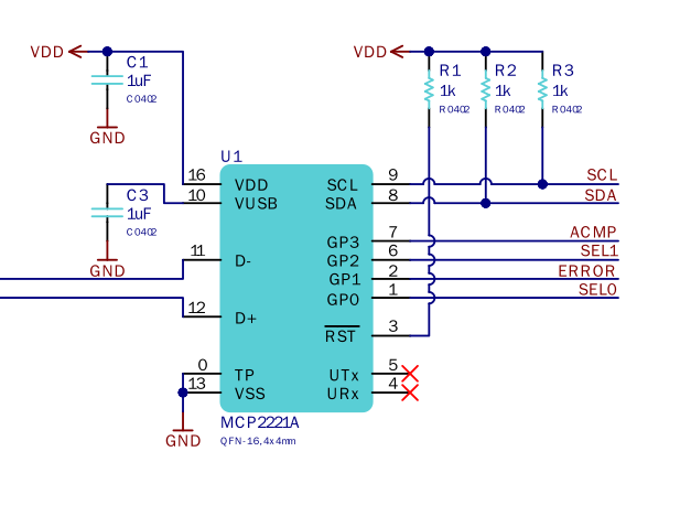

    On the MCP2221A side.
    The MCP2221A is setup to be powered by the USB. This uses the internal 3.3 Volt LDO for the USB Transceiver, which is why VUSB is connected to ground through a 1uF capacitor. This means that the I2C and GPIO is working at 5 Volts.
    1k Pull up resistors are connected to the SCL, SDA and RST lines.
    The 4 GPIO pins used and they are named ACMP, SEL1, ERROR and SEL0.
    To know more about what these does I have to look at another part of the schematic.
    Looking at this part of the schematic there is a GreenPAK which is a PowerPAK SLG46582, a PMIC with 2 LDO's and configurable logic. The PowerPAK and it's LDO's are powered from the VDD at 5 Volts.
    Here I can see that ACMP, ERROR, SEL0 and SEL1 which is connected to the MCP2221A. However the ACMP is also mentioned in the right of this schematic next to the VDD_OUT, does this mean it's connected both to the MCP2221A and PowerPAK?

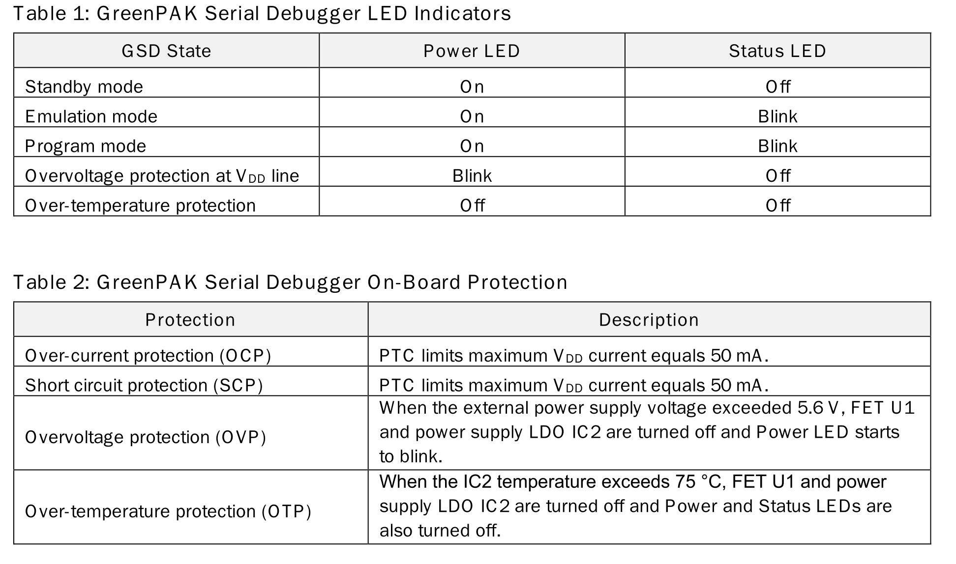

    There is also two tables that show how the GSD LED indicators and protection features works.
    OVP and OTP is most likely handled by the PowerPAK with ACMPs and the internal temperature sensor. Some things is a bit confusing here power supply LDO IC2? FET U1? The FET is U4 in the schematic and PowerPak U5, was this...
