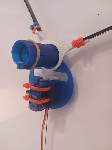

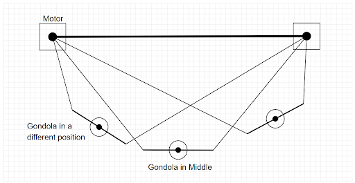

Looking closer at the gondola and you might notice that the belts are not directly attached.
This is because the marker needs to be at the actual centerpoint of the two belts. The two white arms rotate around the blue cylinder. (The blue cylinder is where the marker slides in.) In some plotter designs, this feature is ignored and the belts are directly mounted to the gondola. This creates a problem where the marker won’t be in the expected position. The Gondola will tilt as you move it around so that the weight is always in the lowest possible position. You can see this in the image below.

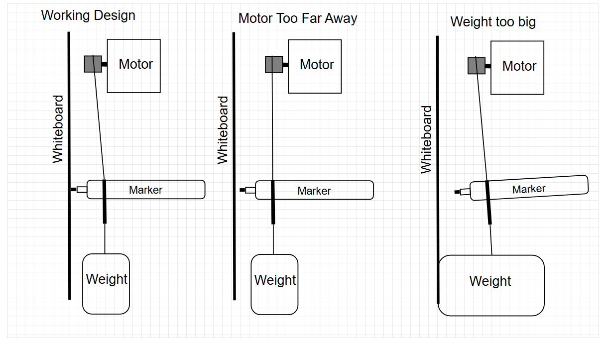

Another consideration with a polar plotter is the marker pressure. In order for the marker to actually touch the drawing surface, the marker needs to push the gondola away from the surface. Consider the sideways view below. If the weight is too big, or the motor is too far away, the marker will just hang in midair and won’t touch the board.

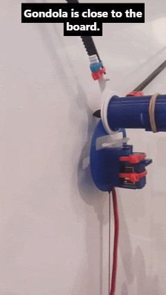

Another mechanical consideration is that the marker can tilt. The further the gondola is from the whiteboard, the more the marker can shake as the plotter moves around and plots. This means the gondola needs to be as close to the whiteboard as possible. Bigger arms will help with this a little bit too. You can see this happen in the gif below.
