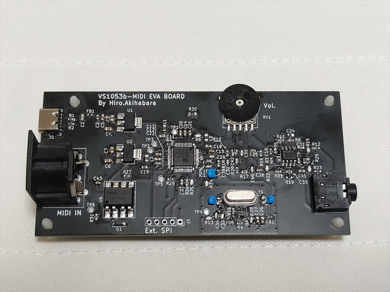

MIDI IN
The MIDI signal is processed by a standard MIDI input circuit, where the signal from the MIDI connector is isolated using a photo-coupler and then connected to the UART RX pin of the VS1053b chip.

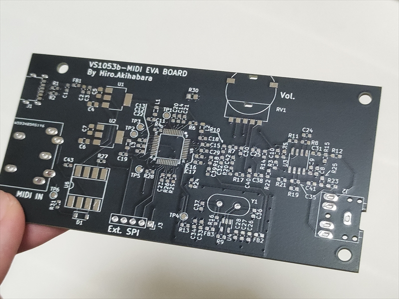

PCB
Thanks to the PCBWay, I was able to produce high-quality circuit boards quickly this time.
The circuit board arrived in Japan about a week after I placed the order.
The delivery time was short, and the matte black solder resist we specified turned out beautifully.
I was satisfied with the quality.

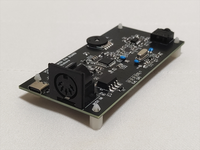

After I received the PCB, I manually soldered the components onto the PCB.
