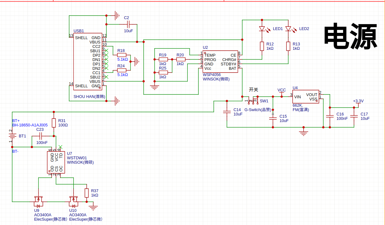

4. Hardware Part
The power supply part uses 18650 batteries for power supply, with DW01 protection and 4056 charging functions. SW1 serves as the main power switch of the entire device. U4 converts the voltage to 3.3V. The maximum power consumption does not exceed 40mA when the clips are short-circuited.

- DW01: A typical lithium battery protection IC, used to prevent overcharging, over-discharging, and short-circuiting of the battery.
- 4056: Refers to chips like TP4056, a common lithium battery charging management IC, supporting constant-current and constant-voltage charging.
