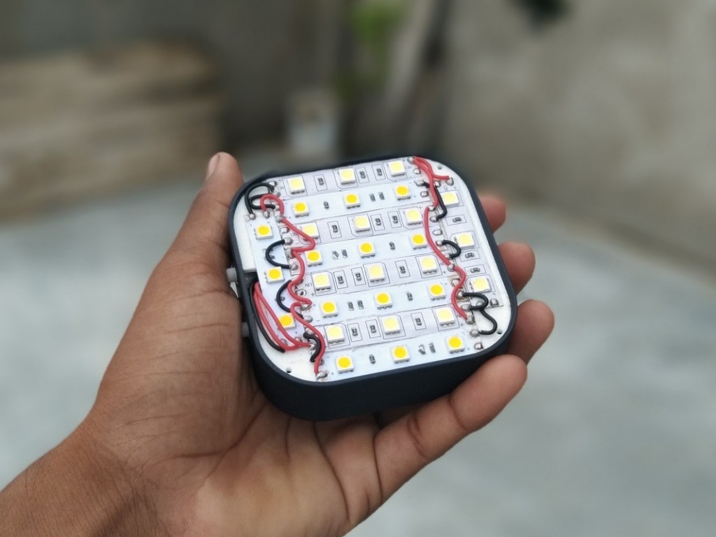

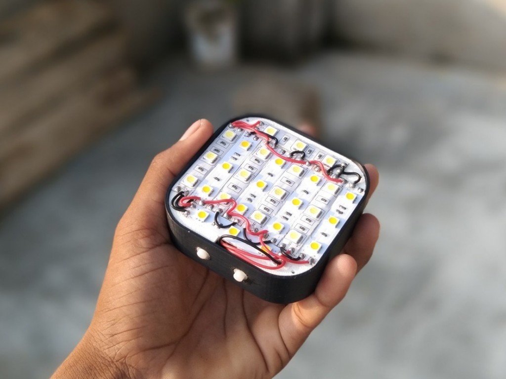

2Strip Light Assembly

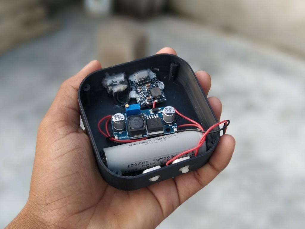

Begin by preparing the 3D-printed cover for the strip light installation. First, measure the length of the cover and cut both the cool white and warm white LED strips to the required size. Once the strips are ready, peel off the adhesive backing and carefully press them onto the cover. For a more balanced and natural lighting effect, I arranged the strips alternately—starting with cool white, then warm white, followed again by cool white and warm white. This alternating pattern helps create an even and pleasant color combination.

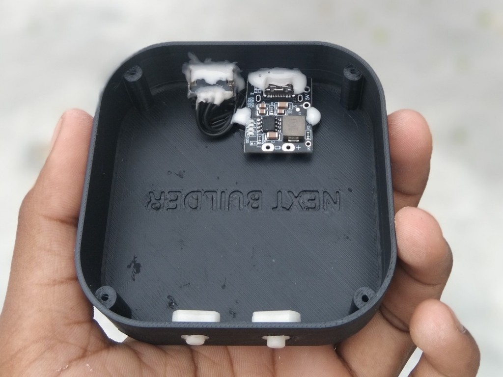

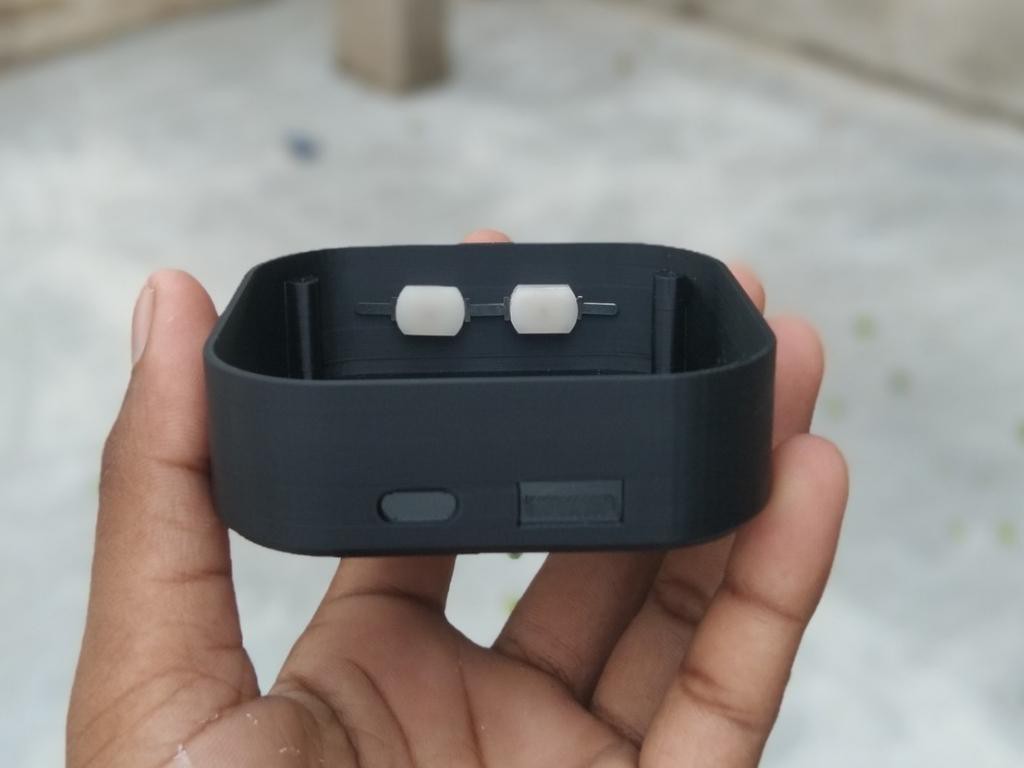

3Switch Assembly
On the opposite side of the housing, you’ll notice two small holes designed for switches. I used two locking-type push switches here—one to control the cool white LED strip and the other to control the warm white LED strip. To assemble them, simply insert each switch into its slot and apply a very small amount of T-7000 glue to hold them in place. Be careful not to use too much glue, as excess adhesive could damage the switches or make them difficult to operate.

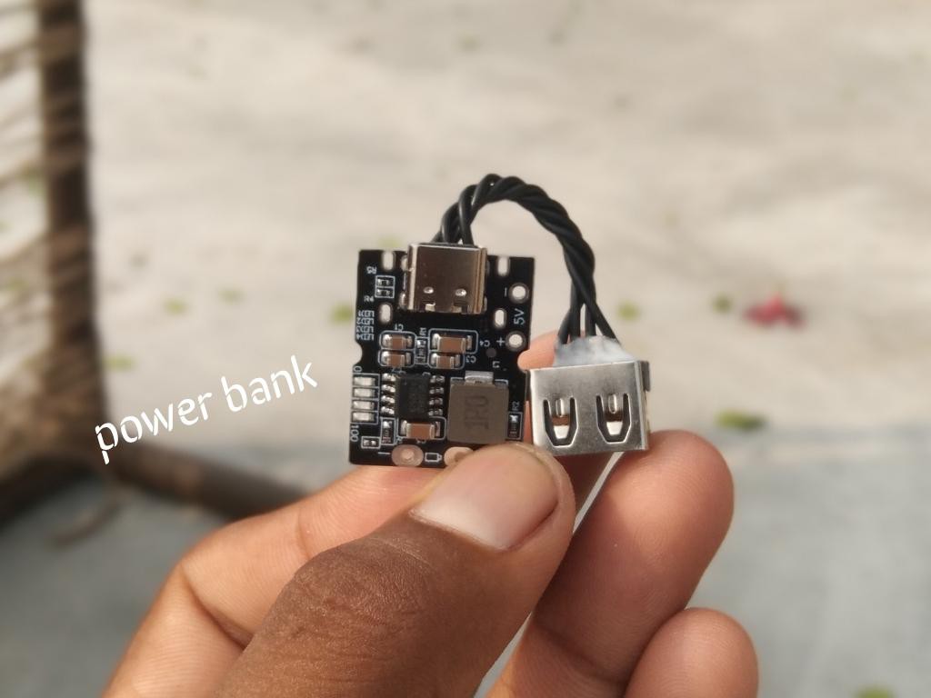

4Power Bank Module Assembly

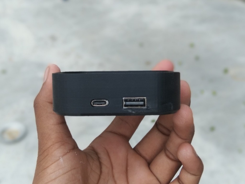

The power bank module I’m using comes with good features, but the module and the USB port are separate, which means they need to be soldered manually. To do this, I cut four short pieces of 28 AWG silicone wire and soldered them between the power bank module and the USB port. Once the soldering was complete, I placed both components into their respective cutouts inside the 3D-printed housing, making sure they were properly aligned for use. To secure them in place, I applied a small amount of T-7000 glue to fix the USB port. The power bank module can normally be fastened with two small screws, but since I didn’t have the right size available, I also used T-7000 glue for this part. After everything was set in position, I left it aside to dry completely.

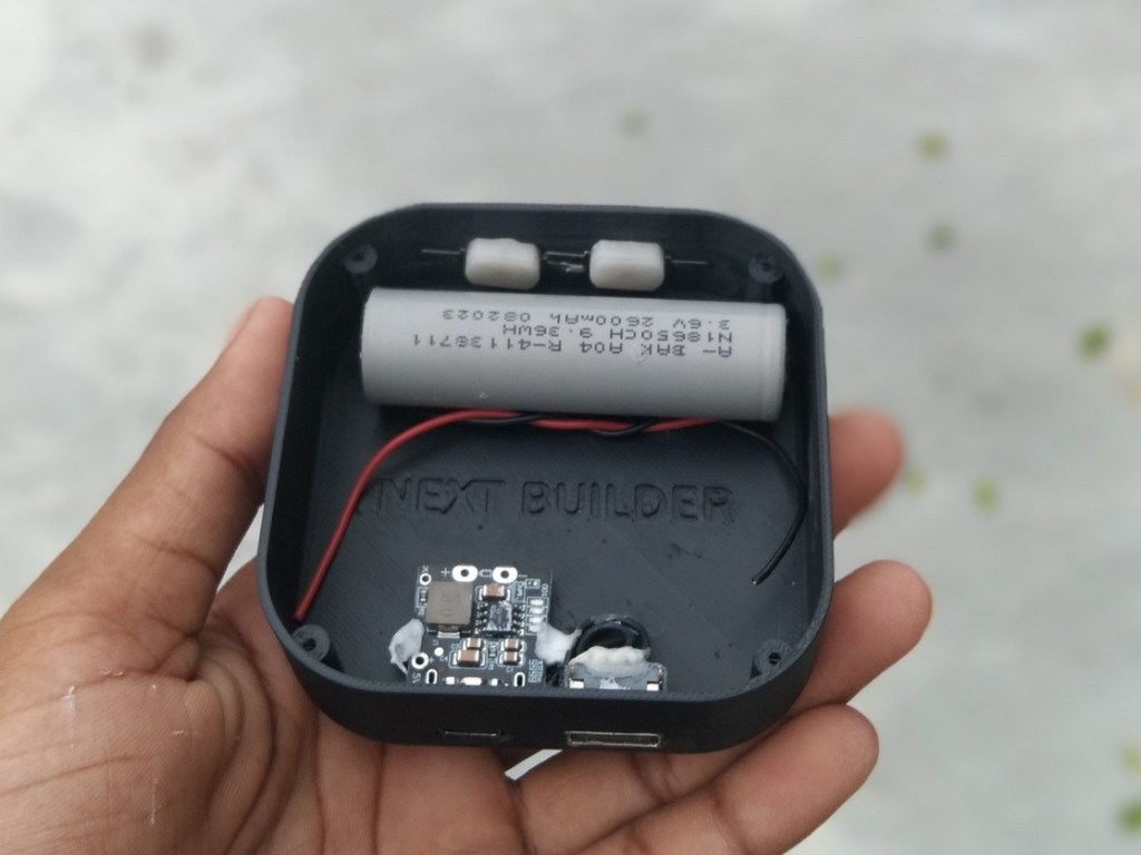

5Battery Assembly

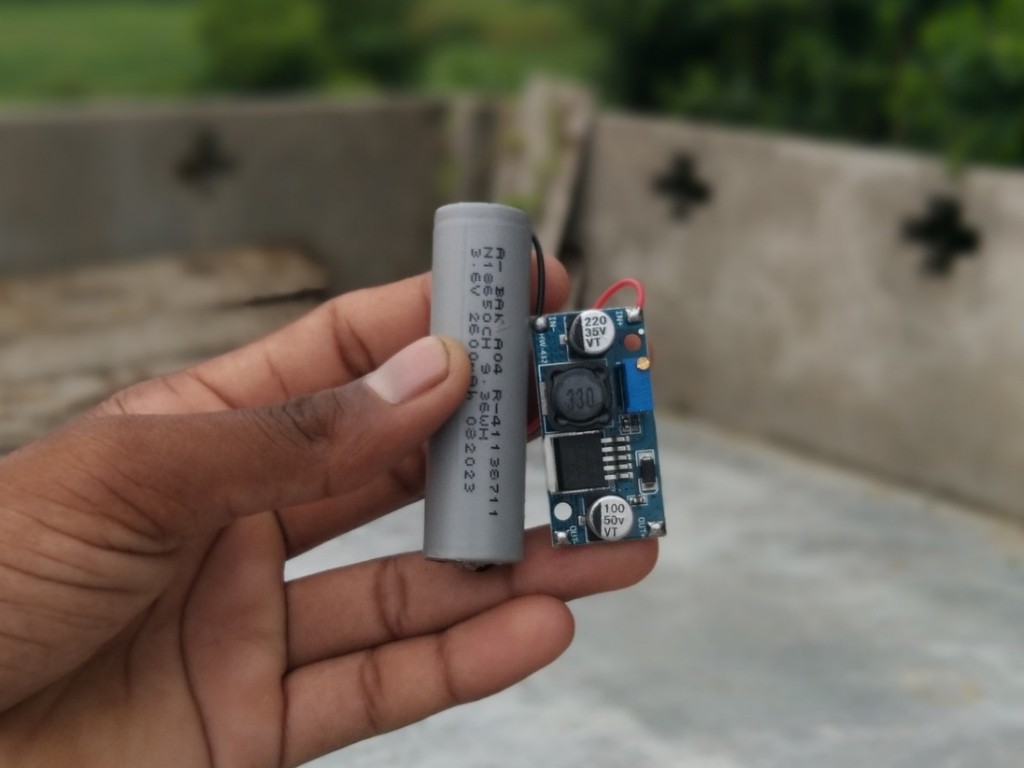

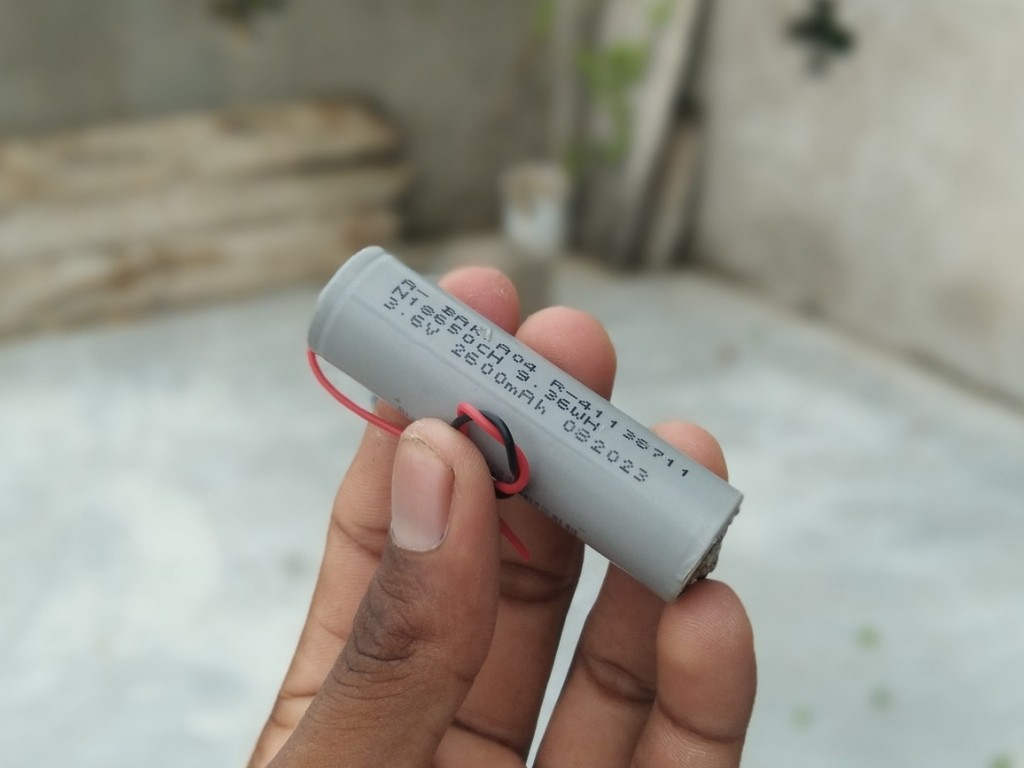

Since there isn’t a dedicated compartment for the battery, I placed it neatly along the side of the housing. To secure it, I first used double-sided tape to hold the battery in position, then applied a thin layer of T-7000 glue for extra strength. After fixing it in place, I left it to dry completely for better results.
6Buck Booster Module Assembly

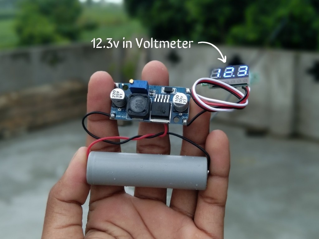

Just like the battery, there isn’t a dedicated compartment for the XL6009 step-up buck booster module. Before assemble it, simply fix the voltage to 12v by rotating the Potentiometer of xl6009 to clockwise, once done! I placed the module in an empty space inside the housing and applied a small amount of T-7000 glue to secure it. This keeps the module firmly in place without taking up much space.

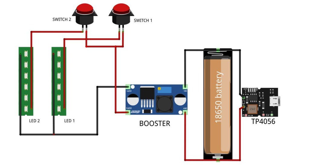

7Connection Diagram
Now it’s time to wire everything together. The 18650 battery is first connected to the TP4056 charging module (stands for power bank module) —positive to B+ and negative to B-. From the TP4056, the battery also connects to the input of the XL6009 buck booster module, with the positive lead going to IN+ and the negative lead to IN-.
The output of the booster module (OUT+ and OUT-) is then used to power the LED strips. To control them individually, I added two locking-type push switches. Switch 1 is wired in series with the first LED strip, while Switch 2 is wired in series with the second LED strip. Both switches take their power from the booster’s positive output, and the negative lines of both LED strips are connected back to the booster’s negative output. The booster ensures they always receive a stable voltage from the 18650 battery.

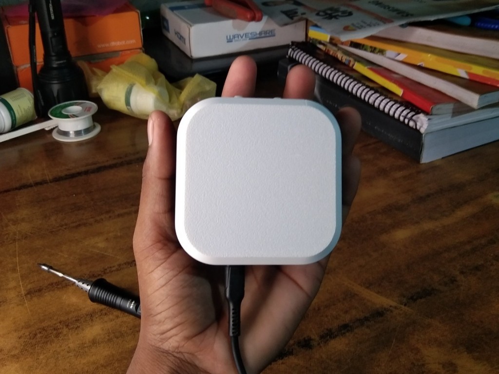

9Diffuser Assembly
With the cover securely in place, the final step is to assemble the diffuser. The diffuser plays a very important role—it softens and evenly spreads the light from the LED strips, preventing harsh glare and creating a smooth, comfortable glow. Without it, the light would appear too sharp and uneven.
To attach the diffuser, apply a very small amount of super glue along its edges and carefully position it over the housing. Hold it gently for a moment to ensure it sets properly, and allow the glue to dry completely.

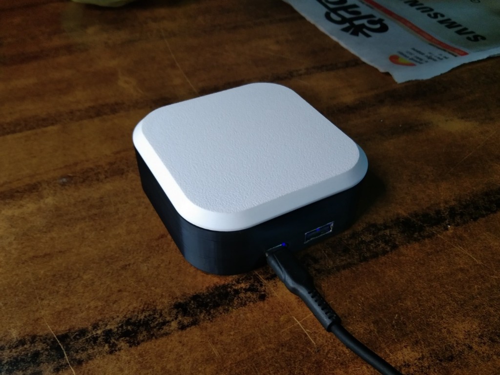

10Full Charging
Before testing the Pocket Glow, make sure to fully charge the battery. A complete charge not only ensures maximum runtime but also helps maintain the health of the battery in the long run. Connect the charging cable to the USB port of the power bank module and wait until the indicator shows that charging is complete.
Once the battery is fully charged and everything is secured, your Pocket Glow is ready for its first test.
