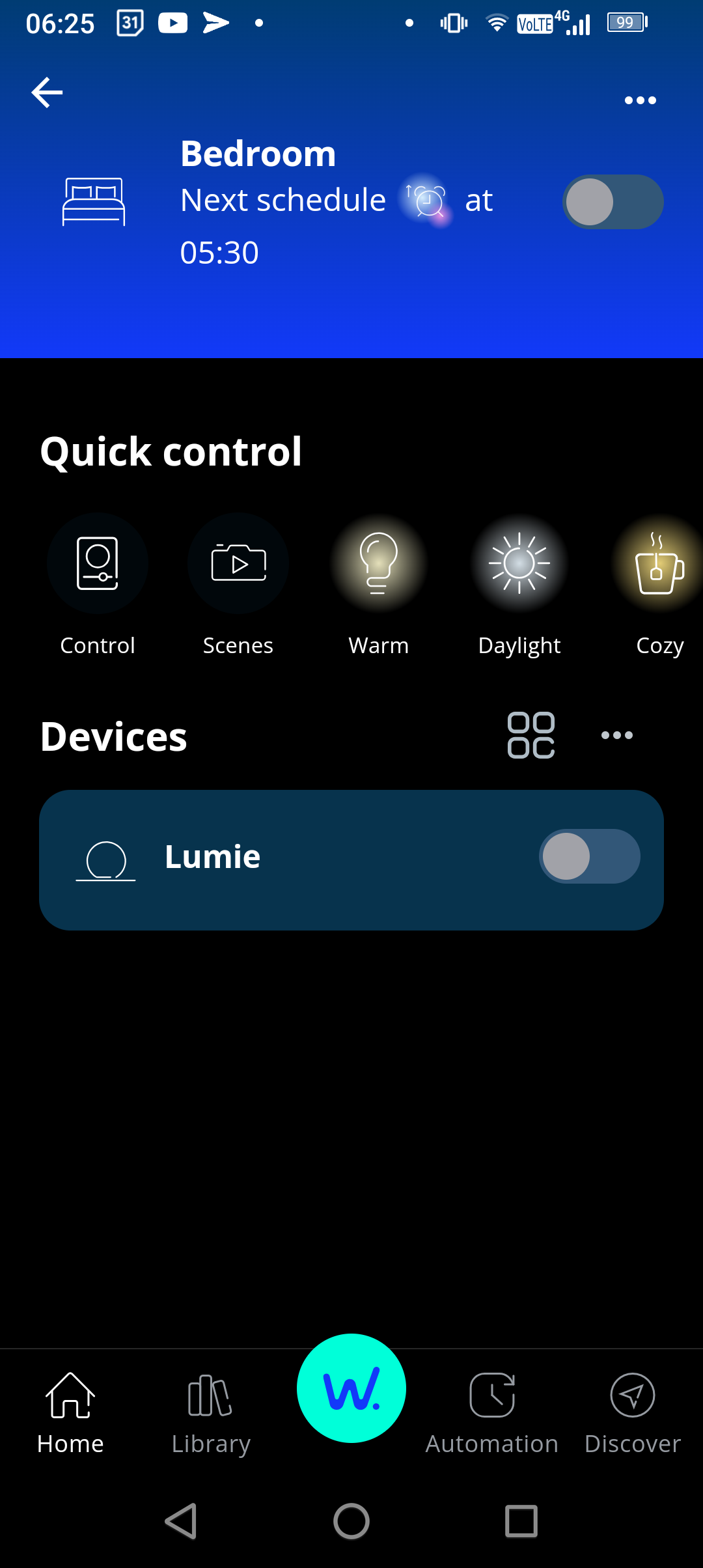

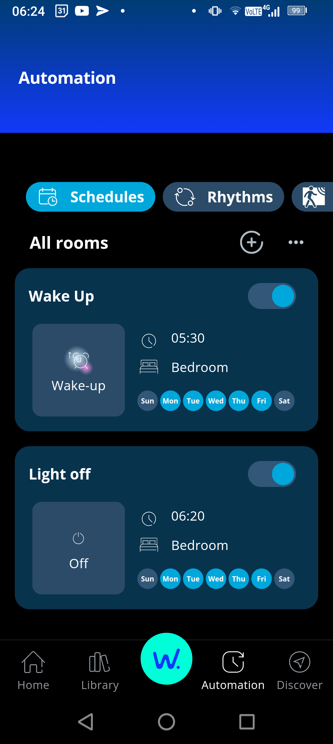

7Set up the new bulb on your phone
I set up the app like this:
