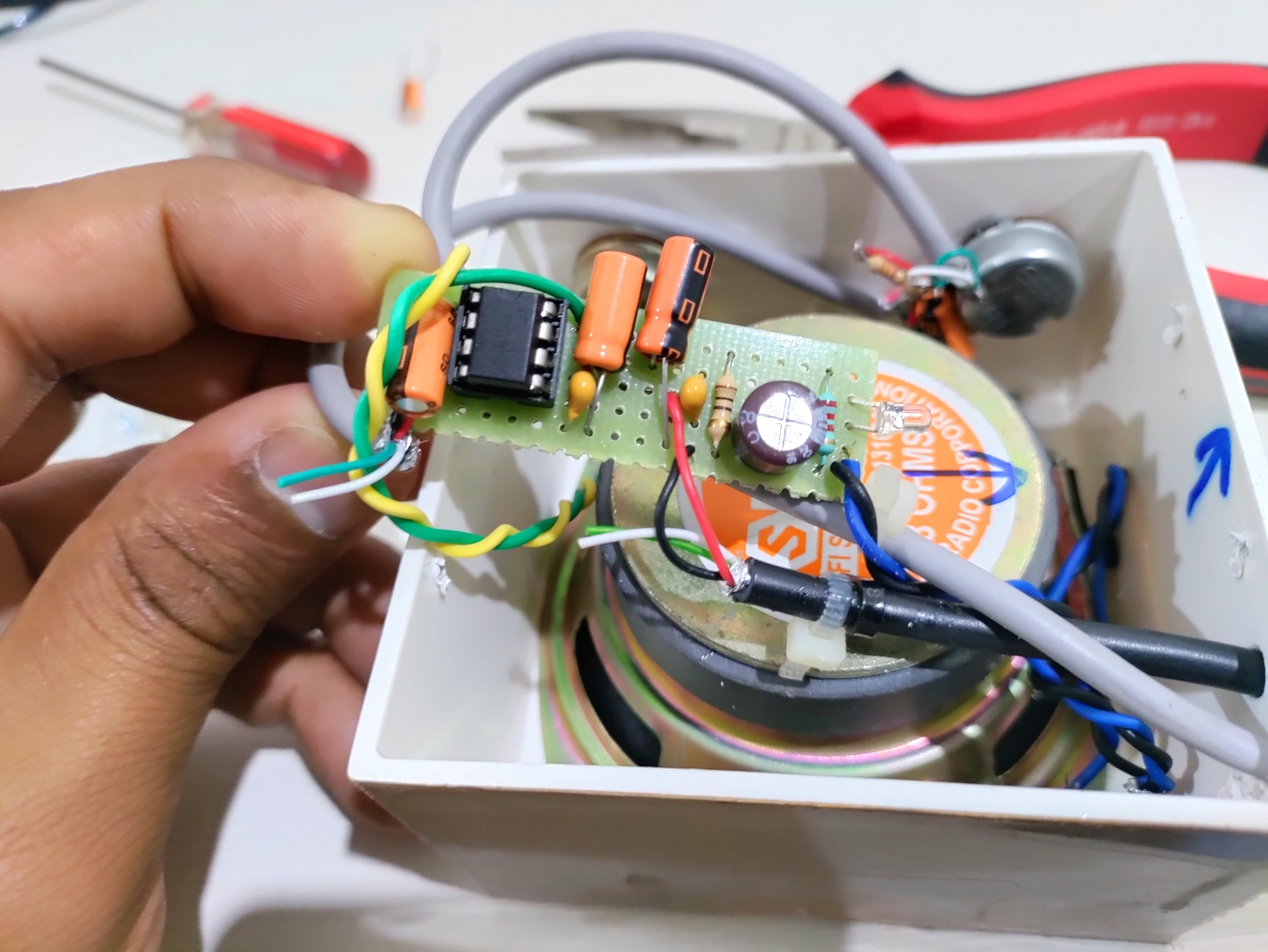

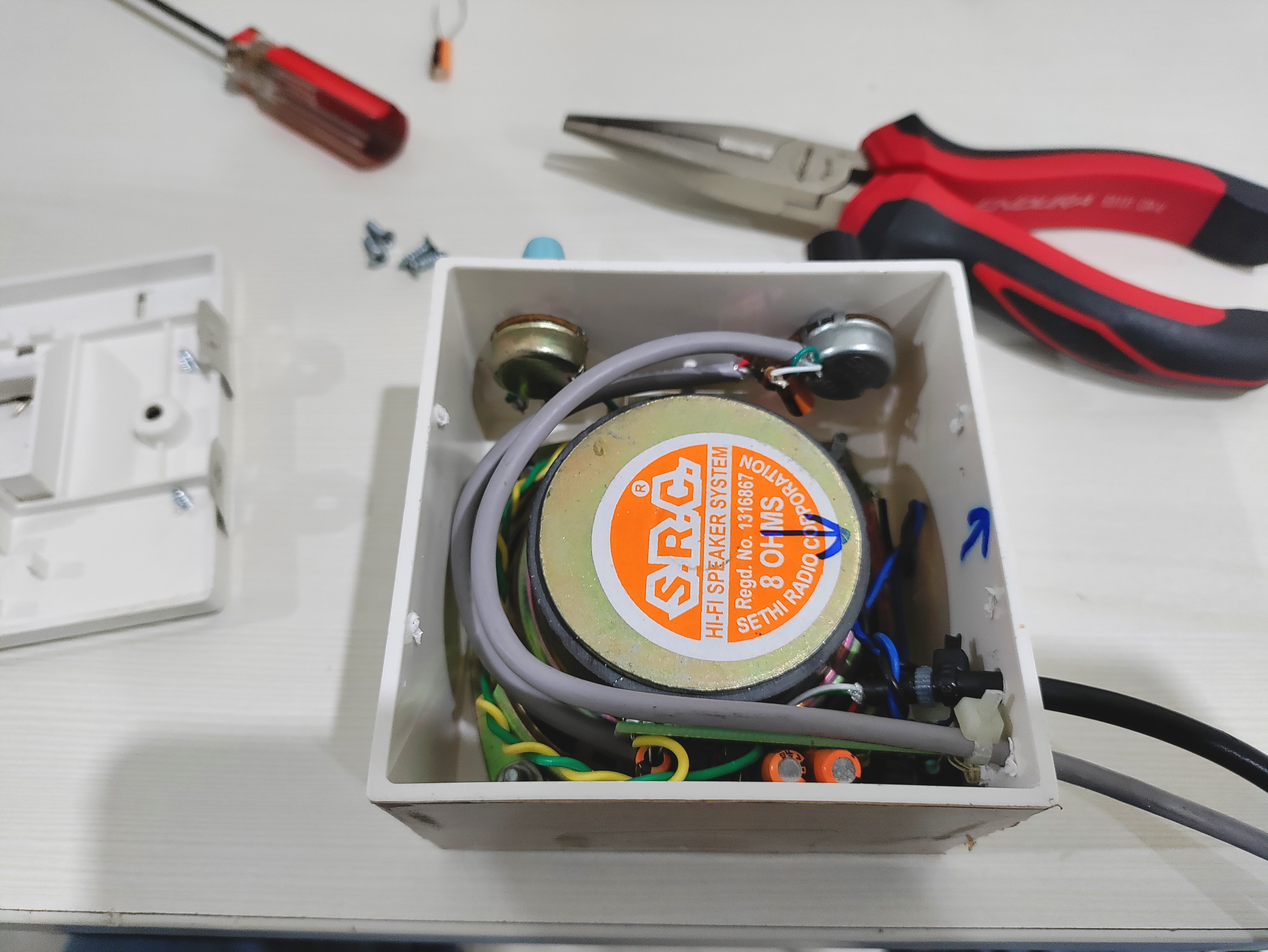

It is a USB powered speaker for laptop/desktop. It is working based on the amplifier IC LM386 which is widely available in the market. The entire circuit fitted in a small box to make it beautiful. It contain a volume control knob and a gain control knob for easy interface. Power led indicating the status.
