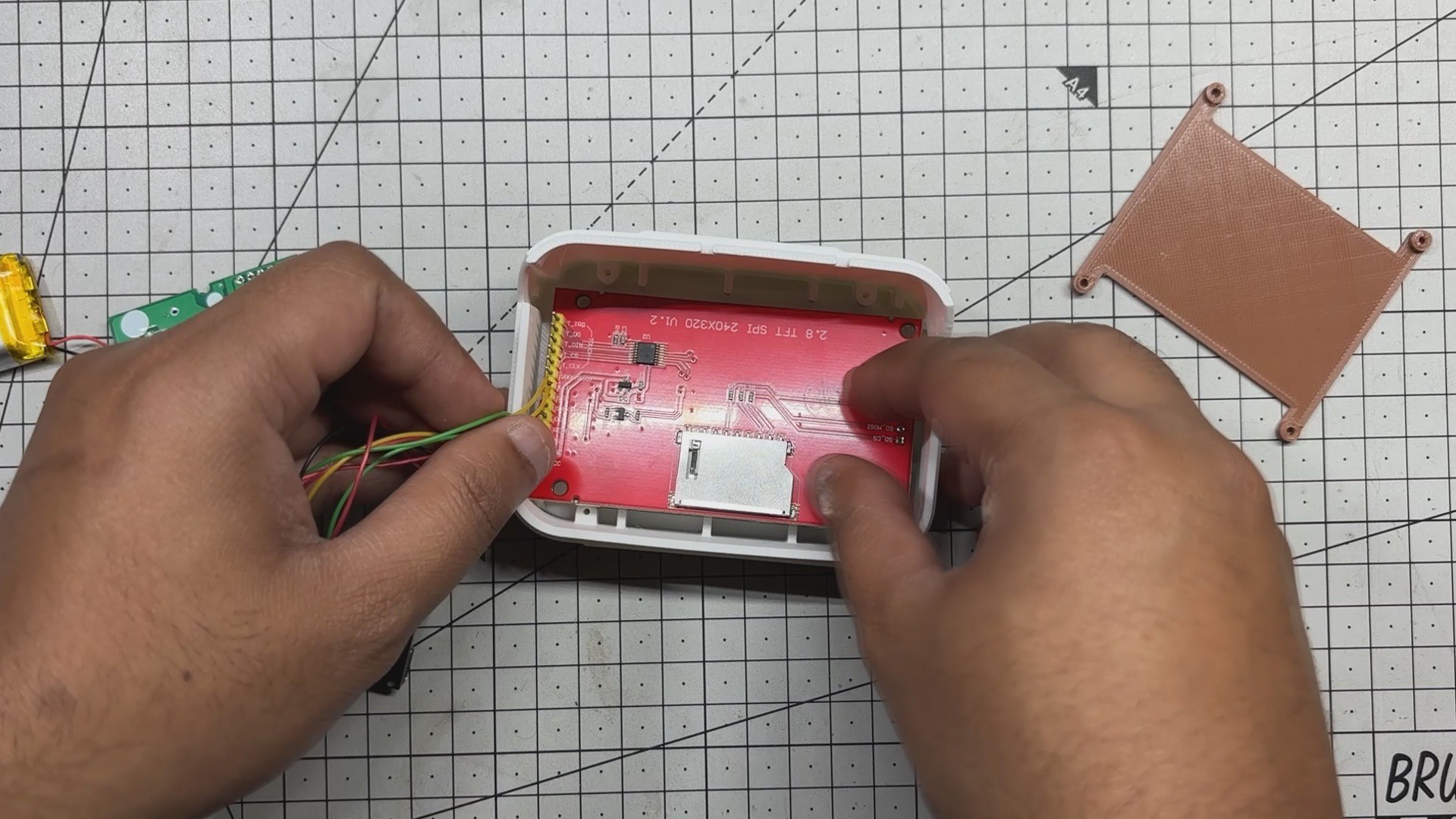

4Front Enclosure—Screen Assembly

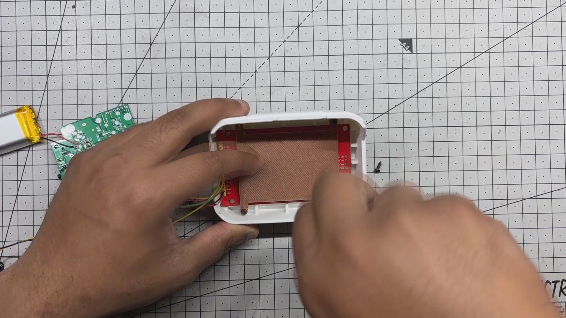

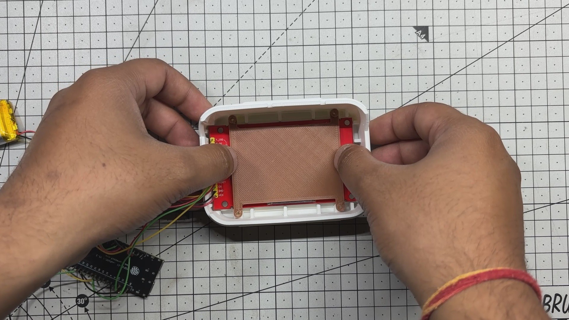

- The front enclosure assembly begins with positioning the ILI9341 display into its designated mounting slot.
- Once aligned, we secure it using a holding plate, which is fastened with four M2 screws. This plate ensures the display remains firmly in place and properly seated within the enclosure.

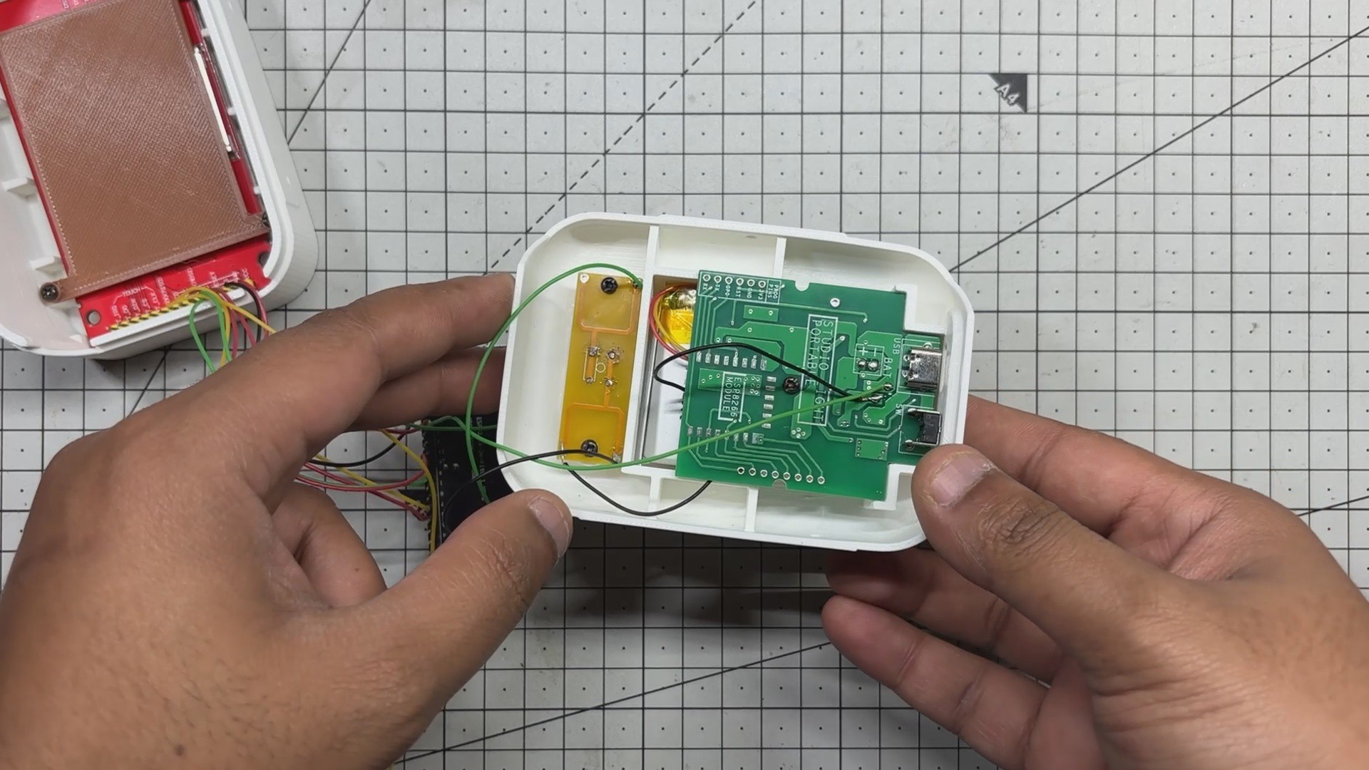

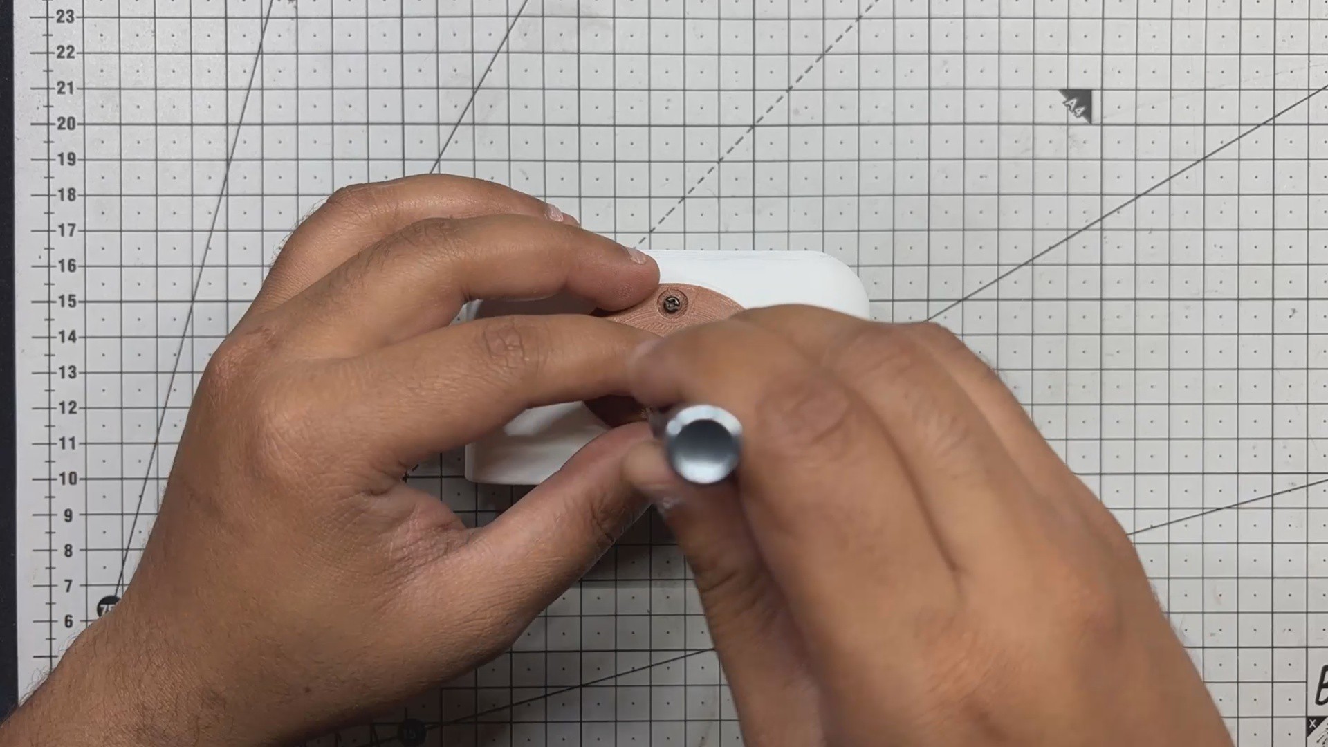

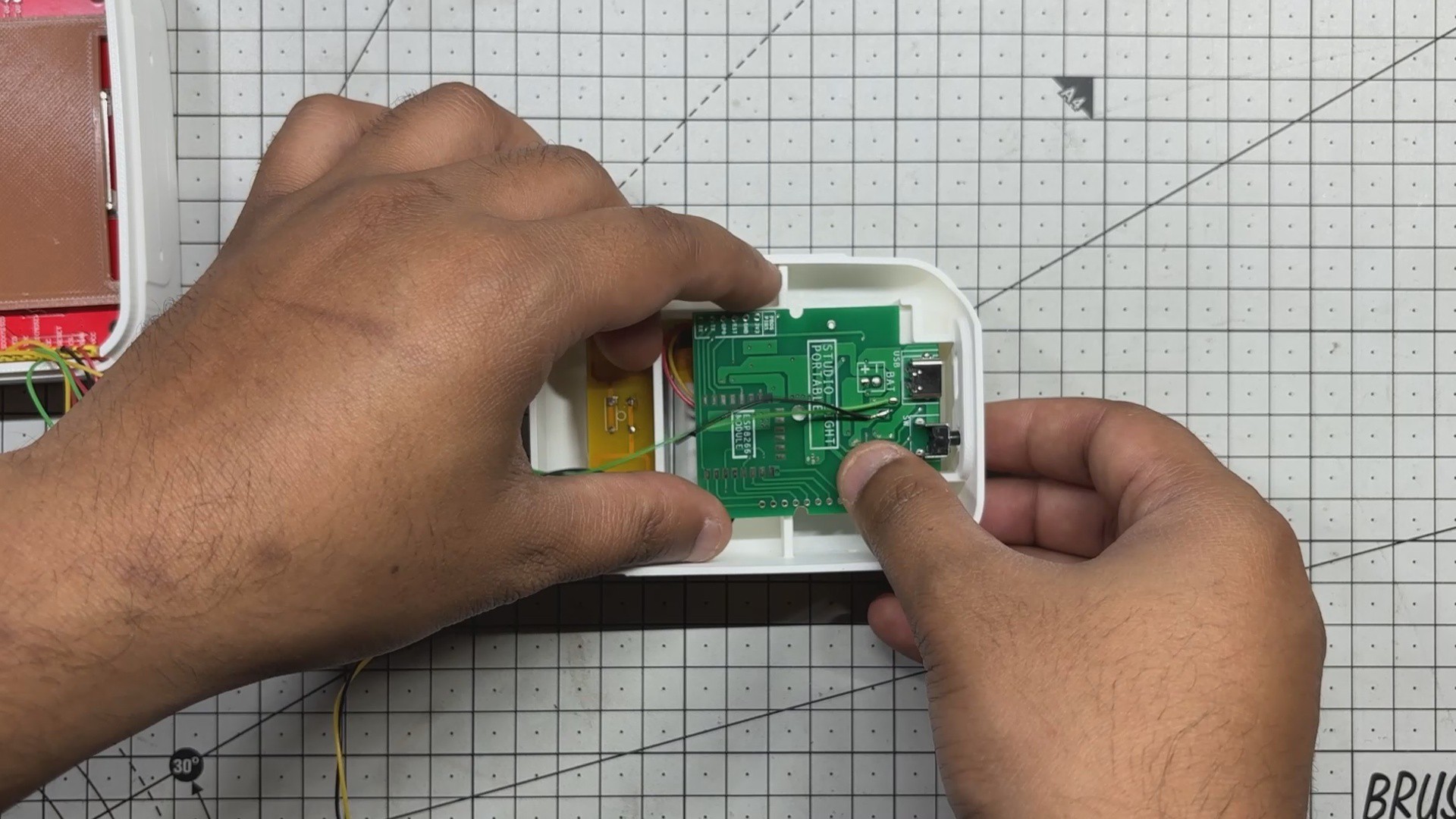

5Back Enclosure—Power Circuit and Switch Assembly
The back enclosure assembly begins with inserting the switch actuator into its designated slot. Once in place, the button PCB is positioned directly above it and secured using two M2 screws, ensuring the actuator can reliably press the onboard push button when triggered.

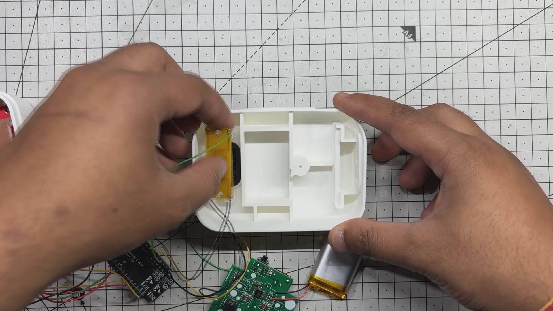

Next, the LiPo cell is carefully placed into its allocated compartment. The power circuit is then aligned over its central mounting boss and fastened with a single M2 screw. This not only secures the board but also holds the LiPo cell firmly in position beneath it, completing the internal layout of the rear section.

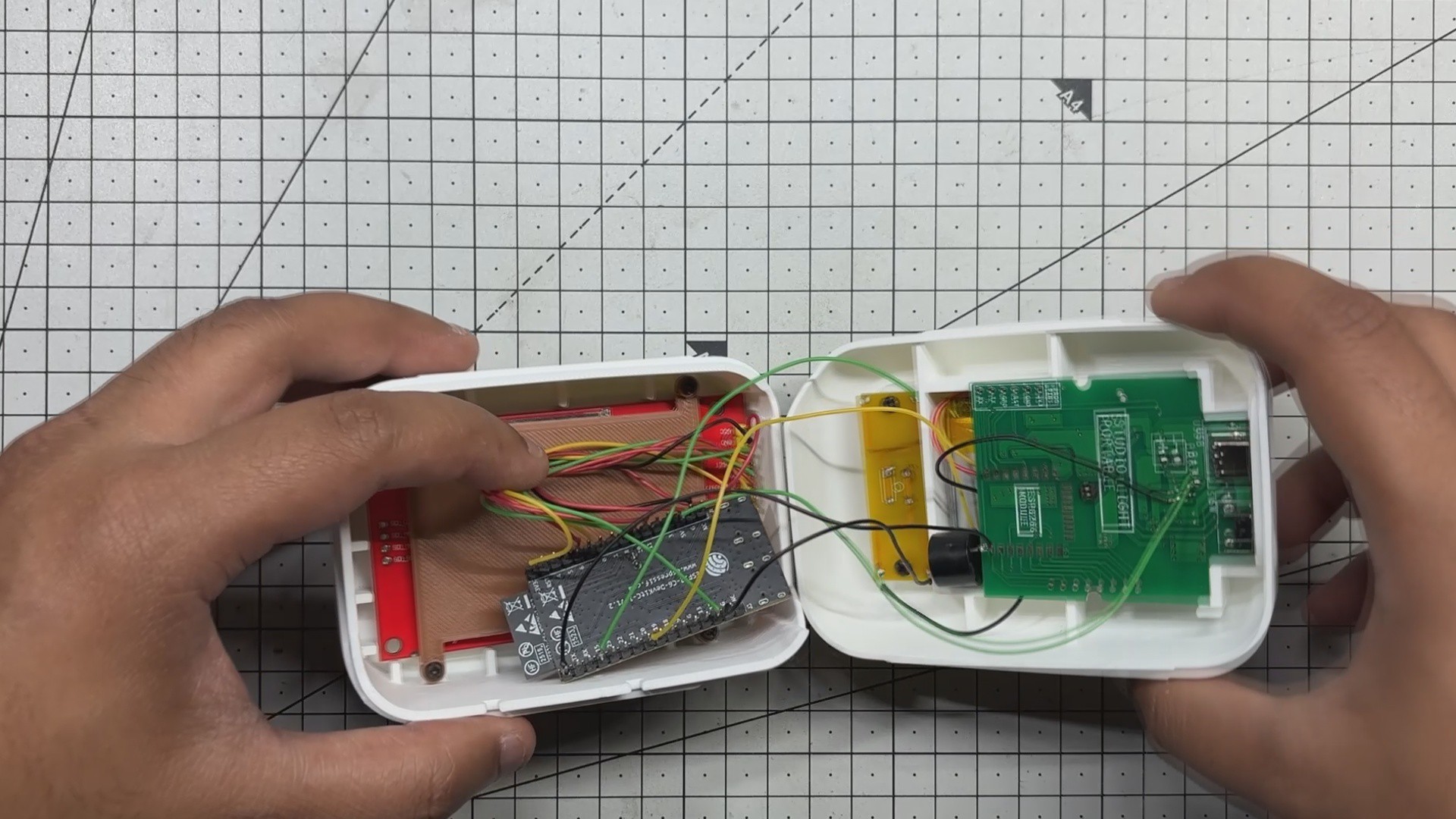

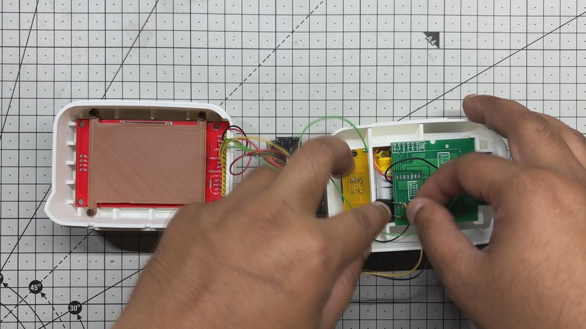

6Final Assembly

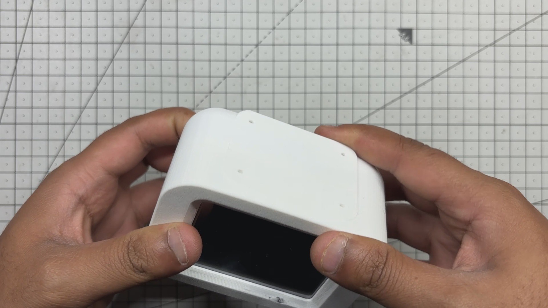

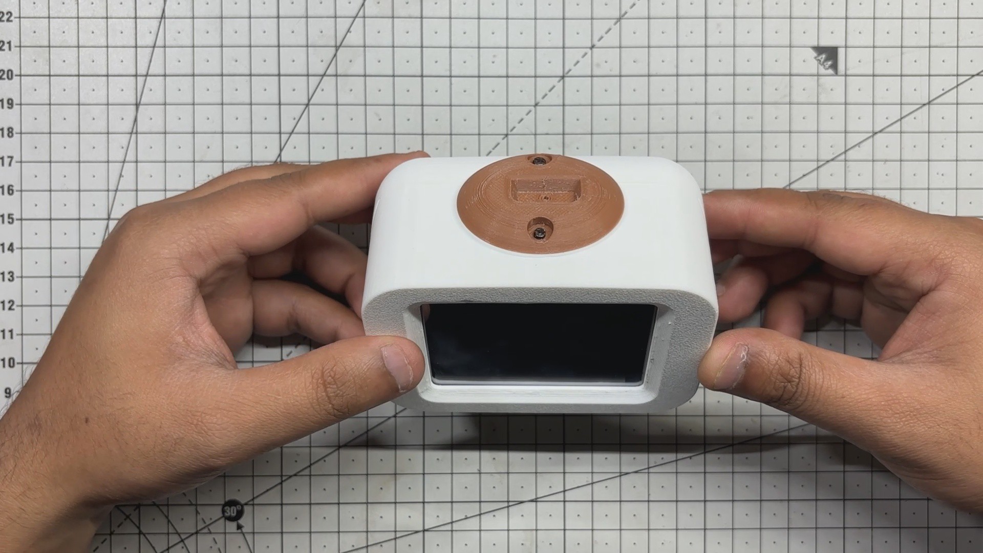

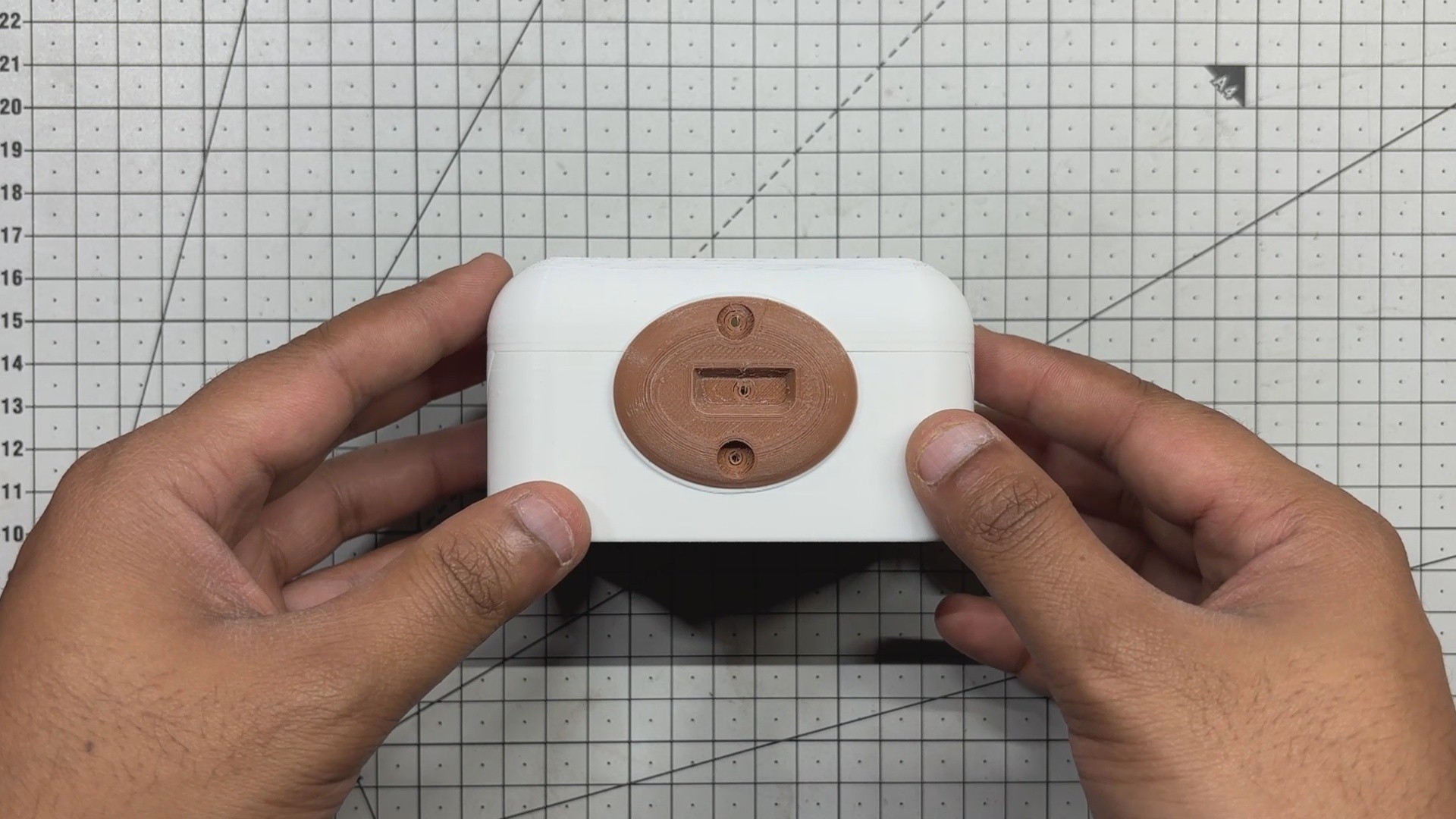

- Assembly starts by placing the buzzer in its designated spot. Next, the ESP32-C6 Devkit is mounted onto the screen holder, and the front and back sections of the enclosure are closed together.
- The antenna holder is then positioned on top, aligned with the parting line, and secured using two M2 screws, locking all three sections firmly in place.

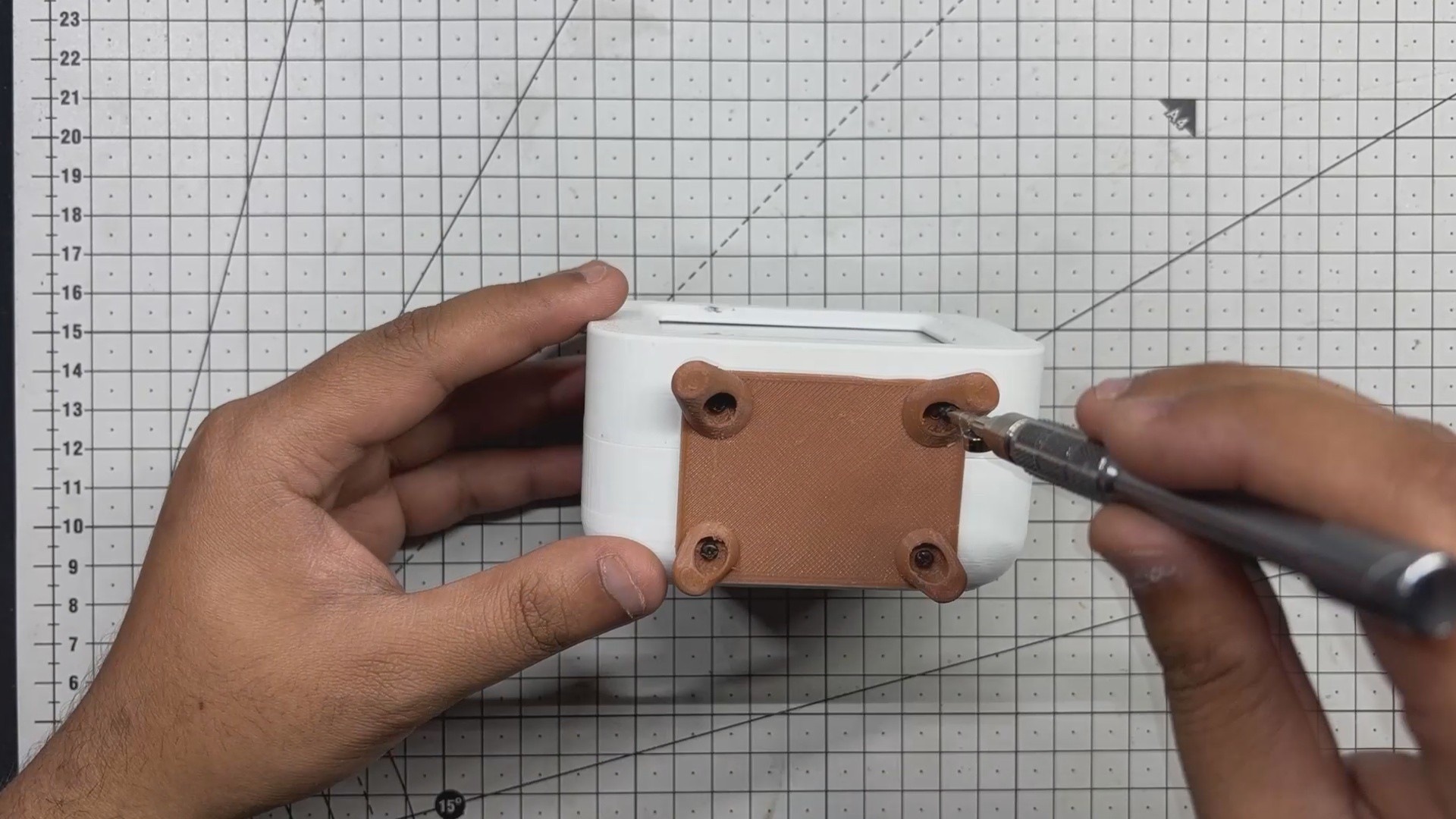

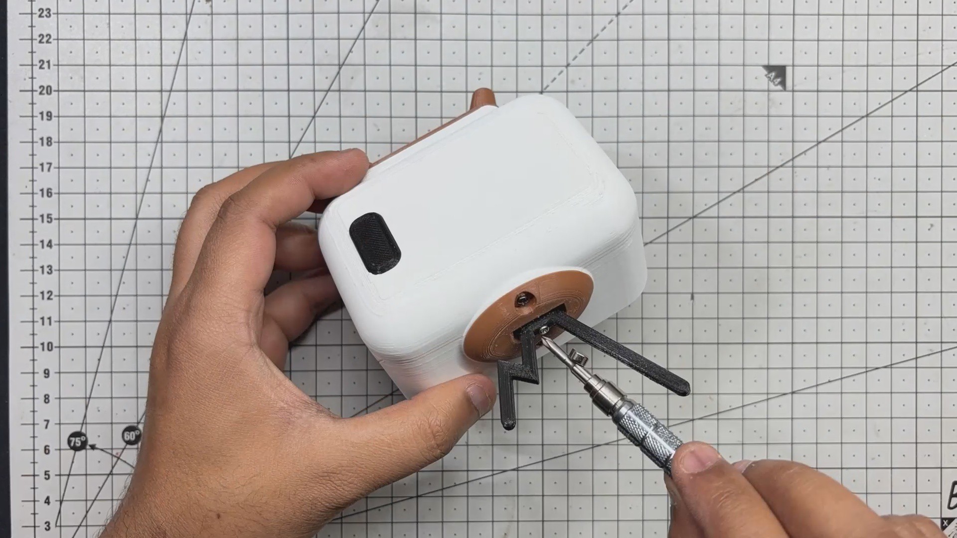

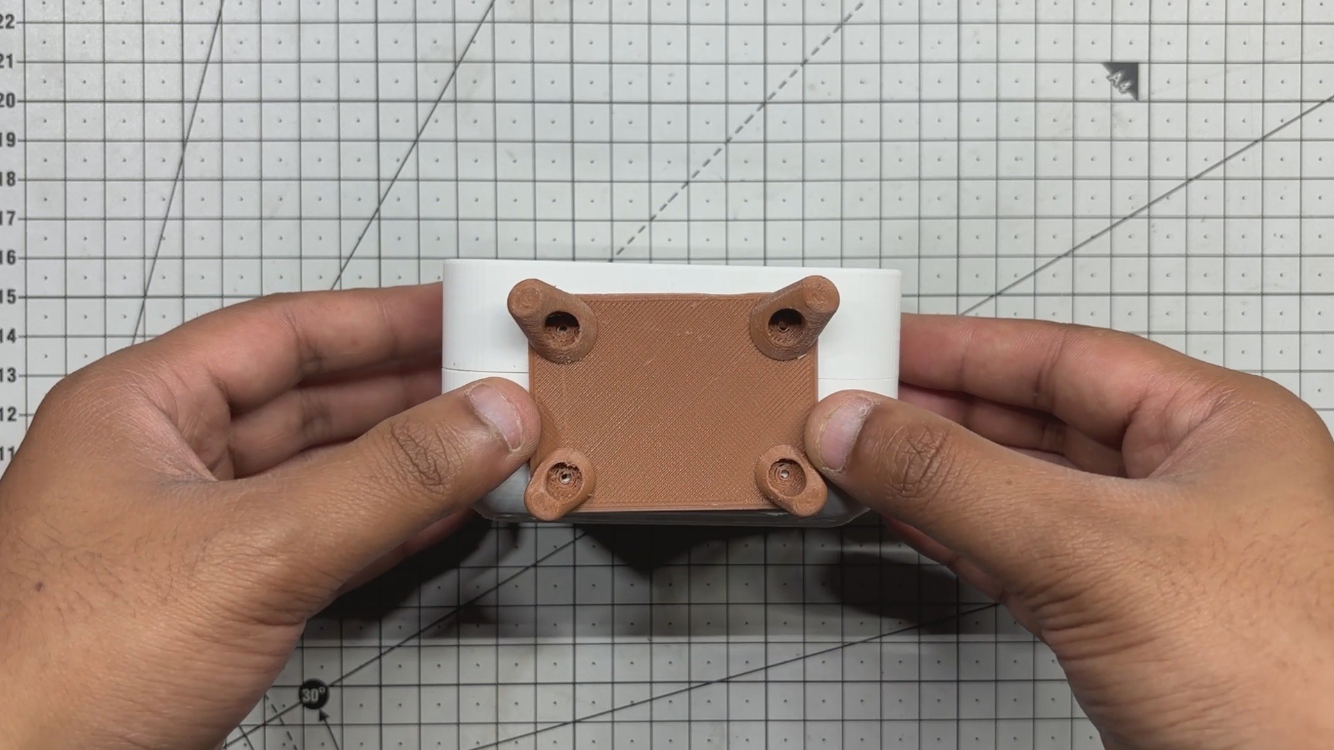

- From the bottom, the stand is attached and fastened with four M2 screws. Like the antenna holder, the stand also reinforces the connection between the front and back halves.

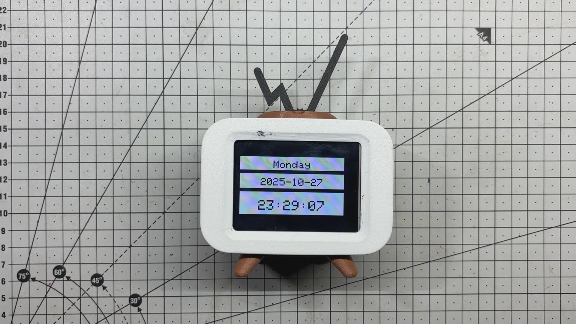

- Finally, the antenna is mounted onto the holder and secured with a single M2 screw. With that, the full assembly is complete.

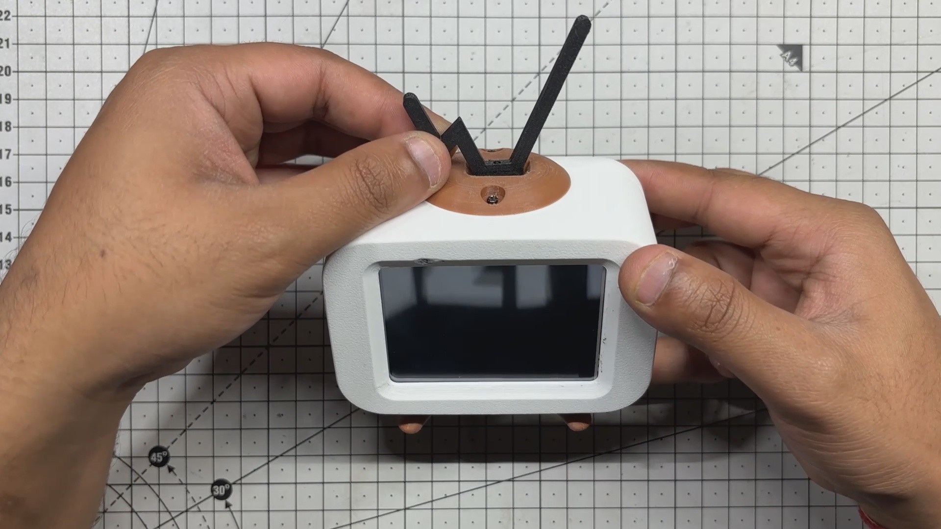

7Result
End Result of this build is a fully functional hybrid that doubles as a desk clock and a Snake game console. It fetches real-time data over WiFi and seamlessly switches into game mode, controlled via an Xbox controller paired over BLE. The ESP32-C6 handles everything smoothly, delivering reliable performance throughout.
Powered by a 3.7V 600mAh LiPo cell, the setup offers a solid 6–7 hours of backup, which is reasonable given the power demands of the ILI9341 display. For future iterations, switching to an E Ink display could drastically cut power consumption and extend battery life, which is a promising upgrade for long-term use.

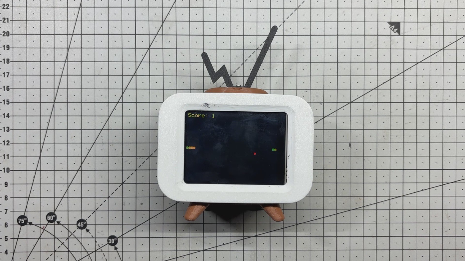

8Clock and Gaming
By pressing the Back switch, the desk clock seamlessly transforms into a Snake game console. Once the Xbox controller is powered on, it automatically pairs with the ESP32-C6 via Bluetooth Low Energy (BLE), allowing instant gameplay using the left joystick.
As the snake consumes each food dot, the score counter increases and the snake grows progressively longer. If the player accidentally collides with the snake’s own body, the game ends and the score resets, just like the classic rules.
When you're done playing, a simple press of the same switch reverts the setup back to its original clock mode, making the transition between timekeeping and gaming smooth and intuitive.
