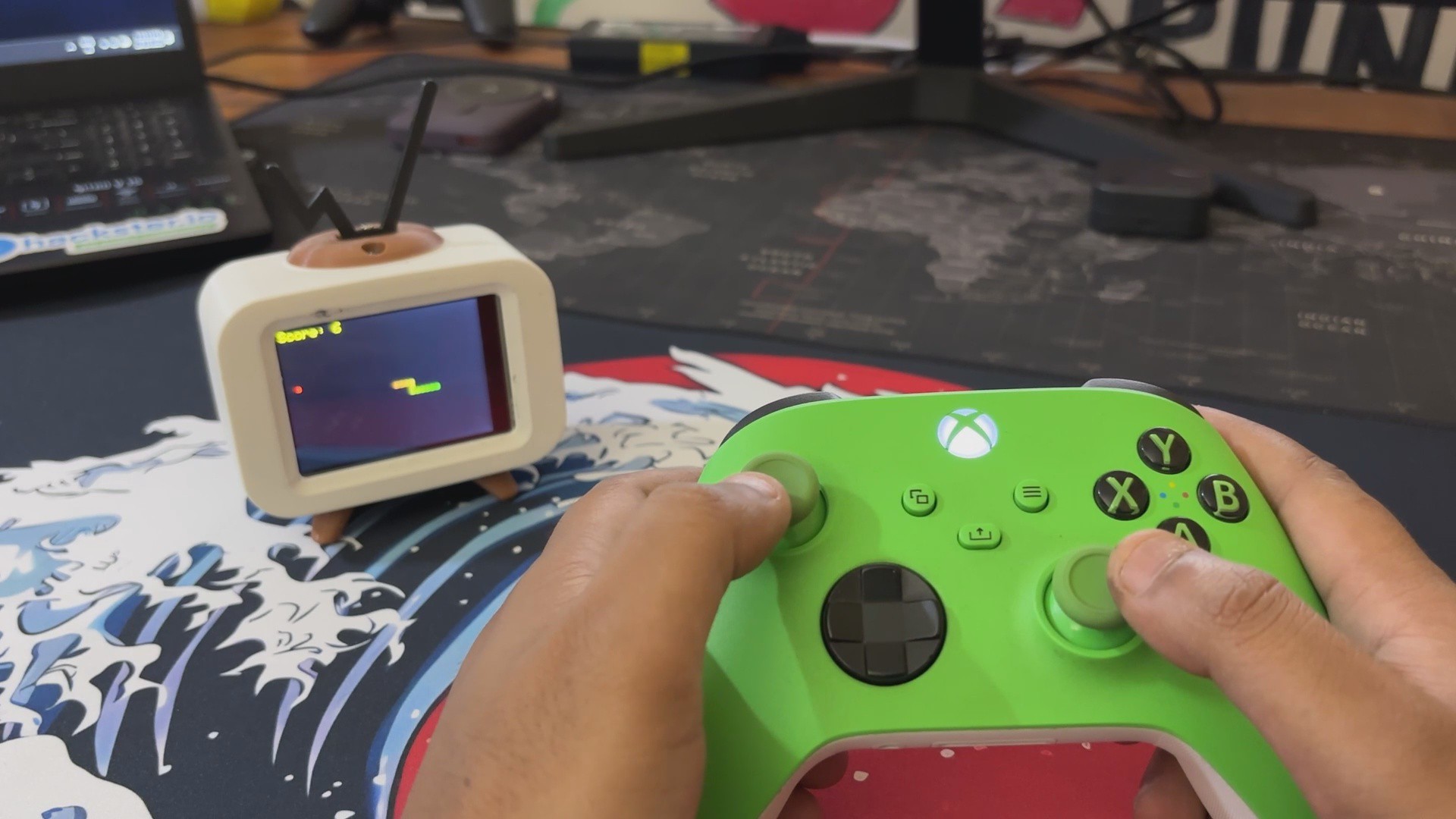

Greetings everyone and welcome back. Time for something truly unique, meet Serpentime, a hybrid between a digital clock and a retro Snake game console, housed in an enclosure styled like a television set from the 1980s.
Serpentime is a compact, dual-mode creation that blends the utility of a digital clock with the charm of a retro Snake game console. With a single button press, it shifts from timekeeper to game machine, powered by an Xbox controller for a surprisingly immersive experience.

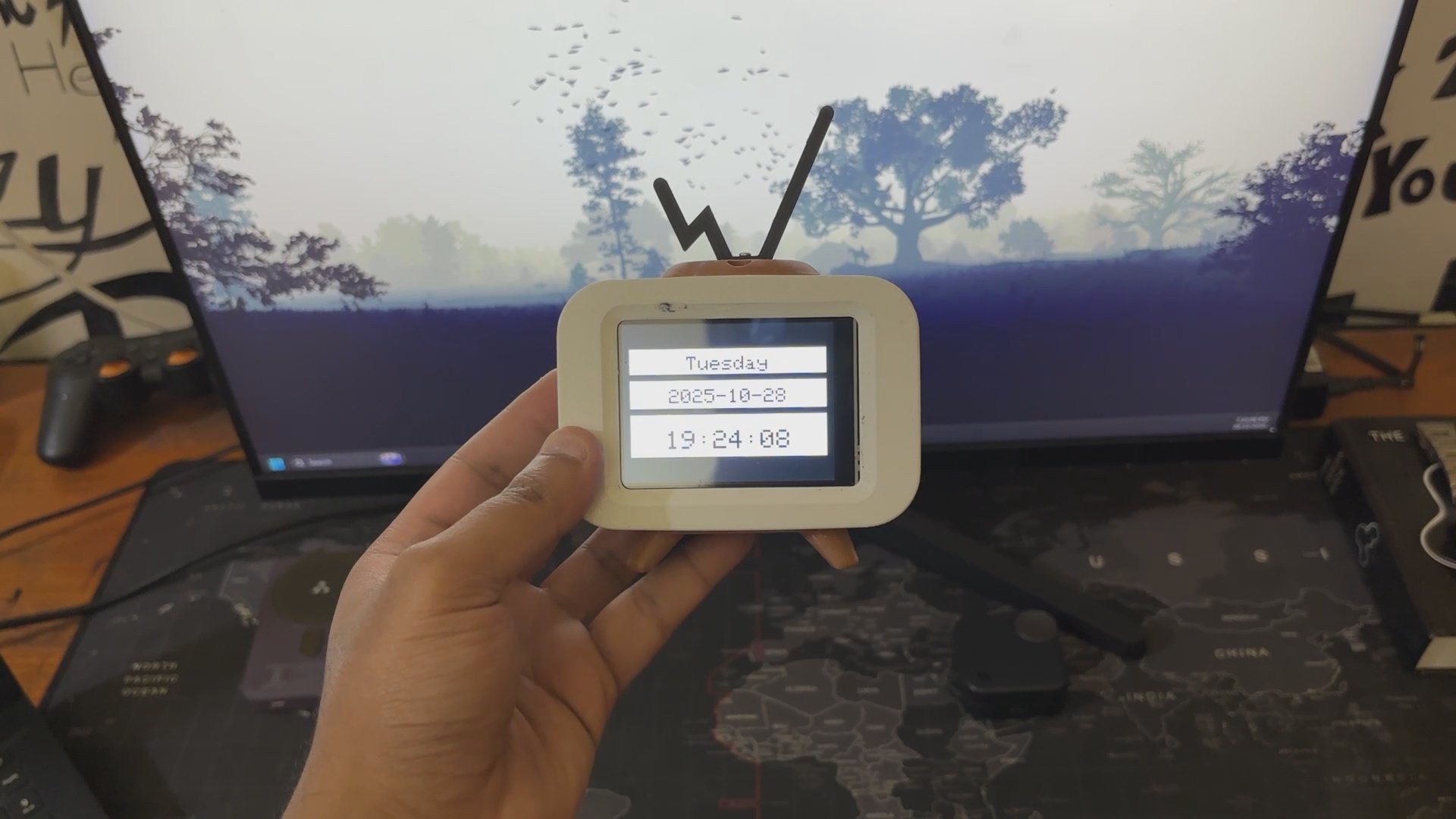

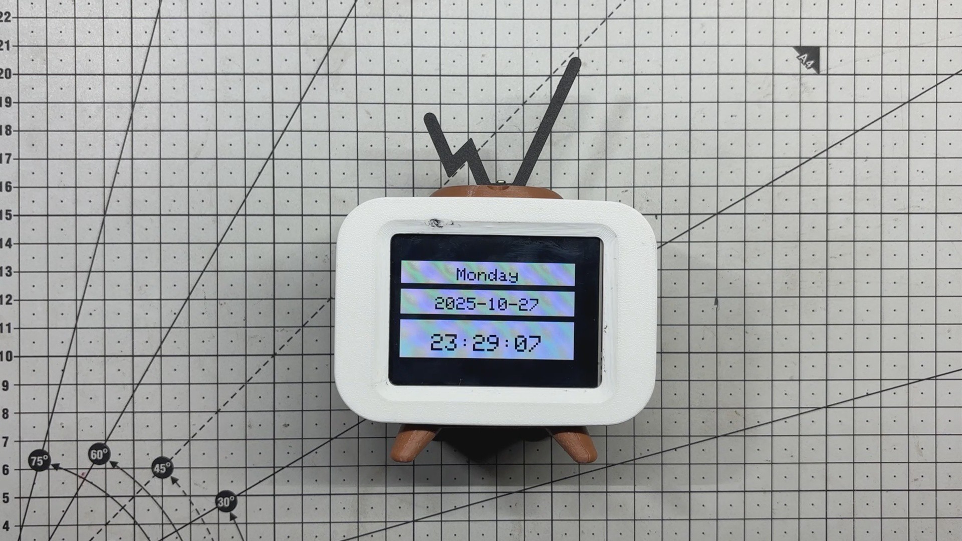

In clock mode, it fetches time, date, and weekday data via NTP and displays it in crisp white panels with bold black cut-out text.

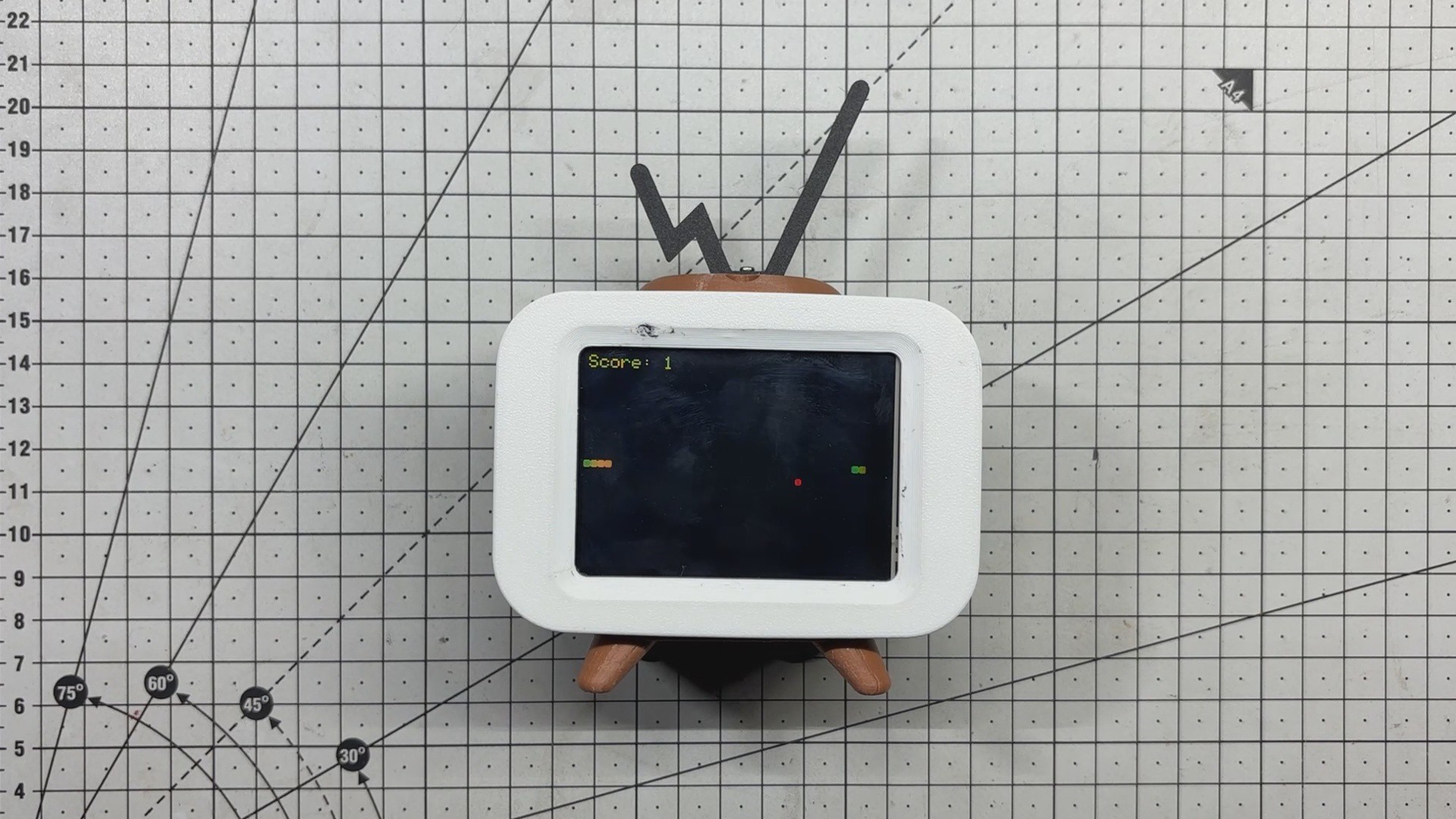

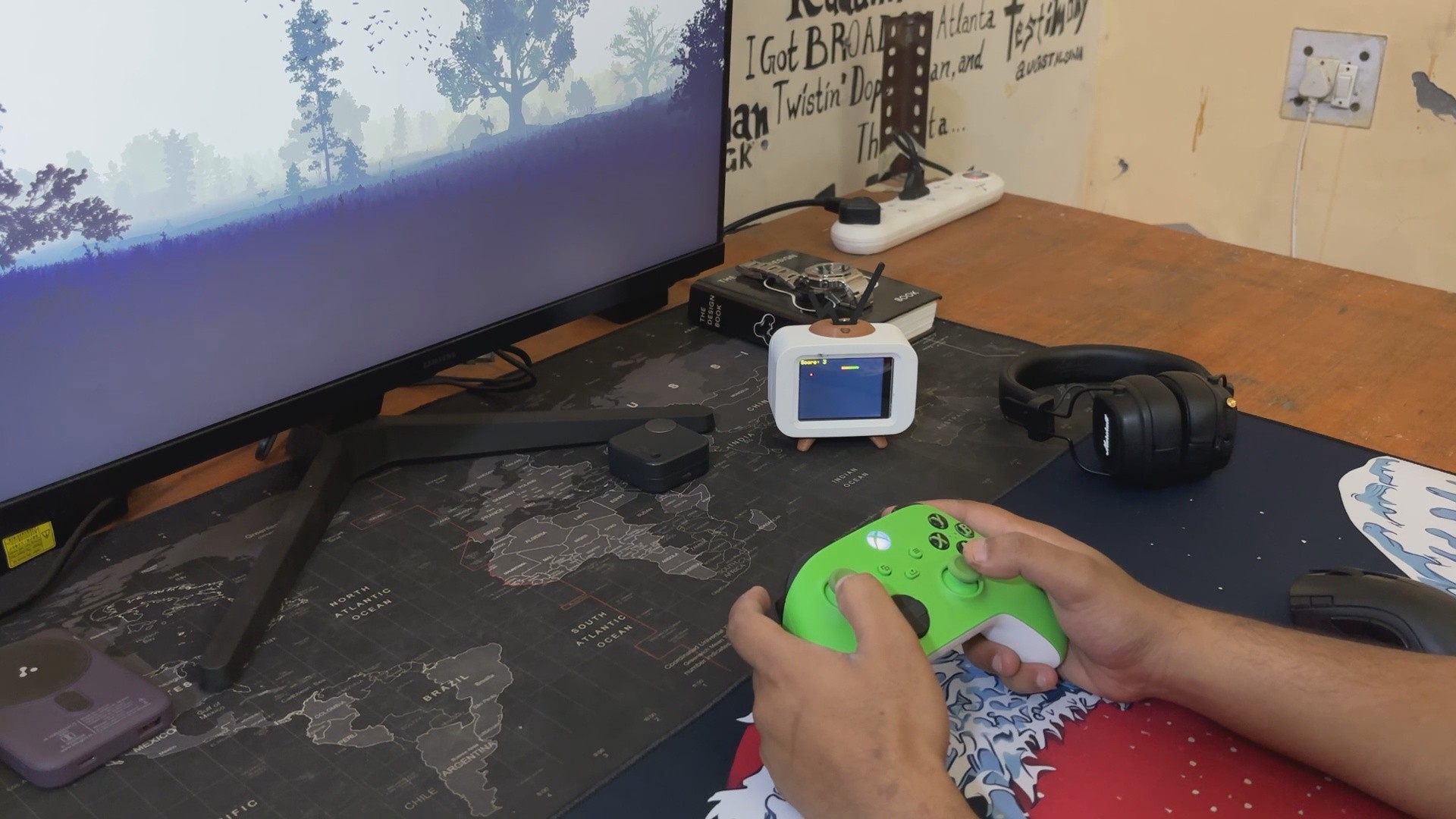

Switch to game mode, and you’re greeted by a smooth Snake game driven by the controller’s left joystick, complete with gradient snake segments, pulsing food, and a live score overlay.

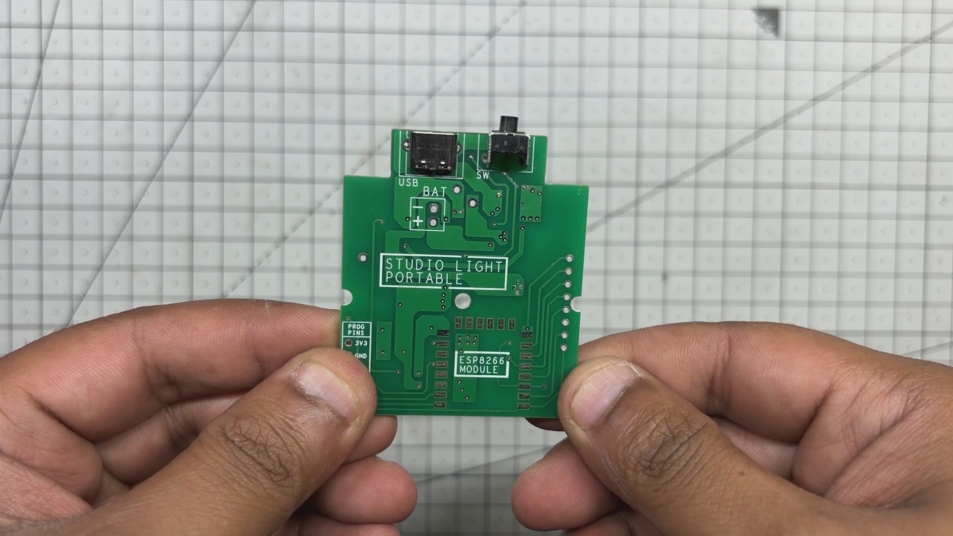

At its core is the ESP32-C6 Devkit, paired with an ILI9341 240×320 TFT display. For power, I built a custom circuit around the IP5306 power management IC, which steps up a 3.7V LiPo cell to a stable 5V which is enough to keep both the ESP and display running reliably.
The game logic is handled through a dedicated ESP32 library called BLEGamepadClient, which makes the Xbox controller pairing seamless. A buzzer adds tactile feedback when food is picked up, and a mode-switch button toggles between clock and game modes.
To bring the whole build to life, I designed an enclosure inspired by vintage 1980s television sets. The ILI9341 acts as the screen, framed by a retro shell complete with a dummy antenna and a 10-degree inclined base, a nod to old-school CRTs.

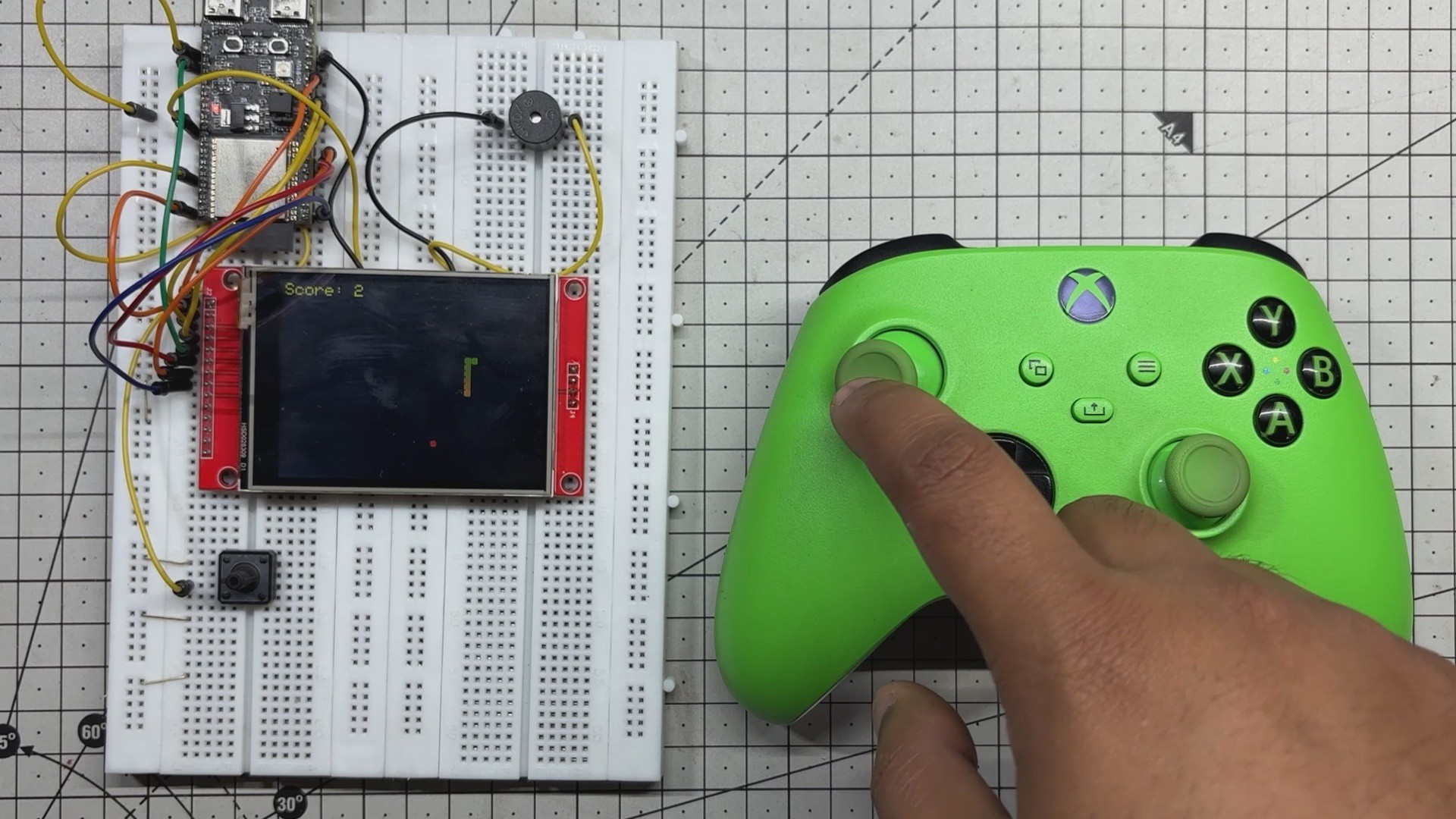

The idea to use an Xbox controller came from a project I had prepared earlier, where I demonstrated how to pair an ESP32 with the controller to perform various tasks. Initially, I used it to display button inputs on an ILI9341 screen.
https://hackaday.io/project/204381-xbox-controller-with-esp32
Once that concept was solid, I decided to repurpose the controller to drive one of my existing Snake game builds. I integrated BLE logic and input handling into the console code, and the result was a fully playable Snake game controlled via the Xbox controller’s left joystick.

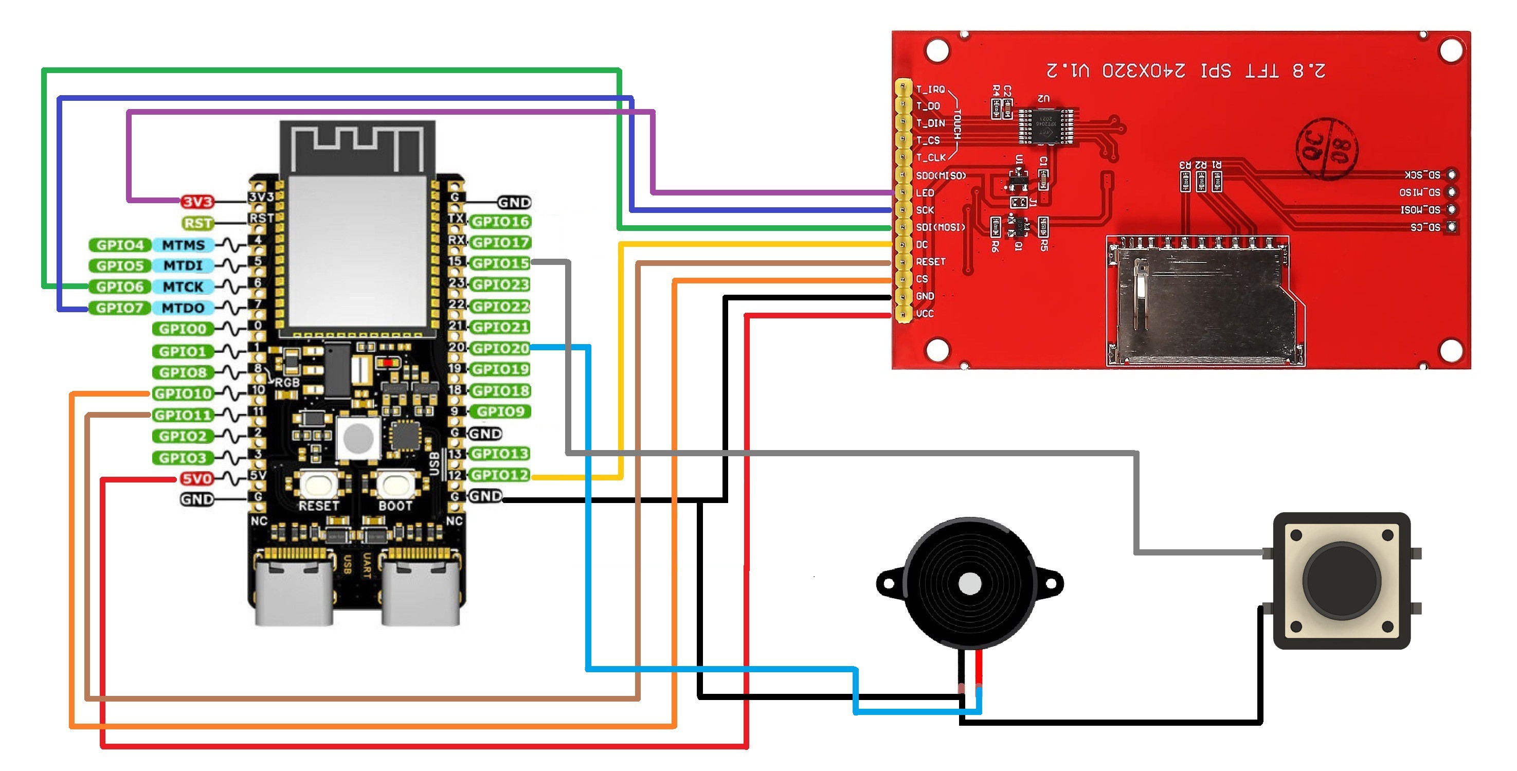

For wiring, I followed a simple diagram that connects the ILI9341 display to the ESP32-C6 via SPI, along with a few additional GPIOs. The setup includes connections for a mode-switch button and a buzzer, making the entire circuit compact and easy to replicate.

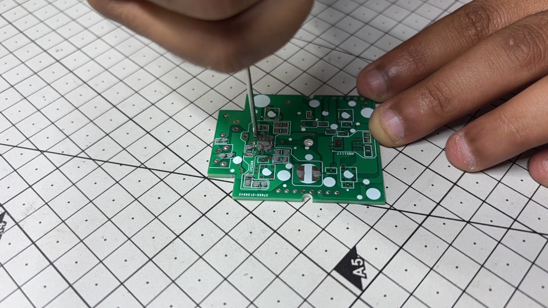

    PCB Assembly

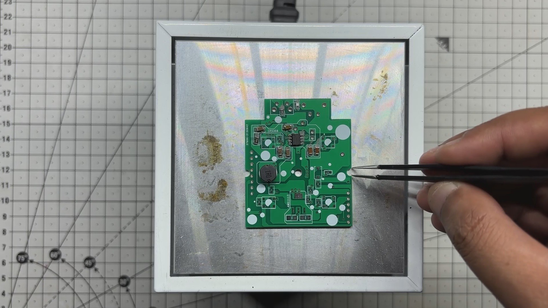

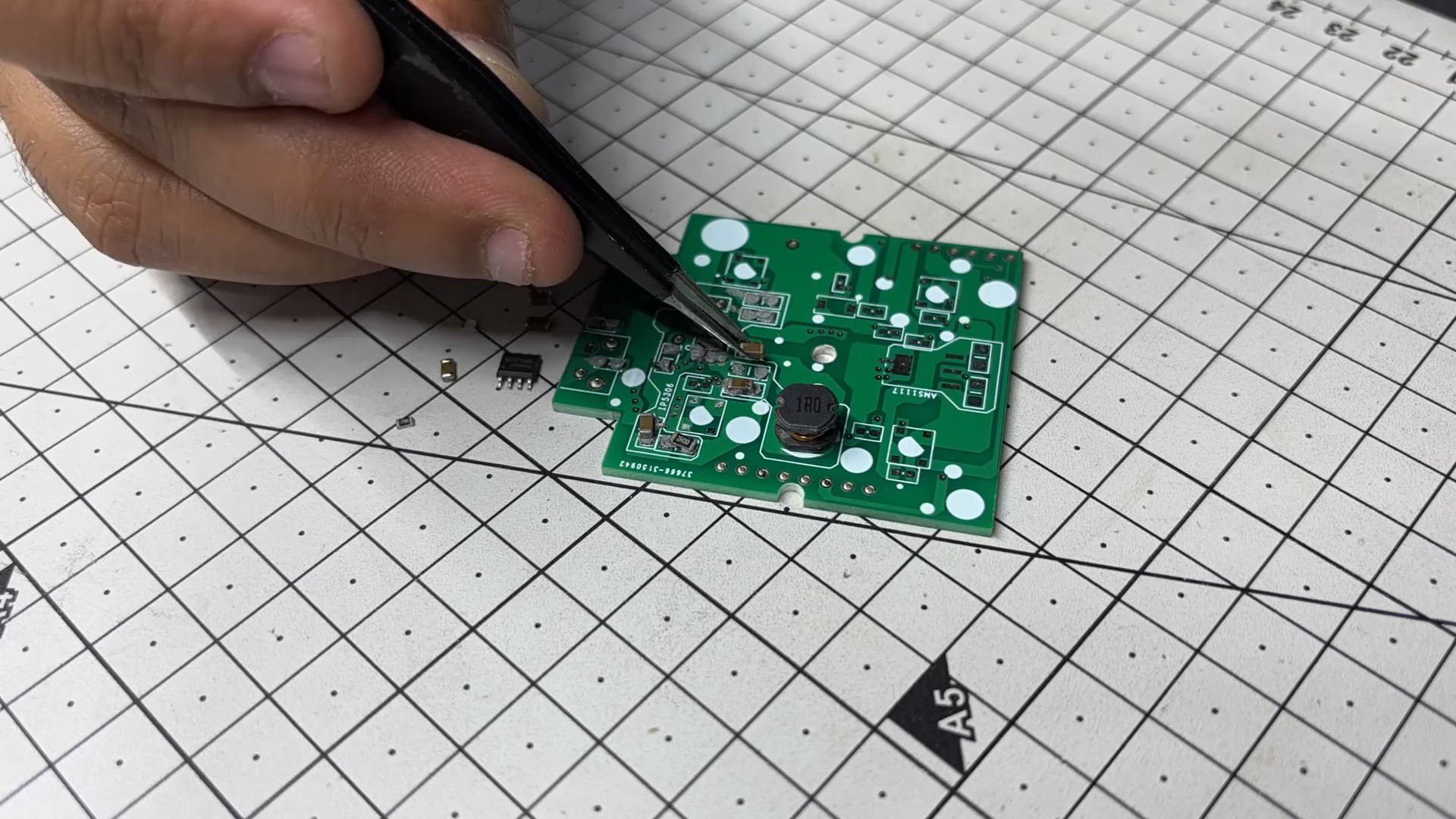

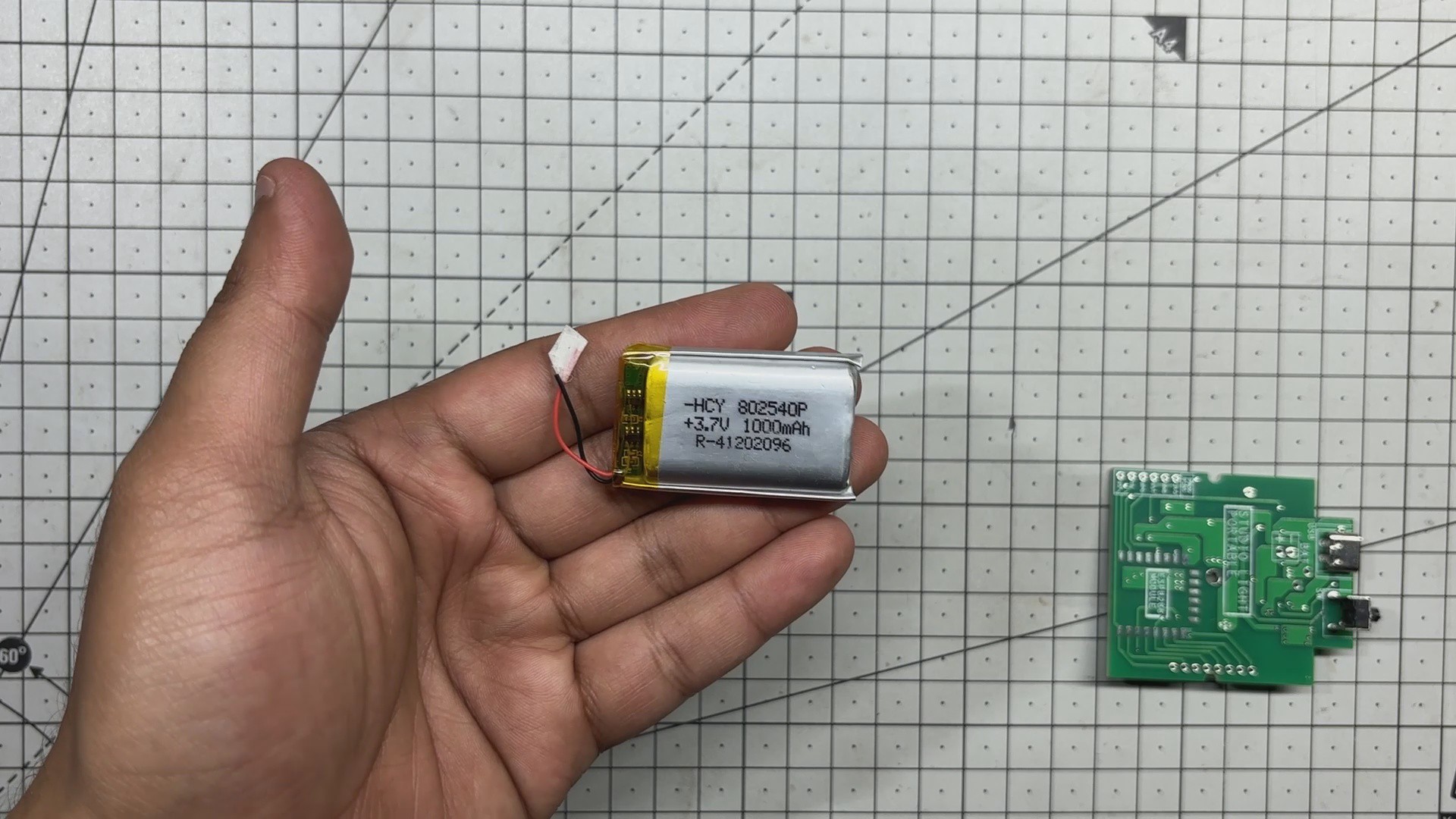

    • The PCB assembly process begins by applying solder paste to each SMD component pad one at a time with a solder paste dispensing needle; we are using 63/37 Sn/Pb solder paste here.
    • Next, we use an ESD tweezer to pick and arrange all SMD components on the top side of the board.
    • We pick the circuit and place it on the Reflow hotplate, which heats the PCB to the solder paste melting temperature, causing all SMD components to permanently solder to their pads.

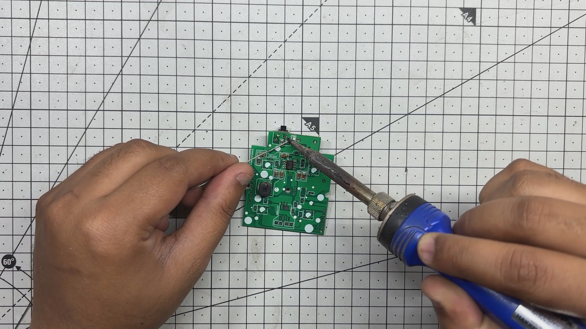

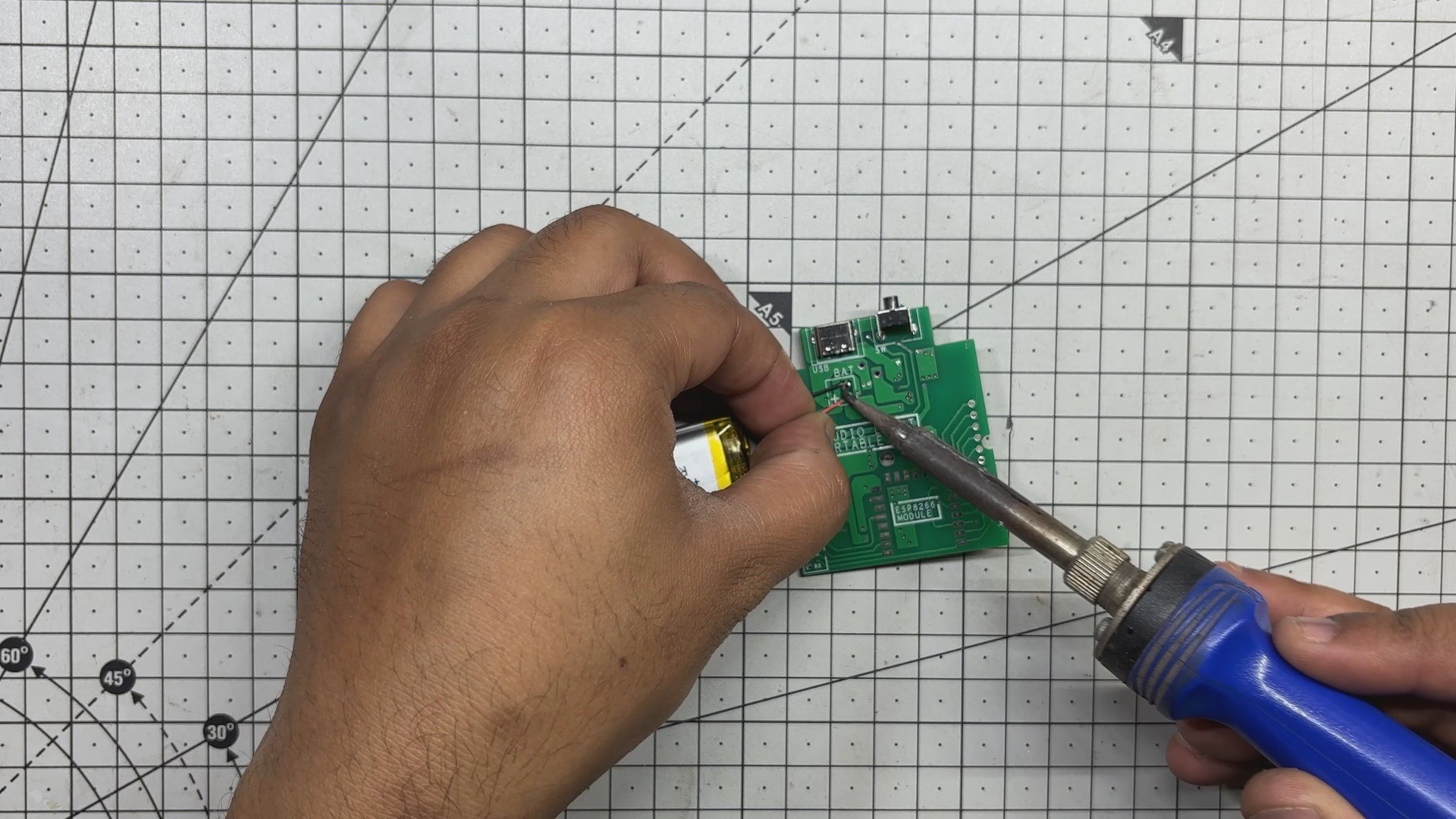

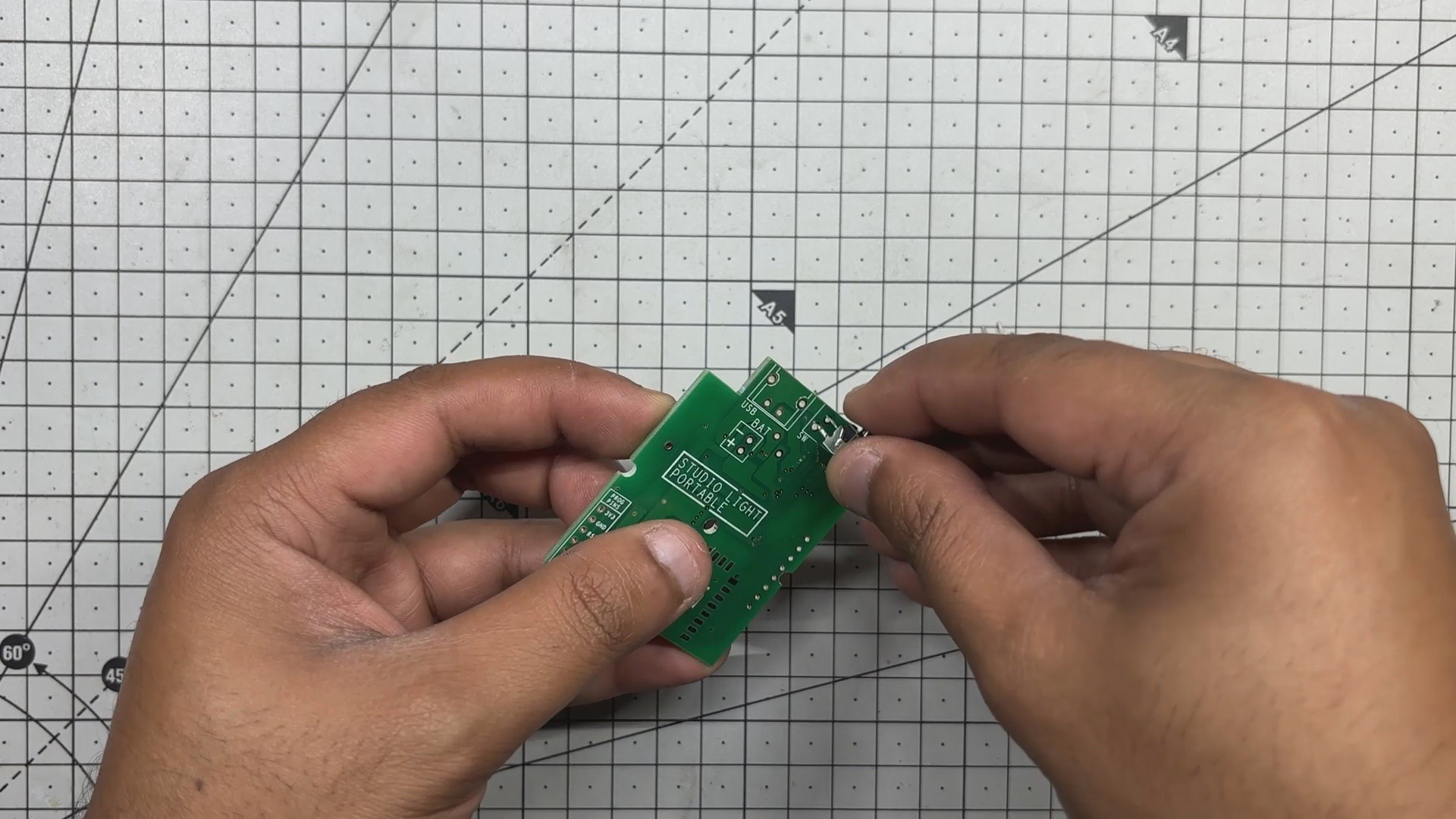

    • Now come the through-hole components; we begin by installing the Push Switch, followed by the type C Port. Board is then filpped over and we solder both through-hole component pads using a soldering iron.
  • 2
    Power Source

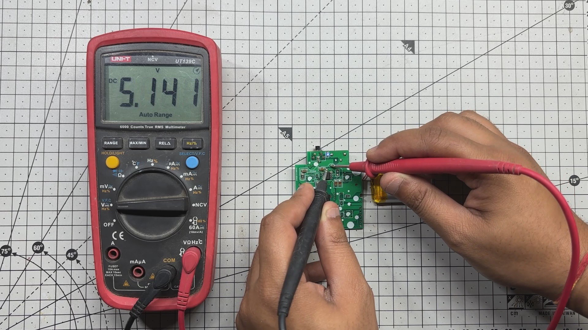

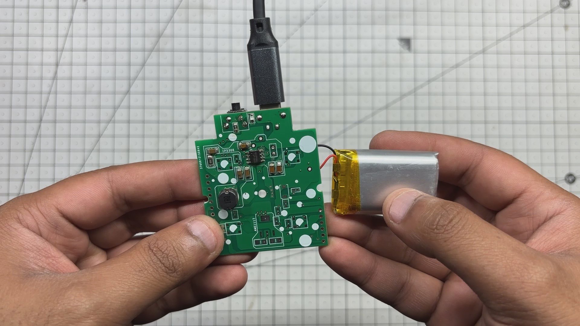

    For power, we’re using a 3.7V 600mAh LiPo cell. Its positive and negative terminals are soldered directly to the battery connector on the power circuit. The system is activated by pressing a vertical push button, which powers up the board and lights up the indicator LED that confirms the setup is operational.
    To verify, we measure the output voltage across the board, which reads a stable 5V.
    Charging is straightforward: just connect a USB Type-C cable using any standard smartphone charger. During charging, the indicator LED blinks to show activity, and once the battery is fully charged, the LED remains solid to indicate completion.

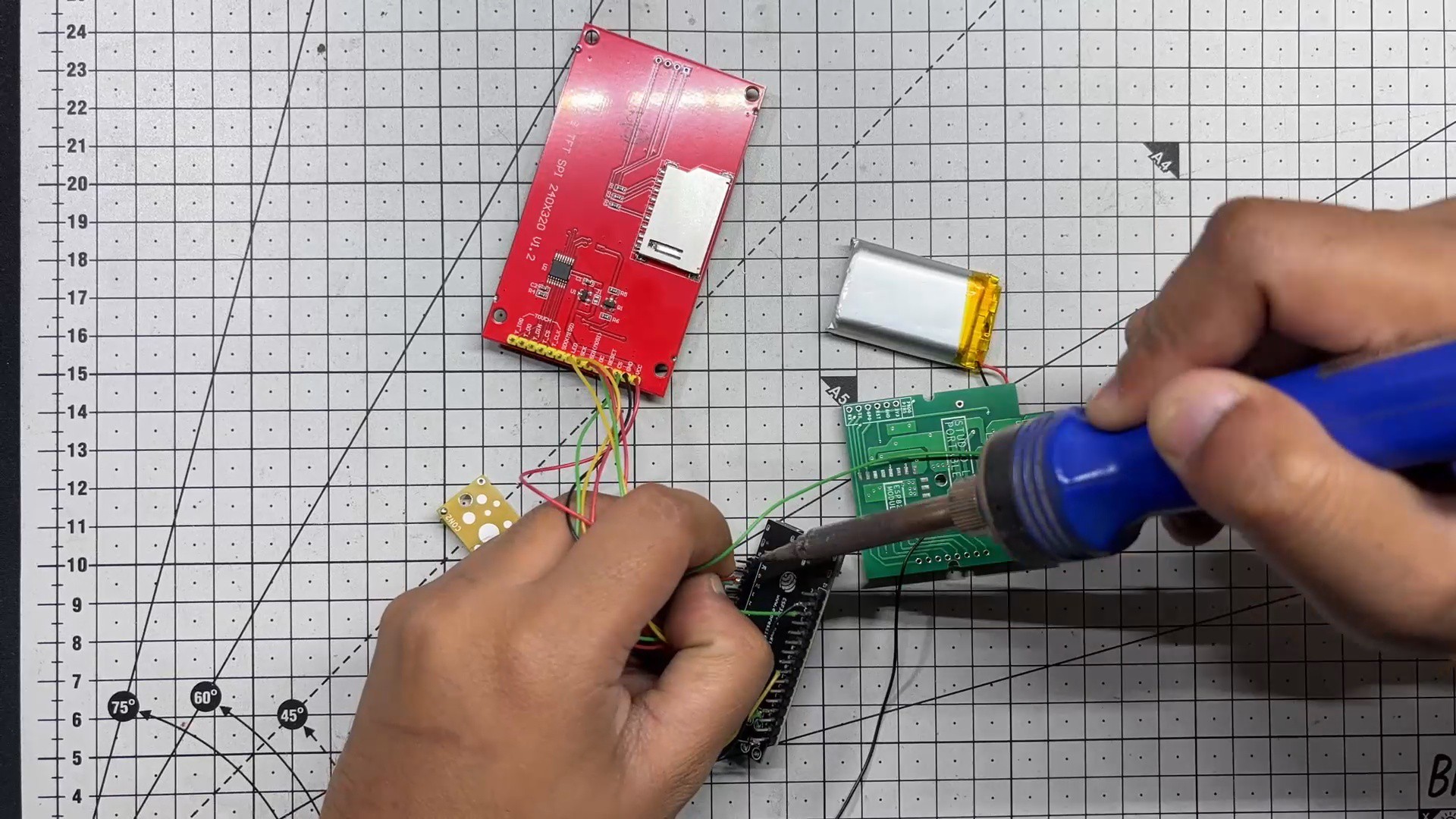

    WIRING

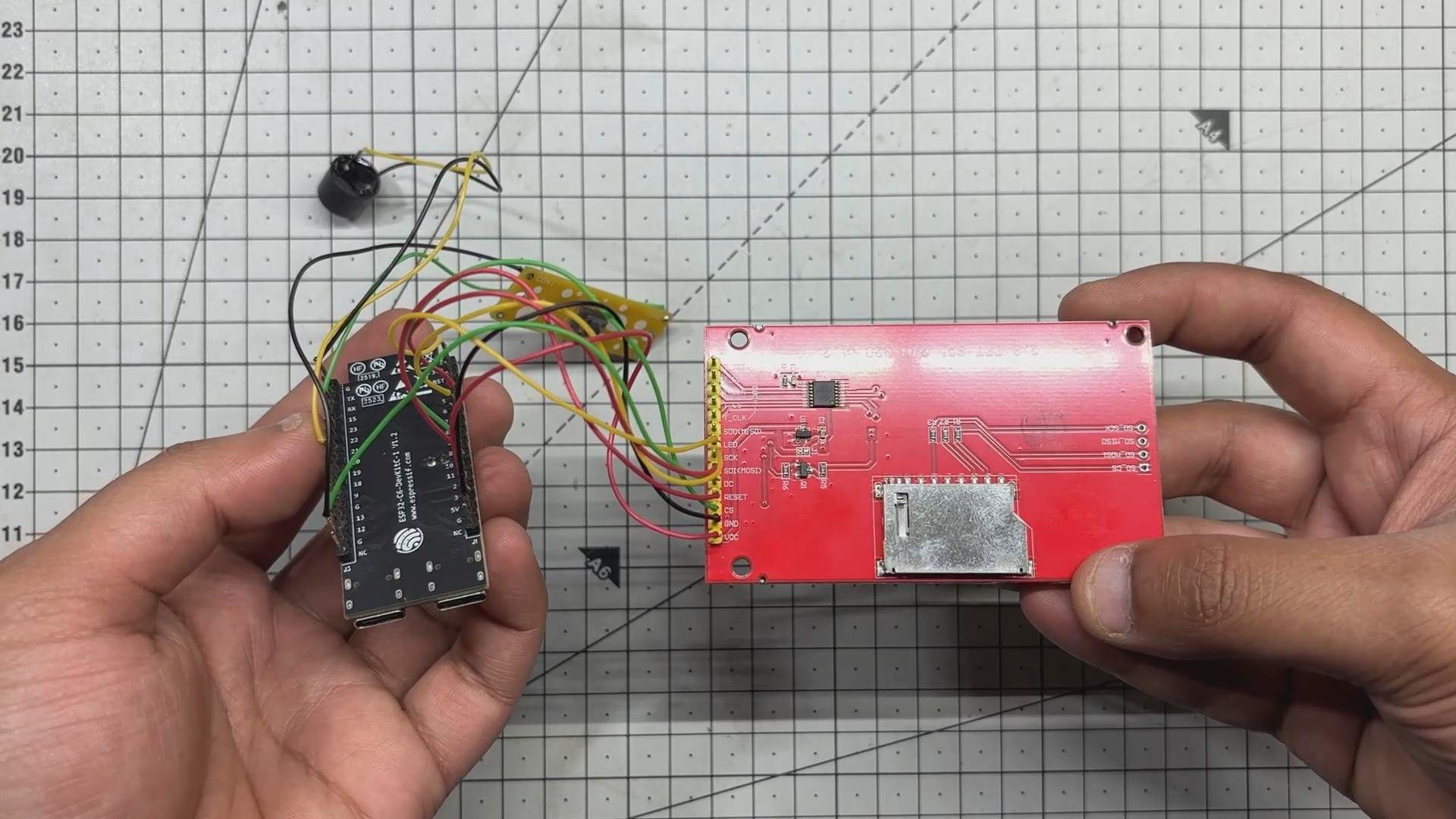

    We now start the wiring process, which begins by connecting the TFT Display with the ESP32 C6 Dev kit in the following order.
    • DISPLAY's MOSI to GPIO6
    • SCK to GPIO7
    • Chip Select to GPIO10
    • Reset to GPIO11
    • DC to GPIO12
    • The LED Pin of Display goes to 3.3V of the DevKit.
    • VCC goes to 5V
    • GND to GND
    We’ve reused a button PCB from a previous project; it features a 6×6 push button mounted on a small board that fits neatly into our enclosure. The button’s signal pin is connected to GPIO15 on the ESP32-C6, while the other terminal is tied to ground.
    Additionally, we’ve integrated a buzzer with the ESP32-C6 dev kit. The buzzer’s positive lead is wired to GPIO20, and its negative lead is connected to ground.
    To complete the power setup, we’ve connected the output of our IP5306-based power circuit directly to the ESP32-C6 dev kit: 5V goes to the dev kit’s 5V input, and ground is shared between both boards, finalizing the entire wiring process
