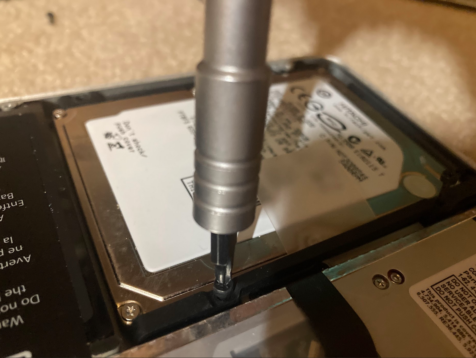

    *If you are removing your hard drive, please read this next part carefully, because Apple's hard drive enclosures are a tad bit fragile.
    Step 1: Remove the backplate to access the internals. The hard drive slot is located underneath the right palmrest.

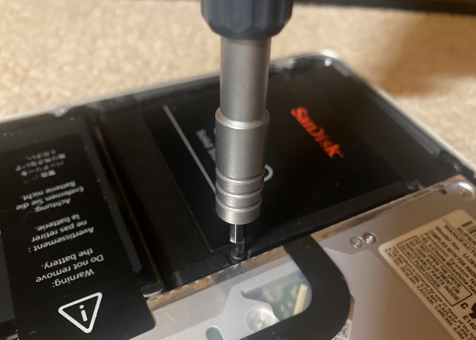

    Step 2: Carefully remove the screws on the side bumper closest to the optical drive. There are two screws per bumper, one on each side. Before the drive can be removed, you need to loosen the screws and remove the bumper. We only need to remove one bumper, which is the one closest to the optical drive. Leave the other bumper inside if you would like.

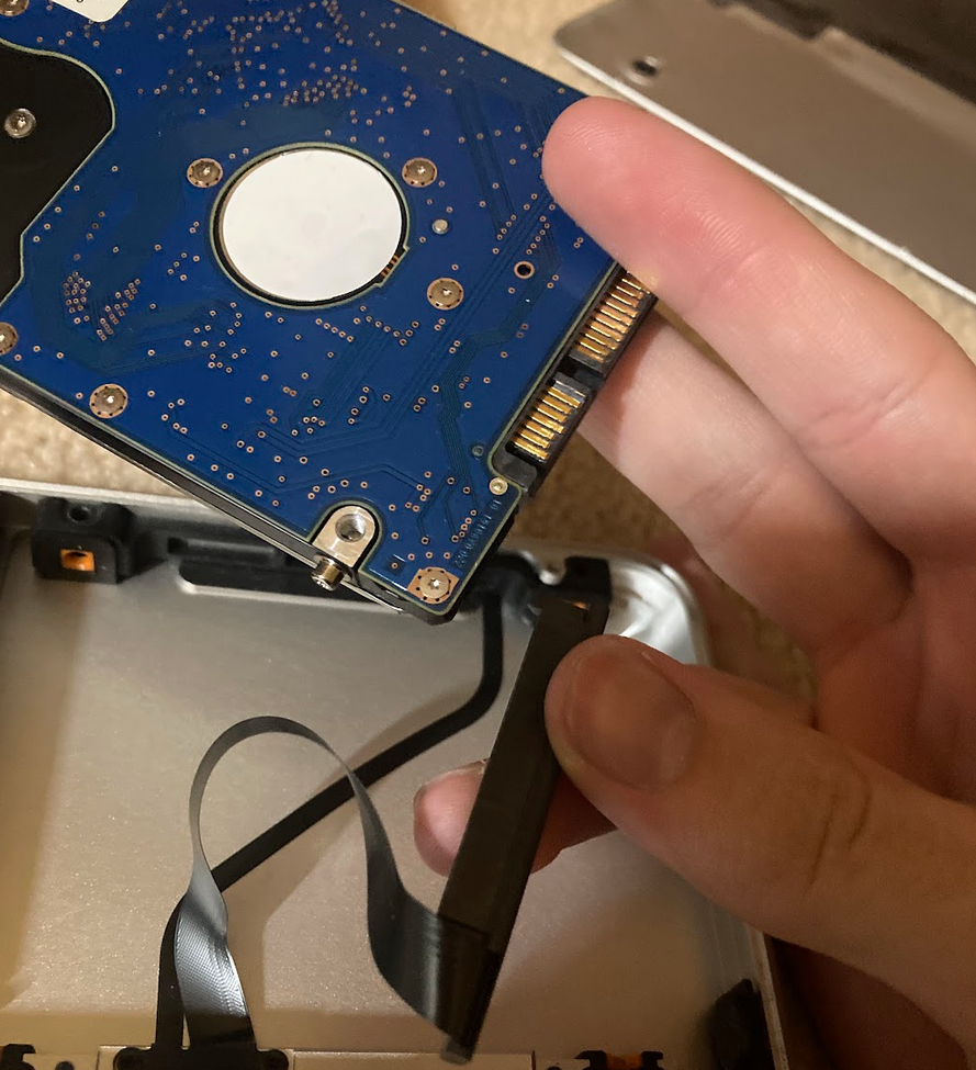

    Step 3: Once the bumper has been removed, carefully lift the drive by the clear plastic tab. As you can see, there is a VERY FRAGILE ribbon cable underneath. DO NOT PULL OUT COMPLETELY UNTIL THE CABLE IS DETACHED.

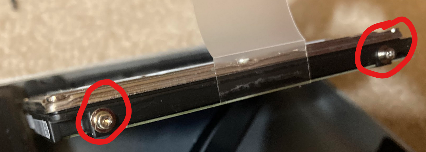

    Step 4: As you can see in the image below, Apple installs small cylinder-head screws into the sides of the drive. The bumper we removed is designed to clamp down on these screw heads to hold the drive into place. If you don't want your drive to rattle around inside, you need to remove these from the factory drive and screw them onto your new drive.

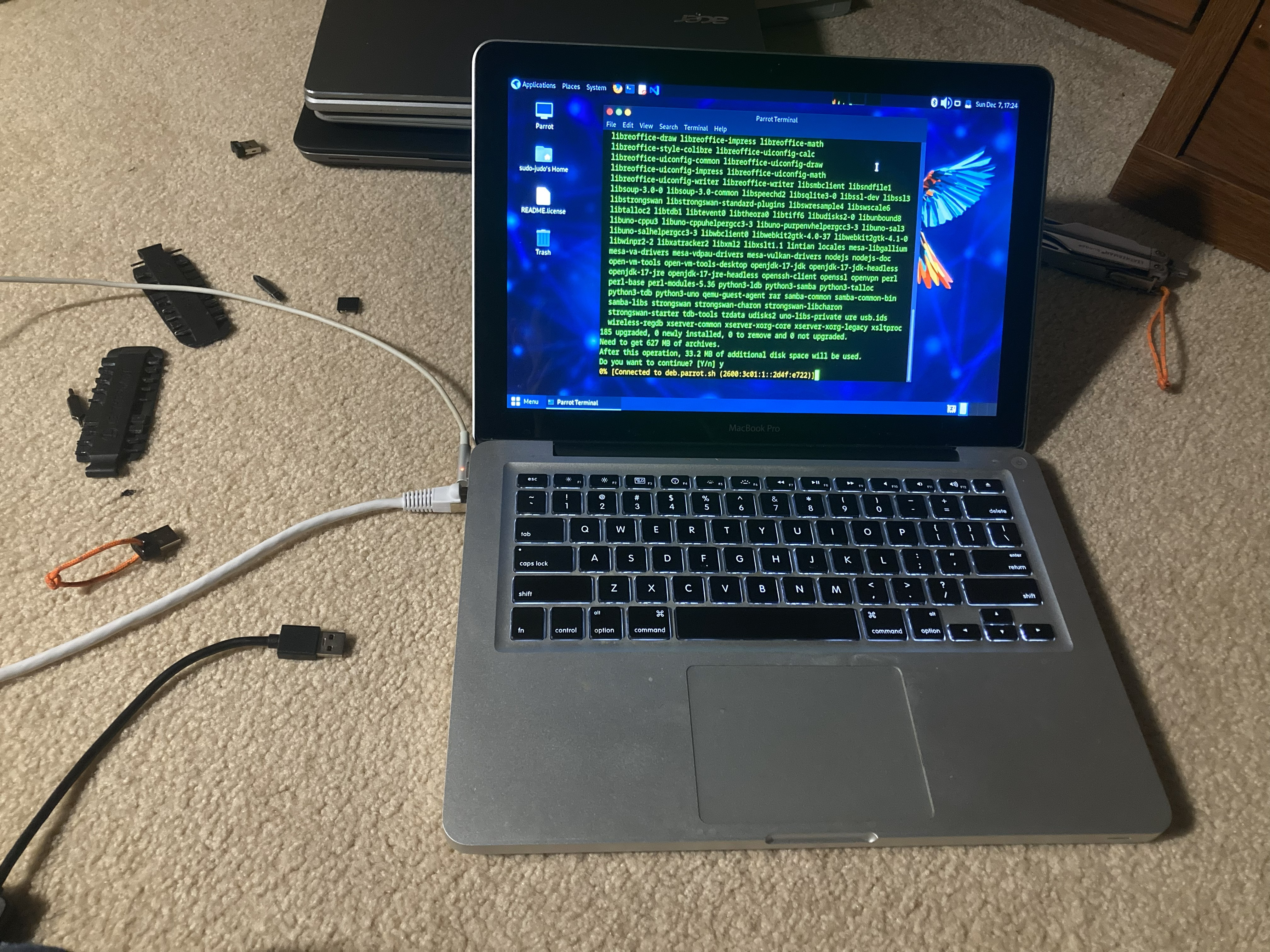

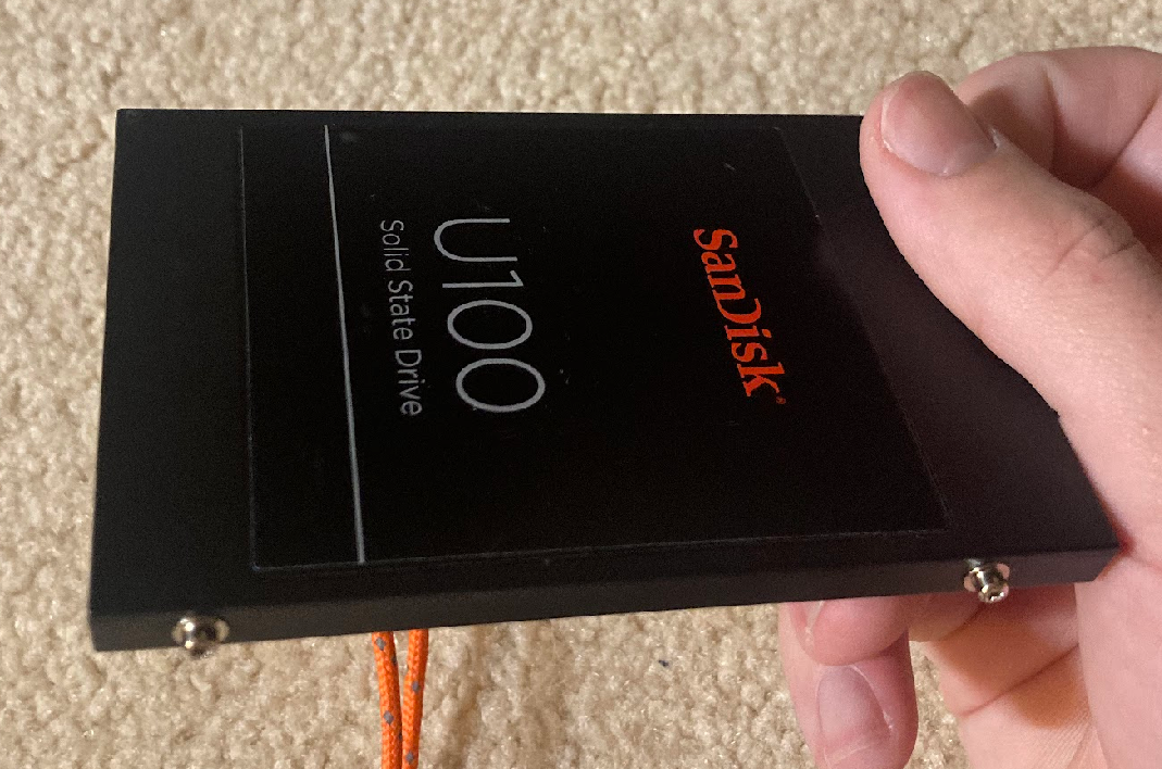

    Step 5: Once you have transplanted the cylinder-head screws onto your new drive, you can reattach the ribbon cable and slowly lower it into the slot again. I put Linux on the drive shown below beforehand, so now all I have to do is put it inside the MacBook and boot it.
    Step 6: Reinsert the bumper and SLOWLY tighten. Keep in mind that not only are you tightening the bumper onto the chassis, but the bumper is widening to squeeze the drive the more you tighten it. You should only tighten until it is snug, or it will just become a matter of which part snaps first. When done, reinstall the backplate.
    Step 7: If you did everything properly, your newly-installed drive should be connected and installed properly. Now just boot up the computer, select the drive in the EFI, and cross your fingers!
    At this point in time, we should have our MacBook running some version of Linux (or Arch, if that's what you REALLY want) for the next steps. If you need more help, privately message me. I am currently probing the internals in the shell so I have a baseline for the next log. I will post the next log soon, and hopefully I will include some basic probing you can conduct in the Shell with FlashROM to test your chip and back up your flash layout.

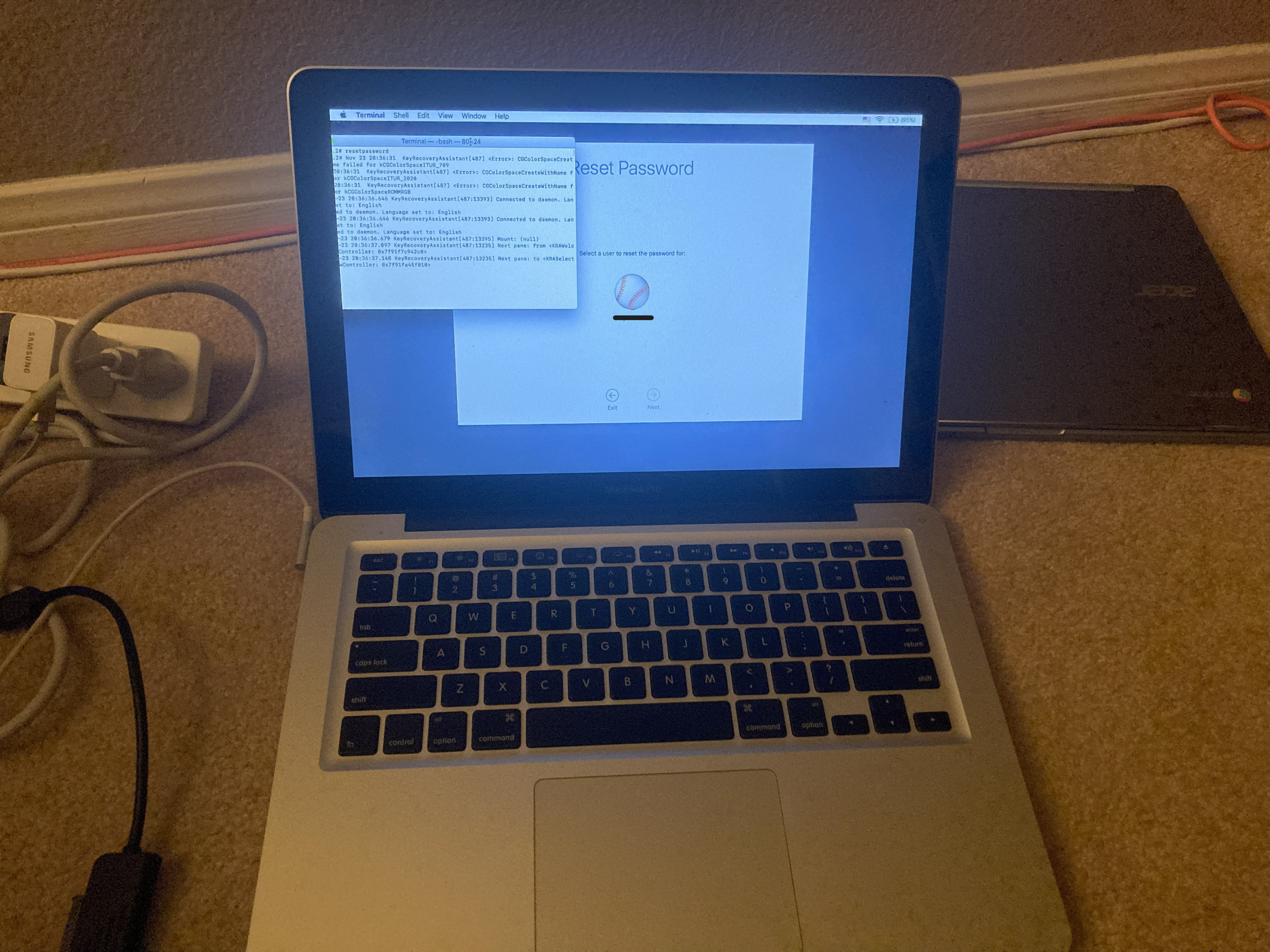

    After consulting Apple's forums, I found a quick method to reset the password by invoking the command "resetpassword" in the Bash Shell while the Mac was in Recovery Mode, which can be accessed by holding down the "options" key immediately after booting.
    Macbook Password Reset ScreenResetting the password in Bash Shell, which was a surprisingly painless and straightforward process. I think that there must have been some other security feature that was disabled that allowed me to do this. I was logged out of the Mac OS drive and was able to reset the password without any other credentials.
    Once I had successfully changed the password, I felt safe to give the MacBook a proper shutdown as I now had Administrator access and did not need to worry about locking myself out.

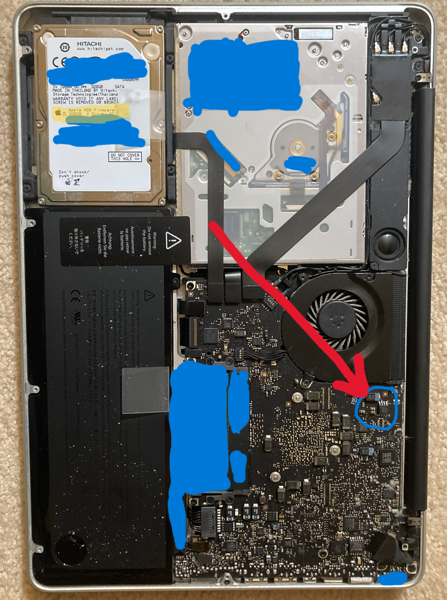

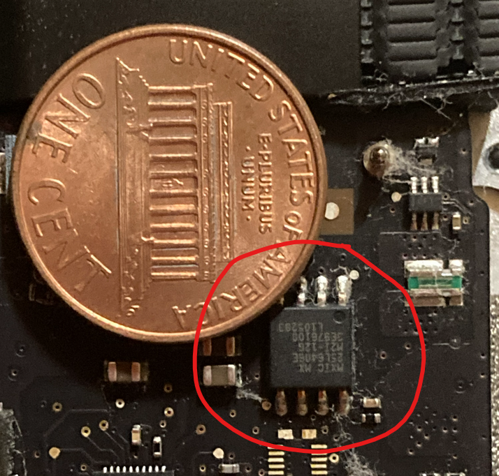

    Once the MacBook was powered off, I felt safe removing the backplate to take pictures of the hardware stickers and look for the BIOS/UEFI chip. (It is unlikely that I will be doing any external flashing via clip because of the surface mounted components surrounding the chip) I just needed to take pictures for reference for now, so as soon as that was complete, I reinstalled the backplate. The internals seemed surprisingly clean and intact, except for some suspicious particles on top of the battery. (I will reinspect the battery at a later time)
    It took a while to find the chip based on the motherboard's model number, but after referencing some technical resources, I found the location of what is listed as the BIOS/UEFI chip on the motherboard.
    Here are some images of the BIOS/UEFI chip that I took, with a penny for scale.
