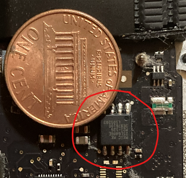

Once the MacBook was powered off, I felt safe removing the backplate to take pictures of the hardware stickers and look for the BIOS/UEFI chip. (It is unlikely that I will be doing any external flashing via clip because of the surface mounted components surrounding the chip) I just needed to take pictures for reference for now, so as soon as that was complete, I reinstalled the backplate. The internals seemed surprisingly clean and intact, except for some suspicious particles on top of the battery. (I will reinspect the battery at a later time)
It took a while to find the chip based on the motherboard's model number, but after referencing some technical resources, I found the location of what is listed as the BIOS/UEFI chip on the motherboard.
Here are some images of the BIOS/UEFI chip that I took, with a penny for scale.
