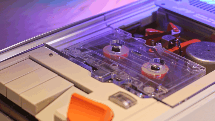

I kept this from the original player (Privileg TC 183) to avoid going into the recording part (bias signal generation, erase head oscillator, tape EQ). Instead of the regular cassette, the deck now powers a tape loop instead, so there's no need for rewinding at the end of the tape.
Once the tape gets erased and the signal gets recorded, it traaavels on the tape loop, guided by the orange brackets and is being read on the second tape head and played on the speaker.

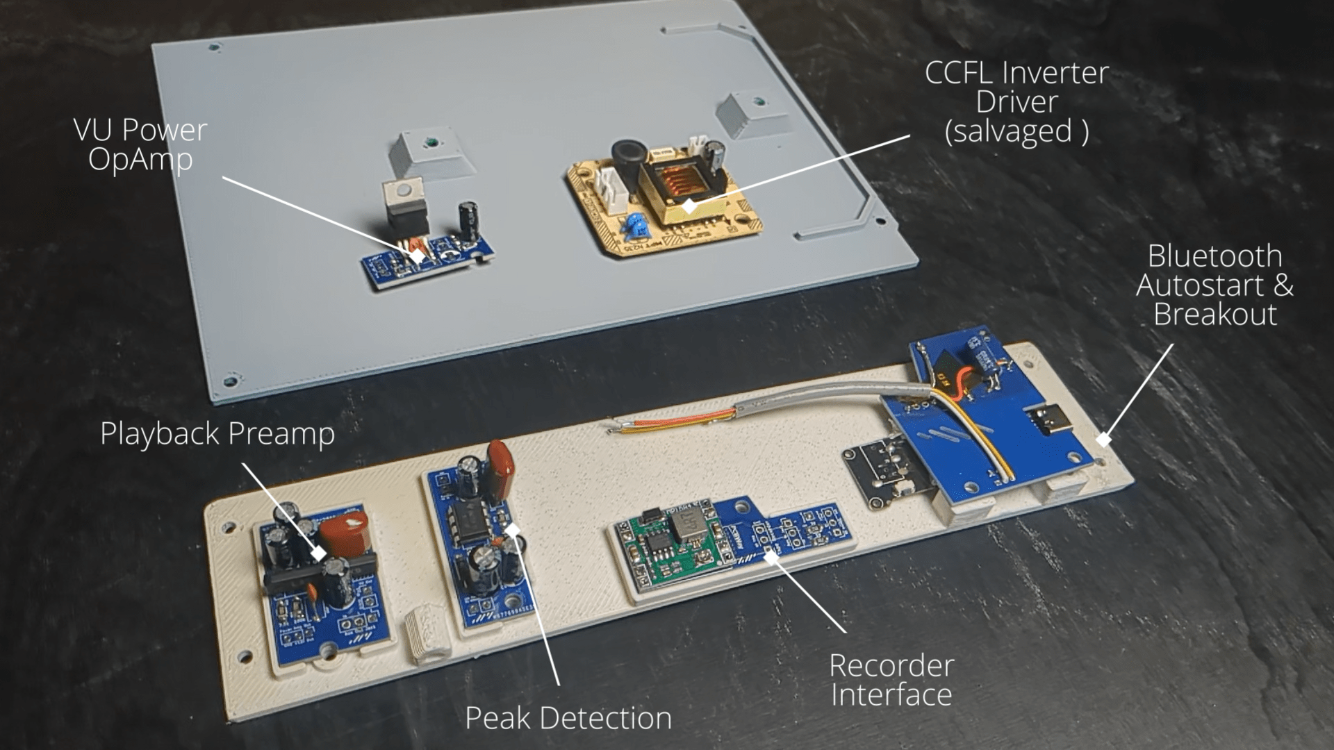

Thankfully, cassette dedicated chips are still available, I used the LA3161 ("preamplifier for car stereo") together with its datasheet example of tape EQ compensation. A lovely single-supply preamp that saved me of a lot of fiddling with gain and biasing.
This preamped signal goes straight into a TDA2030 power amp (and from here to the speaker), but it also feeds the signal chain for the VU meter.
VU meter
Speaking of which, it almost wore me out trying to design it. Going back to the desk lamp built in my first youtube video, the VU meter works by under-voltage starving the inverter driver of the CCFL (cold-cathode fluorescent lamp) tube. It's hacky, not "safe" for the tube, but what's a completely safe life other than boring?
Anyway, I needed to feed the tube driver enough current while varying the voltage in a 12-24V range, dictated by the audio signal. I ended up using a power op amp (TDA2050).
Rectification, it doesn't take directly the audio signal, but...
Peak detection
To look nice on VU meter, I need a smooth, groovy signal, rather than the full audio. I used an op amp (LM358) in a single-supply non-inverting configuration to further amplify the audio signal (a lot, around 500x) and exagerate the peaks. It also pushes it into clipping, conveniently dropping the lower half of the wave.
This huge peak-to-peak can then easily be smoothed with a diode-based peak detector. Although I had a spare op amp in the LM358 package, my signal now peaks over 12V so I won't care about the voltage drop of the diode to use an active peak detector.
