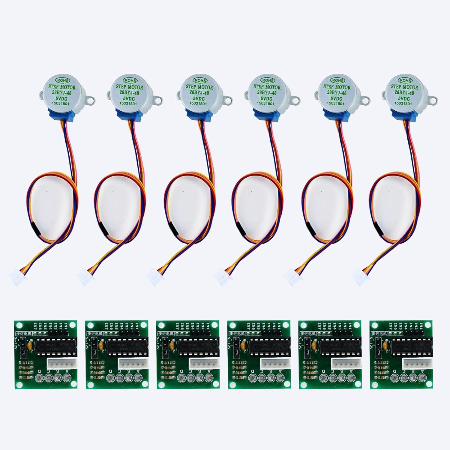

  • Parts
    JohnsonFarms.us • 11/29/2025 at 06:14 • 0 comments
    The electronic parts for this project are fairly inexpensive. We sourced parts from amazon but they are widely available elsewhere.

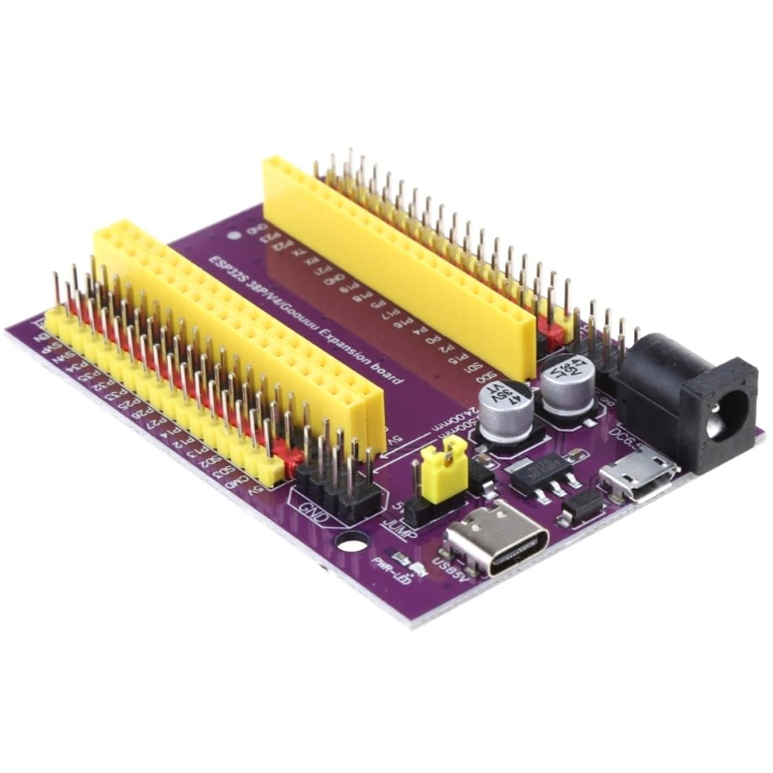

    The stepper motors and drivers were purchased in a six pack combo with the motors and drivers. The project only needs 3 motor/drivers but having the extras is not a bad idea. The cheap drivers are meant to have reverse polarity protection, but in my experience it does not work, oops.
    The ESP32 linked above is a 5 pack, you obviously only need one but if you are looking for a good deal the multi-packs are best.
    You can use a number of different dev boards, but the 3d printed holder for the PCBs and the writeup for wiring is setup for the linked board. So long as there are three 5v connections available on the board, or you are willing to splice the 5v power form the three driver boards together, than you can use anything compatible with the ESP32.
    For the M3 Screws you only need 12 M3x4mm, and 2 M3x12. We purchased a large kit so we could have options and use them with other projects. Plus you have alternate sizes if needed. The larger pen holder does need an M4 screw but you only need that if you want to use larger markers.
    For the Dupont Wires you will need 18 female to female wires. We found the 20 cm length to fit nicely.

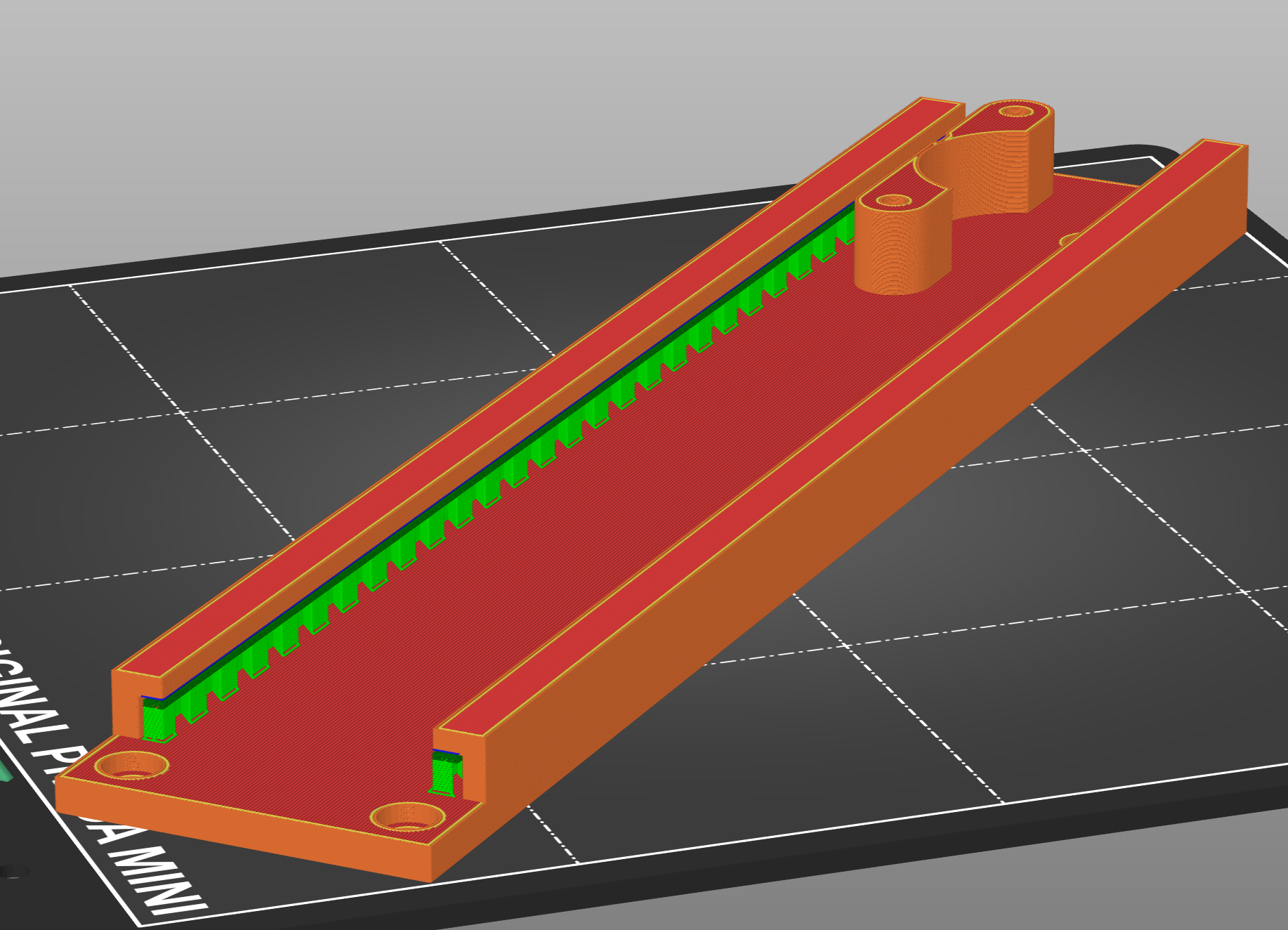

    3d Printing

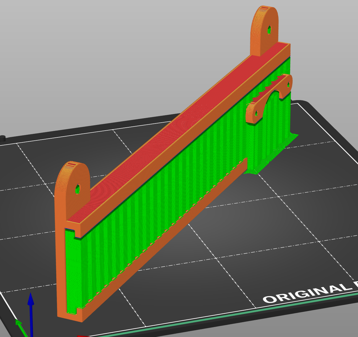

    The 3d printed parts are all easy prints. Nothing too complicated and a fairly quick print as well. The test prints were done in PETG and PLA including intermixing components of both materials within a build and there were no issues. Print files are available at Printables.
    You need one of everything, and multiples of the following:
    • 2 x gear.stl
    • 3 x x_frame_spacer.stl
    • 9 x electronics_mount_spacer.stl
    The only parts that need support are the x_frame.stl and y_frame.stl along the interior of the rail where the x_movement.stl and y_movement.stl slide within the frames.  Snug supports were easiest to remove by running a small flathead screwdriver down the rail. See the image below for an example of supports.
    The parts can be printed on a printer as small as the Prusa Mini, but it does require some alternate orientation for the x_frame.stl to fit (everything else fits no problem). It needs turned onto onto an edge and rotated diagonal on the plate to fit. This is not ideal, but possible if it is your only option. See image below for an example of orientation for smaller build plates.

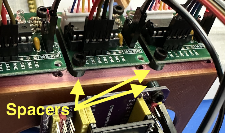

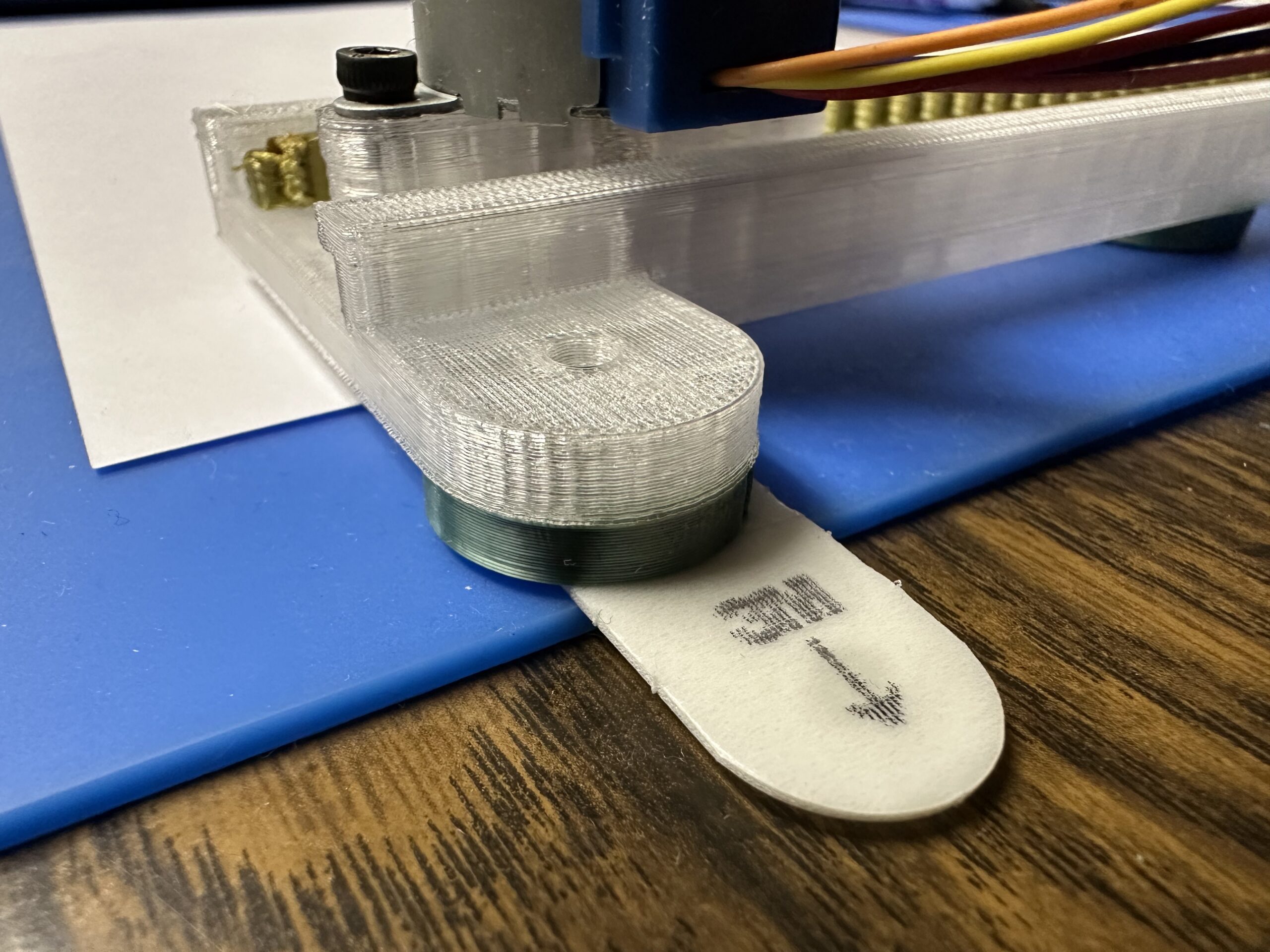

    Electronics Mount
    For the electronics, use the electronics_mount and the electronics_mount_spacers with M3 screws. See the photo below for an example. Just place the spacers between the boards and the mount.
    Mounting Tip
    You do not have to screw the frame to a board, though that may be convenient depending on your use. We just used a couple removable command strips to stick it to a surface (you can see this in one of the above photos), in our case a silicone work mat. The mat has the added benefit of a bit of texture and squish which has helped hold the papers in place and allow for a bit of give for stiffer writing implements like ball point pens.

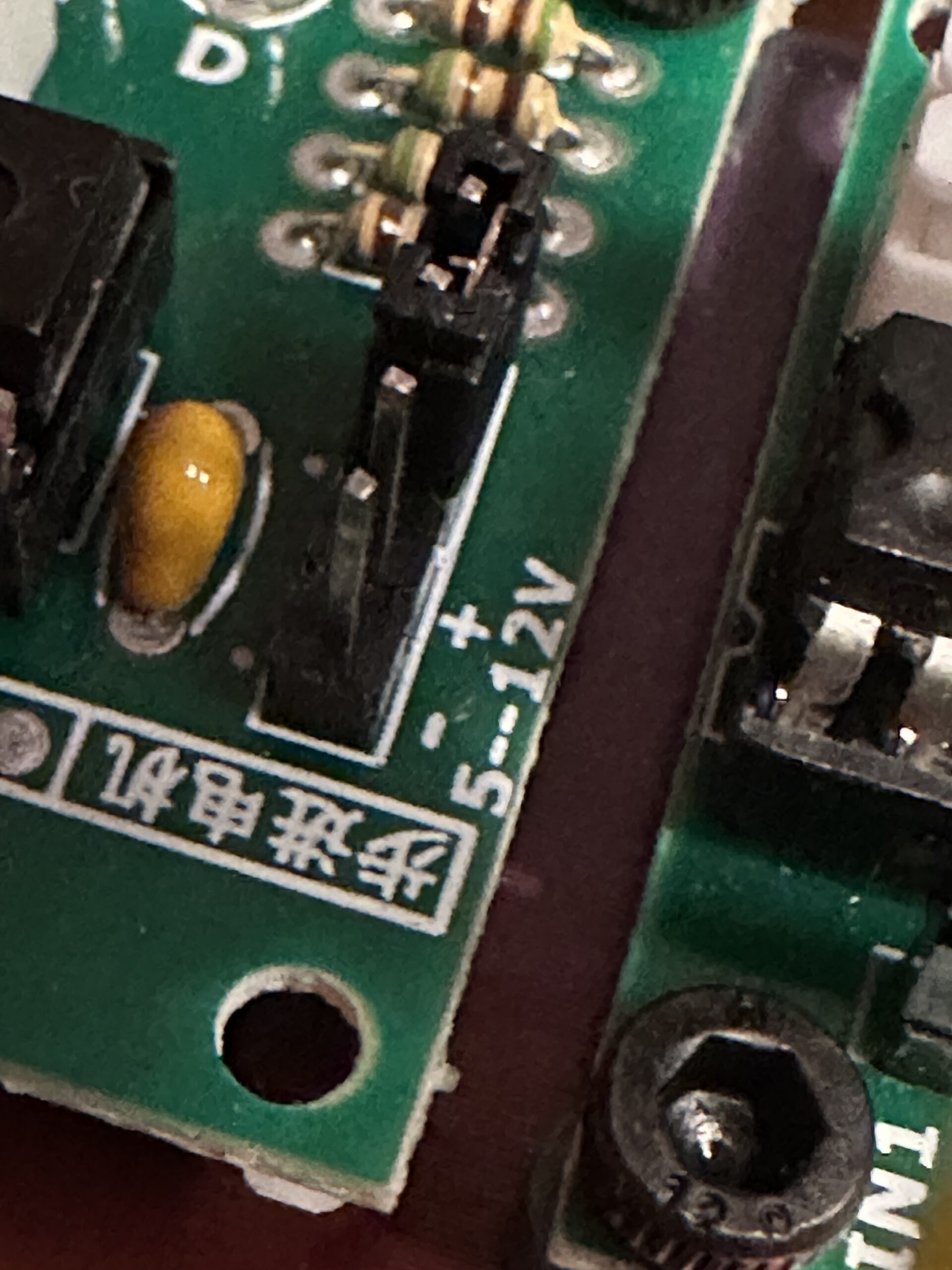

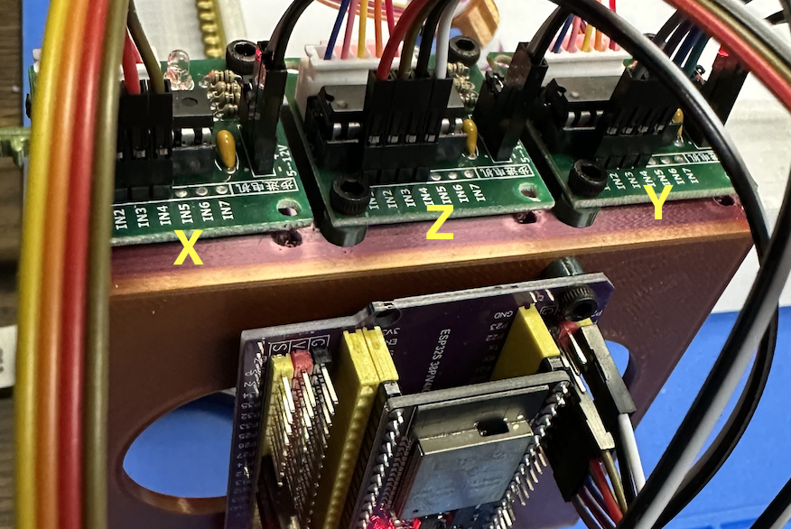

    Wiring
    The wiring is pretty straight forward. However, caution is needed when connecting the power. The motor controllers are supposed to have reverse polarity protection, but experience has shown that to be false. So keep track of your negative and positive wires carefully.
    The motor wires just plug directly into the motor control boards, the plugs only fit one way so you can't mess this up. When you wire from the motor control board to the dev board you want to use the yellow column of pins. Just for reference the red column is positive voltage and the black is negative. So if you connect these signal wires to the red or black column it can fry your board.

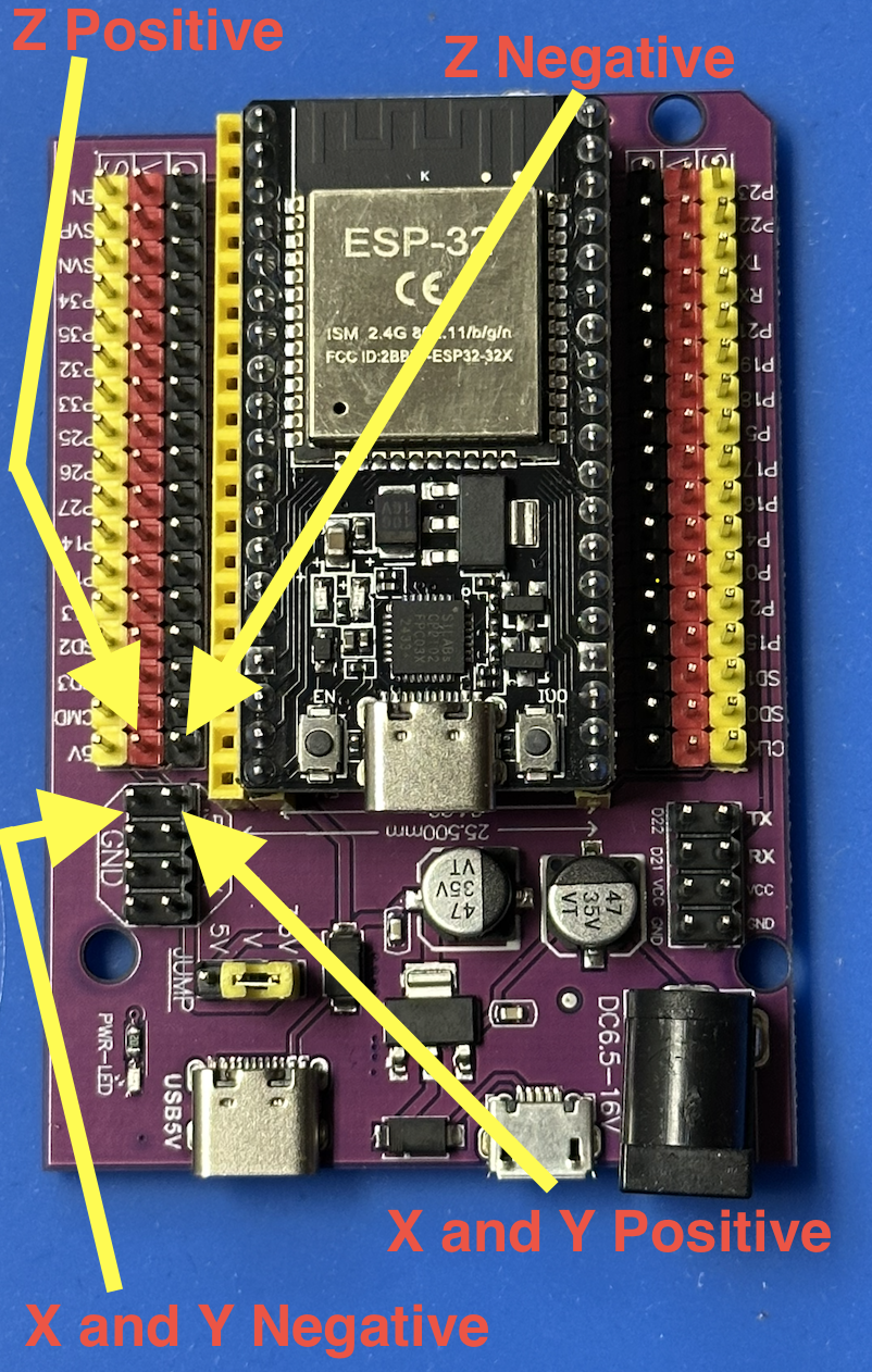

    For the power we use the power plugs on the dev board for the X and Y and the 5v pinout for the Z, see image below. Be cautious here, the plugs are right near each other, but the plugs for the Z power are switched left right from the X and Y right next to it.
    The positive and negative are clearly marked in the corner of the mortar control board.
