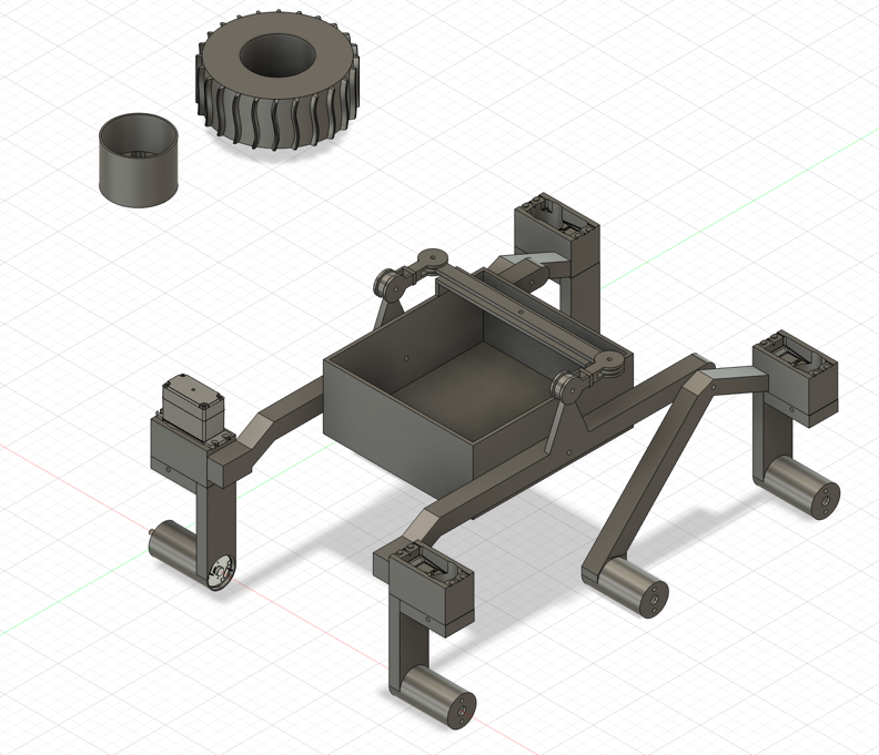

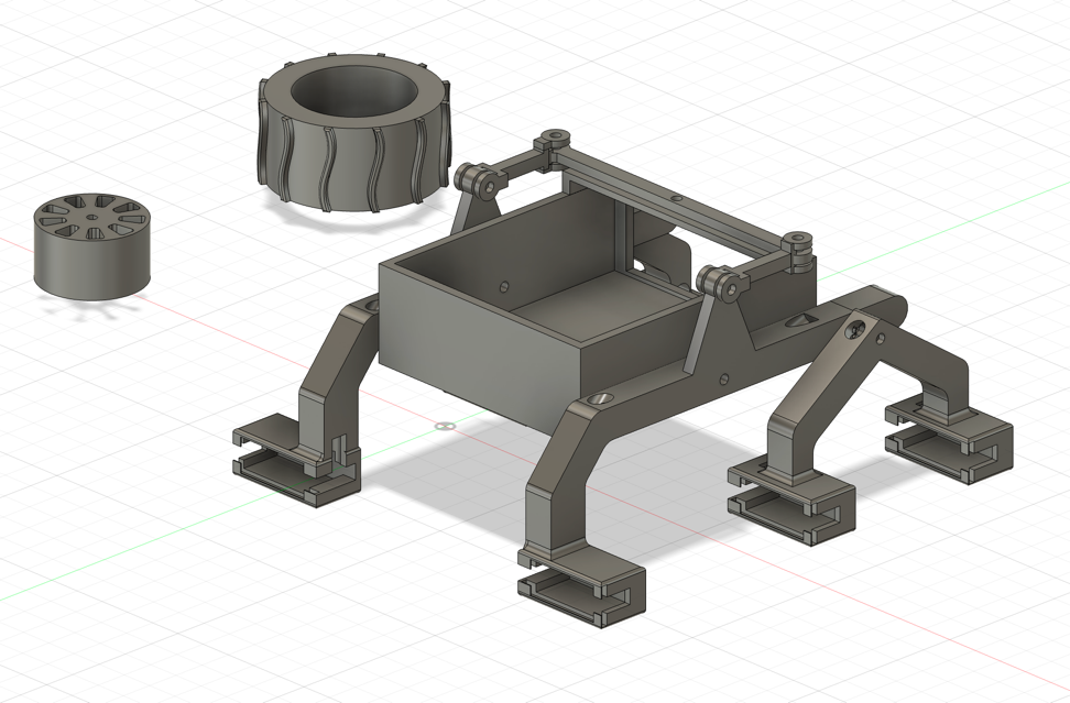

3D-Printed Parts
All STL files for this rover are available in: pathfinder/3d-models/
The complete mechanical design is also available in STEP format: pathfinder/cad/papaya-pathfinder.step
Use PETG or PLA for the structural parts, and TPU for the tires. All parts are designed to be assembled using M3 screws and nuts.
| File | Qty | Material | Notes |
body.stl |
1 | PETG / PLA | Main chassis |
arm_left.stl |
1 | PETG / PLA | Left suspension arm |
arm_right.stl |
1 | PETG / PLA | Right suspension arm |
pivot_left.stl |
1 | PETG / PLA | Left pivot mount |
pivot_right.stl |
1 | PETG / PLA | Right pivot mount |
differential_bar.stl |
1 | PETG / PLA | Central rocker-bogie differential bar |
differential_link_left.stl |
1 | PETG / PLA | Left link between differential bar and suspension arm |
differential_link_right.stl |
1 | PETG / PLA | Right link between differential bar and suspension arm |
motor_mount.stl |
4 | PETG / PLA | Motor mounts for GA25 motors used on steering arms |
horn_adapter.stl |
4 | PETG / PLA | Servo horn adapters for steering servos. Print horizontally for strength. |
rim.stl |
6 | PETG / PLA | Standard option. Connects directly to the motor shaft (D-shape). Simple, but can strip over time under high torque. |
rim_hexagonal.stl |
6 | PETG / PLA | Pro option (Recommended). Requires 12mm brass hex adapters. Much stronger connection, prevents the motor shaft from stripping the plastic. |
tire.stl |
6 | TPU | Tires |

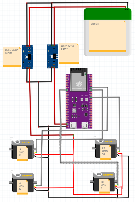

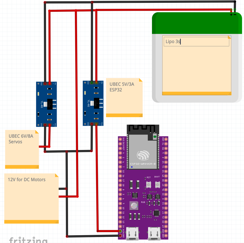

Wiring Diagram
Power Distribution: Shows the rover power distribution, including the LiPo 3S battery,
separate UBECs for logic (5V) and servos (6V), and the motor power rails.
Motors: Motor wiring using two BTS7960 drivers, each controlling one side of the rover.
The ESP32 provides PWM control signals to each driver.
Servos: Servo wiring powered by a dedicated 6V UBEC. PWM control signals are provided by the ESP32.
System Overview: High-level overview of the complete rover wiring, combining power,
motor drivers, servos and control logic.
