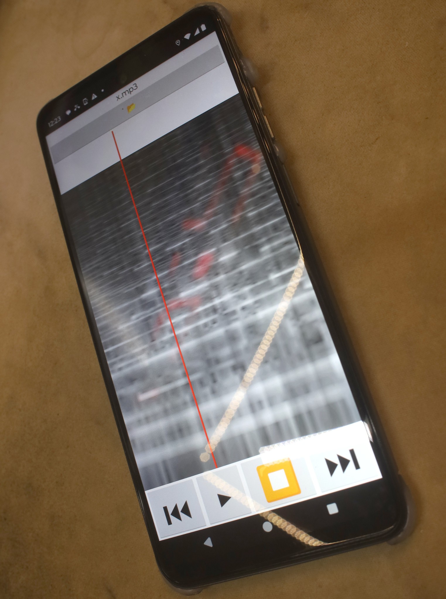

     The mane feature was a spectrogram of a complete sound file which you can pan & zoom around, play repeatedly from a precise starting point.  The mane problem was decoding & converting the file in a reasonable amount of time.  The decoding goes really fast.  The calculation of the spectrogram goes in parallel on all the cores, asynchronous of the user input.  It manages to go really fast despite being pure Java.
    The complete spectrum in the highest resolution goes in a texture.  For a 4 minute file, it's 11MB if the FFT window size is 4096, 1024 frequencies are shown, & 32 bits per pixel.
     A spectrum is simpler than a waveform, in that you're not mipmapping the complete file or reading the original audio data for every navigation event.  The spectrum allows seeing changes in areas of constant loudness, like compressed audio. Pondered...

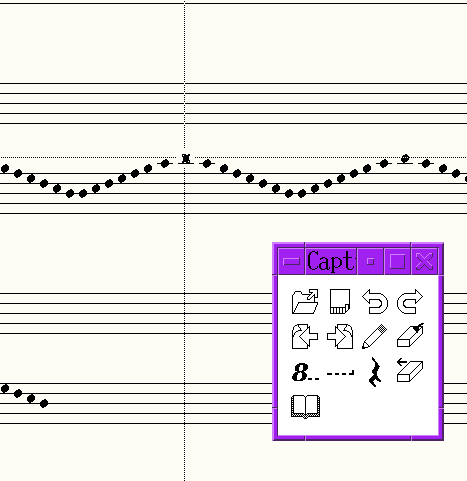

  • MIDI capture & bars
    lion mclionhead • 12/23/2025 at 05:10 • 0 comments
    By the time 1 month had gone by, it was clear that the peanuts xmas song would not be transcribed in time.  Lion readable music notation from MIDI is a hard problem.
    Reverse engineering the MIDI protocol from hex dumps instead of formulating an AI prompt, revealed the start codes are ored with 0x80.  All the other data is limited to 0x00-0x7f.  The packets are variable length.  Sometimes they're 4 bytes ending in 0.  Sometimes they're 3 bytes.
    The 1st step was using the right pedal to go forwards 1 note & the left pedal to go backwards 1 note.  The right pedal needed debouncing in the form of 2 analog levels.  The left pedal seems to have hysteresis of its own.
    Then to do cross development on raspberry pi, it became clear it needed to switch between single monitor, dual monitor, & 3 page single monitor mode at runtime.  3 page single monitor remanes a notional mode if lions can ever afford enough space.

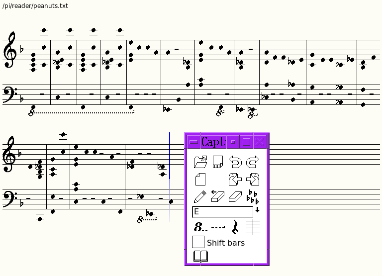

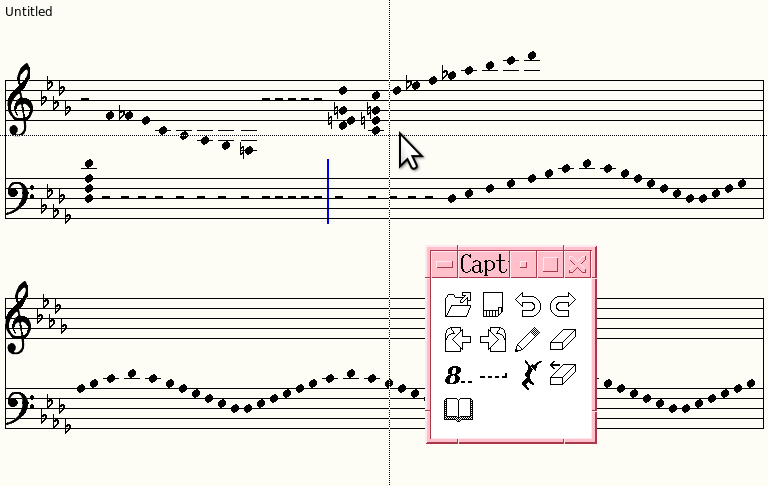

    Managed to get some peanuts transcribed by capturing MIDI keypresses.  A lot of behaviors have yet to be fixed, manely more 8va corner cases, undo stack corner cases, accidental corner cases.

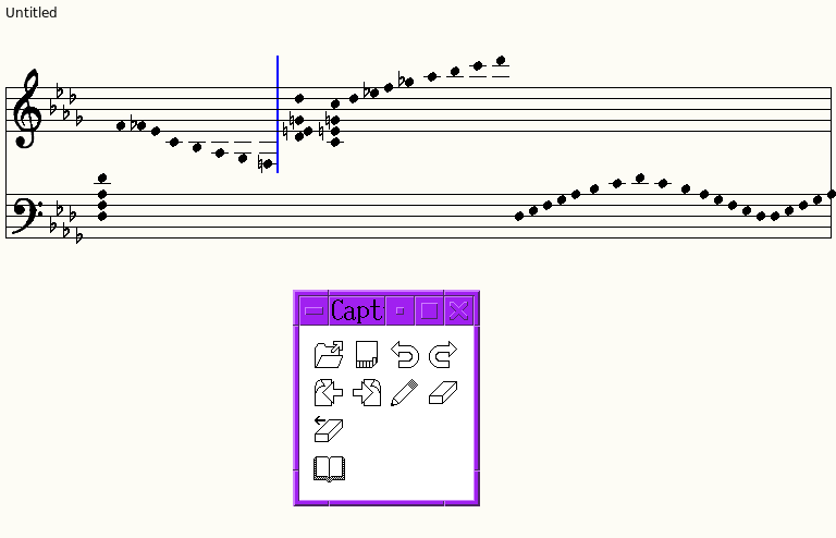

     It quickly became clear that it needed some minimal indication of timing or measures.  The reason we have bars is the same reason serial data has start bits.  The trick is an object which spans all the staves.  The bars could be in a 3rd staff, which leaves a need for the user to manually shift them sideways without a time signature.  We have rests to shift notes sideways.
    The top staff could be designated as the bar staff & they would follow only edits in that staff.  The problem is the time values in the bottom staff still need to skip the bar time.  The bars in a 3rd staff could just follow the time values in the top staff.  There's no dragging, dropping, cutting or pasting of objects in the score.  There are only rests for horizontal alignment.
    The easiest solution ended up being separate bar objects in all the staves, with the polygons & time shifting based on the top staff.  All the edit operations need a unique, quirky behavior to update the bars & 8vas.  Edits below the 1st staff would shift everything besides the bars while edits in the 1st staff would shift the bars in all the staves.  Deletion & insertion of the bars themselves would shift everything in all the staves.
    Ended up requiring the user to specify when edits shifted the bars.  Adding a note in 1 staff would entail checking the option, adding the note in 1 staff, then unchecking the option & adding a rest in the other staff.  The mane problem is the lack of any timing information preventing auto computation of the bar positions.  It might need a set of general drag & drop tools.
    The lack of measure wrapping means it can't draw bars on the sides.  Measure wrapping would create the problems of a measure that's too wide to fit on a single line or a case of no bars being defined.  Finale required the user to call a reformatting command to wrap the measures.
    The other big problem was playback of the source audio file from preset times.  This still needs a full computer.  No phone audio player has quite the same capability.  Minidisc recorders could create preset times, but modern phone players are only designed for consumption.  Then the phone output needs to be mixed with the piano output.  The lion kingdom would be so lucky if its minidisc recorder still worked. Went through 2 & all the spare parts.  The replacement gears suffered from some age related degradation.

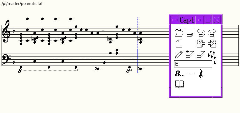

  • Changed file indicator, key signatures
    lion mclionhead • 12/17/2025 at 00:59 • 0 comments
    Updating the changed file indicator normally requires massaging the undo stack after every save so the current level is unchanged & all the other levels are changed.  Then every operation needs to redraw the changed file indicator.  For load operations, you have to either reset the entire undo stack, manetane a 2nd unchanged level in the undo stack, or just deal with a previous save operation now showing a changed file.  It's much easier to make load erase the undo stack & make every undo operation set the file to changed.
    Next came key signatures.  The difficulties there are handling key changes.  For proper notation, it has to draw a double bar & naturals for the previous key.  Of course, in a reduced notation it could stand to just draw the new signature in a different color.
    You have to add the key signature to both cleffs manually.  The trick is C major doesn't have a key signature, so key changes end up requiring naturals or it's another page we have to take from Music Construction Set by amending conventional notation.  Not sure how Finale handled the user entering a key change from C to C.  It would have needed a placeholder.  For now, key changes to C major are not supported.
    At this point, having certain objects with zero length & overlapping times started becoming more trouble than it's worth.  The trick is the cursor has to overlap the key signature to record the 1st note after the key signature.  If it's after the key signature, it inserts a rest & records the 1st note at beat 1.  If the time value is ever used for actual timing, it could be smart enough to factor in the object type in the playback time.  It could also have a distinct playback time/length & display time/length.  Every object needs to have a nonzero length in order to position the cursor after the last object.
    During this process, switched to XOR to indicate the active tool.  Vintage XOR interfaces are a lot more appealing now & for a user base of 1.
    It's not known if bars are required for the minimal notation system to be legible.  Lions would try going without & move on to MIDI capture.   It requires developing on the obsolete 800Mhz raspberry pi.  Compiling on a 166Mhz Cyrix went a lot faster than an 800Mhz raspberry pi.
    With MIDI capture, you're inserting notes into the current beat to build up a chord, then manually advancing a beat or rewinding  a beat with the page buttons.  After capturing a ways on 1 staff with just the keyboard & page buttons, rewind & start capturing the other staff with the trackpad.  Then insert rests to synchronize the 2 staffs.
    Of course, it would be nice to undo mistakes without the trackpad.  1 of the pedals could make it erase notes by MIDI code.

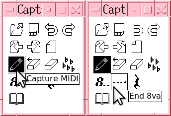

    8va would entail a drawing tool for the user to pick a start & another drawing tool for the user to pick an end point.   It picks the direction from which side of the staff you're on.
    Kind of an extension of Music Construction Set in that MCS didn't have an endpoint tool.  It tries to draw indicators for where the markers are going, but it doesn't draw ghost images of the markers like the annotation tools.  The markers shift the score around, because of the ledger lines.  It would be quite noisy if it constantly shifted the score to draw a ghost.
    Then came a delete tool for individual objects.  It would eventually be necessary to delete user defined accidentals while retaining the default accidentals.  That would entail dereferencing the note from the accidental bitmap.
    It's pretty hard to see what object is selected for deletion, but it tries with crosshairs & an xor box.

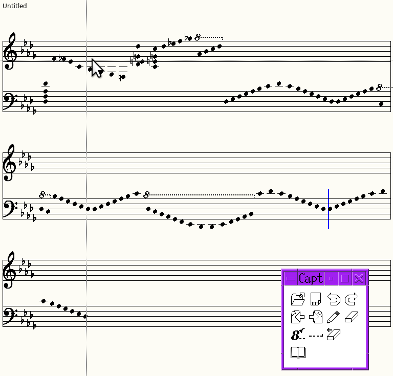

  • Line wrapping
    lion mclionhead • 12/11/2025 at 07:25 • 0 comments
    Managed to get minimal line wrapping to work.  That requires a lot of non manetainable, janky, spaghetti.  Cleffs, key signatures, 8va's have to be extended to each line.  There are glitches.  The mouse pointing is really bad.  The replicated cleffs on each line are off by a few pixels, but its far enough along to start letting more glitches slide in order to get somewhere functional.
    There's definite contention on the issue of letting bugs slide in order to get to minimal functionality.  On the 1 paw, we're supposed to be doing test driven development.  On the other paw, we're supposed to be making minimum viable products.  Lions have traditionally favored letting bugs slide to get to the finish line.  It was always about the requirements constantly changing, the low odds of it being finished, the low odds of anyone ever using it.  When working with other animals or making a high profile program with frequent uploads, you always have to keep up with the bugs, can't be finish line focused because in that case your quality of work is being judged.
    8va line wrapping was the next big one.  Professionally engraved music has the 8va's extend off the end of each line & restart on the next line without any special ending on the previous line.  Take every win you can get.
    Undo & redo would be the last step before finally moving into user defined notation.

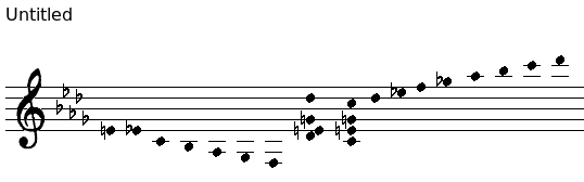

  • More staves
    lion mclionhead • 12/02/2025 at 06:21 • 0 comments
    Got it to show arbitrary numbers of staves.  The mane trick is aligning the beats in both staves.  Currently, it's hard coded to create 2.  Then came 8va symbols, which were a brute force coding job.
    Exercised it drawing lowest A & highest C.  It's going to need adaptive staff spacing, but it's going to be rarely used.

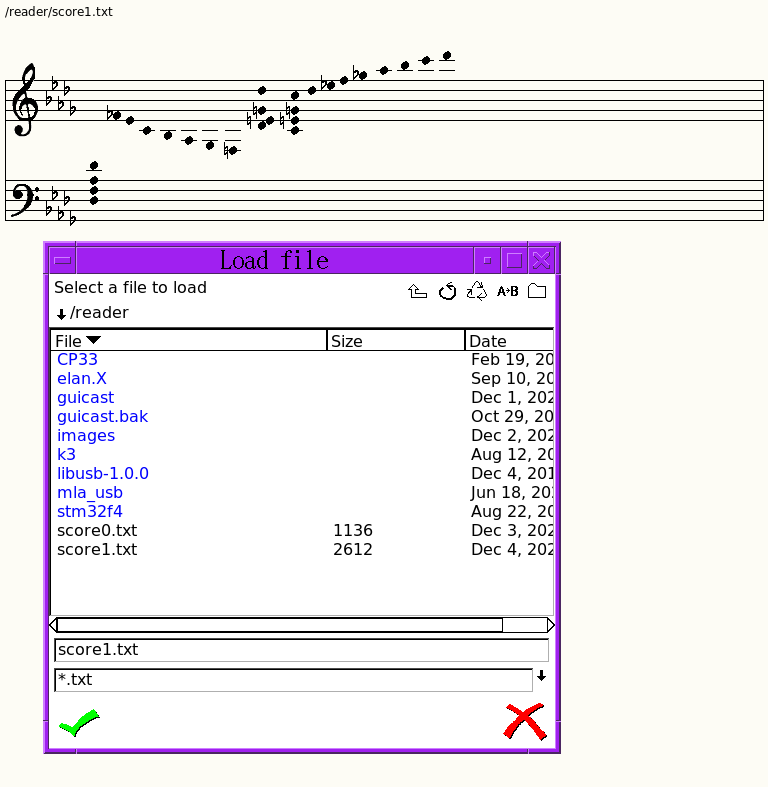

    All the drawing used X primatives & pixmaps instead of the more modern method of drawing on a bitmap & blitting or using a modern library.
    The next step was persistent storage.  Lacking a keyboard or desire to type with a mouse, it just automatically creates a filename.  The user has to ssh in & rename it.  This is what the headless sound recorders have always done & it works well.  https://hackaday.io/project/28716-ultimate-4-channel-audio-recorder
    Maybe it's time to make a web based file manager for all these headless programs, like webphone.
    Banging out the persistent storage reminded lions that the music reader program has been on raspberry pi for 5 years & it uses the same GUI library as Cinelerra.   Also, ffmpeg was easy to build on raspberry pi.   Cinelerra could easily compile on a 64 bit raspberry pi but it would need a KVM.
    Just text files with automatically created filenames.

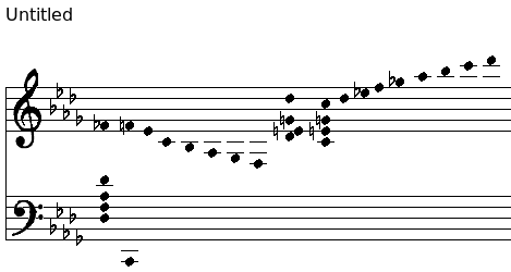

    After a solid week on this, the reality of how hard it is became clear.  When transcribing a MIDI keypress into human readable notation, there's a nasty translation through the current cleff, current key, current octave, current accidental.  It's a lot harder than dragging & dropping notes.  That's why the cheapest music entry programs are just type setters.
    Some diabolical algorithms managed to compute shortpaw notation directly from MIDI pitch codes.  A cleff & key still must be provided.  The trick with development is to create a database of synthetic MIDI codes with a variety of test cases.  Automatic prediction of the accidentals is still a black art.  Finale never chose perfect accidentals either.  It basically adds sharps if the key is flat & adds flats if the key is sharp.  It adds naturals if the closest position on the staff is a natural.
    Being shortpaw notation, the accidentals currently reset for every note.  It still probably needs to indicate canceled accidentals to be readable.
    Of course, what we really want is the least number of accidentals.  This requires applying knowledge of all the preceding accidentals in the measure, a diabolical problem indeed.
    The general idea is the pitch code is going to be fixed & can only be set through MIDI capture.  The theory is the user would manually override the automatic accidentals by dragging & dropping a new accidental.  The indicated note would move up or down by the necessary amount for the new accidental to result in the same pitch that was captured.
    A few more days led to an algorithm which always draws accidentals if they're different than the key signature.  If they're the same as the key signature, it resets the accidental once.  The next step would be user defined accidentals.
    In this case, MIDI code E + a user defined flat caused it to draw F flat.  Then MIDI code F with no accidental made it draw a natural.  The idea is the MIDI code being fixed & only the notation changing based on the addition of an accidental.  The next step would be supporting a bass cleff, with the option to change the number of staffs at different times.
