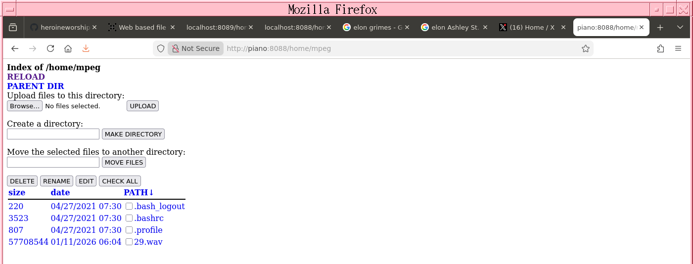

Web based file manager
Graphical filesystem interface for headless devices
The lion kingdom had been using the hell out of its web based file manager for android since 2020
https://github.com/heroineworshiper/webphone
Meanwhile, the number of headless raspberry pi appliances grew.  Sound recorders, music displays, MIDI capture programs, robotic cameras all required managing local storage but couldn't justify a full keyboard & monitor.  Ssh was becoming inconvenient for the growing number of devices & these devices would probably get more use if the file management was more convenient.
The breaking point was the MIDI capture program.  That needed a way to rename & delete files.

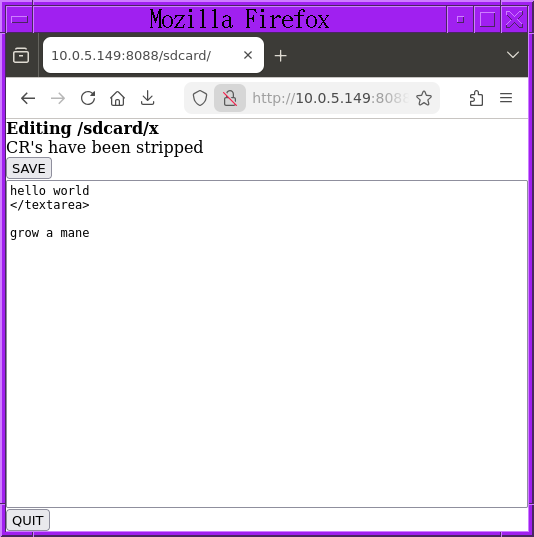

    Copied the last C++ changes to the android version.  The Java SE version seems rather pointless now, other than a demo of an android program running in Java SE.
    Manely, editing trick tags in the text editor.

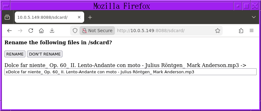

    Renaming 1 particular filename with a character the browser would encode as 0xf6 instead of 0xc3 0xb6
  • UTF-8 corner cases
    lion mclionhead01/21/2026 at 06:20 0 comments
    Had a case of the browser converting  & # 246 ; in a NAME field to 0xf6 in a ContentDisposition instead of the UTF-8 encoding 0xc3 0xb6.  The filesystem stores 0xc3 0xb6 so it couldn't find the filename & crashed.  The only way to know it wasn't UTF-8 was to detect 0xf6 followed by an ASCII character.
    The current hack is to convert all characters >= 128 in the ContentDisposition text to UTF-8 so they match the filesystem.
    It may be that NAME & HREF don't support UTF-8 at all & the  handling of & # is just undefined.  It's another case where the ideal solution is encoding all the filenames in the NAME & HREF as hashes instead of HTML.  Then the ContentDisposition would be converted from the hashes directly to the original filenames.
    Helas, the rename operation in WebPhone somehow ended up putting the 0xf6 character in the filesystem instead of 0xc3 0xb6.  It wouldn't display anymore in xterm, while webphone properly converted it in the browser.  Then it could no longer rename the 0xf6 encoded name to anything else.  It appears the ContentValue still had a 0xf6 that wasn't converted.  The only way anything can read the file anymore would be moving webphone to hashes.
    Ended up moving all the NAME values to hex but HREF still had to be HTML encoded to be compatible with manually entered URLs.  Moving the NAME values to hex made it easier to detect when a value was a __ command instead of a filename, but only in the C++ version.  The Java version had to stay with HTML encoded NAME values, since java doesn't expose the UTF-8 encoding.  It only exposes ints.
    Noted another problem where the touch command couldn't find the filename containing 0xc3 0xb6 so lions couldn't reorder a directory by date.  It made lions ponder adding a touch command to webphone.
