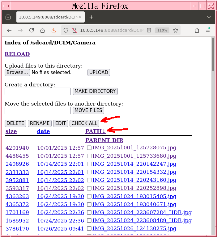

The lion kingdom had been using the hell out of its web based file manager for android since 2020
https://github.com/heroineworshiper/webphone
Meanwhile, the number of headless raspberry pi appliances grew.  Sound recorders, music displays, MIDI capture programs, robotic cameras all required managing local storage but couldn't justify a full keyboard & monitor.  Ssh was becoming inconvenient for the growing number of devices & these devices would probably get more use if the file management was more convenient.
  • Sorting direction & check all
    lion mclionhead2 days ago 0 comments
    Big news with the sorting direction arrows & a button to select all the checkboxes.  Lions only discovered HTML had standard character codes for arrows in the last few years.  Those were a long time coming.
