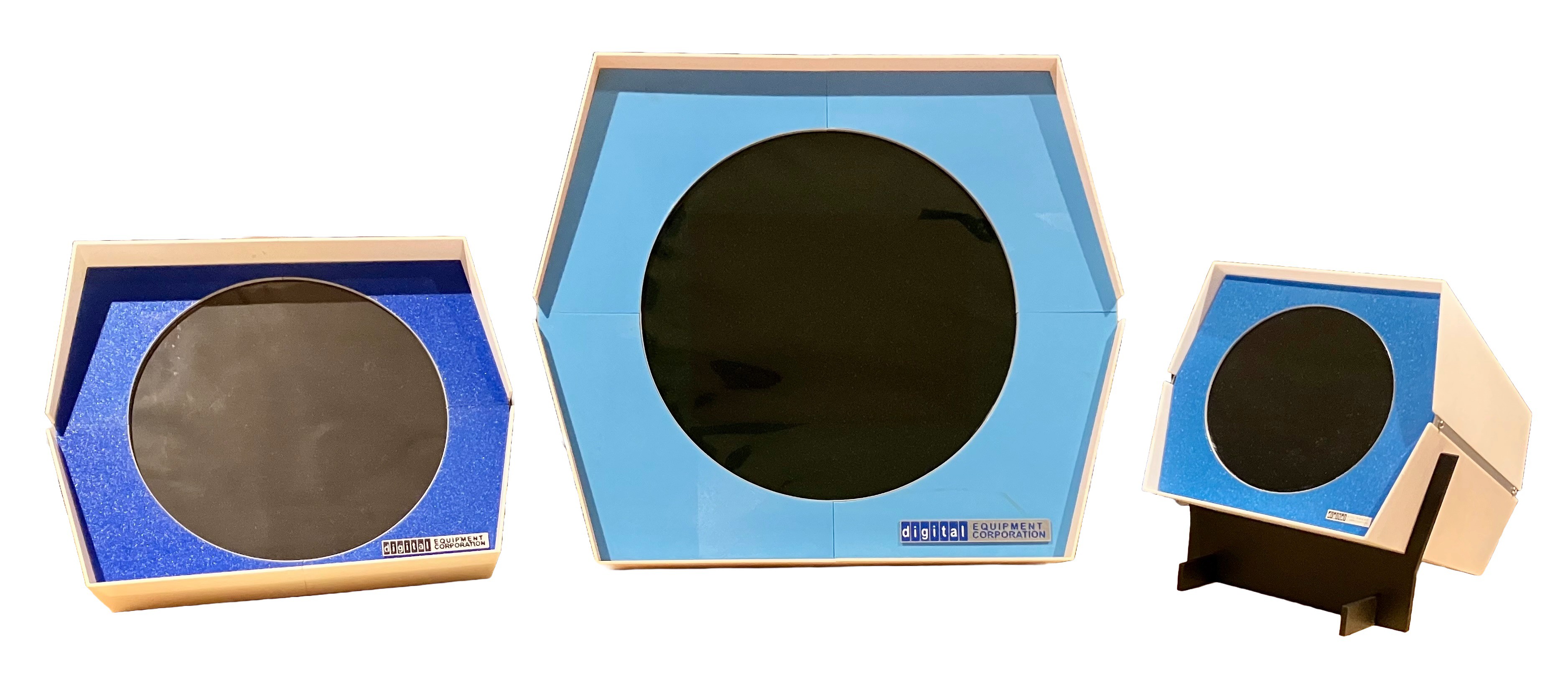

My first instinct, given that I mostly make reproductions myself, was to create a DEC Precision CRT Display Type 30 Reproduction since the PDP-1 was already well in hand. I ended up making three reproductions of this unique Type 30 Display that was used with the PDP-1.
Why three?
  1. DEC Precision CRT Display Type 30 Reproduction - When I made this first version I was under the impression that the PiDP-1 was a 2/3 scale Replica of the original.  I later found out that PiDP-1 is actually at 57% scale plus I had based my model on an invalid assumption w.r.t. the circular screen opening size. Long story short my reproduction was actually at 75% scale and it's big. Too big for my desktop but it will be great for Spacewar! games at my local retro computer meetings.
  2. Honey, I Shrunk the Type 30 Display Reproduction - I wanted to make a smaller display so I zeroed in on a 50% scale model. Why 50%? Because at that scale a Pimoroni PIM-372 8" 4:3 Display could be easily installed.  Later when I factored in my invalid circular screen opening size I realized that the scale was actually 56%, an almost perfect match to the PiDP-1.
  3. Another Type 30 Display Reproduction At 36% Scale - When I started my Type 30 reproduction project(s) I sent a request to the Computer History Museum (CHM) through their contact page asking if it would be possible to get some measurements of the Type 30 display. In mid-October 2025 I received a reply from a wonderful archivist at the CHM who kindly agreed to take some measurements for me. Based on those measurements I decided to make one last Type 30 display.  I chose 36% scale to accommodate a Waveshare 5 inch HDMI Circular Touch Display which other PiDP-1 enthusiasts were using. Because of the relatively small size I decided to model the whole display not just the front part. It was the CHM measurement that the circular screen opening was actually 14" that made me realize that my assumption of a 16" opening based on my misreading of the Precision CRT Display Type 30 manual was wrong, and I had to recalculate the scales of my first two attempts.

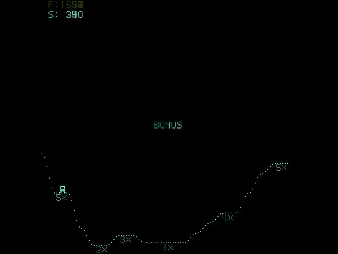

    Upon a sixth successful landing on the last unique target, after the normal score and fuel animations, the player will see the following screen counting up the score with 1,000 additional points.
    That's OK I guess but it feels a little underwhelming for such a monumental achievement right? After a little thought I realized that this was a fireworks moment.  So I began playing around with a fireworks effect. Here is what I came up with.
    Still a work in progress but at this point I decided to try and incorporate the code into Lunar Lander.
    Much to my disappointment the additional code will not fit into the 4K memory limit of the PDP-1 without using the paged memory system (which I do not want to do for this project).
    Sigh. I might at some point continue to work on fireworks as a stand alone demo. Lots of room for improvement.

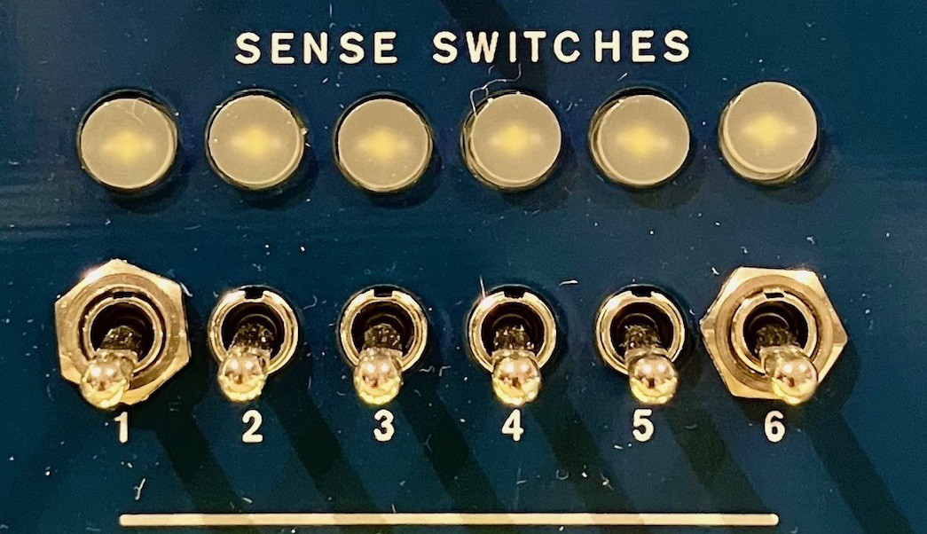

    I added a mechanism for restarting Lunar Lander at any point while the game is running. It won't work from the GAME OVER screen (you can just click any button on the game controller) or the NEW GAME screen (game is already restarted).
    To restart Lunar Lander to the NEW GAME screen while playing, simply change the state of Sense Switch 1.  So if it's ON turn it OFF and vice-versa.
    The PDP-1 has a single instruction for determining the state of a Sense Switch.
    Instruction   Code #            Explanation
        szs       6400s0      Skip on ZERO Sense Switch.
    Where  s  in the code is the switch number 1-6.
    I added the following code in the New Game setup section.
    sw1, 0         / Value of Sense Switch 1 at the start of a game.
    / Get the current state of Sense Switch 1.
        dzm sw1    / Default sw1 to 'off'.
        lac (1     / Value to set if Sense Switch 1 is "on".
        szs 10     / Skip if Sense Switch 1 is already off.
        dac sw1    / Set sw1 to "on".
    Then at the start of the main game loop I added the following.
    / Check for restart signal.
        lac (0     / Default to Sense Switch 1 "off"
        szs 10     / Skip if Sense Switch 1 is off.
        lac (1     / Set to Sense Switch 1 "on".
        sas sw1    / Is Sense Switch 1 still in the same state?
        jmp ngm    /   No - Restart the game.
                   /  Yes - Keep playing.
    I did not want to tie the reset signal to a specific state of the sense switch (ON or OFF)  so that the game would start correctly no matter what the initial state was.

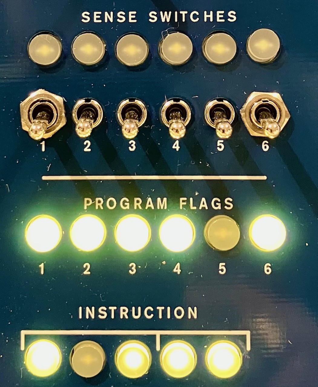

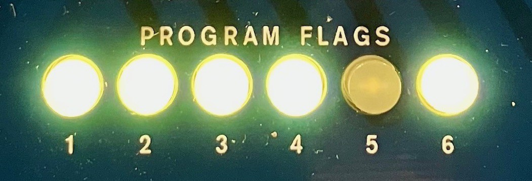

    I added a 1000 point bonus for safely landing on all six zones in a single game. If you are meticulous like me you will probably attempt the zones from one side to the other in order and thus never lose track of which zones have been successfully conquered. On the other hand a better strategy might be to try the zones you find easiest first and might then forget which zones you have completed.
    I have repurposed the Program Flags to light up upon each successful landing. The six lamps are now mapped to the six landing zones (from left to right) in the order they appear on the screen.  I was using the Program Flags to keep track of some internal bookkeeping but now think that this is a better use of the feature.
    So the player above is one safe landing (in the fifth zone from the left) from getting a 1000 point bonus. Let's wish them luck because at this point they are for sure running low on fuel.
    I wasn't expecting this, but it turns out that there is something very satisfying about seeing a physical "contact light" turn on when you have successfully landed. Who knew.
    The contact light on the Apollo Lunar Excursion Module (LEM) was an indicator in the cockpit that illuminated when one or more of the 67.2-inch probes extending from the footpads touched the lunar surface.
    I posted the updated code to the Files section above.

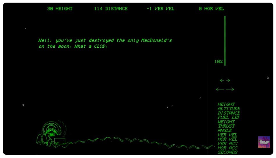

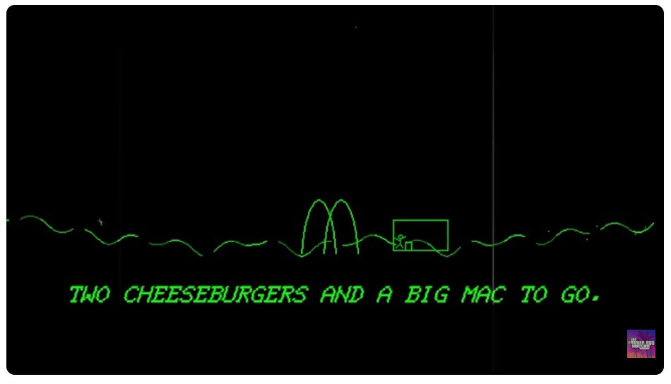

    I was having a discussion of my Lunar Lander game with someone in the PiDP-1 Google Group, and they asked if my version had a McDonalds? I was a little confused so I did a bit of research. It turns out there was a 1973 version of Lunar Lander (called Moonlander)  for the DEC GT40 (in essence an all-in-one PDP-11 with a VT11 graphics system and a display) that featured a McDonalds as an Easter egg.  You had to "fly" to the right-most edge of the scrolling moon terrain to find the McDonalds (with golden arches).  If you inadvertently (or purposefully) crashed into the McDonalds the game displayed the following message:
    Upon successfully landing near the McDonalds, an astronaut would debark the LEM, go into the restaurant, and order..
    then walk back to the LEM, get in, and fly away. Hilarious.
