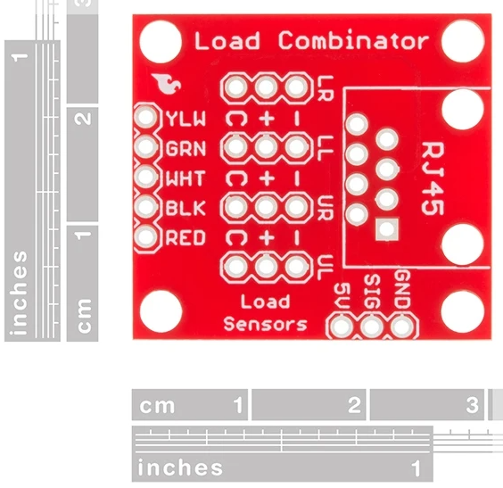

    For the Wheatstone bridge, I plan to use this SparkFun Load Sensor Combinator.
    That has a footprint for an RJ45 socket, which I'll use for connecting this board to the rest of the circuitry. A couple of years ago, for an unrelated project, I bought a couple dozen PCB mount RJ45 sockets that I never got around to using. When I grabbed them to check the dimensions, I discovered that they were top insertion orientation, which is a geometry that's not going to work in this scenario. So, I've now ordered some more PCB mount RJ45 sockets, but with side-insertion orientation. With that RJ45 socket, space will be tight if I attach the board under the scale, so I will probably have to provide some load sensor foot extensions of a quarter inch or whatever for ground clearance.

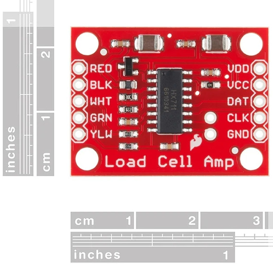

    The cable from that board will go to an amplifier board. For that amplifier, I'll use the SparkFun Load Cell Amplifier - HX711.
    That board does not have a footprint for the RJ45 socket, but it does expect the same signals as output by the combinator board.

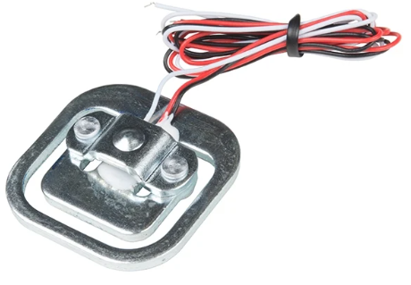

    For a while, I was thinking about taking my Dremel to the plastic casing and hoping that inside would be something wonderful (for me). I'm now changing my mind for a different approach. In all of the scales, there is easy access to the gadgets on the four corners. They all look like pretty generic load sensors similar to this one (available from Sparkfun  and many other places):
    The folks at Sparkfun have also provided some straightforward information for interfacing to load sensors, singly or in a quad setup.
