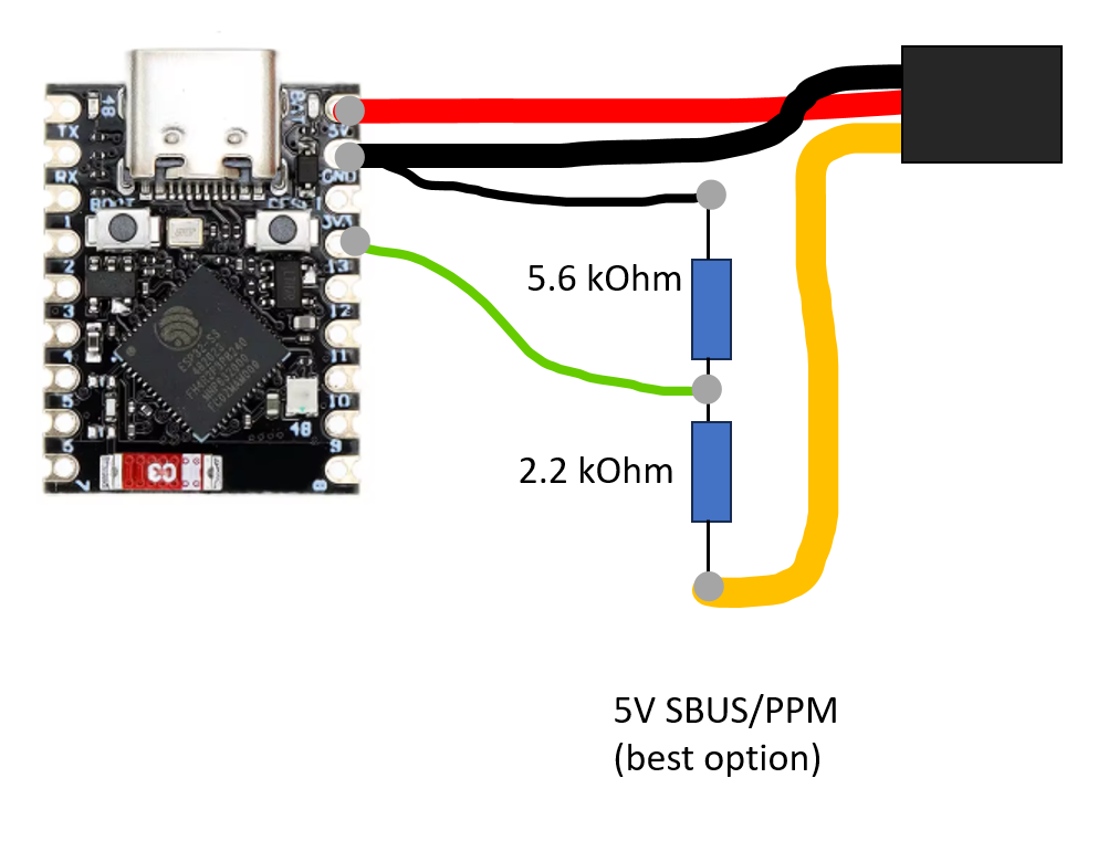

 solder a servo wire red to +5V, black to GND, white (SBUS signal) to GPIO 13 (right column just under 5V, GND, 3.3V)
 (in case your RX has a 5V logic, just add a resistor bridge  in serial to the signal pin)

 the LED shows the status of communication:
  - flashing blue/purple/yellow  : searching protocol : no signal is received, either the RX is not connected or the radio is OFF
  - solid cyan : the PPM signal is received and valid
  - solid purple : SBUS signal is received and valid
  - solid red : the TX signal is lost, failsafe is active
