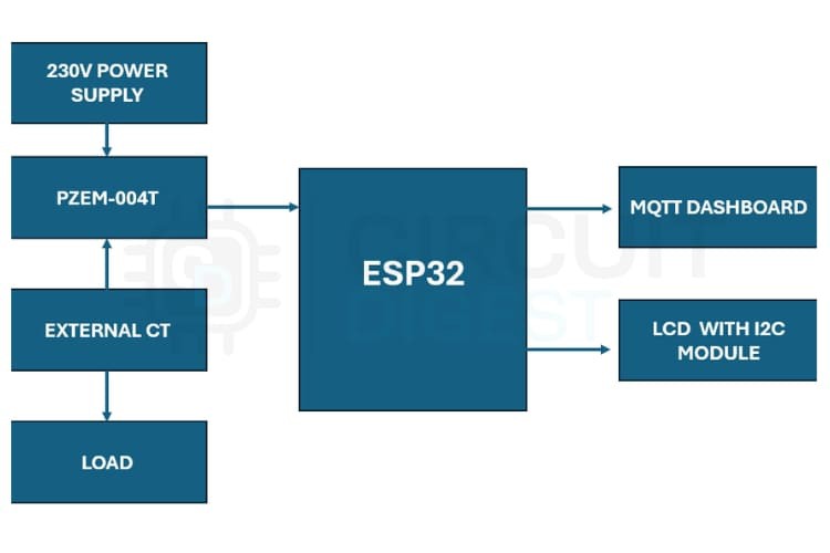

Sensors & Data Flow
  1. PZEM-004T measures AC parameters using a current transformer and internal metering chip.
  2. The ESP32 polls these values over UART (Modbus) and updates the LCD.
  3. Readings are sent over Wi-Fi to an MQTT broker where a web dashboard displays them in real time.
  4. If a condition exceeds a threshold (e.g., voltage spike), the ESP32 calls a cloud API to send an SMS alert.

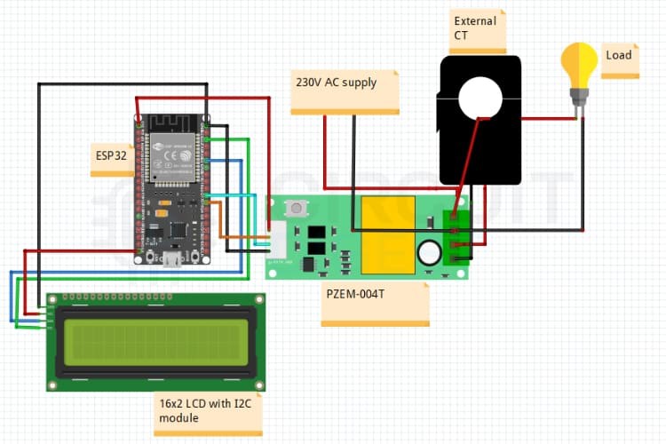

Circuit Summary
  • ESP32 RX/TX ↔ PZEM-004T UART
  • I2C (SDA/SCL) ↔ LCD for local readouts
  • Power from 5 V supply
  • CT around live conductor for current sensing
No mains is wired into the microcontroller — the PZEM module isolates the high voltage side.

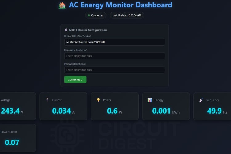

Dashboard
The dashboard (HTML + CSS) displays real-time values for all major electrical parameters. It connects to a public MQTT broker and auto-updates UI elements as new data arrives.
