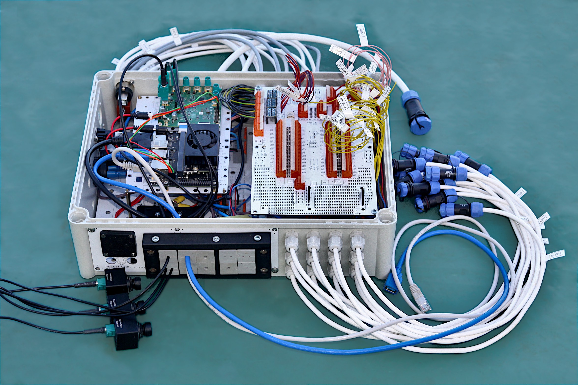

    WEEDINATOR Ai Camera Control Box (Box 2)
    Weedinator Camera & Control Box Components

    Step by step video instructions on how to assemble the components onto the WEEDINATOR MCU PCB.
    This guide covers the assembly process for the WEEDINATOR MCU PCB, moving from precision surface-mount work to robust through-hole connectors.

    Populating the 20 Channel High-side Switch PCB
    PCB Design and Enclosure Logistics

    Enclosure Layout and Component Placement
    The current prototype assembly (Box Two) includes the 20-channel high-side switch PCB, the MCU board, a fuse box with LED fuses, the Jetson Nano, and the camera de-serializer board.
    Key Layout Considerations:
    • Space Constraints: Because this unit (Box Two) is designed to sit flush against "Box One" on the robot, one end of the enclosure must remain completely blank. No components or connectors can protrude from that side.
    • Thermal Management: Cooling fans are positioned in opposite corners to create cross-flow.
    • EMI Interference: It is crucial to keep the cooling fan away from the MCU. Fans can cause signal degradation and electromagnetic interference (EMI) if they are too close to sensitive logic circuits.
    Cable Entry and Gland Strategy
    I am using a modular panel system to organize external connections. This allows for a clean, organized entry point for various wire gauges.
    • Gland Sizes: I’m primarily using 12 mm glands for standard wiring (supporting up to 12 holes in a tight but functional cluster) and 16 mm glands for larger cables.
    • Split Gland System: For USB and camera cables, I’m using "tech glands" (split glands). These are essential for FAKRA connectors found on the cameras; since these connectors are permanent, they cannot be threaded through standard holes. The split gland allows the cable to be slotted in and then sealed.
    • XLR Fittings: I’m using XLR-style housings for the Jetson's DisplayPort and USB ports. While handy for temporary monitoring, they are more prone to shaking loose than fixed glands, so they are reserved for non-critical or temporary connections.

    Project Progress: Wiring and Housing Preparation
    Drilling and Enclosure Strategy
    I have finished drilling all the necessary holes in the enclosure. I’ve intentionally drilled about 50% more holes than currently required. In my experience, trying to go back inside the system to rewire or add features later is an absolute nightmare, so having those spares ready is critical.
    I’ve included a large slot for icote split glands. These are great for Ethernet and USB cables because they allow you to pass cables through without having to remove the connectors or couplings. Speaking of connectors, I’ve learned the hard way never to mount the connectors directly into the enclosure holes; it's much better to use a system where the couplings stay outside the box.
    Critical Technical Note: Brass Inserts
    If you are using brass inserts (specifically the type from RS Online), the drill size is absolutely critical.
    • Required Drill Bit: 5.7 mm
    • Warning: If you use a smaller bit, such as 5.5 mm, the screw will lock into the insert during installation, and you will never get it out again.
    Component Assembly and Labeling
    I am now ready to assemble the internal components. The fuse box can stay on, and I’ll be using standoffs for the rest of the parts.
    I’m currently installing a 20-channel high-side switchboard. I have already wired the eight channels on the lower PCB. Proper labeling is essential here; every logic cable and board position is labeled (e.g., "Relay 1," "Relay 2"). Without these labels, it would be impossible to keep track of the system.
    Current Status and Next Steps
    The total channel count is now at 28. The system is expandable; I could stack another PCB to add another 20 channels if needed, though I haven't reached that requirement yet.
    The logic cables are tucked in and routed to one side to keep the layout tidy. I am going to finish connecting the remaining wires and fasten the board down before moving on to the next phase.
    PCB Layer Cake: Assembly and Cable Management
    Layer 1: Switchboard and Power Supply
    The board is currently partially wired with eight channels completed and twelve remaining. I have meticulously labeled everything to ensure clarity during assembly.
    Cable Routing Strategy:
    • Rear Routing: All wires are tucked neatly behind the board rather than across the top.
    • Hinge Accessibility: By keeping the top clear, the board can "hinge" upward if you ever need to access components underneath (like replacing relays) without disconnecting the entire system.
    • Power: The 12V supply comes from the fuse box through a general-purpose connector. While some pins are currently unused, they are ready for future expansion.

    • 1.5 mm²: Used where cables double up.
    • 2.5 mm²: Used for groups of four connectors and the main common lines routing back to the base.
    Enclosure Constraints and Flexibility
    Space is becoming tight on two sides of the enclosure because this unit butts up directly against "Control Box 1." Consequently, I’ve had to leave eight channels unwired for now, though they remain available for immediate use if needed.
    Split Gland System: I am using a flexible rubber grommet/split gland system for the network and camera cables.
    • No Cutting Required: This system allows you to pass fat camera cables through the enclosure without cutting the connectors off.
    • Scalability: Each grommet can potentially hold two wires, doubling the capacity of a standard 10-way entry.
    • Dedicated Ports: I’ve reserved four glands specifically for the encoder wires and motor controllers coming off the main MCU board.
    Next Steps
    The MCU board is ready to be bolted down onto the standoffs. Once secured, I will begin routing the long logic cables to their respective terminals on the far side of the enclosure.
    Power and Motor Control
    We’ve made significant progress on the motor wiring and power monitoring:
    1. Wiring Gauges: The motors are wired with 1.5 mm cables, supported by a 2.5 mm main feed to the master switch.
    2. Voltage Monitoring: I’ve installed a handy voltage meter. This is vital for monitoring the health of the battery and confirming the alternator is outputting its expected 14.8V.
    3. Motor Control: The PWM and direction connections use pink color-coded cables routed under the board. These control a dual-channel motor controller, which currently operates a prototype pan-tilt mechanism for our safety cameras.
    4. Motor Polarity: The motor cables are twin-core; if the direction is reversed, simply swapping the connections will fix it.
    Jetson Nano & Vision System
    This box serves as the hub for our vision and processing via the Jetson Nano.
    1. FAKRA Vision System: We are using TechNexion FAKRA cameras rather than standard Raspberry Pi cameras.
    2. Durability: They are waterproof and support long cable runs (up to 15m).
    3. Configuration: We have three connections—one for the front safety camera, one for the rear, and one dedicated to crop detection on the cultivating machine.
    4. Performance: Currently achieving approximately 15 FPS per camera.
    5. Connectivity: * A DisplayPort cable is routed to the exterior for screen communication.
    6. Spare USB ports are available for a wireless keyboard/mouse.
    7. An icote split gland system is used for all USB, Ethernet, and camera cables to avoid cutting connectors and maintain waterproof integrity.
    MCU Communications and Logic
    The Jetson Nano acts as the "Master," communicating via USB (the blue cable) to the local MCU and the MCU in Box One.
    1. Logic Level Shifting: Since the encoders operate at 5V and our system runs at 3.3V, I’ve integrated logic level shifters.
    2. Timer-Based Pins: The MCU is very specific about which pins it uses for encoders and PWM because they are timer-based. We have identified three encoder-compatible pins and are auditing the manual to find more.
    Final Weatherproofing
    To wrap up the hardware side:
    1. The de-serializer board is confirmed to be 14.8V tolerant, making it safe for direct alternator power.
    2. I am installing blanking grommets in all unused holes. This is a small but critical step to keep insects and debris out of the enclosure, which could otherwise cause shorts as they grow or nest.
    MCU Configuration and Pin Mapping
    Encoder and PWM Trade-offs
    I’ve integrated four-core cables for the encoder channels. While an initial LLM analysis of the datasheet suggested a theoretical maximum of 10 encoders and 4 PWM outputs, there is a clear trade-off between these functions. Through experimental verification, I’m aiming for a balanced configuration—likely 8 encoders and 6 PWM outputs.
    The system currently uses logic level converters to handle 5V encoders. Note that 12V encoders would require custom wiring in the provided "hackable space" on the board.
    Current Pin Assignments: | Function | Component | Pins | | :--- | :--- | :--- | | Encoder 1 | Input | PA0, PA1 | | Encoder 2 | Input | PE9, PE11 | | Encoder 3 | Input | PD12, PD13 | | Encoder 4 | Input | Testing in progress | | PWM | Speed Control | PE4, PA5, PC7 |
    Modular Hardware Adaptations
    The beauty of this system is its modularity. Although this is "Box Two" (the Camera Box), it can be adapted depending on the rig requirements:
    1. Motor Controllers: Currently, I only have one dual-channel controller for the pan-tilt cameras. However, there is room to bolt on 3 to 4 single-channel controllers if needed.
    2. GPS Integration: While this box doesn't use it, the board is designed to support a bolt-on GPS system.
    3. Stacking: There is potential to raise the PCBs using standoffs to insert additional layers, such as extra motor controller boards, above or below the current stack.
    Physical Clearances and Enclosure Fit
    With the lid on, the FAKRA camera cables present a height restriction. They exit the de-serializer board vertically, meaning the Jetson/Nano PCB stack cannot be raised much higher without putting stress on the connectors or requiring a sharp bend in the cables.
    I estimate there’s about 30mm of vertical play available, which might just be enough for one extra layer of motor control if I’m careful with the routing.
    The Full Rig Setup
    In the final configuration, this Camera Box (Box Two) will sit alongside Box One. Box One is identical in size but omits the Jetson and de-serializer board to provide maximum real estate for heavy-duty motor controllers and the primary GPS system.
