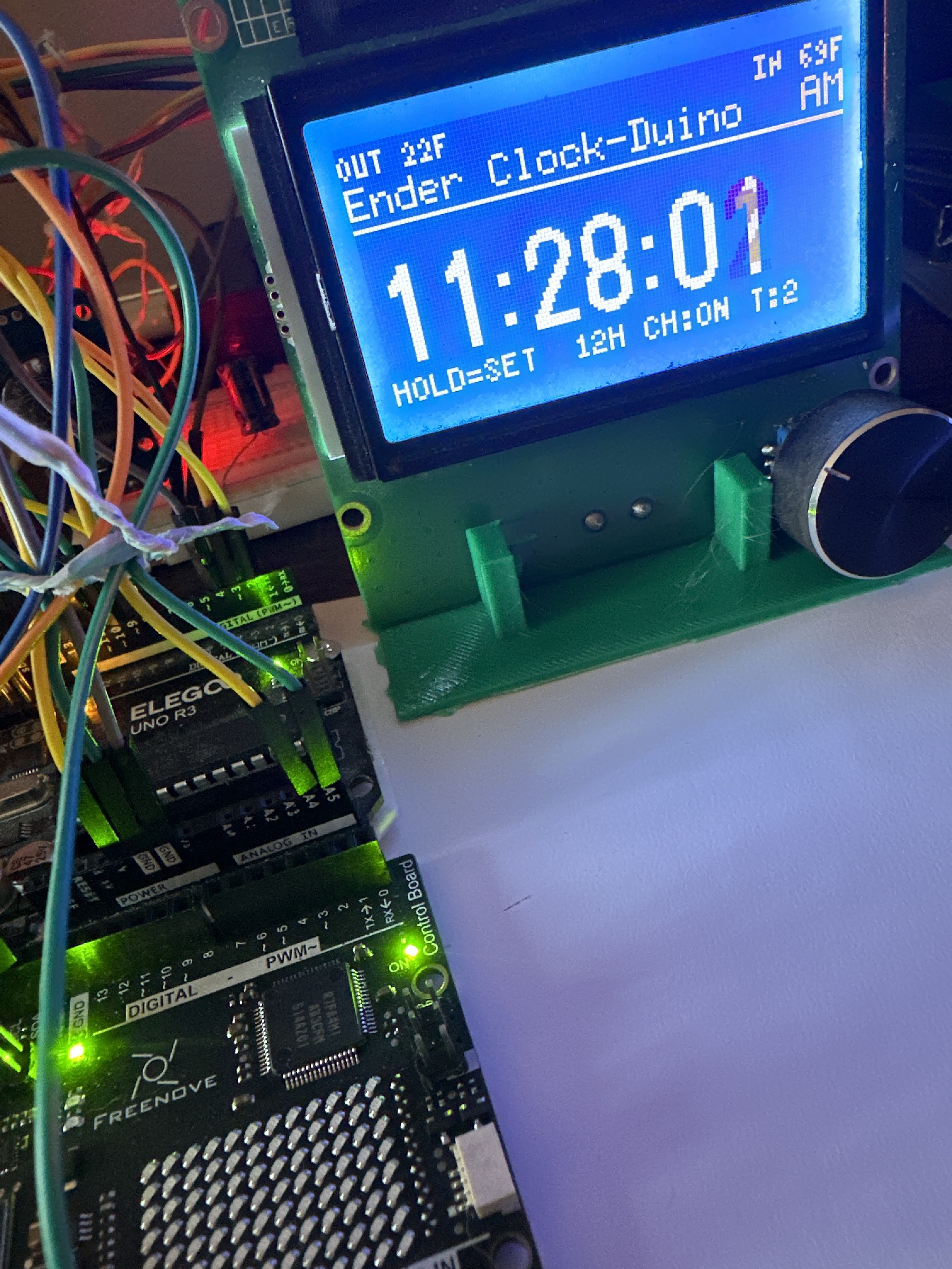

Hello World! This project is an Arduino-based clock that repurposes an Ender-3 Pro printer display and rotary encoder into a permanent, appliance-style timepiece. The ST7920 LCD is driven over hardware SPI using U8g2, and the encoder is handled through interrupts for responsive and accurate input. Timekeeping is provided by a DS3231 RTC module, ensuring long-term accuracy and retention across resets and power loss,while EEPROM is used to store user settings so configuration persists without reentry. The interface uses a 12-hour time format with a clear AM and PM indicator and provides audible feedback through a piezo buzzer using tone variation rather than simulated volume control. The system is designed to be stable, predictable, and capable of running unattended for extended periods, treating reclaimed hardware as functional hardware rather than obsolete part's.This is an evolving project.Now Includes weather from attached Arduino R4 Via wireless network in a master slave set config.
This project uses an Arduino Uno R3 board with an original Ender 3 Pro control panel LCD. The Arduino is driving the ST7920 LCD over hardware SPI and handling the integrated rotary encoder via interrupts for reliable input. Timekeeping is provided by a DS3231 RTC module to maintain accuracy across power loss, while user settings are stored in EEPROM so configuration persists without reentry. Audible feedback is implemented with a piezo buzzer using distinct tone patterns for interaction cues.
Firmware developed collaboratively using AI-assisted code generation, with system architecture, behavior, integration, testing, and refinement by me :)

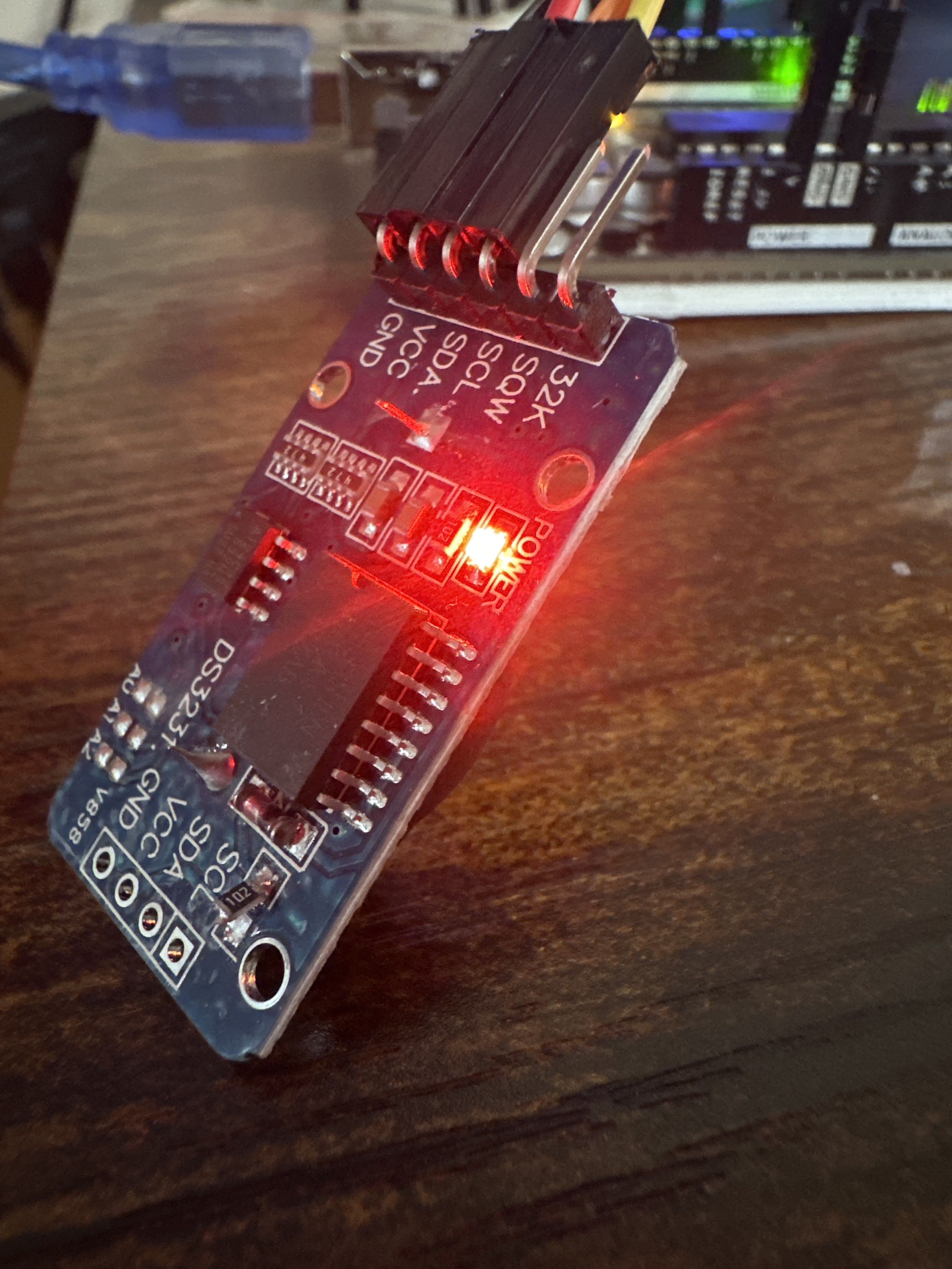

  • 1 × Elegoo Uno R3 Arduino R3 Clone
  • 1 × ST7920 Display Spare Stock Ender 3 LCD Display
  • 1 × Ender Clock-Duino Stand See links to download .stl file
  • 1 × Breadboard Electronic Components / Misc. Electronic Components
  • 1 × Assorted Jumpers

    Project Log — Stardate 1Dot22Dot25
    R3 Master / R4 Slave configuration is operational. Primary system objectives have been met and baseline functionality is confirmed. Minor firmware anomalies remain and are currently under evaluation.
    Network connectivity is established; however, after extended operational periods the connection becomes intermittent and may disengage unexpectedly.
    System startup sequence is presently order-dependent. The R4 Slave must be powered prior to the R3 Master for proper clock output to render on the Ender-3 Pro display.
    Automatic external temperature updates are functional but exhibit inconsistent refresh behavior, indicating a possible synchronization or timing issue between devices.
    An alpha release of both firmware components will be published shortly to support collaborative review, testing, and external input.
    Overall system status remains stable. Continued observation and incremental firmware refinement are in progress.

  • Ender Clock-Duino Sketch w/ DS3231
    Rhea Rae • 01/19/2026 at 19:53 • 0 comments

  • DS3231
    Rhea Rae • 01/15/2026 at 17:05 • 0 comments
    This DS3231 RTC module includes a charge path intended for a rechargeable LIR2032, implemented using a small series resistor and a glass diode feeding the VBAT node. Since I am using a standard CR2032 (non-rechargeable), I disabled the charging path.
    To do this, I identified the resistor located directly next to the glass diode associated with the battery circuit (both resistors on this board are marked “102”). I lifted one leg of the resistor that feeds the diode, effectively opening the VCC → VBAT charging path while leaving the battery connected to the DS3231’s VBAT pin.
    After lifting the resistor, I installed a CR2032 coin cell, set the time, unplugged the clock for several minutes, and then re-applied power. The RTC retained the correct time, confirming that VBAT backup is functioning normally and that the coin cell is no longer being charged from VCC.
    This modification prevents unintended charging of a non-rechargeable coin cell while preserving full RTC backup operation.
    -RR

    If screen is scrambled switch pin D13 and D11.
    -RR
  • ST7920 Pin-Out
    Rhea Rae • 01/12/2026 at 18:25 • 0 comments
    Use EXP 3 Header!
    -RR

    Wiring Table Ender 3 Display to R3
    Wiring Table
    Ender EXP3 Pin Connect To
    5V5V
    GNDGND
    Chip SelectD10
    DataD11
    ClockD13
    Knob RotationD2
    Knob Rotation 2D3
    Knob ButtonD4
    BeeperD8
