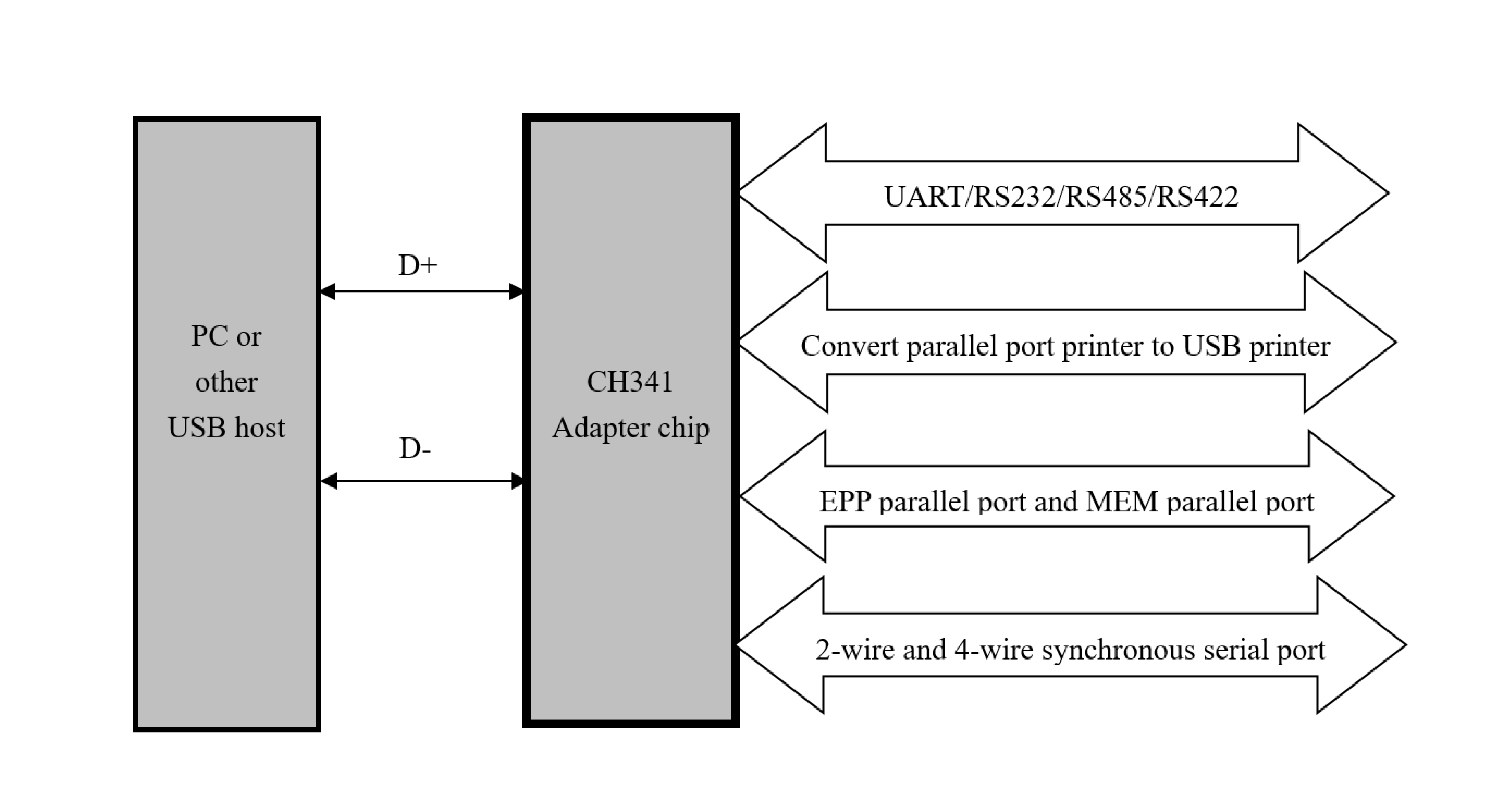

Overview
The CH341 is a USB bus adapter chip that provides UART, print, and parallel ports as well as commonly used synchronous serial interfaces such as 2-wire and 4-wire via the USB bus. In the UART mode, the CH341 provides interactive rate control signals such as serial transmit enable and serial receive ready, as well as the commonly used MODEM contact signals, which can be used to extend UART for computers, or to upgrade ordinary serial devices directly to the USB bus. In the print port mode, the CH341 provides a standard USB print port compatible with USB-related specifications and the Windows operating system, which is used to upgrade ordinary parallel-port printers directly to the USB bus. In parallel port mode, the CH341 provides an 8-bit parallel interface in EPP mode or MEM mode for direct input and output data in environments where a microcontroller/DSP/MCU is not required. In addition, the CH341B/F/A chip supports some common synchronous serial interfaces, such as 2-wire interface (SCL line, SDA line) and 4-wire interface (CS line, SCK/CLK line, MISO/SDI/DIN line, MOSI/SDO/DOUT line).

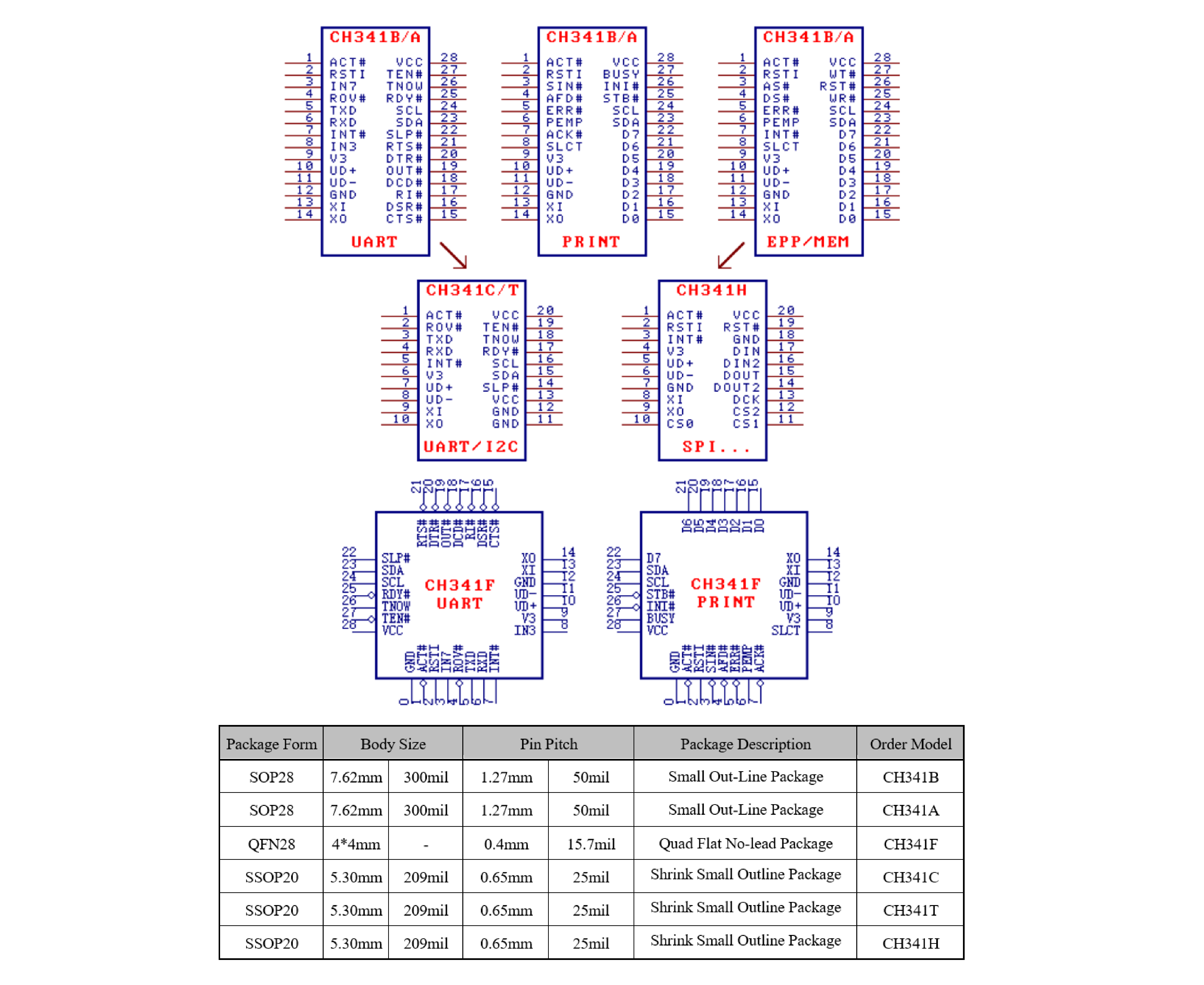

Package
Note:
CH341C/T is only used for USB to serial or USB to 2-wire interface.
CH341H is only used for USB to 4-wire interface, etc. (e.g. SPI), it is not recommended for new design, CH341B or CH341F is recommended.
CH341A, CH341T and CH341H must be connected with external crystal and oscillator capacitor.
CH341B, CH341F and CH341C can either be connected to an external crystal and capacitor or use the built-in clock directly without external connection.
