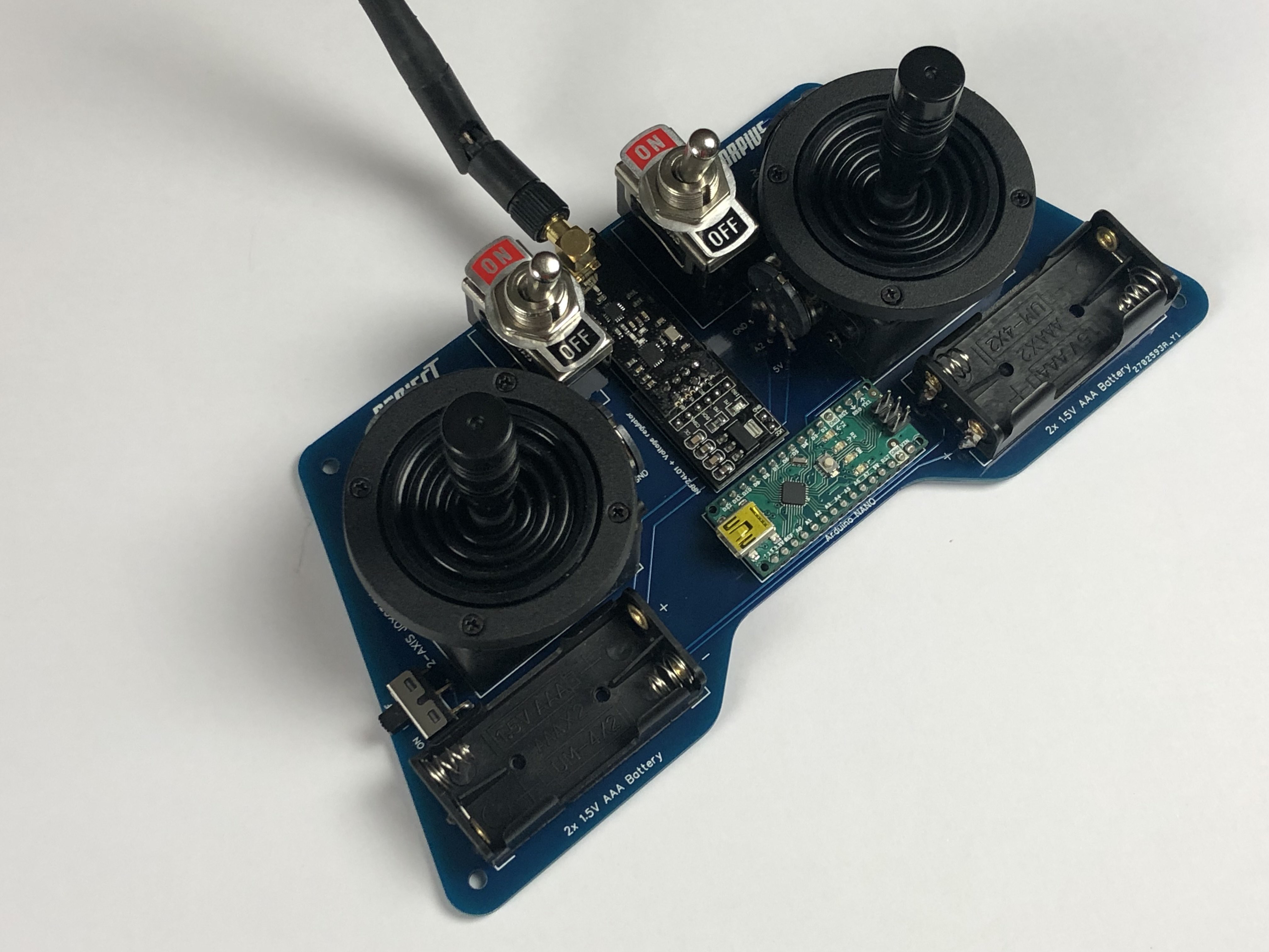

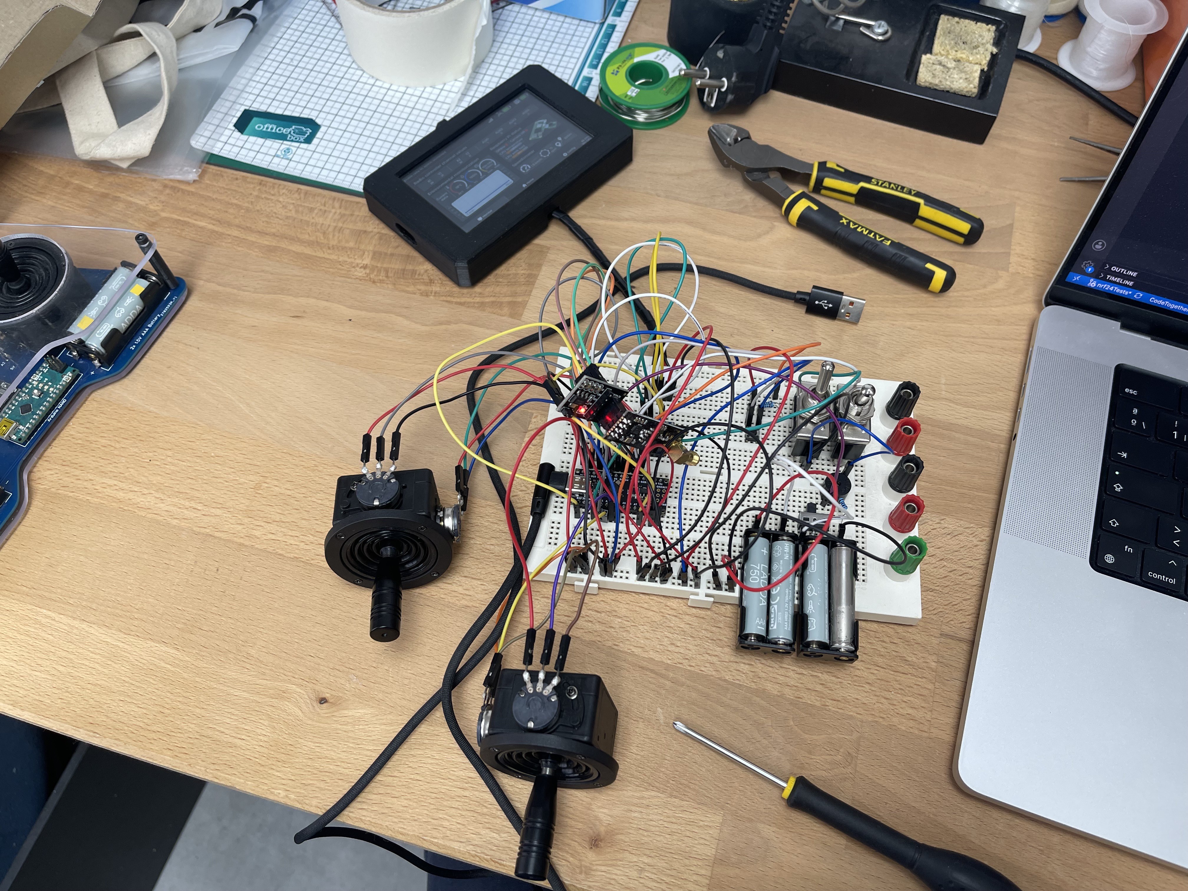

    I am working on a new remote controller to operate the rover. Originally, I only created an add-on module that could be attached to generic remote controllers, but it had a few issues (e.g., 3D printed parts had to be adapted to each generic remote controller model)
    This new remote control will be created using a manufacturable PCB. Here is the PCB design:
    This design is an updated version of a remote controller design I created a few years ago for another project. The main improvements are: support for touchscreen connection, buzzer, push button and battery level sensor. Here is the original assembled remote controller:
    Right now, I am finishing up some tests on a protoboard to validate the PCB design before production:
