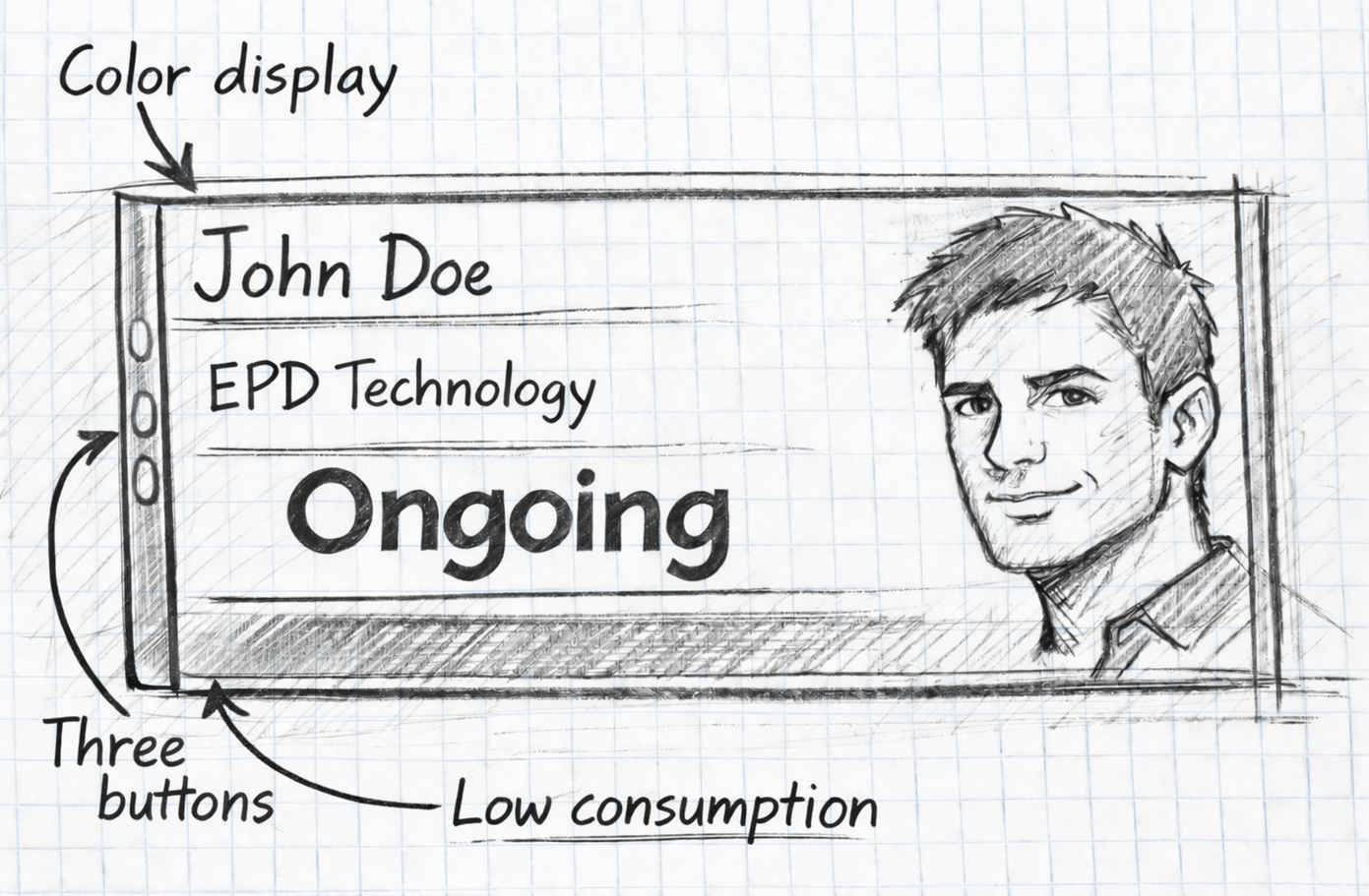

Here’s a sketch of what the organizers have in mind:
They’re looking for a screen with good visibility and the ability to change the session status by pressing one or more buttons on the side of the device.

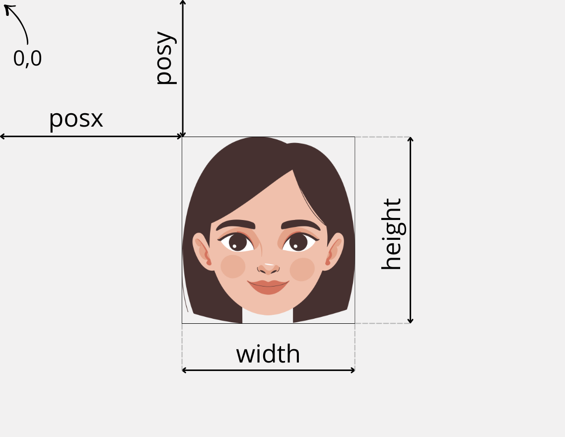

In code, the function is used as follows:
pushImage(posx, posy, width, height, imageData);
  • posx and posy are the coordinates where the image will start to be drawn.
  • width and height specify how many pixels wide and tall the image will be.
