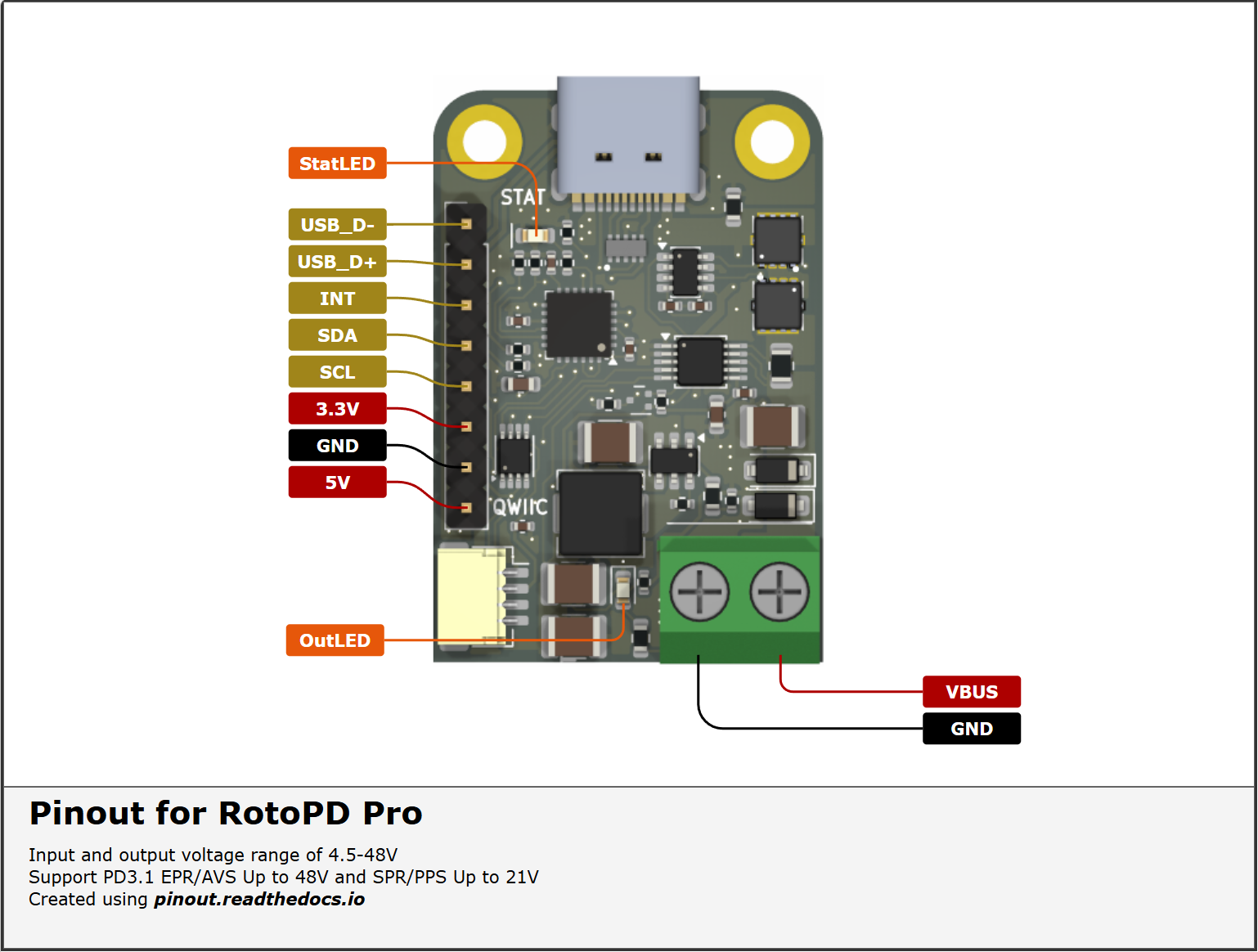

To config the board, you will need an I2C bus. The board integrates seamlessly into the Qwiic and STEMMA QT ecosystems, no soldering is required. The board only work with 3.3V I2C logic.
To make it even easier to use, RotoPD includes a built-in buck converter that efficiently steps down USB-C VBUS power to a stable 5V output, making it perfect for powering microcontrollers, sensors, and other low-voltage components in your project.

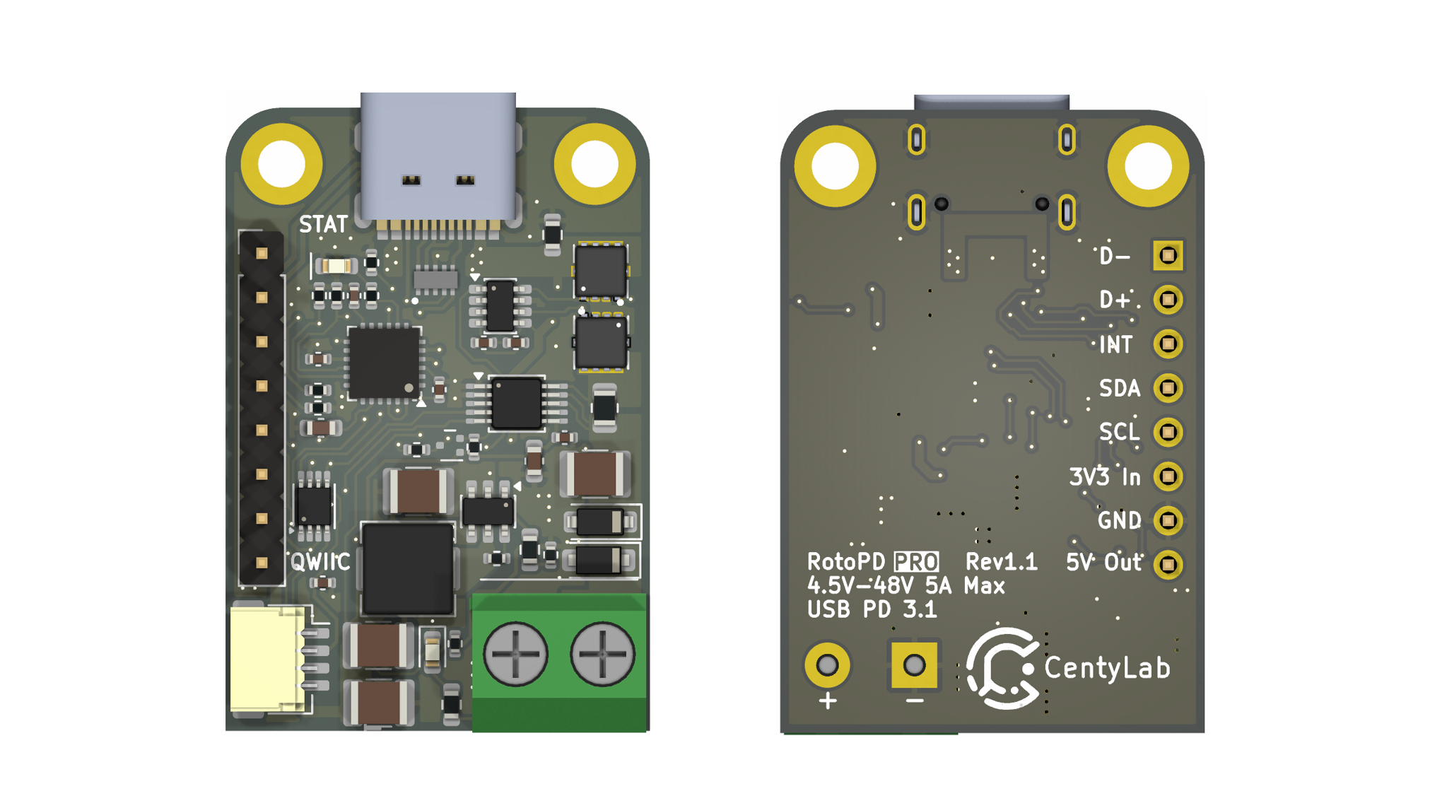

    We didn’t develop the library from scratch — we modified it specifically for the RotoPD Pro application. This IC is very important because it handles OVP (Over‑Voltage Protection) and OCP (Over‑Current Protection) for downstream devices.
    I couldn’t get a good photo of the code, so here’s a picture of the Rev 1.1 board instead.

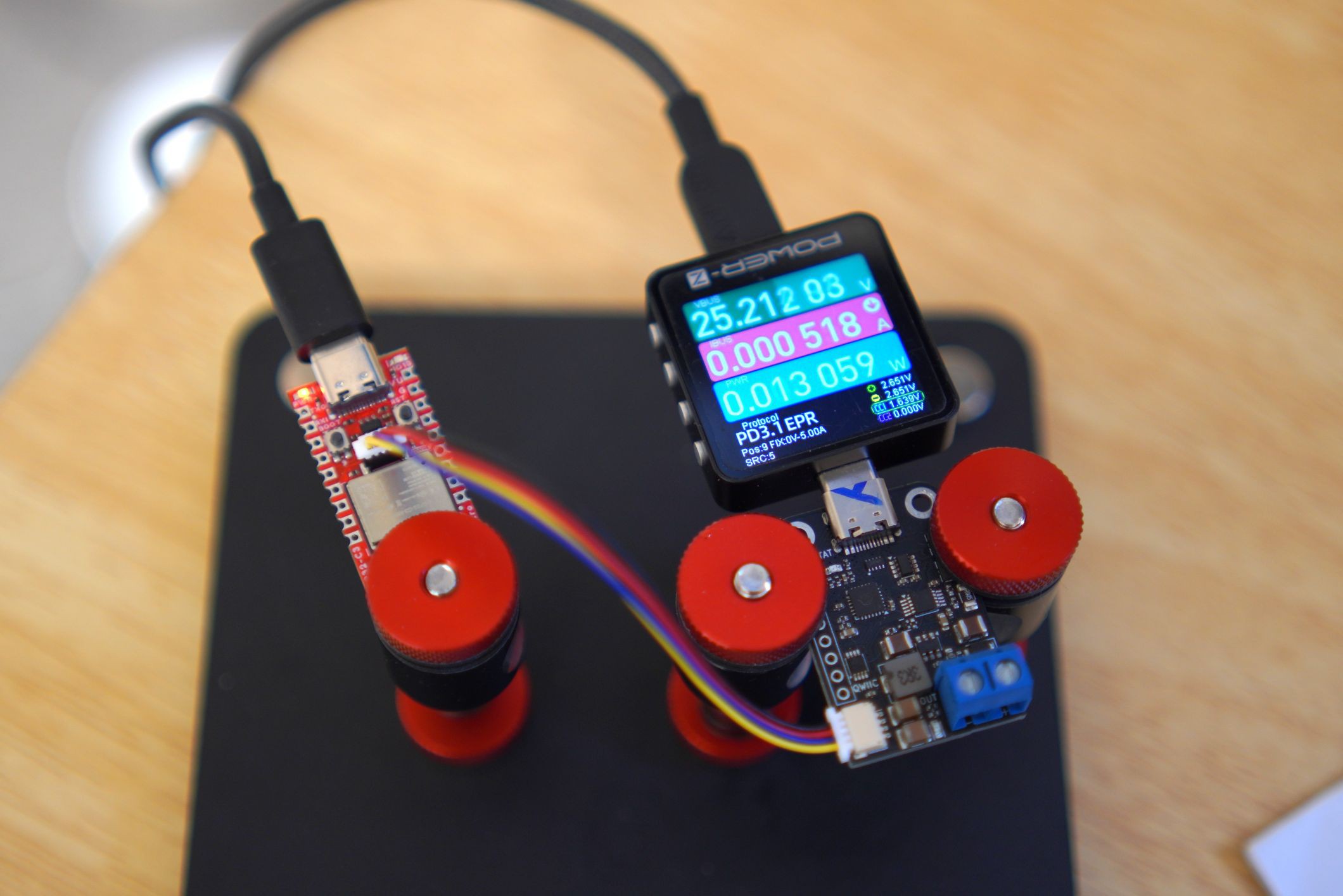

  • Quick fix actually work
    CentyLab • 03/20/2026 at 07:03 • 0 comments
    Swapping out the 3.3V -> 5V level shifter IC just solve this GitHub issue. We also need to swap out 2 (two) other resistors as the calculation was not correct. Basic functionally is working now!
    Next step: Firmware development!

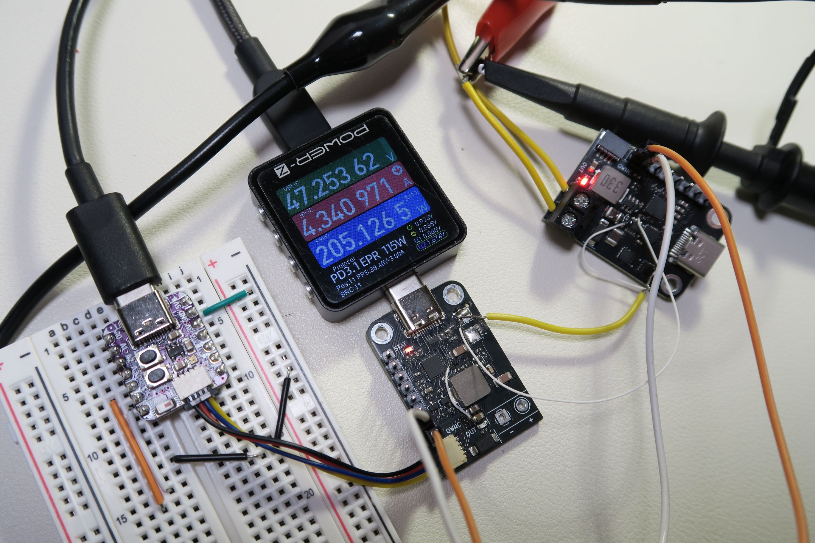

  • First try!
    CentyLab • 03/14/2026 at 04:00 • 0 comments
    Our first design was able to pull 48V like expected without anything blowing up!
    However, the voltage level shifter doesn't solve the leaking current issue, mentioned in this GitHub issue. We are working to replace this part with footprint compatible parts.
