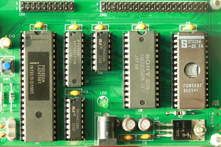

Intel 8032 CPU with external EPROM, RAM, Crystal, Latch, decoder, etc.,
In the past, Conventional Classic Single Board Computer(SBC) will have a CPU, external ROM or EPROM, external RAM, latch, address decoder, I/O port, Reset circuit and crystal. The above board can be run with 8031 or 8032 controller. We can find more details HERE. The board comes with expansion board with which we can run FORTH.

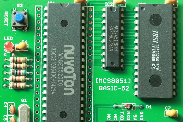

8052
8052 CPU with 8kB FLASH, 8kB EPROM, 32kB RAM, latch, crystal

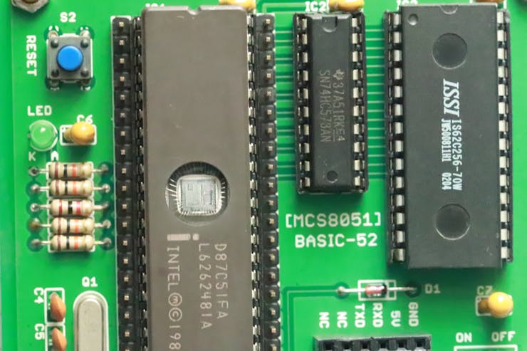

The scope of the project is to implement a Zilog Z80 based SBC with 8kB ROM and 8kB RAM running Microsoft BASIC Ver 4.7b and a Intel MCS-51 based SBC with 8kB code ROM and 32kB RAM running BASIC-52 with I2C extensions. It is same as the picture shown above which is having 8kB ROM and 32kB RAM.

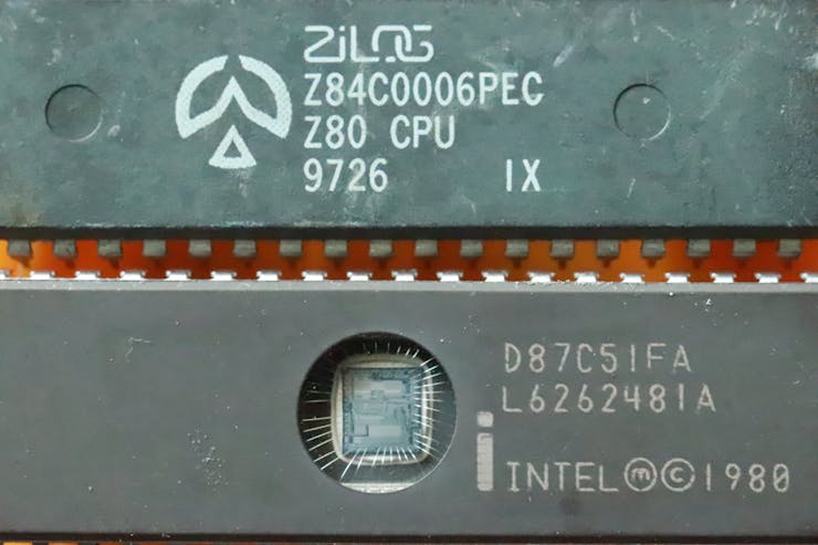

Zilog

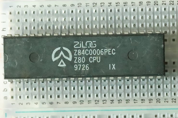

Zilog Z80 CPU at 6 MHz in DIP40 package
Intel

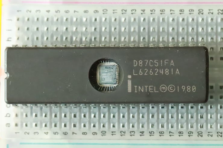

Intel 8751 with 8kB EPROM in DIP40 package

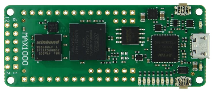

Arrow
MAX10 Device board with small form factor and lower cost

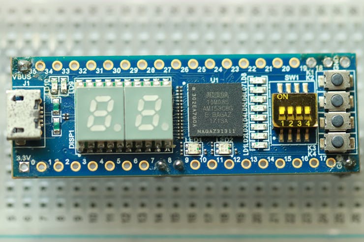

This board is a small size board with lots of resource and low in cost. The formfactor is not exactly DIP-40 size and the board contains more resources than we need. The FPGA used is MAX10 family 10M08SAU169C8G. We can learn more about the MAX1000 board HERE.

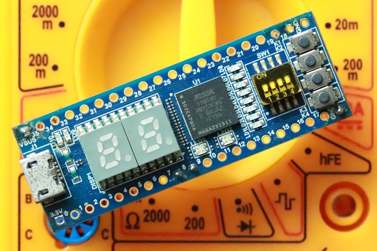

MAX10 board in DIP40 size
The above board also comes with MAX10 FPGA and having exact DIP-40 size. We can find Hardware, Software and Example project HERE. We can also find the overview for the above board at HERE.
The MAX10 FPGA devices are new generation devices which having combination of CPLD and FPGA architecture. The MAX10 devices comes with internal FLASH memory so that we do not require external configuration device during power-up. The MAX10 devices also comes with inbuilt ADC and temperature sensor.
