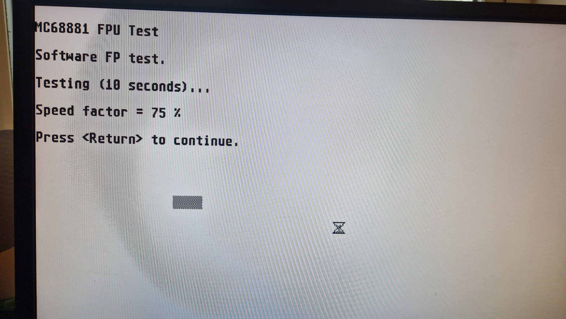

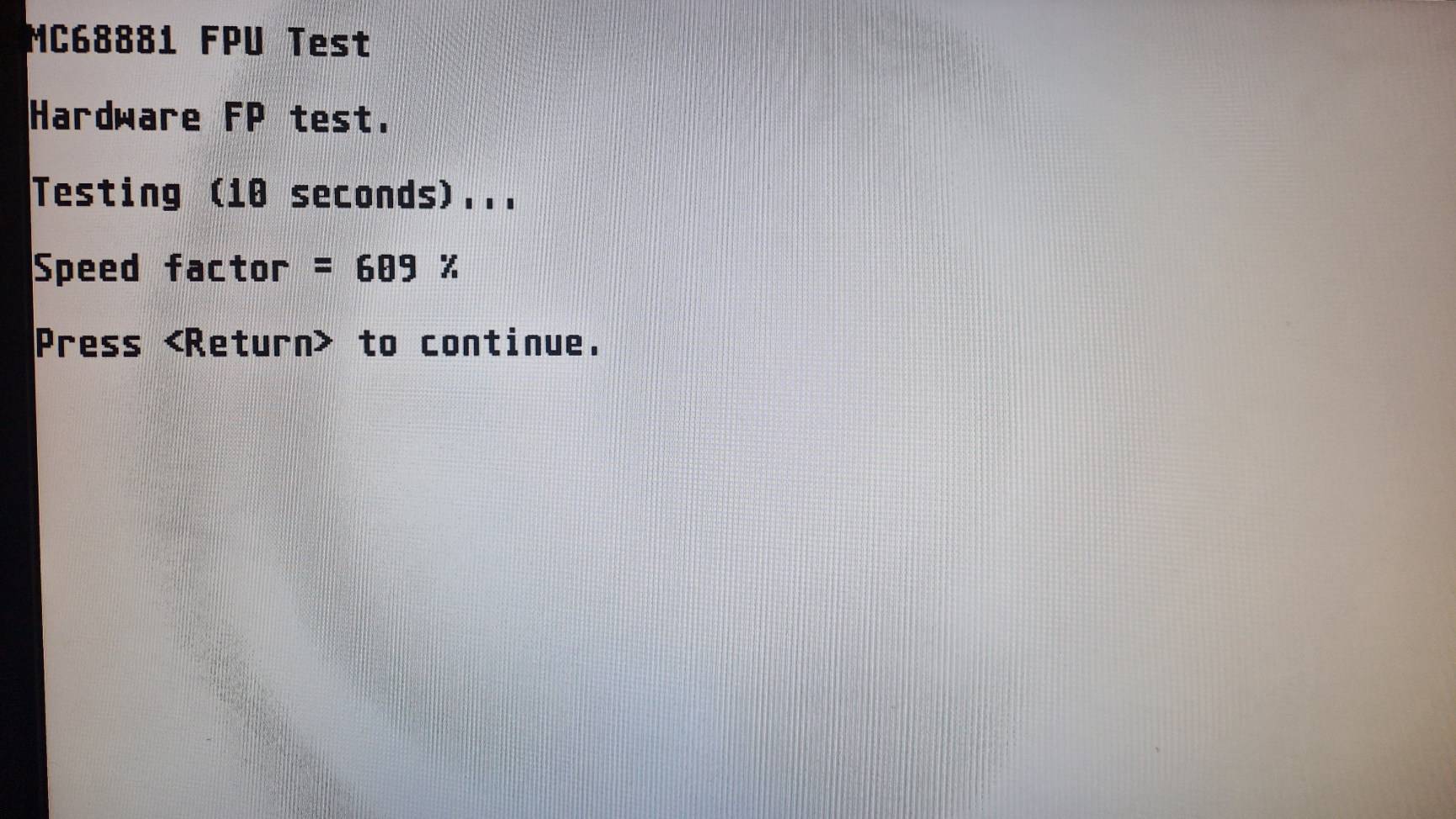

    The FPU now works with EMUTOS and SFP004 libraries. It produces an 8x performance improvement compared to the SOFT-FP code. This is using an unmodified set of utilities from 1991.  I obtained the utilities from here: https://www.atari-forum.com/viewtopic.php?p=478222#p478222
    The  test board is an Alinx AXU3EG using musashi on the ARM PS communicating via AXI to the PL hardware FPGA FPU
    The next stage is to build a hardware PCB using a 68sec000 for true validation. PCBWAY have kindly sponsored this hardware due to it's unique design. I will provide more details when my board arrives from them.

    Known Issue: SFP004 Peripheral Protocol
    Disassembly of FPU_HARD.PRG (Quidnunc 1991, commonly used on Atari ST/SFP004 boards) revealed it uses a different
    register protocol than the MC68020 CIR standard — it writes commands without an OpWord and expects different response
    encodings. This will be addressed in the next update to support the SFP004 peripheral access pattern alongside the
    standard CIR protocol.

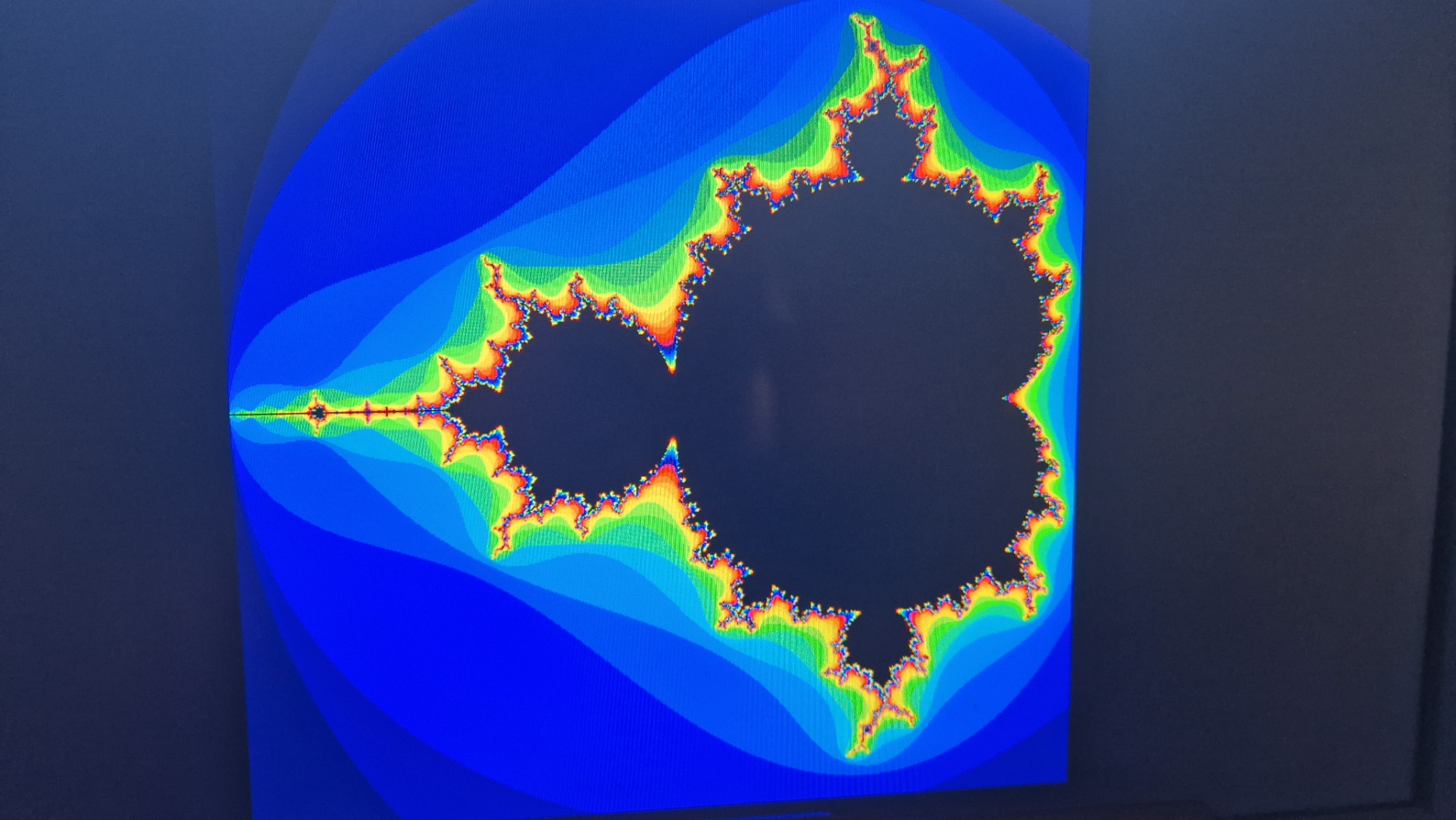

    Matthew Pearce03/16/2026 at 12:52 0 comments
    Mandelbrot set generated using assembler on hardware.
    * Mandelbrot Set Renderer
    * Renders a 640x640 pixel Mandelbrot set using MC68881 FPU F-line
    * instructions.  Centred on the 1280x720 display at offset (320, 40).
    * View window:  real [-2.0, +0.5], imag [-1.25, +1.25]
    * Scale:        2.5 / 640 = 0.00390625
    * Max iters:    32
    * Palette:      16 colours, cycled via (iter & 15)
    * Usage: Load via S-record (L command), execute with G 2000.
    * Assemble:
    *   vasmm68k_mot -Fsrec -m68000 -m68881 -o mandelbrot.srec mandelbrot.s
