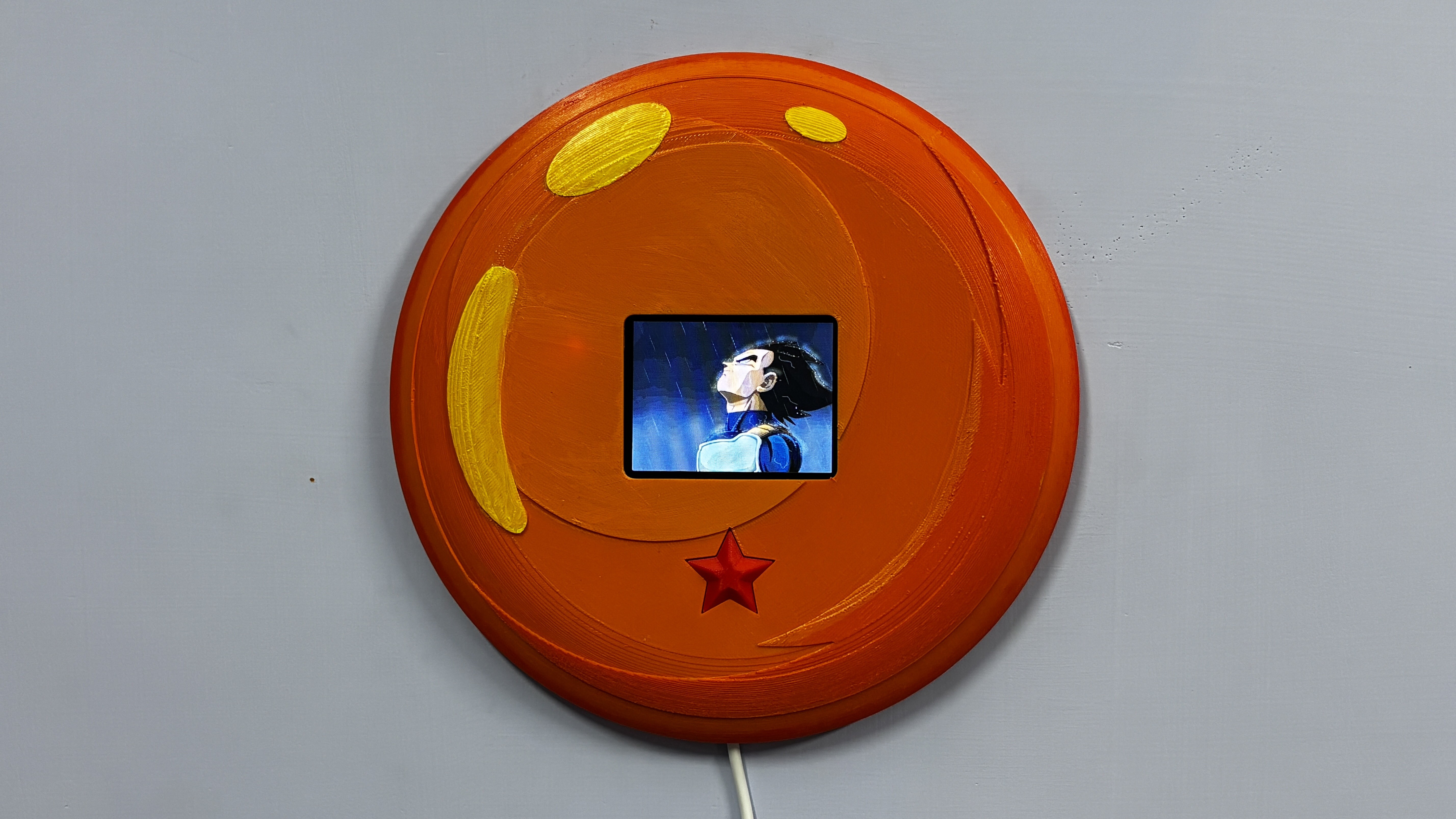

The Zenkai Engine consists of a full-size Dragon Ball enclosure and is powered by a UNIHIKER K10. When the external button that is shaped like a one-star Dragon Ball is pressed, the device plays a short animated sequence of Vegeta standing in rain along with a one-minute motivational speech. After inactivity, the display powers down to conserve energy, awaiting the next trigger.

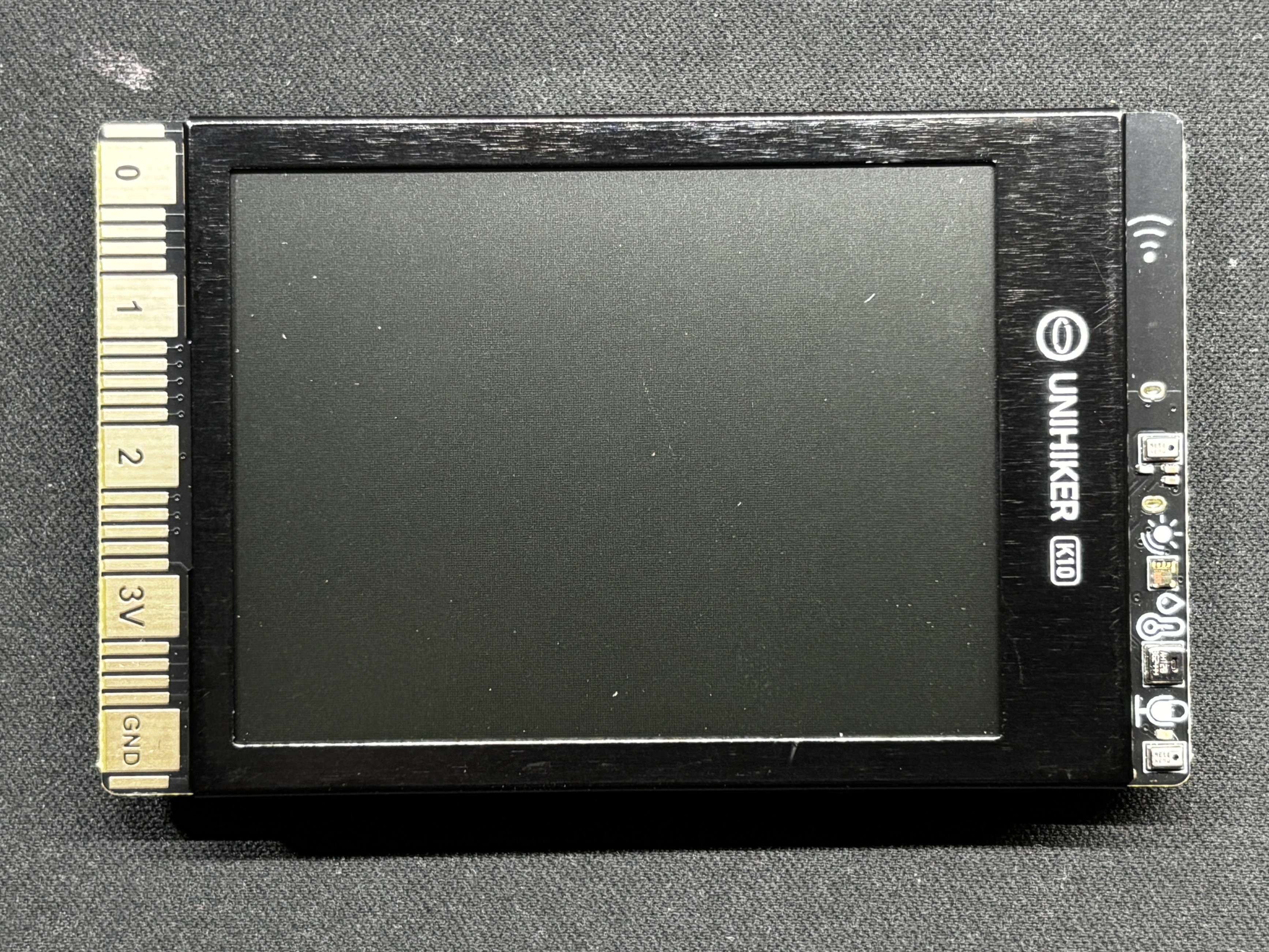

HARDWARE—Unihiker K10
The star of this project is the UNIHIKER K10, which serves as the core controller and display unit for the entire system.
The UNIHIKER platform is available in two variants: the M10 and the K10.
The M10 is based on a Linux-capable processor, designed for higher-level applications.
The K10, on the other hand, is powered by the ESP32-S3 N16R8 module.
Key Specifications:
  • Module: ESP32-S3 N16R8
  • Processor: Xtensa® LX7 dual-core 32-bit CPU
  • Clock Speed: Up to 240 MHz
  • SRAM: 512 KB
  • ROM: 384 KB
  • Flash Memory: 16 MB
  • PSRAM: 8 MB
  • RTC SRAM: 16 KB
With its dual-core architecture and generous Flash and PSRAM, the ESP32-S3 is capable of handling image rendering, SD card file access, and audio playback simultaneously
Our primary reason for selecting the UNIHIKER K10 for this project was its built-in SD card reader and onboard speaker. These two features significantly simplified the overall design and eliminated the need for additional external modules.
All media assets used in the Zenkai Engine are stored directly on the SD card. This includes the image frames used to simulate the animated sequence, as well as the audio file that plays during activation.
The display renders JPG images read from the SD card in rapid succession to recreate the animated effect. For audio playback, the system uses a WAV format file, as this is the supported and most reliable format for playback through the onboard speaker.
By handling both image rendering and audio output internally, the UNIHIKER K10 serves as a compact, all-in-one solution for managing the interactive and multimedia aspects of the project.

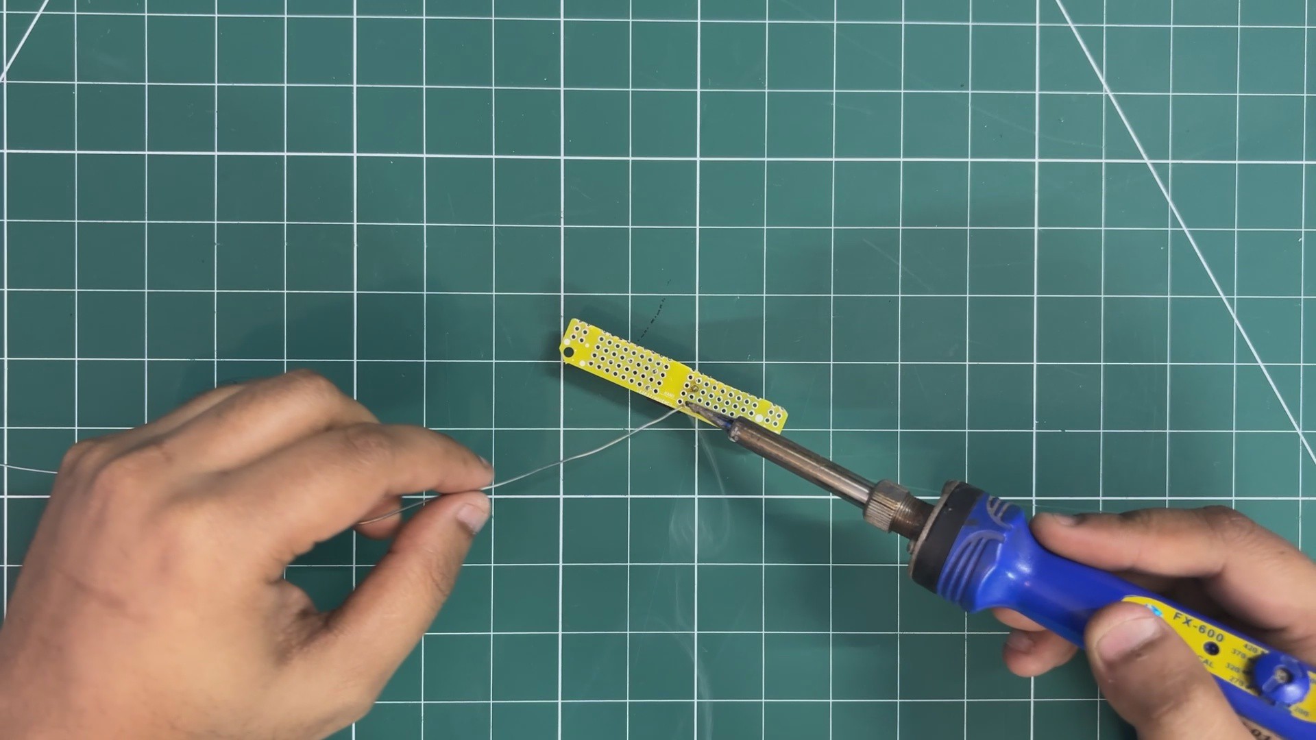

    MAKESHIFT SWITCH PCB
    • We needed a small PCB to securely mount our 12×12 mm push button, so we cut a section from the PCB breadboard using a sheet metal cutter. This trimmed piece serves as the switch PCB.
    • The push button was positioned at the center of this PCB. The board was then flipped over, and the button leads were soldered in place using solder wire.
  • 2

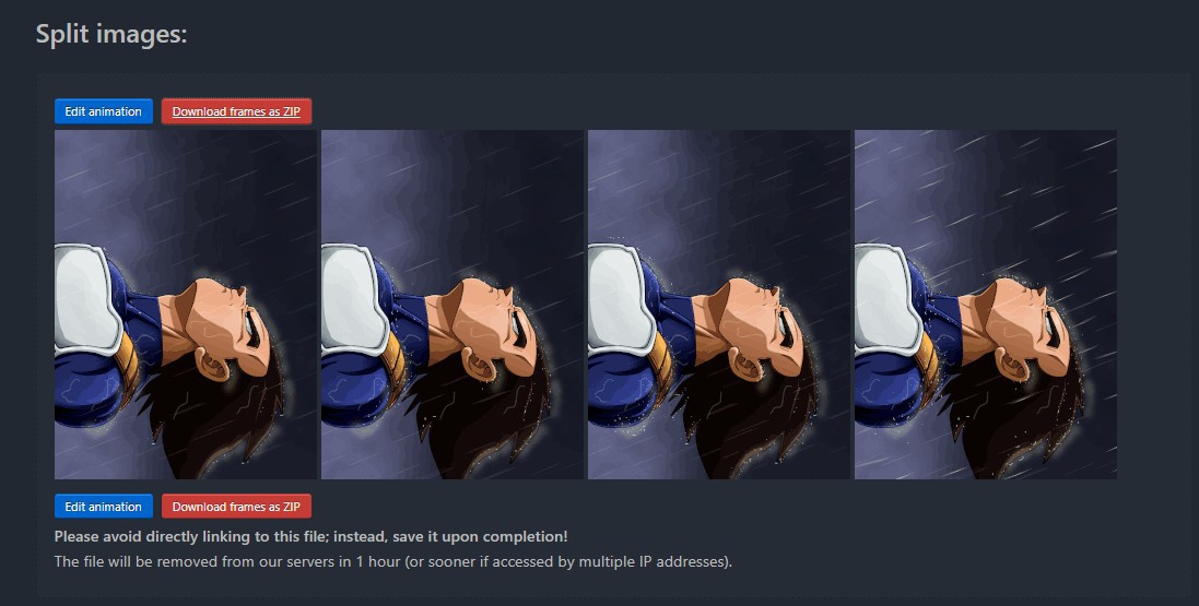

    Preparing GIF
    Now comes one of the most critical parts of this project: the animated GIF.
    Initially, I selected a short looping GIF of Vegeta standing in the rain.
    Ideally, the process would be simple: place the GIF file on the SD card and let the UNIHIKER play it directly. However, the UNIHIKER does not support native GIF playback. It can only display static images stored on the SD card.
    To work around this limitation, I used EZGIF to process the animation. First, the original GIF was resized to 320×240 pixels to match the UNIHIKER’s display resolution.
    Next, the GIF was split into individual frames. Each frame was exported in JPG format.
    The idea is straightforward: instead of playing a GIF file, we rapidly display multiple JPG frames in sequence. By cycling through these images at a fixed frame rate, we simulate motion and recreate the animated effect.
