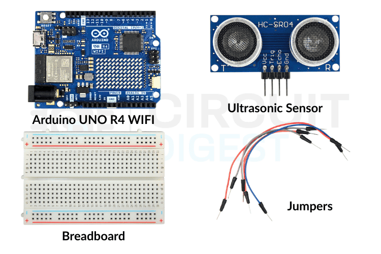

📦 What You Need
  • Arduino UNO R4 WiFi
  • HC-SR04 Ultrasonic Distance Sensor
  • Breadboard + jumper wires
  • USB cable to program the board
  • Free API key from CircuitDigest Cloud

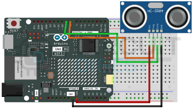

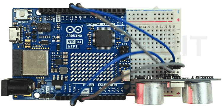

🔧 Wiring (HC-SR04 ↔ Arduino)
Ultrasonic SensorArduino UNO R4 WiFi
VCC5V
GNDGND
TRIGD9
ECHOD10
The sensor measures distance by sending a pulse (TRIG) and timing the echo return (ECHO).

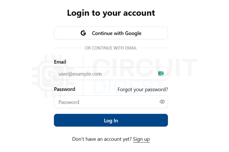

☁️ Setup the CircuitDigest Cloud
  1. Create an account at CircuitDigest Cloud and log in.
  2. Go to API Key in your profile and generate a new key.
  3. In the WhatsApp Notification API section, register up to 5 phone numbers to receive alerts. Each number must be verified via OTP.
  4. Choose or note a WhatsApp template ID for your alert — templates contain placeholders like {#var#} that are filled with sensor data.

📲 Flashing & Testing
  1. Install the Arduino IDE and add support for the UNO R4 WiFi board.
  2. Update SSID, WiFi password, API key, and recipient number in the sketch.
  3. Upload the sketch and open Serial Monitor at 115200 baud.
  4. Trigger the sensor to test alerts and watch WhatsApp messages arrive.
