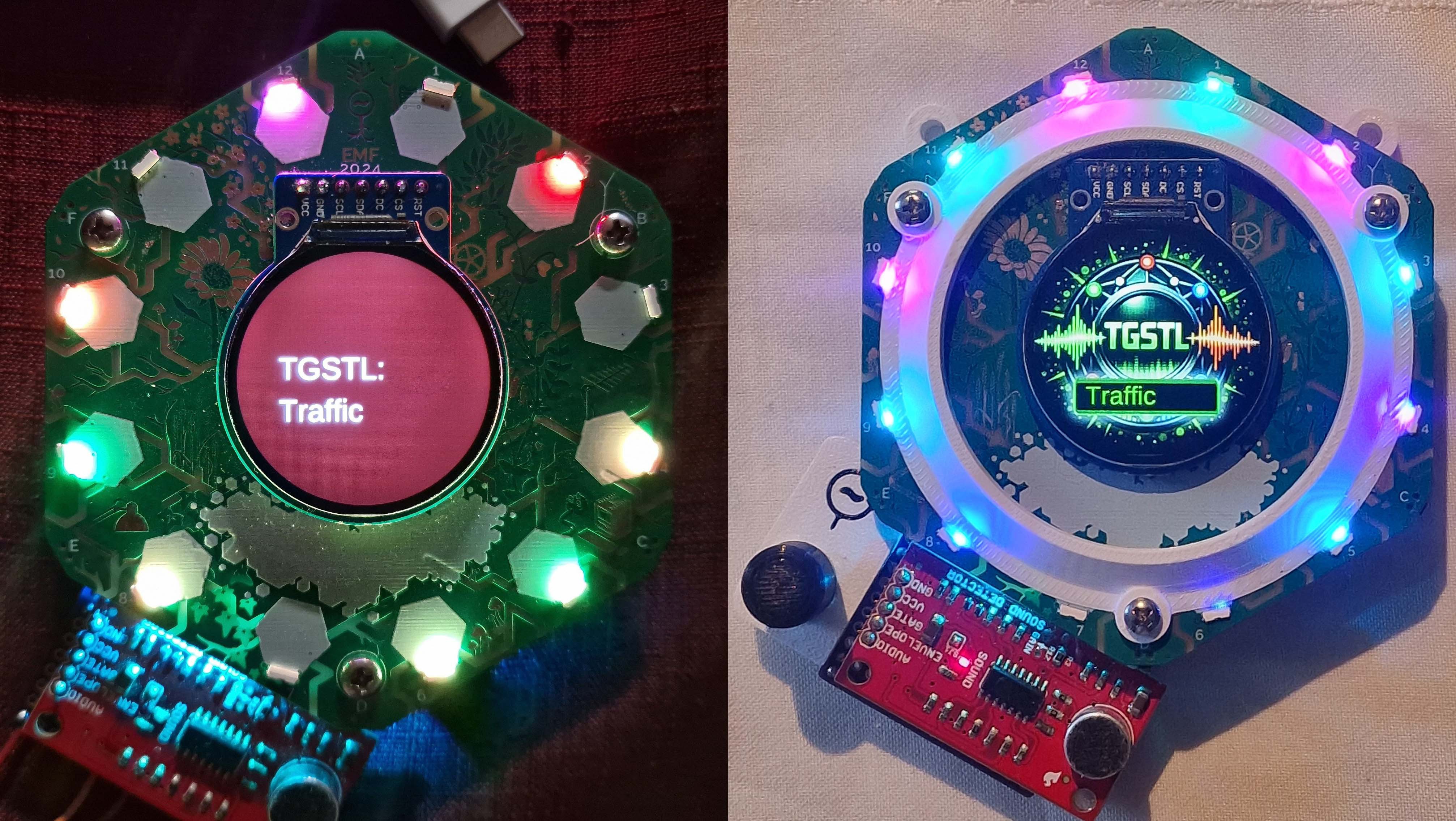

There are many projects for the Electro Magnetic Field camp (EMF camp) tildagon badge, but I thought the 12 RGB onboard LEDs were underutilised, and everybody loves sound to light displays...right?
My goal was to take an exisitng sound to light platform, the Sparkfun sound detector which already has an excellent STL system, and port it to the tildagon badge.
There were x goals I wanted to acheive
1. Get a sound to light system with multiple effects running.
2. Implement it as a tildagon OS App, and for it to be uploaded /started/stopped as other apps.
3. Improve LED visibility.

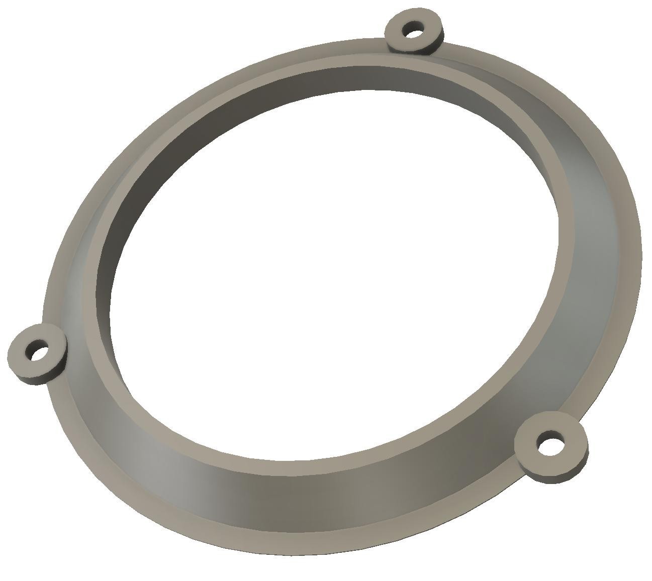

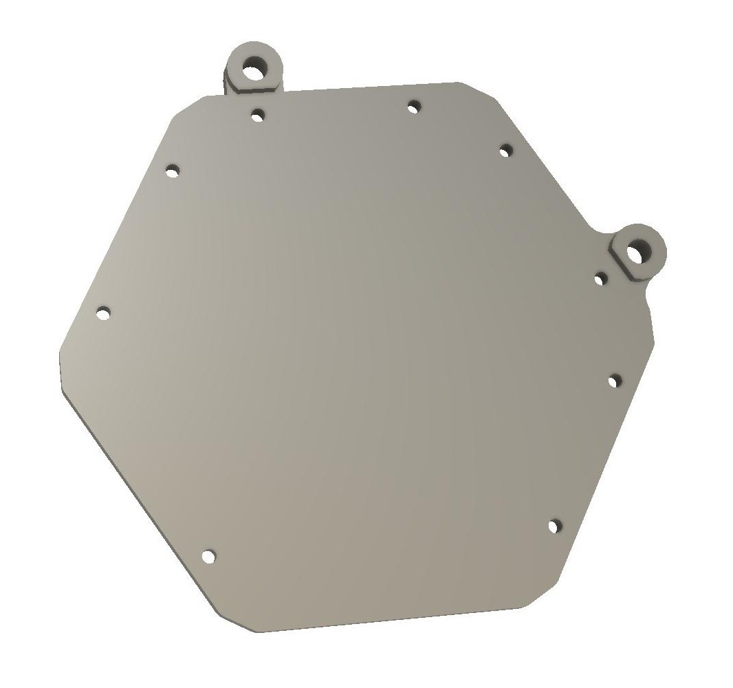

The tildagon badge LEDs are surface mount affairs that throw their light horizontally. With a green PCB the light is obviously going to be sub optimal. In an effort to mitigate this the badge team uses a white silkscreen and places large (1cm sq?) pads in front of each LED to improve the light reflection.
I found this a bit underwhelming so I created a 3d printable diffuser that has a sloping face to maximise the amount of light that is reflected. It has holes that align with the main badge screws so is easily mounted.
With a significantly increased surface area to reflect the light, the improvement is noticeable!
The use of a USB cable as a lanyard is a great idea, but I found the thin cable a bit irritating around my neck so I created a 3d printable badge mount with lugholes to allow it to be attached to a standard 2 point lanyard.

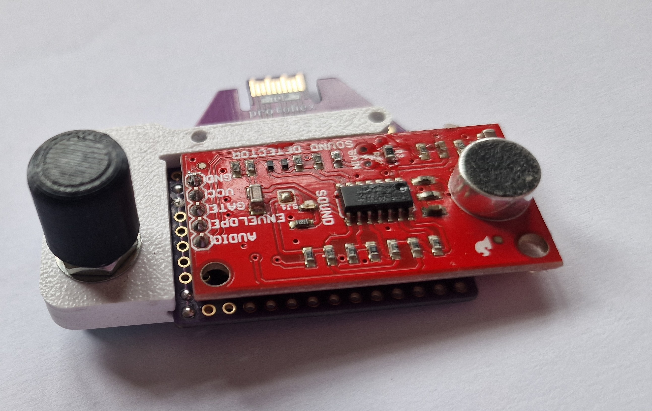

I've used the Sparkfun sound detector module in several other projects and I've been impressed with it's performance when used with the appropriate demo software here by Michael Bartlett. It's one of the best DIY sound to light applications I've seen.
The first unknown was will the detector board run from 3.3V. The board specifies a supply voltage between 3.5 and 5.5V, with 5V being 'ideal'. The board uses an LMV324 op amp, and the datasheet for this states a supply voltage between 2.7V-5V.
I tested this by hooking the board up to a bench power supply. It did work, but I found it significantly less sensitive at this voltage. However, the gain of the circuit can be changed by adjusting the value of R3 and I found a value of 200k seemed to work well. This is an 0805 style device so it's pretty easy to swap for someone with basic soldering skills.

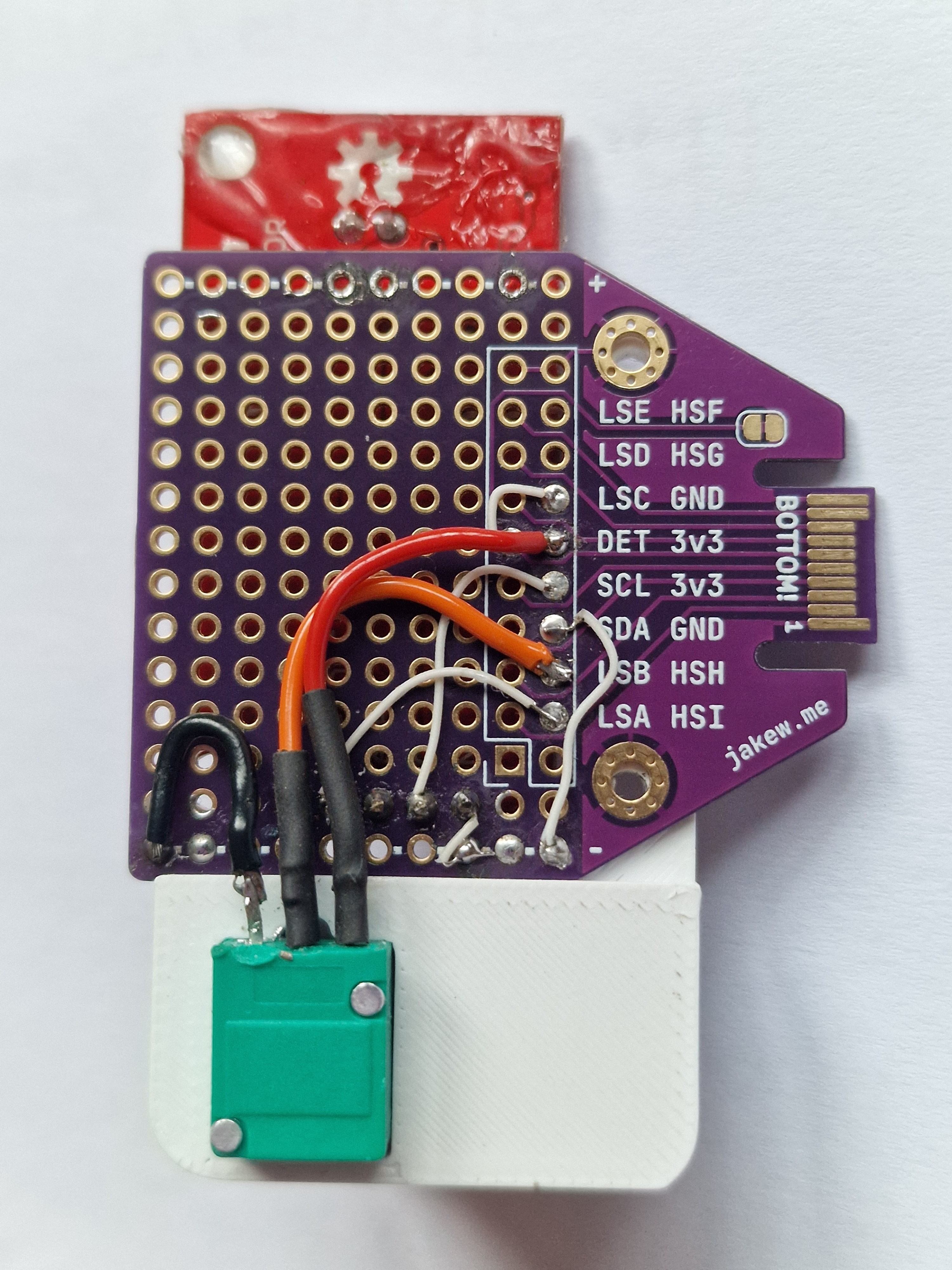

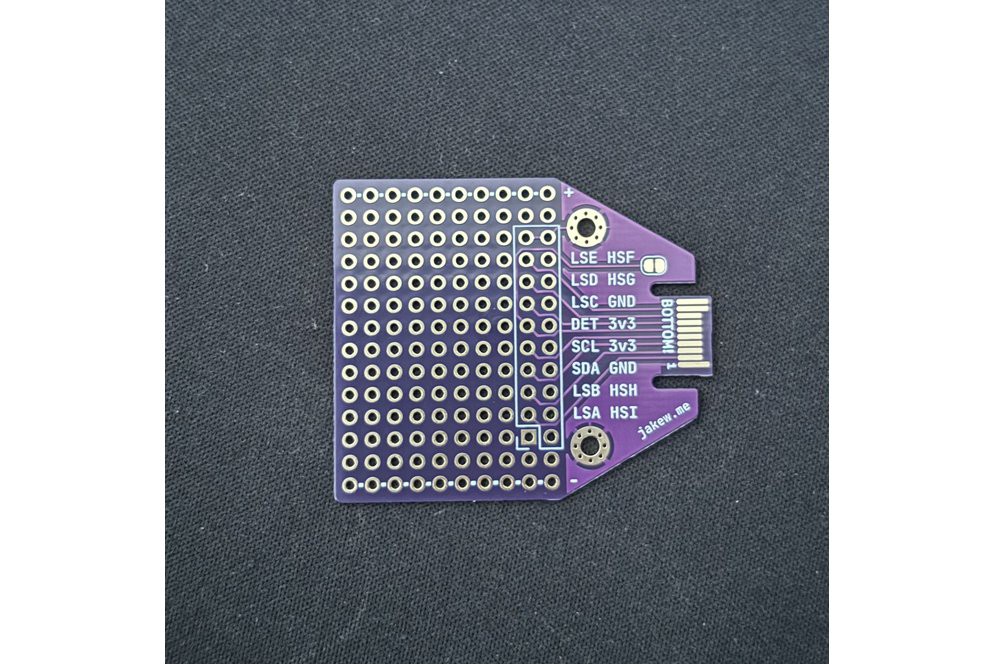

I needed to get the sound detector board connected to the tildagon, the Hexpansion ports were the obvious choice for this. The software requires an analog input, but not all hexpansion ports have this.
I chose port 4 (J4) as this will minimise the width when wearing the badge.
It arrived in a few days and only costs £3.37 (~$4.50) so quite a bargain. Thanks Jake!

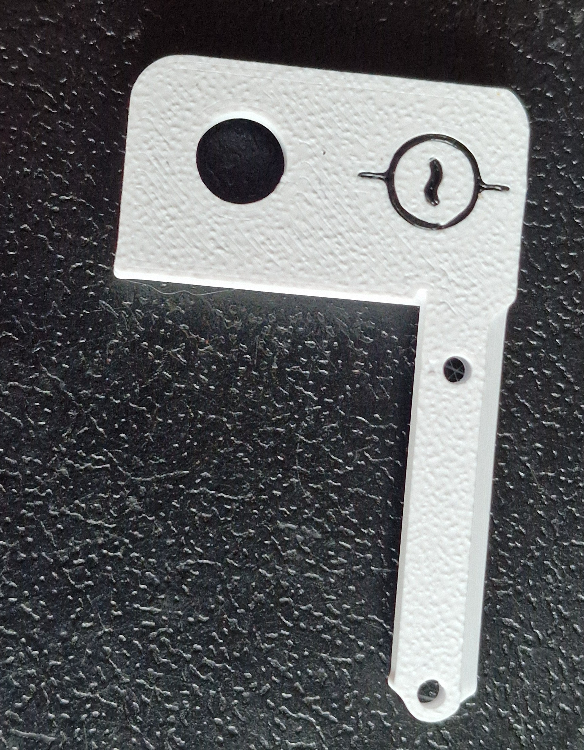

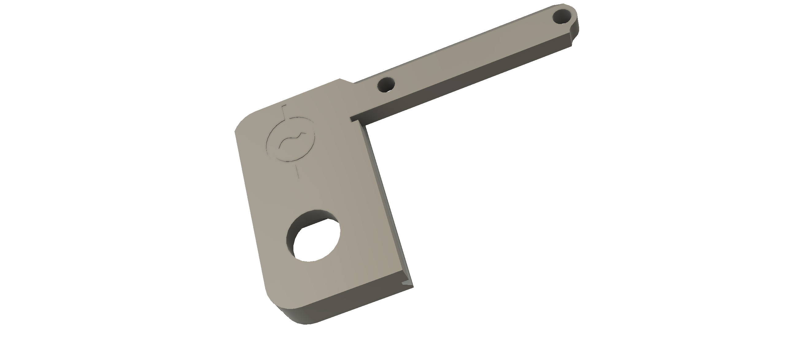

The design uses a potentiometer as a software sensitivity control. I wanted this to be integral to the hexpansion so I created a 3D printable mount that uses the hexpansion fasteners and holds everything together.
I used hookup wire to connect the sound detector board the the appropriate hexpansion pins. One noteworthy connection is that the DET pin must be connected to GND, otherwise the tildagon does'nt see the hexpansion as present, and won't supply power.
The following connections are required:
DET
GND
3V3
Sparkfun VCC
3V3
Potentiometer A
GND
Potentiometer B
GND
Sparkfun GND
HSH
Potentiometer wiper
HSI
Sparkfun Envelope
