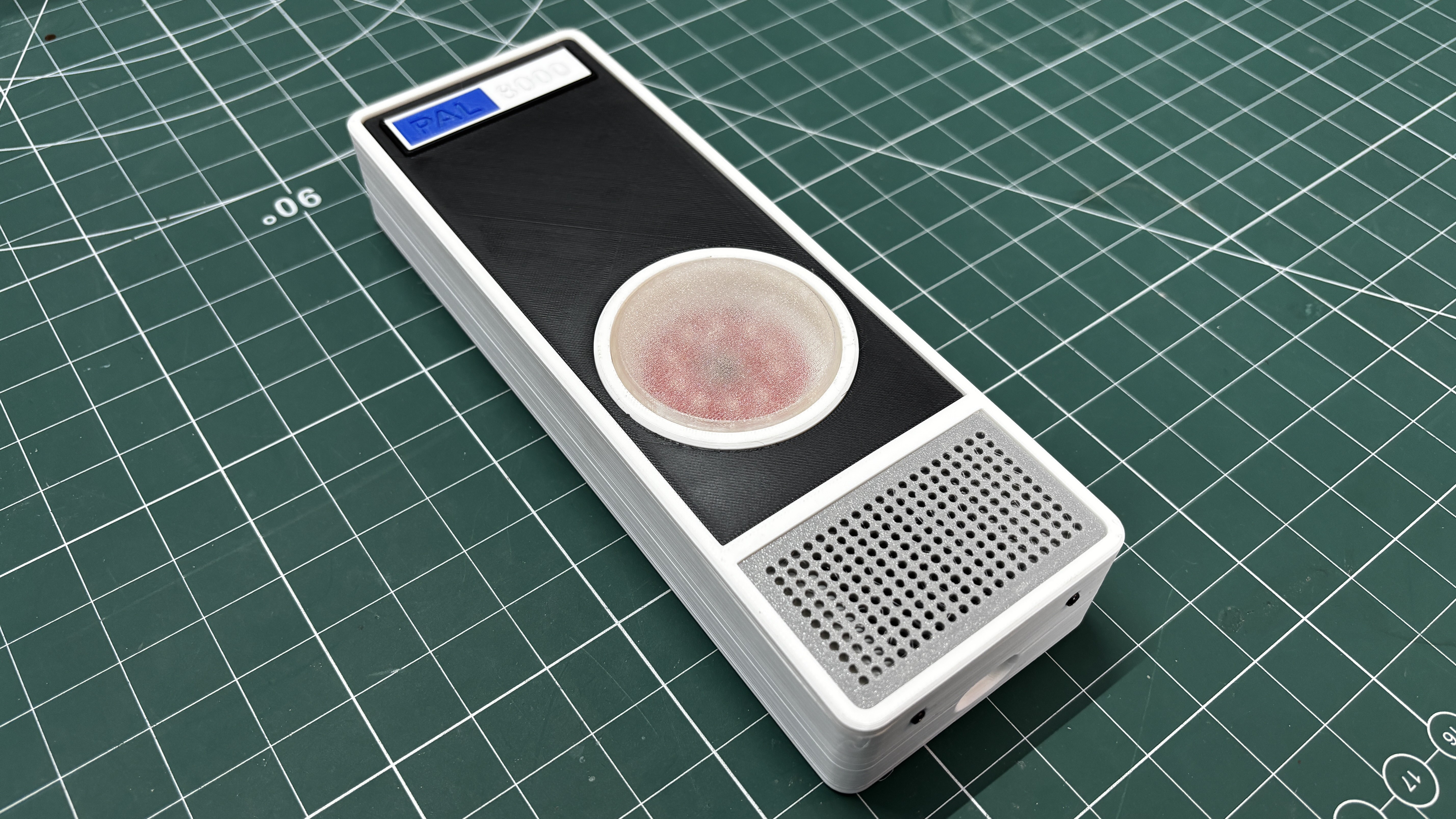

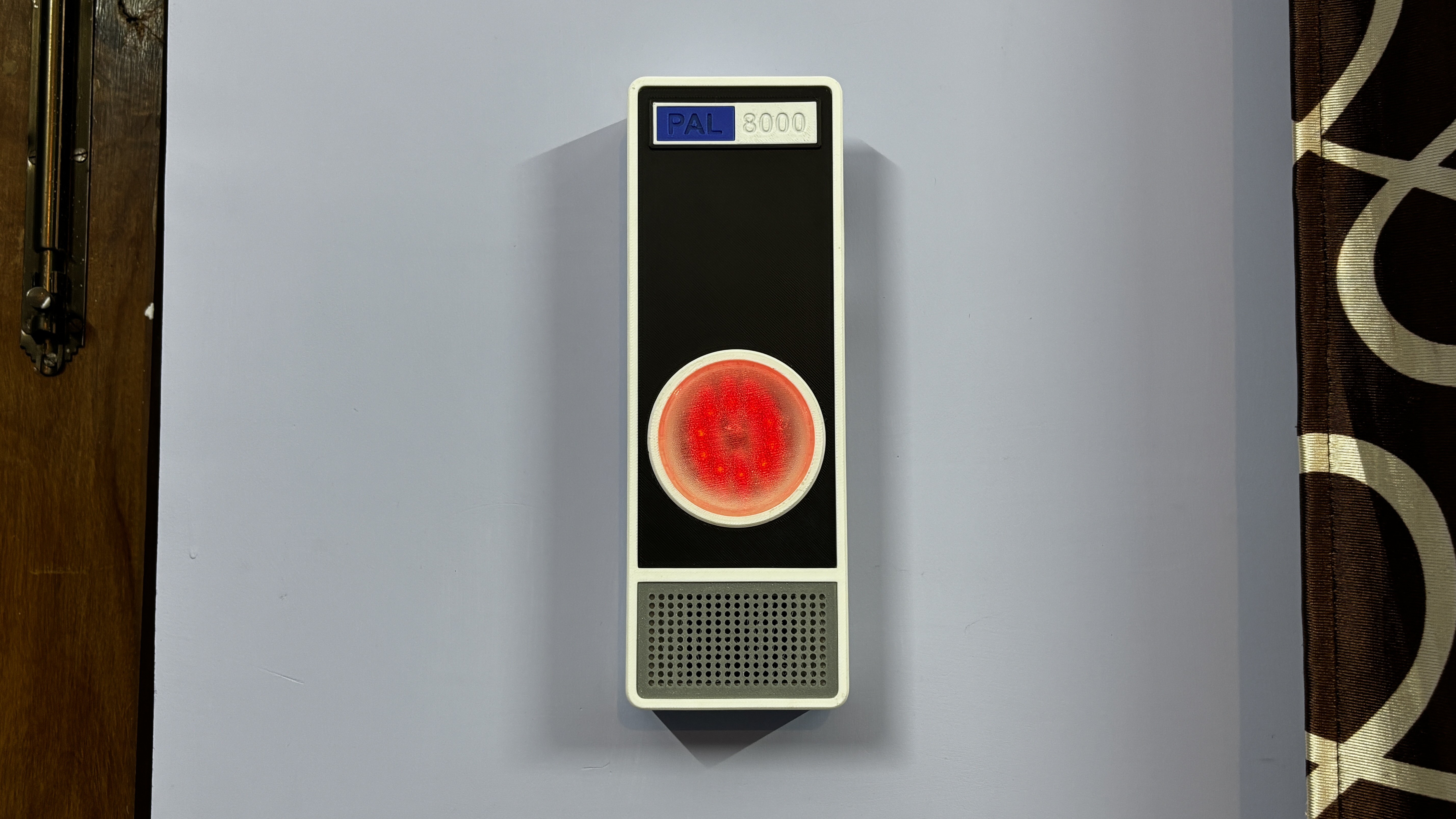

I also designed an enclosure that closely resembles HAL 9000's iconic circular eye design. Mine differs in one way: HAL's enclosure was metallic silver, while mine is white.

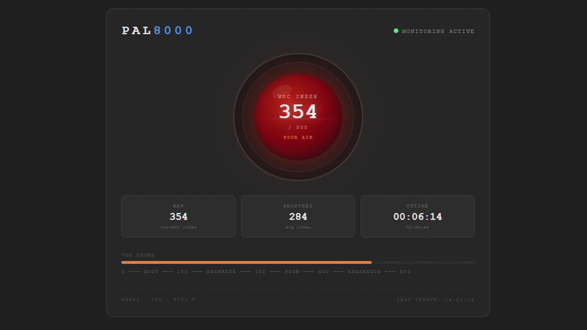

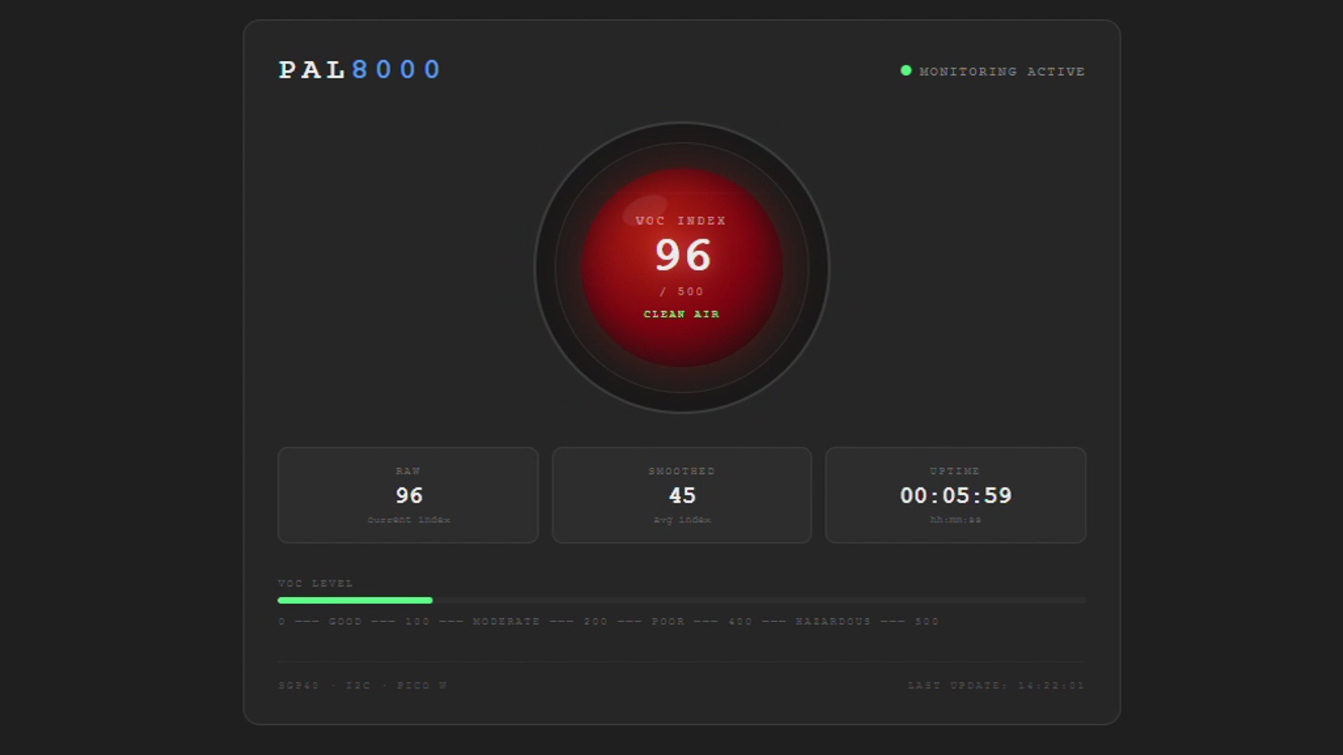

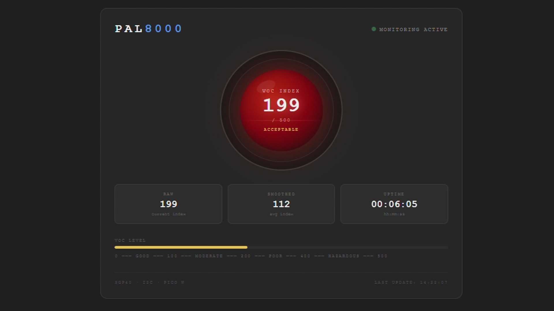

Because we are using a Raspberry Pi Pico W, real-time VOC data can be accessed through a locally hosted web app, letting you monitor your room's air quality directly from a browser on any device on the same network.

My goal with PAL 8000 is to recreate that eerie, eerily calm feeling, not a direct copy but something that carries the same atmosphere.
Using a Raspberry Pi Pico 2 paired with a DFPlayer Mini module, along with audio clips I generated using ElevenLabs, I built PAL 8000 around a Sensirion SGP40 indoor air quality sensor. The SGP40 continuously measures VOC (Volatile Organic Compound) levels in the room and outputs a VOC Index value ranging from 0 to 500. Based on where that reading falls, PAL 8000 plays a corresponding audio clip; if the reading is between 0 and 100, it plays a clip indicating clean air; as readings climb higher, the responses become progressively more urgent, shifting from gentle observations to quiet warnings, all delivered in that same unsettling calm tone.

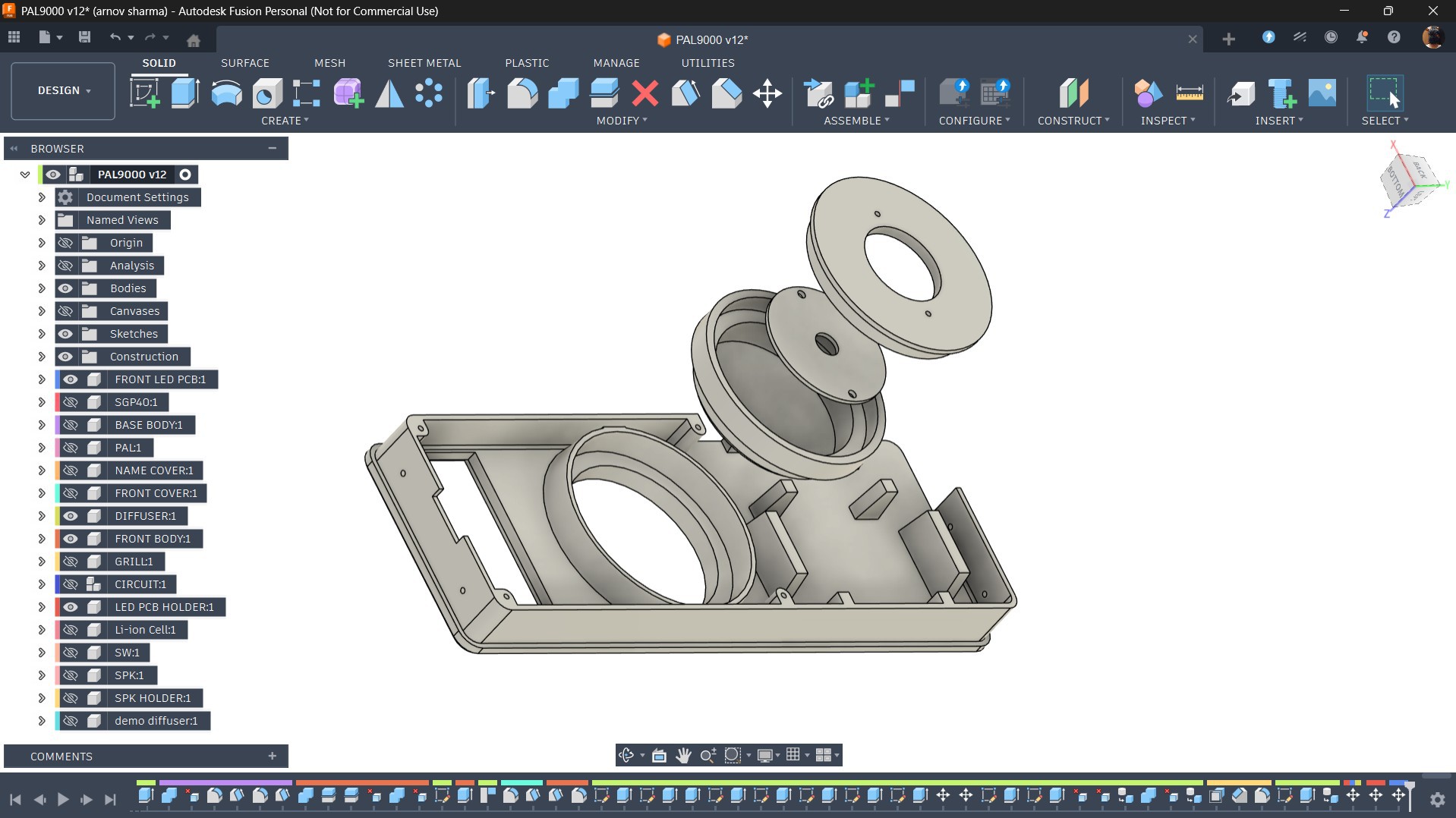

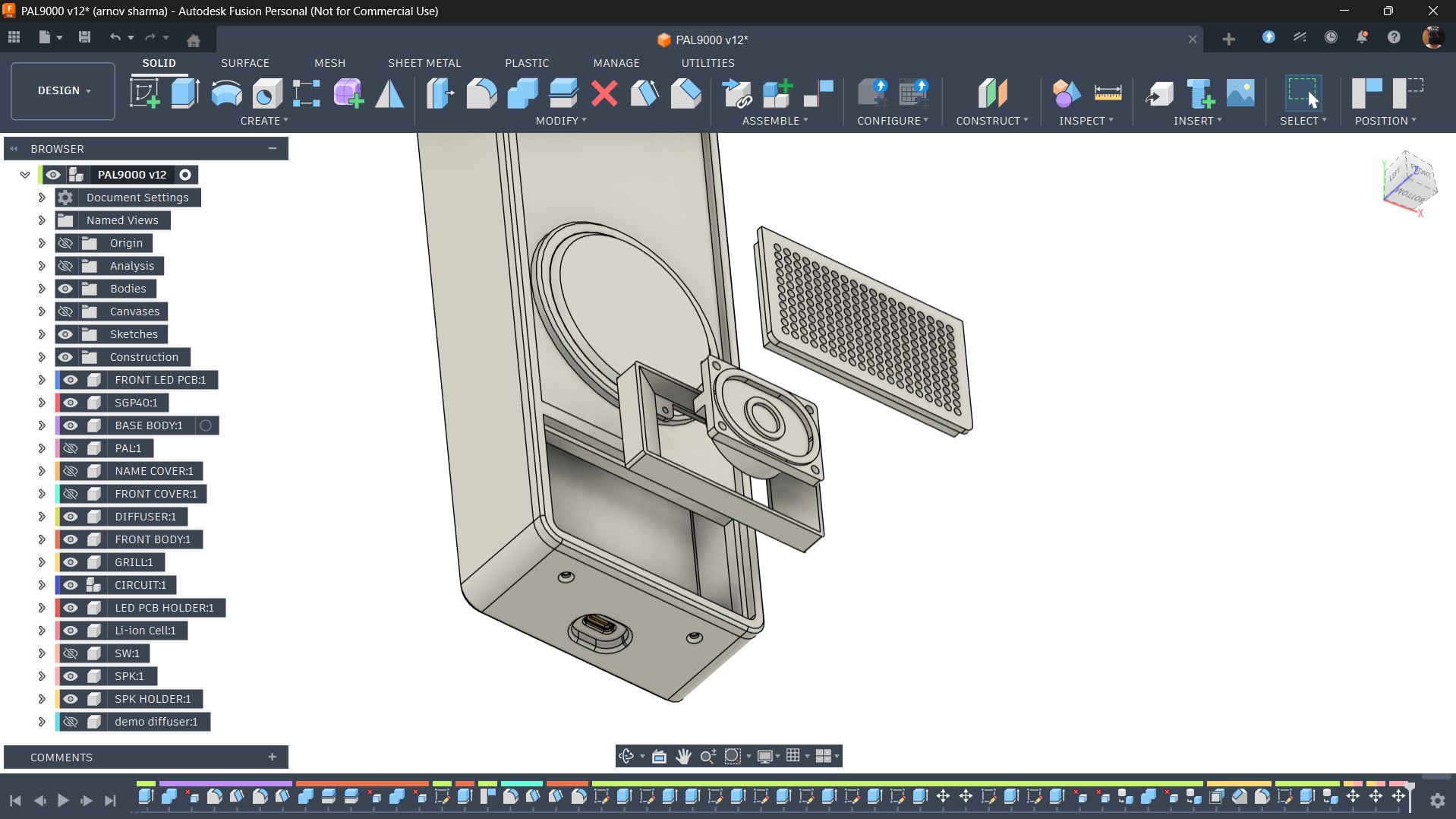

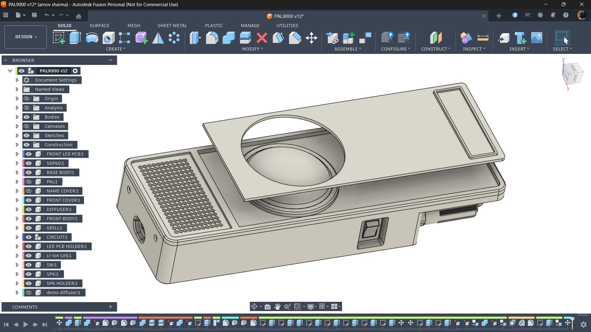

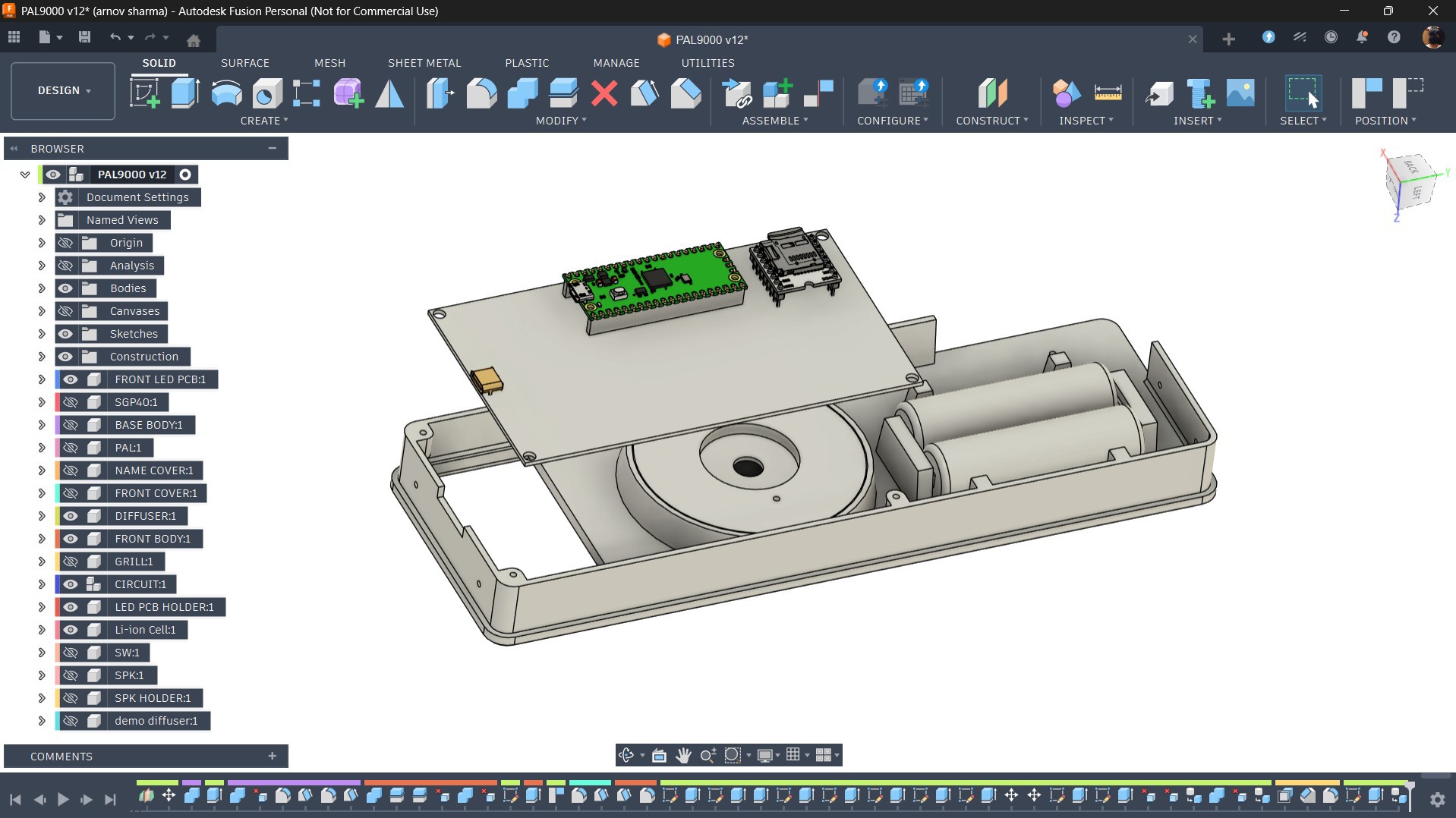

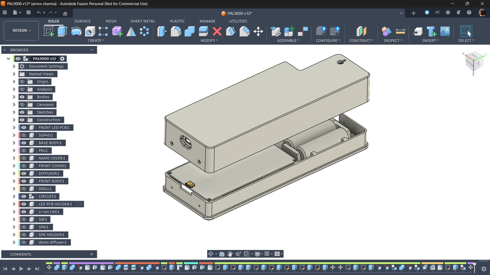

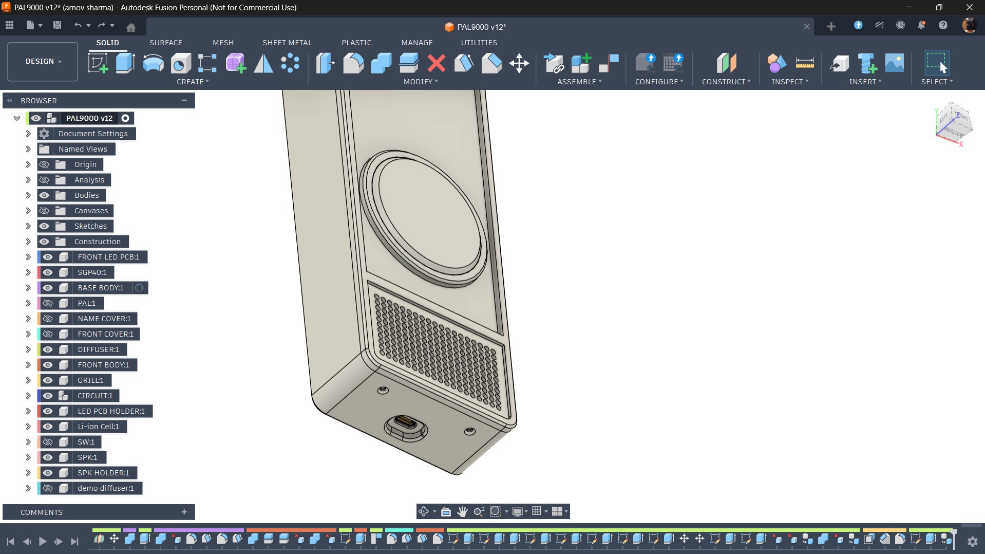

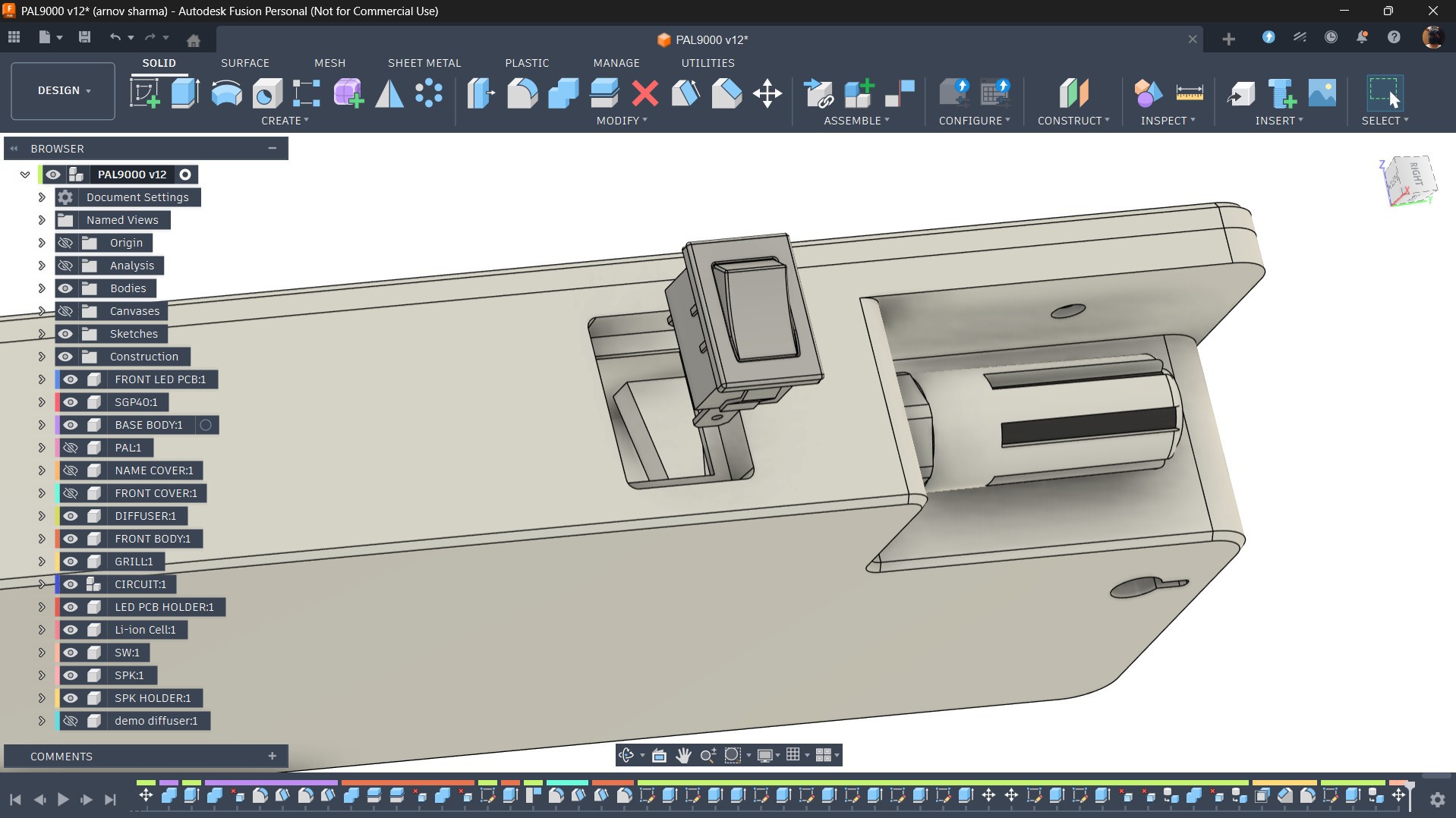

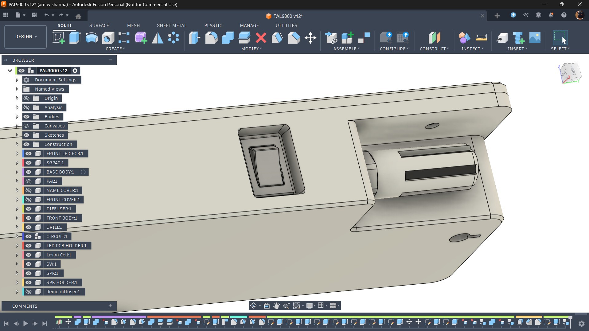

DESIGN

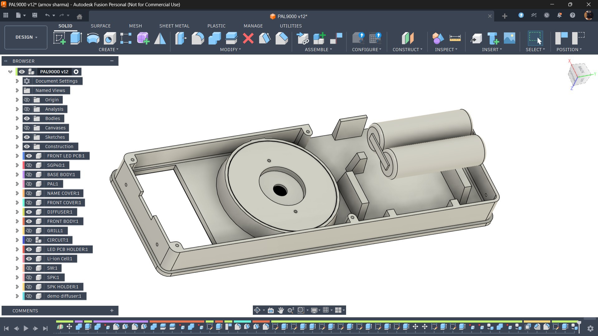

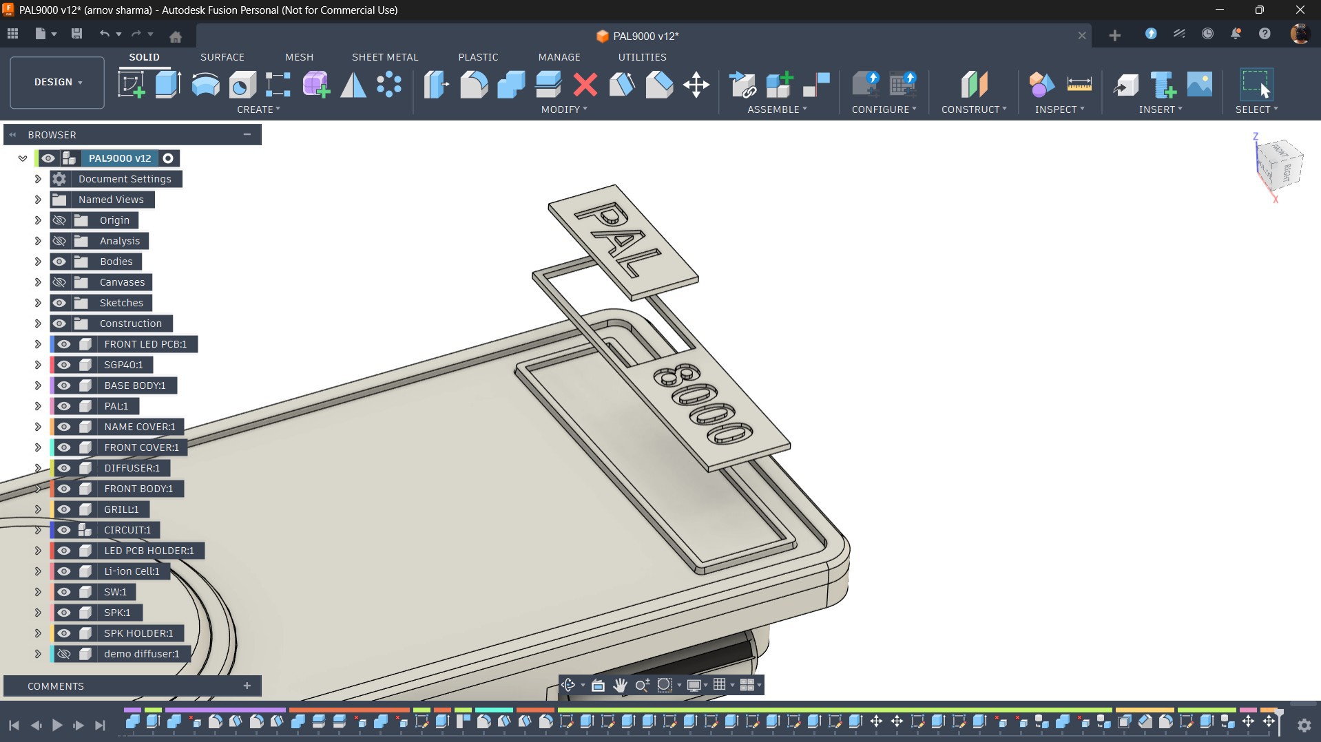

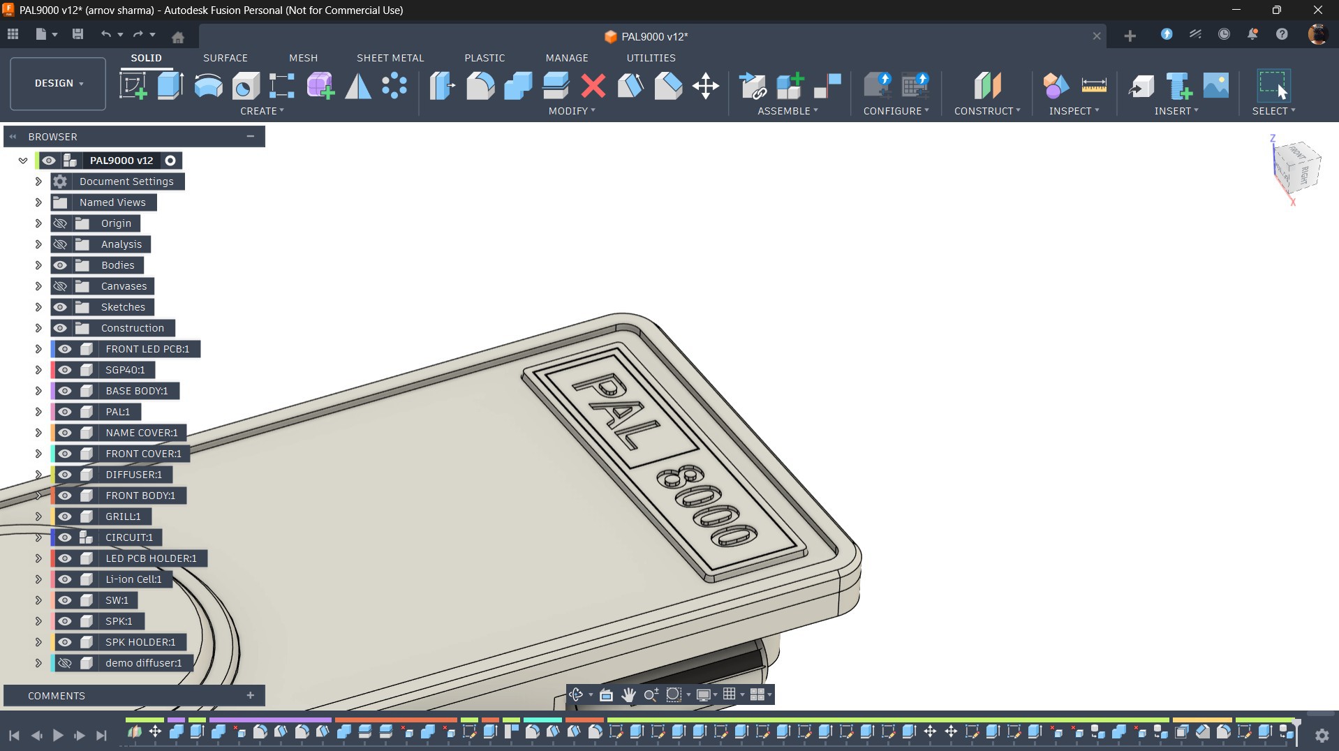

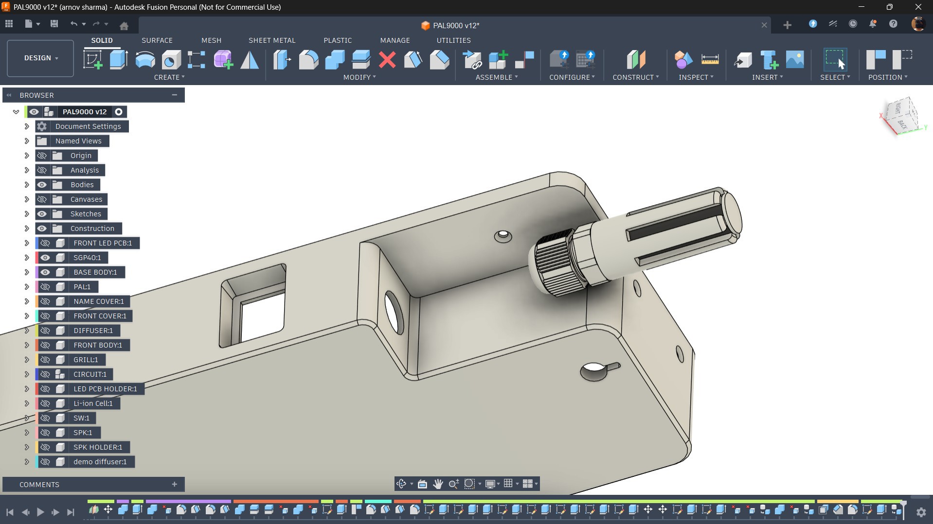

To get started with the design, I began by preparing the enclosure in Fusion 360. I imported 3D models of my existing LED board and Pico driver board from previous projects and searched for a high-quality front-facing reference image of HAL 9000. This image was used to trace the basic outline of the enclosure, which was then extruded and refined to house the Pico driver board and LED board inside. The LED board...
PAL9000 v12.step
step - 12.93 MB - 03/31/2026 at 13:26

PAL9000 v12.f3d
fusion - 8.76 MB - 03/31/2026 at 13:26
Download

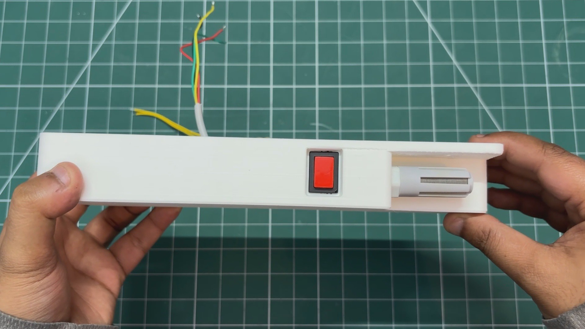

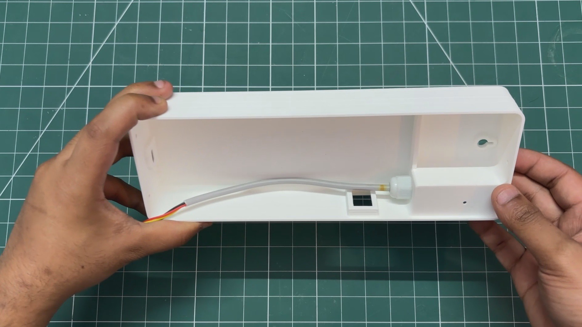

    BACK BODY & SGP40 SENSOR ASSEMBLY
    After the demo run, we desoldered all the components from the Pico driver board. We did this so we could reinstall them individually, along with the enclosure.
    • We started by removing the retaining nut from the PG7 gland of the SGP40 probe, then passed the wire through the mounting hole on the back body.
    • We positioned the SGP40 sensor in place and tightened the nut back, securing the PG7 firmly.
  • 3
    BACK BODY & SWITCH ASSEMBLY
    Next, we used a push button in the form factor of a rocker switch and positioned it in the slot on the back body. It is pressure-fitted into place, and the rocker switch includes two locking tabs that ensure it is held securely in position.
View all 12 instructions
