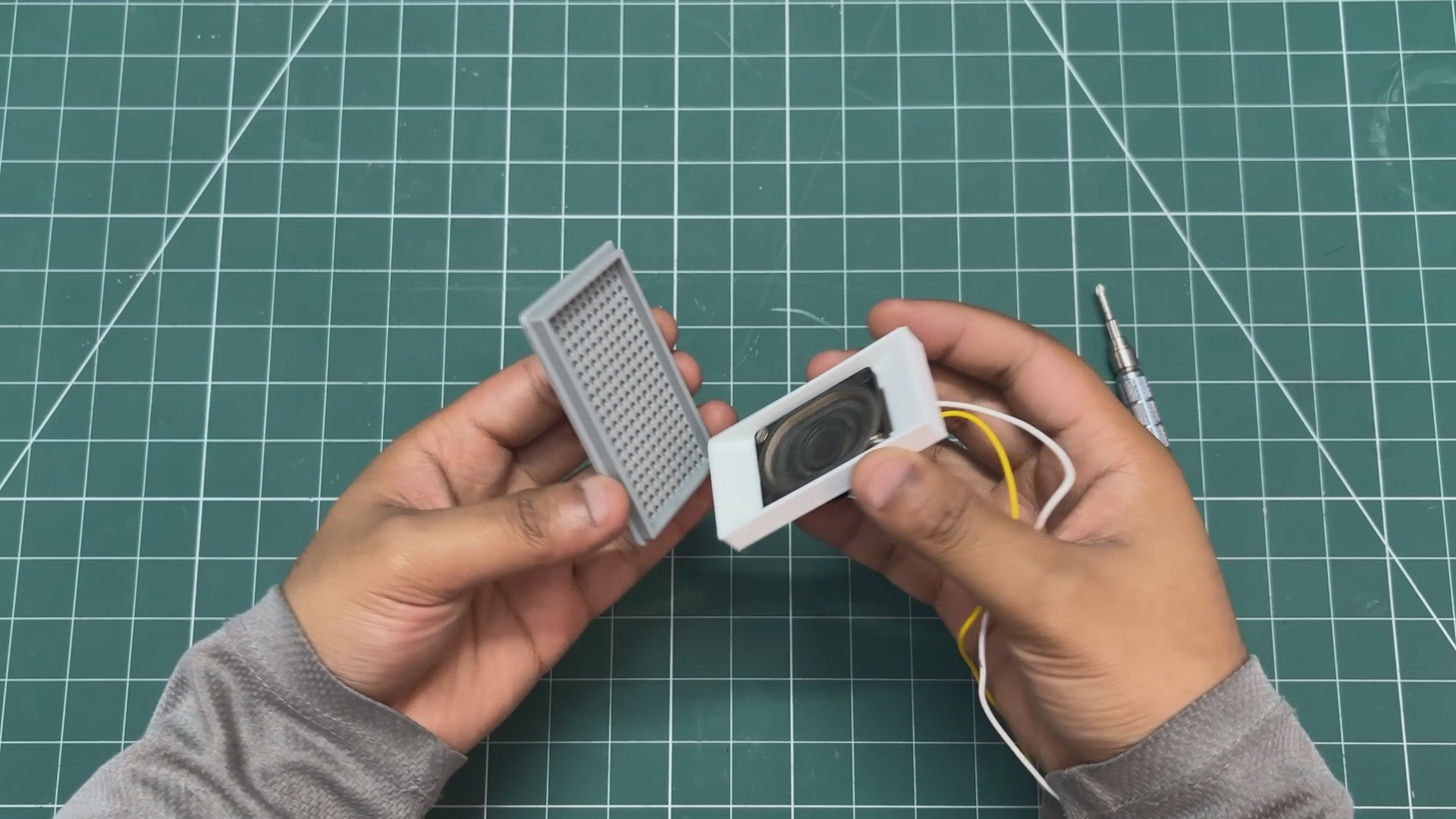

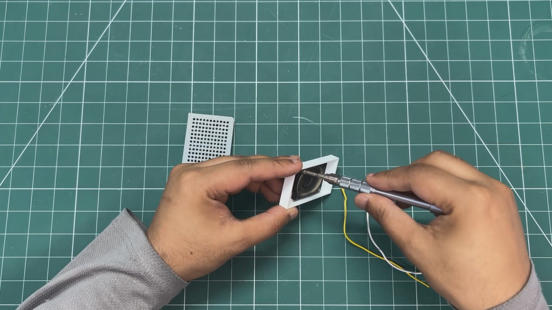

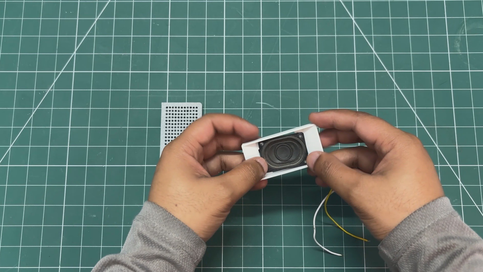

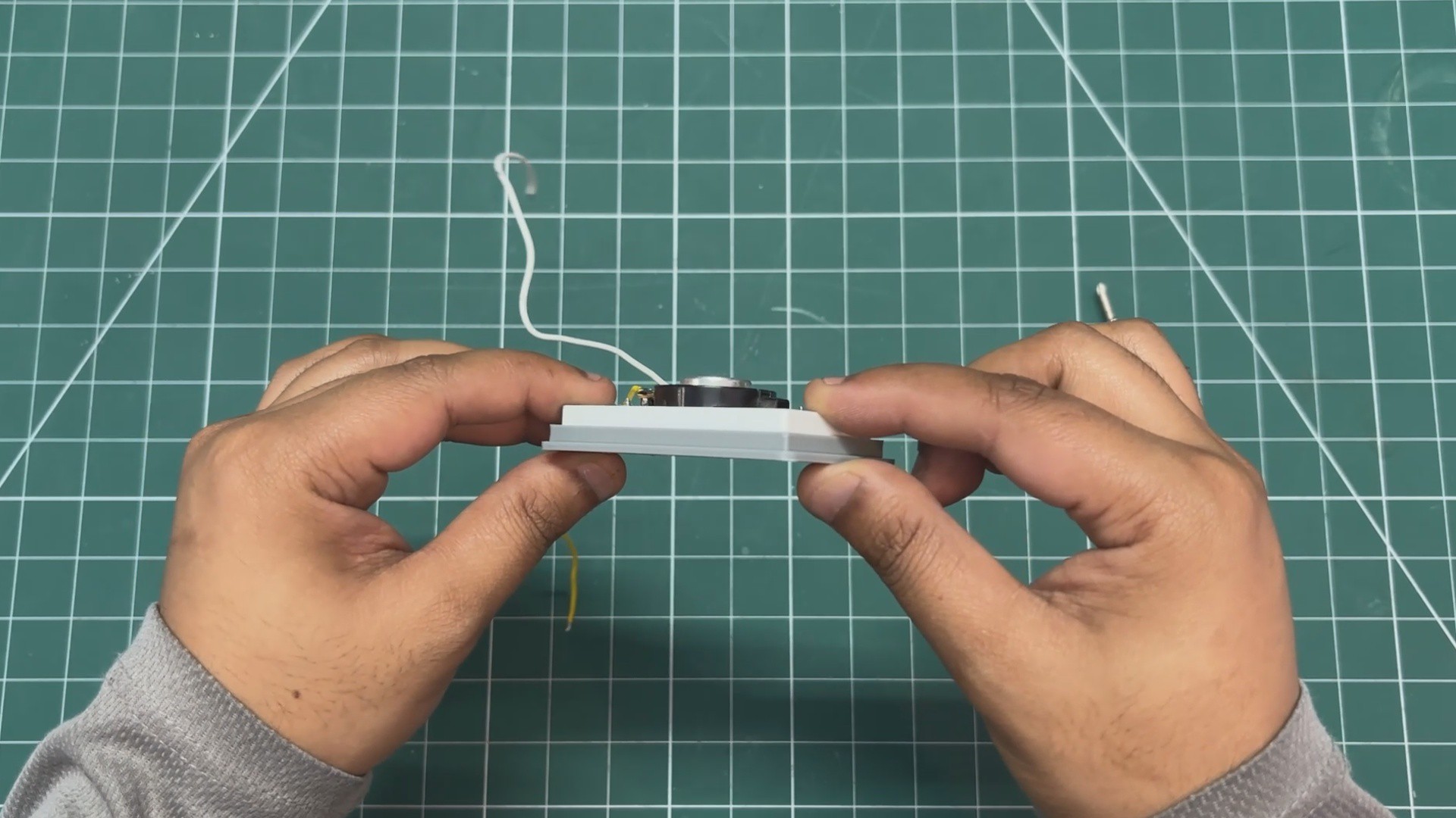

4SPEAKER GRILL ASSEMBLY
We next start the speaker assembly process, which begins by positioning the speaker holder over the speaker’s mounting holes, then using two M2 screws to secure them together.![]()
- The speaker grill is then positioned over the speaker holder, and both parts are pressure-fitted together.

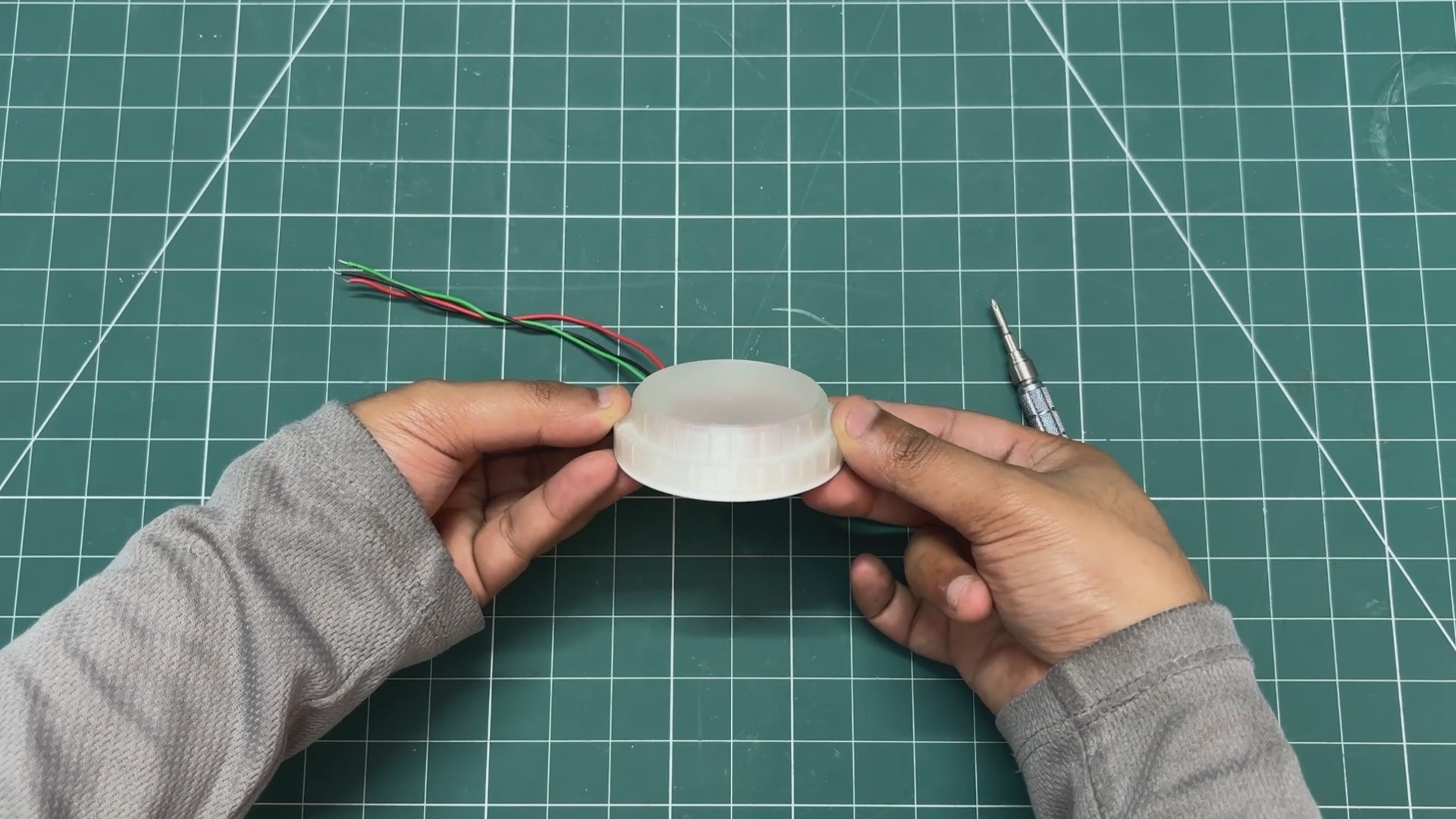

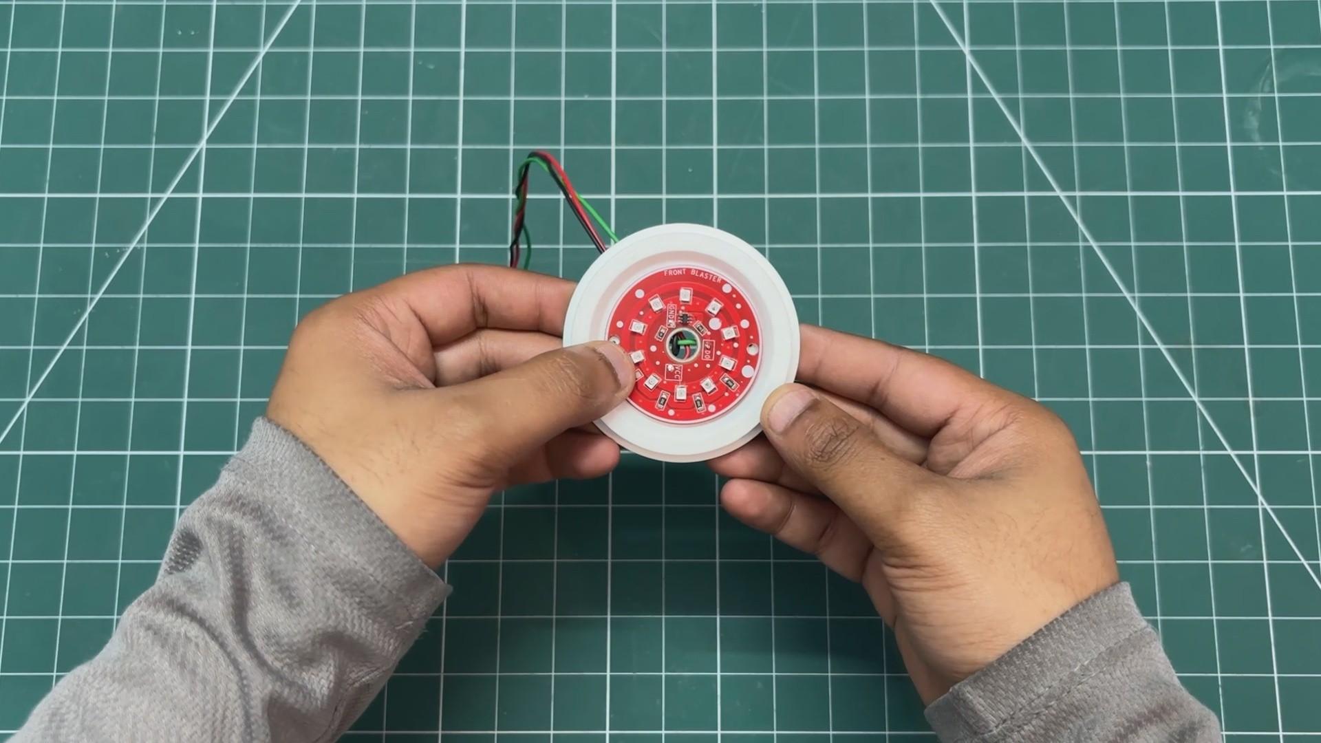

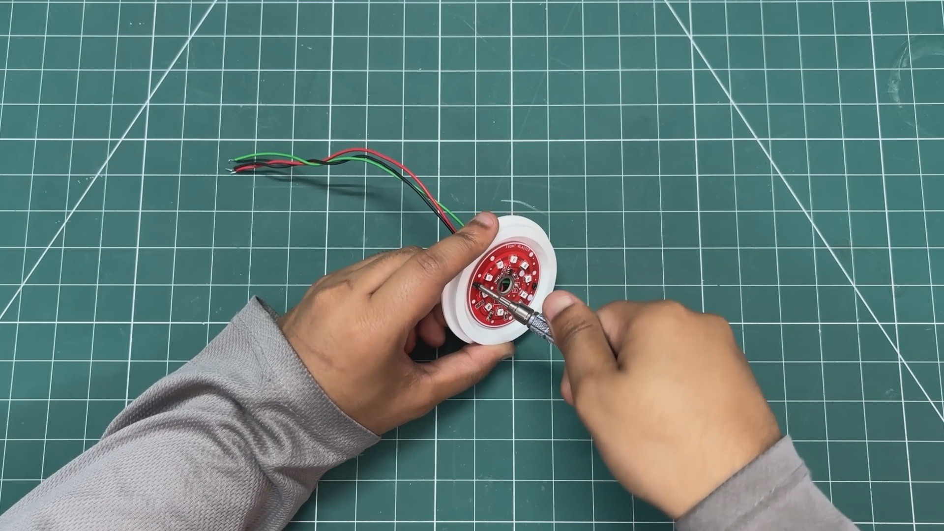

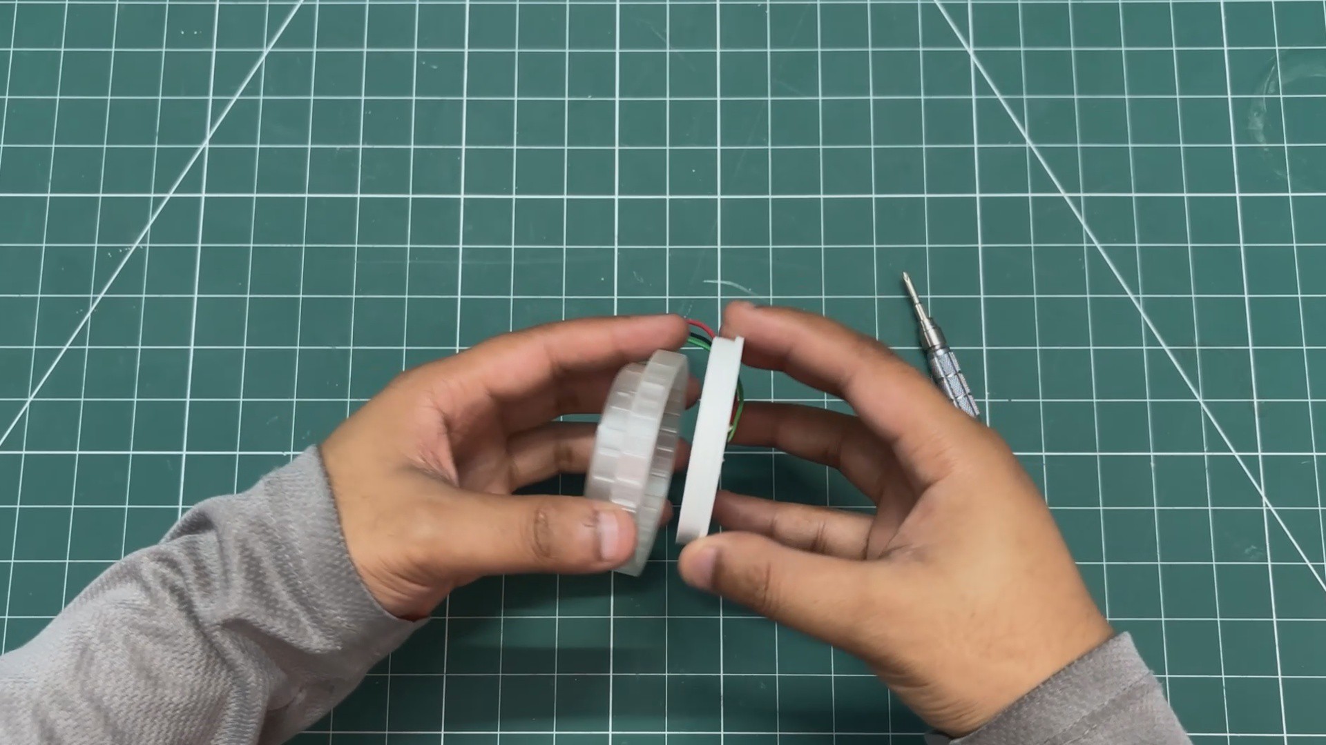

5LED HOLDER & DIFFUSER ASSEMBLY
We passed the wires of the LED board through the hole in the LED board holder, then aligned the mounting holes of the LED board with the holder and used two M2 screws to secure them together.![]()
- The LED diffuser is placed on top of the LED board holder, and both parts are pressure-fitted together.

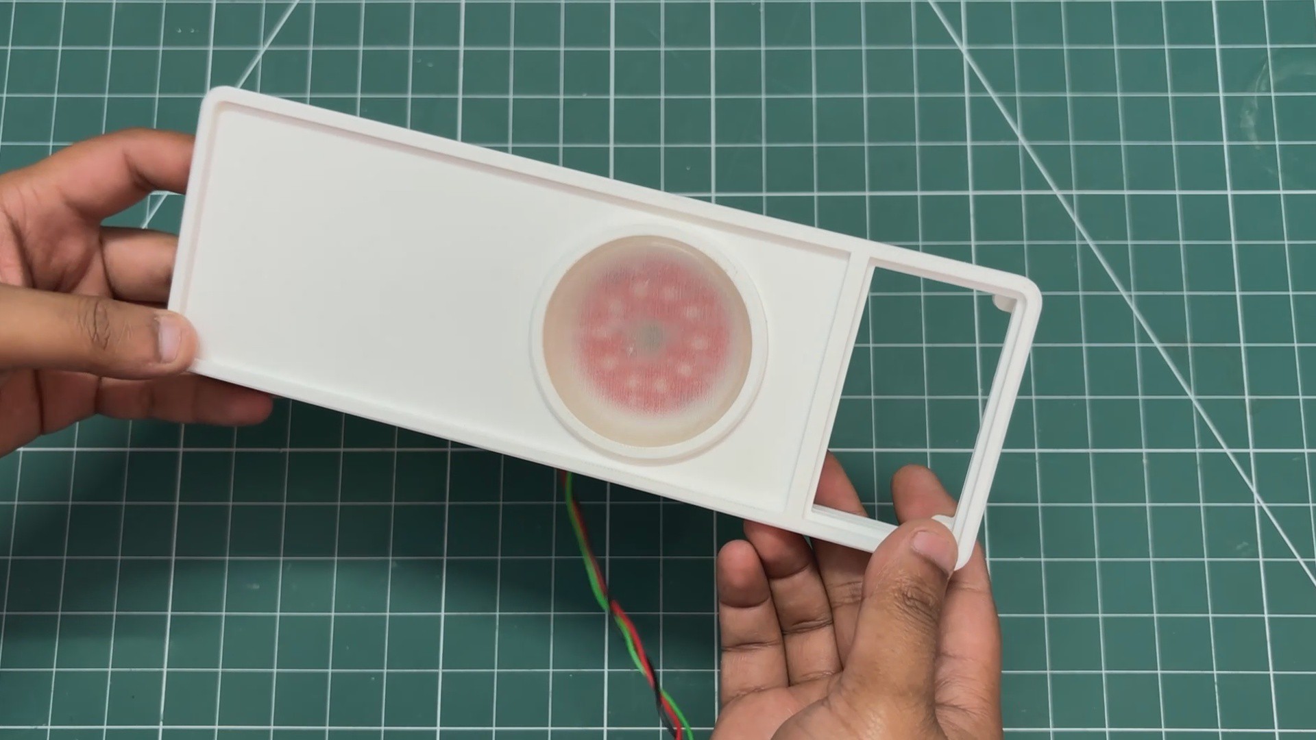

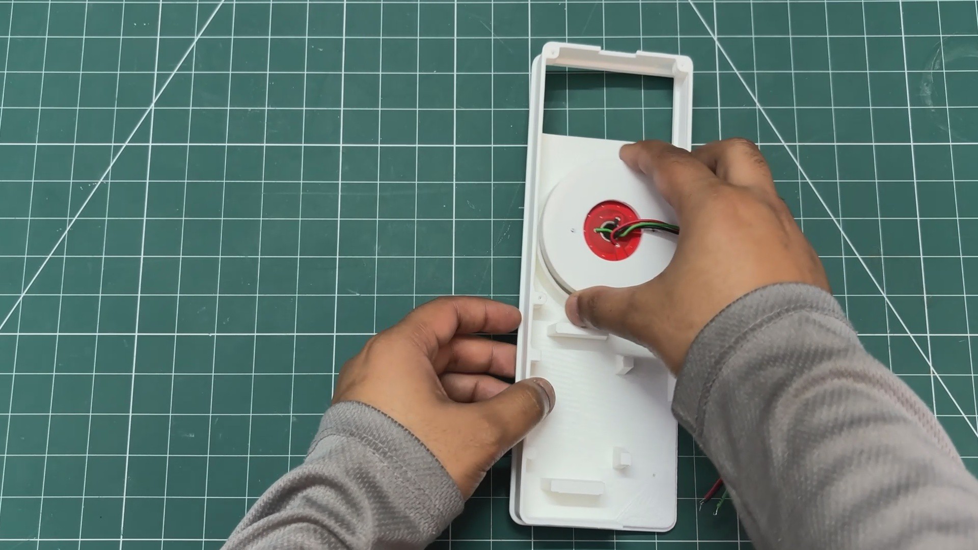

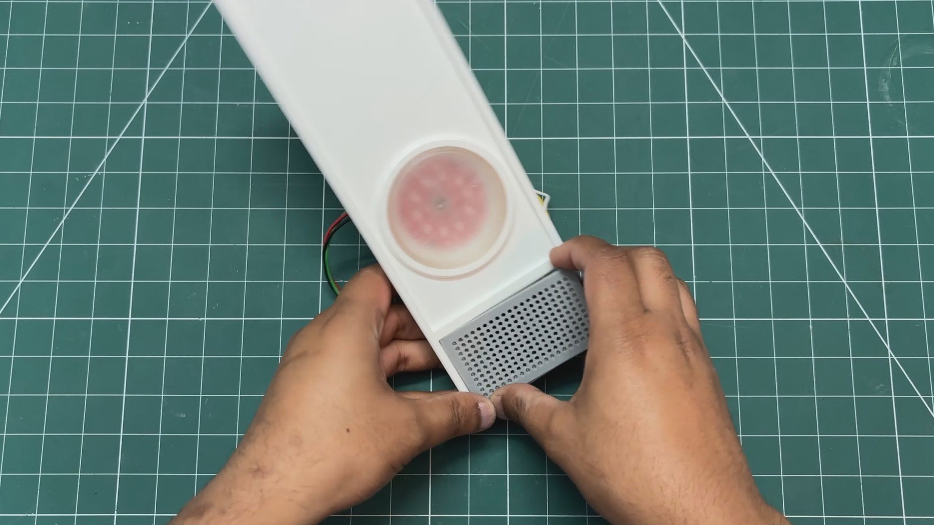

6FRONT BODY ASSEMBLY
The LED board is now positioned in its place on the front body. It is inserted from the inside of the front body and pressure-fitted into place.![]()
- Similarly, the speaker assembly is added from the front side and is also pressure-fitted into position.

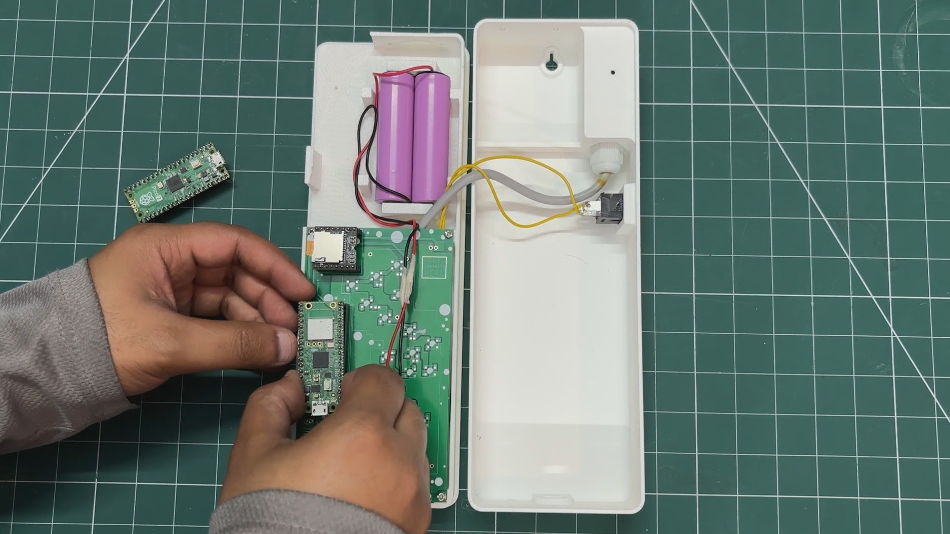

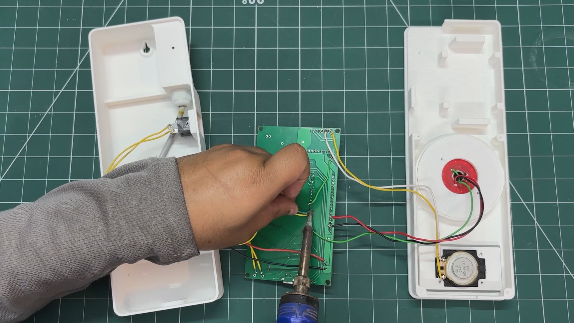

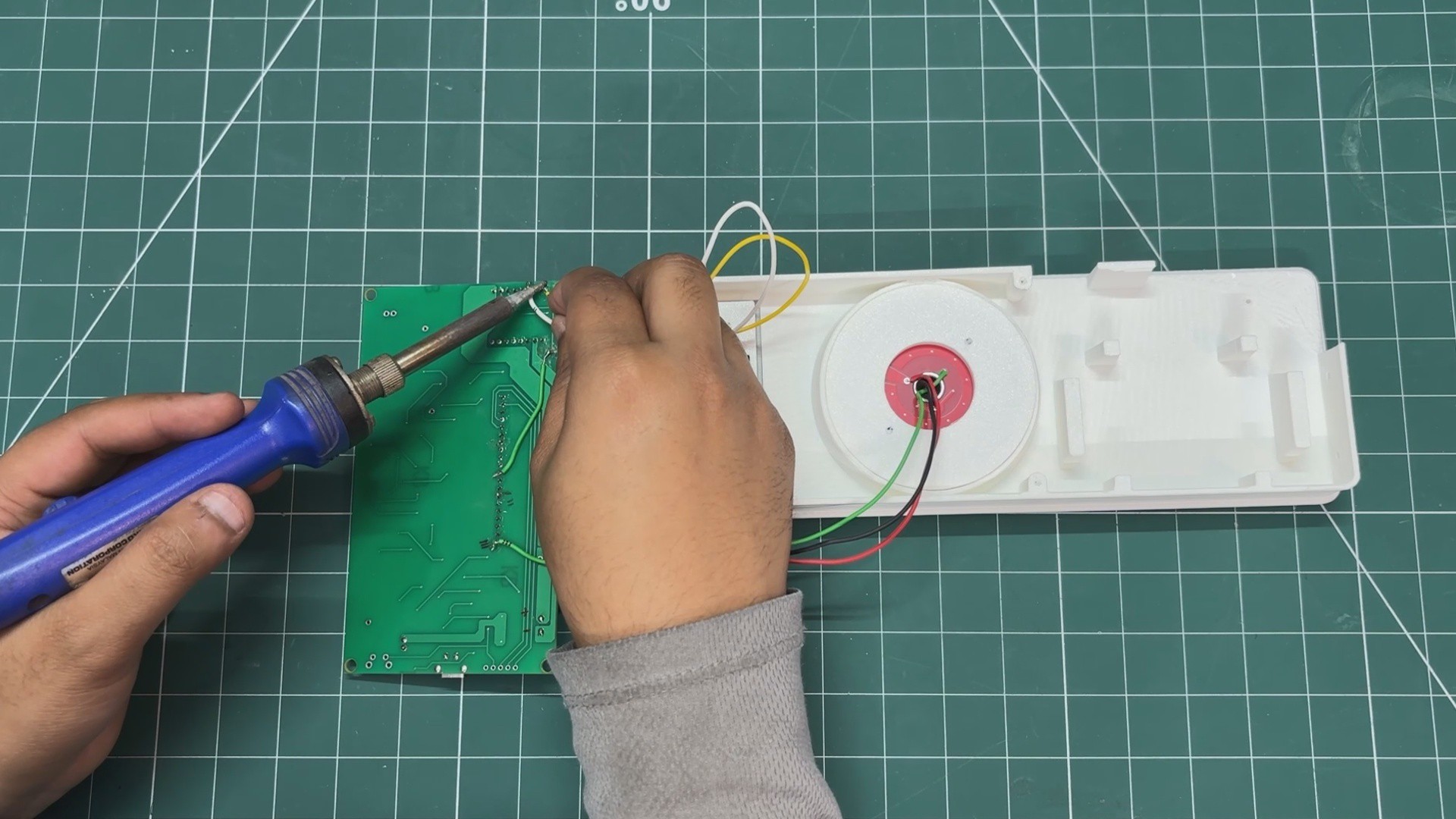

7ReWiring Process
The Pico driver board is first reconnected to the LED board and speaker. We solder the LED board’s VCC and GND to the 5V, and GND of the Pico driver, and the speaker wires are connected to the DFPlayer’s SPK1 and SPK2 pins.
Similarly, we connect the SGP40 sensor’s SDA and SCL pins to GPIO4 and GPIO5 of the Pico. The VCC of the SGP40 is connected to the 3V3 pin of the Pico, and GND is connected to GND. Additionally, the rocker switch wires are connected to GND and the SW pin of the IP5306 IC. Pressing the rocker switch turns ON the IP5306 setup, and double-pressing the button turns the device OFF.

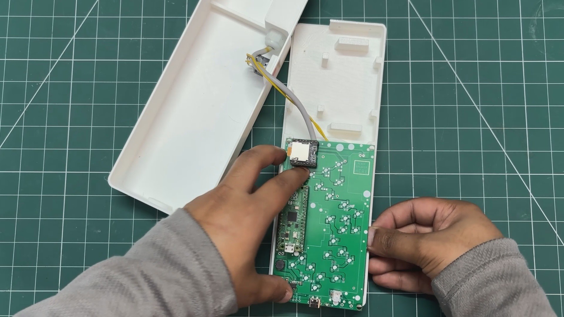

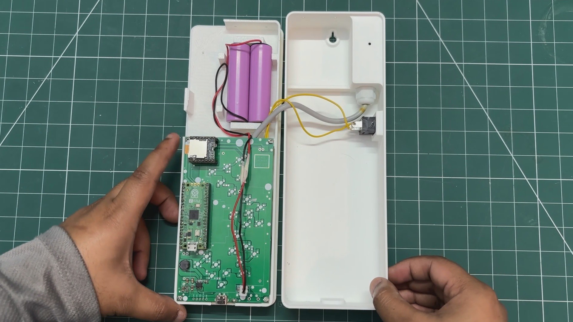

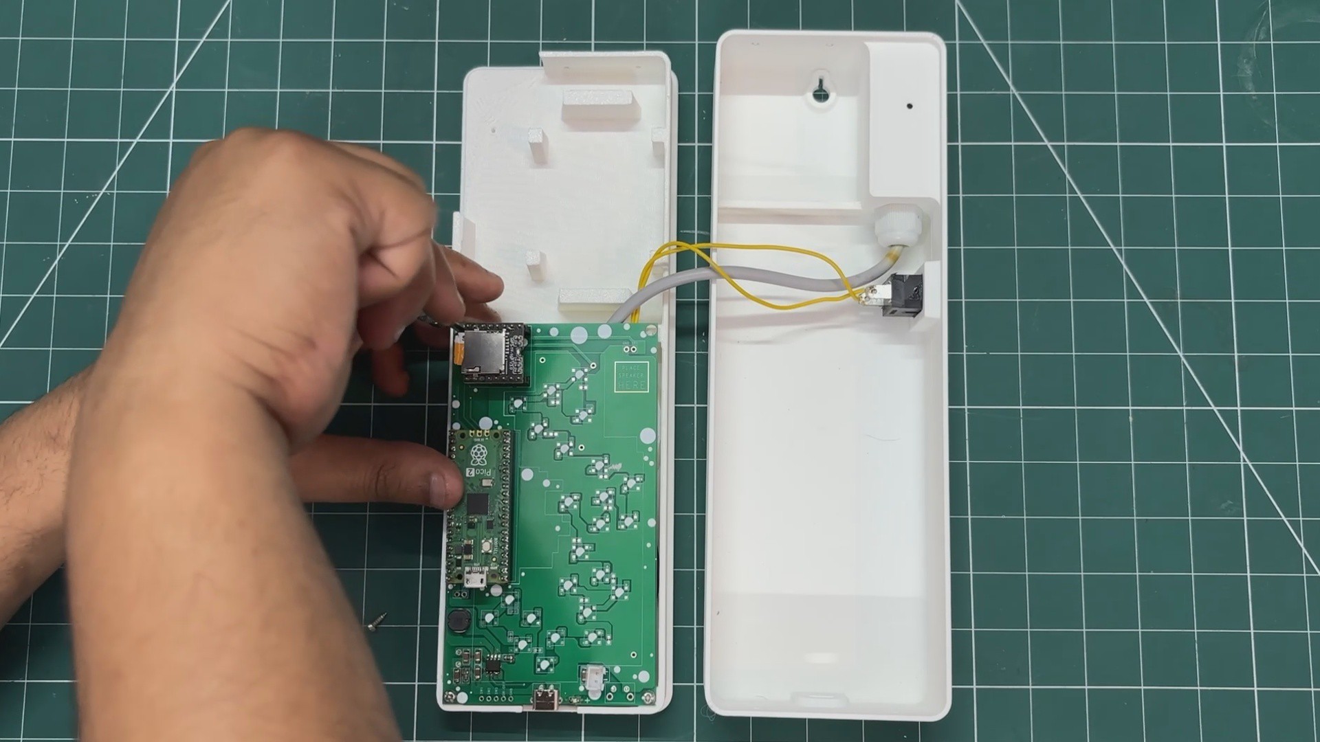

8PUTTING THINGS TOGETHER
The Pico driver board is positioned in its designated place on the front body and then secured using four M2 screws.![]()
- We extended the length of the lithium battery connector so it could be placed on one end of the model and still connect to the Pico driver, whose connector is located on the opposite end.
- We then connected the lithium cell’s JST connector to the connector on the Pico driver and placed the battery into its mounting position.
9PICO W SWAP
At this stage, with most of the assembly complete and only the final enclosure left to put together, we replaced the existing Pico 2 with a Pico W and uploaded the updated code with web app support. This upgrade enhances the project further by adding Wi-Fi connectivity.
