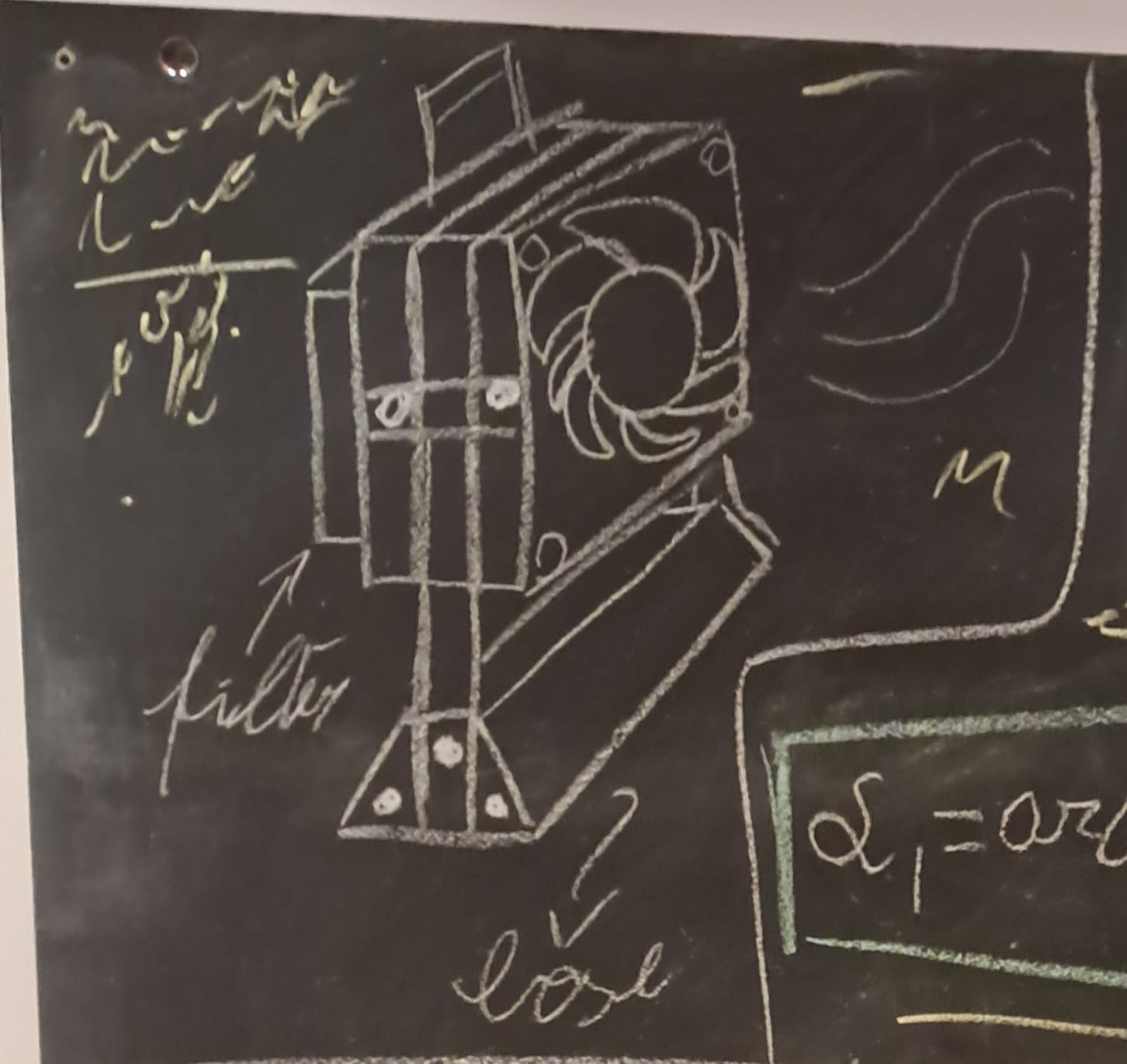

I started to design the extractor unit around an old PC fan that I had lying around in my lab, taking measurements, and then I started sketching a couple of prototypes, trying out different shapes and styles.
Initial design on the chalkboard.
It had to be rugged and practical but also relatively compact and appealing to the eye.

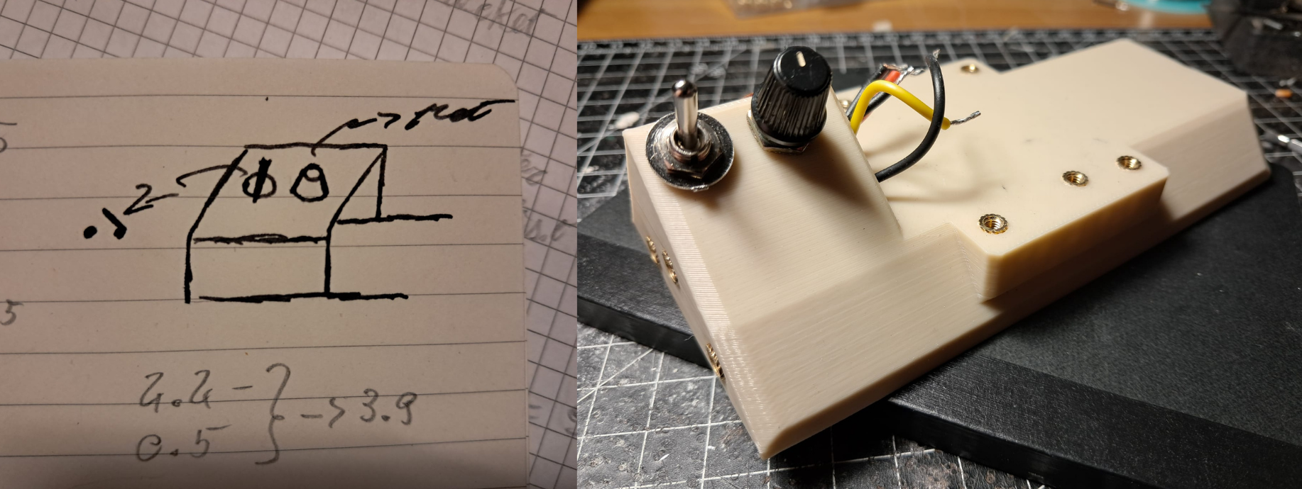

Base
For the base I wanted a low profile shape that would ensure good stability too.
I went for a trapezoid with a modified upper surface to make enough space for the circuit case and the control panel designed to follow the base contour as naturally as possible.

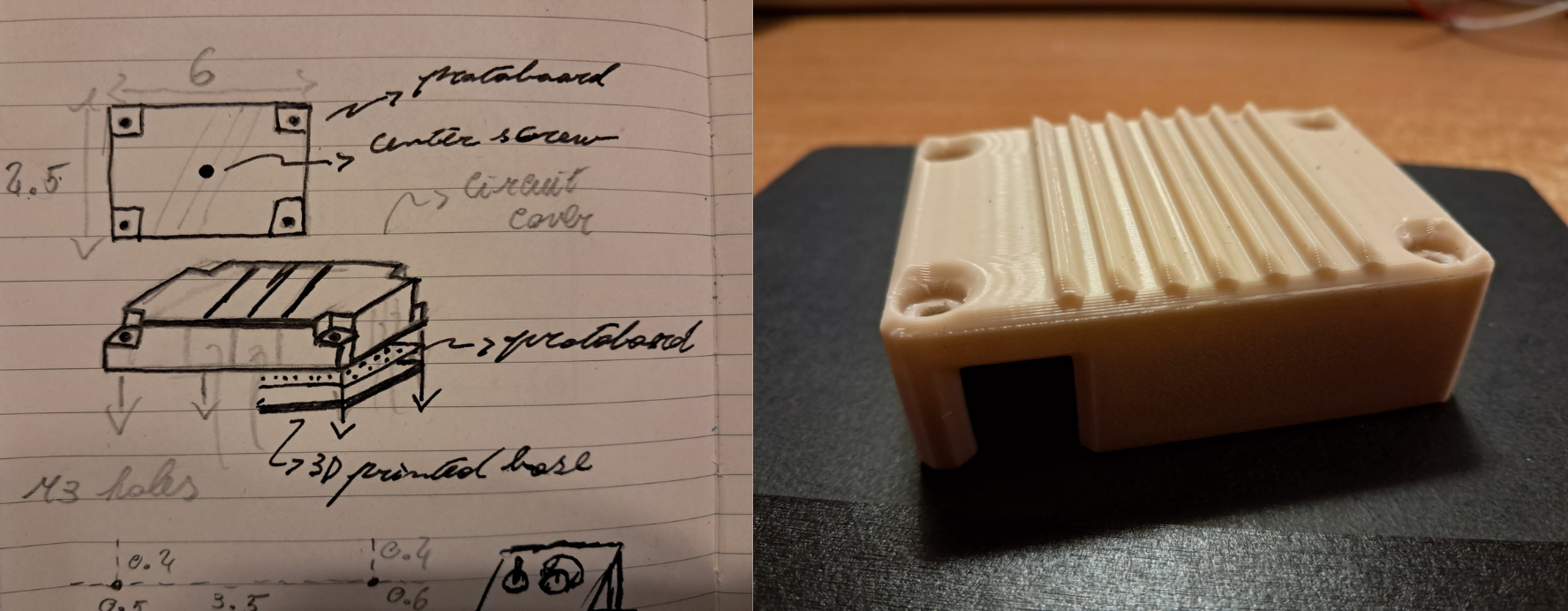

Circuit case
The circuit case was specifically designed for the circuit I made on the protoboard.
There are two holes on the sides, they both leave plenty of room for the power and control connectors.
The internal hollow sections allow housing for all the components.

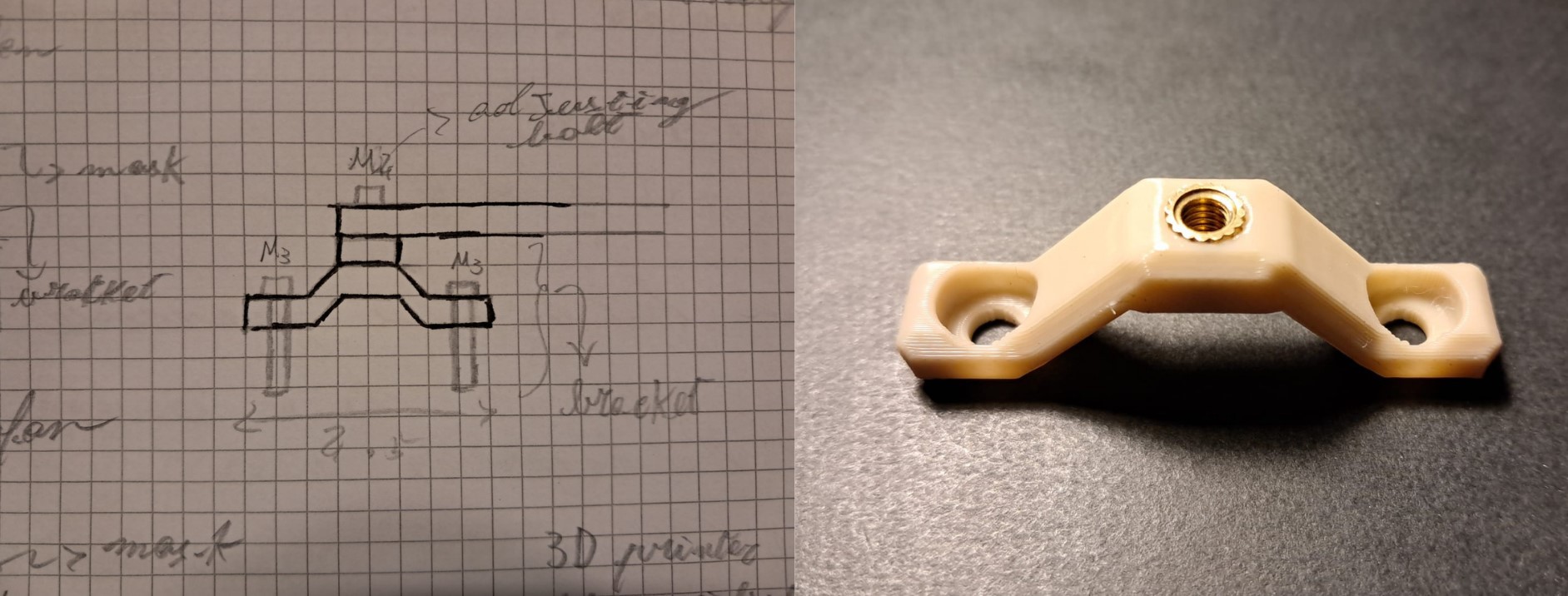

Leg
I had to go through a couple of iterations to get the leg model right.
They kept detaching from the printer plate while printing, I later solved the problem by making the end tip wider. I'm also pretty sure this helps the adjusting bolts on the side to get more grip for safer fastening.

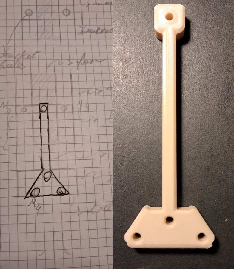

Bracket
This was one of the most satisfying prints of the project because it came out just as I first imagined it.
It is a pivotal part connecting the base to the ventilation and filtering system.
If I had to redesign it, I would make the bolt holes chamfer less deep, leaving more material just to improve structural stability.

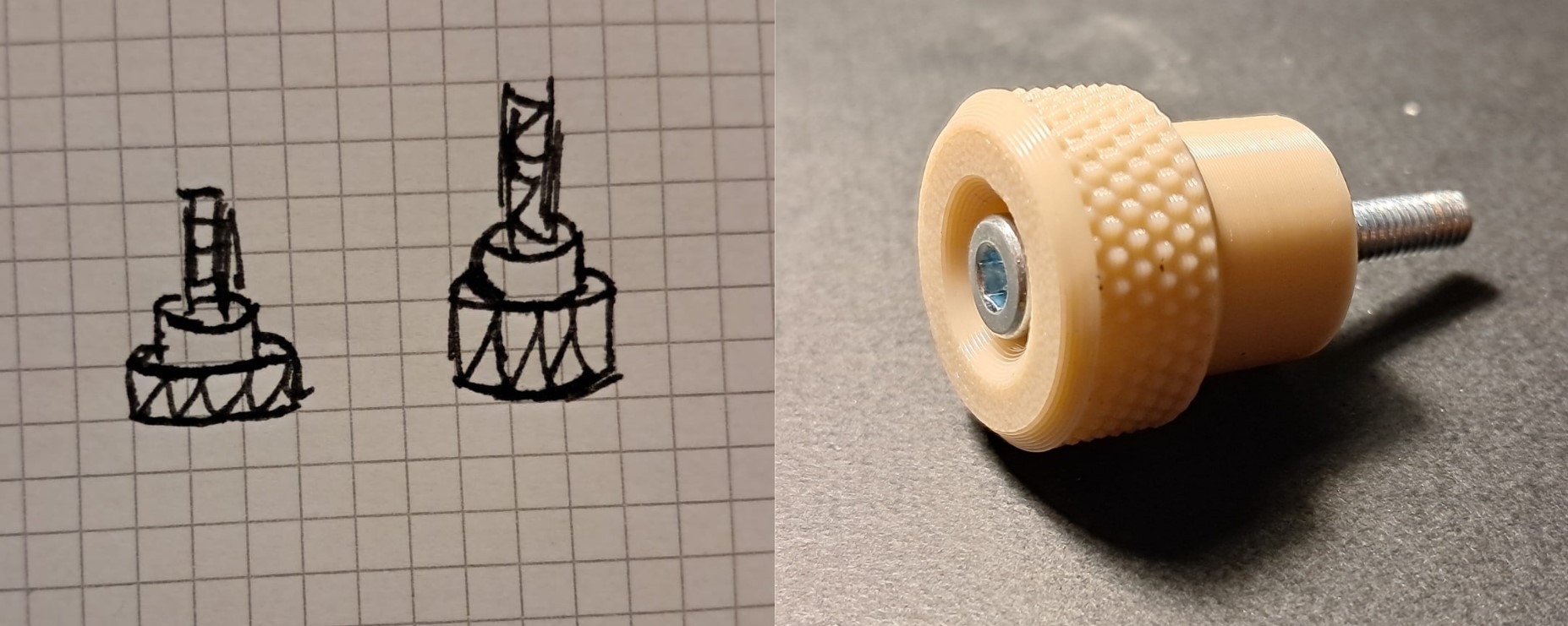

Adjustment bolt
Before this print, I did not believe that a commercial 3D printer could make such precise works as the diamond knurl on the side of this bolt, it made me feel like I was working with a lathe instead of an Ender 3.

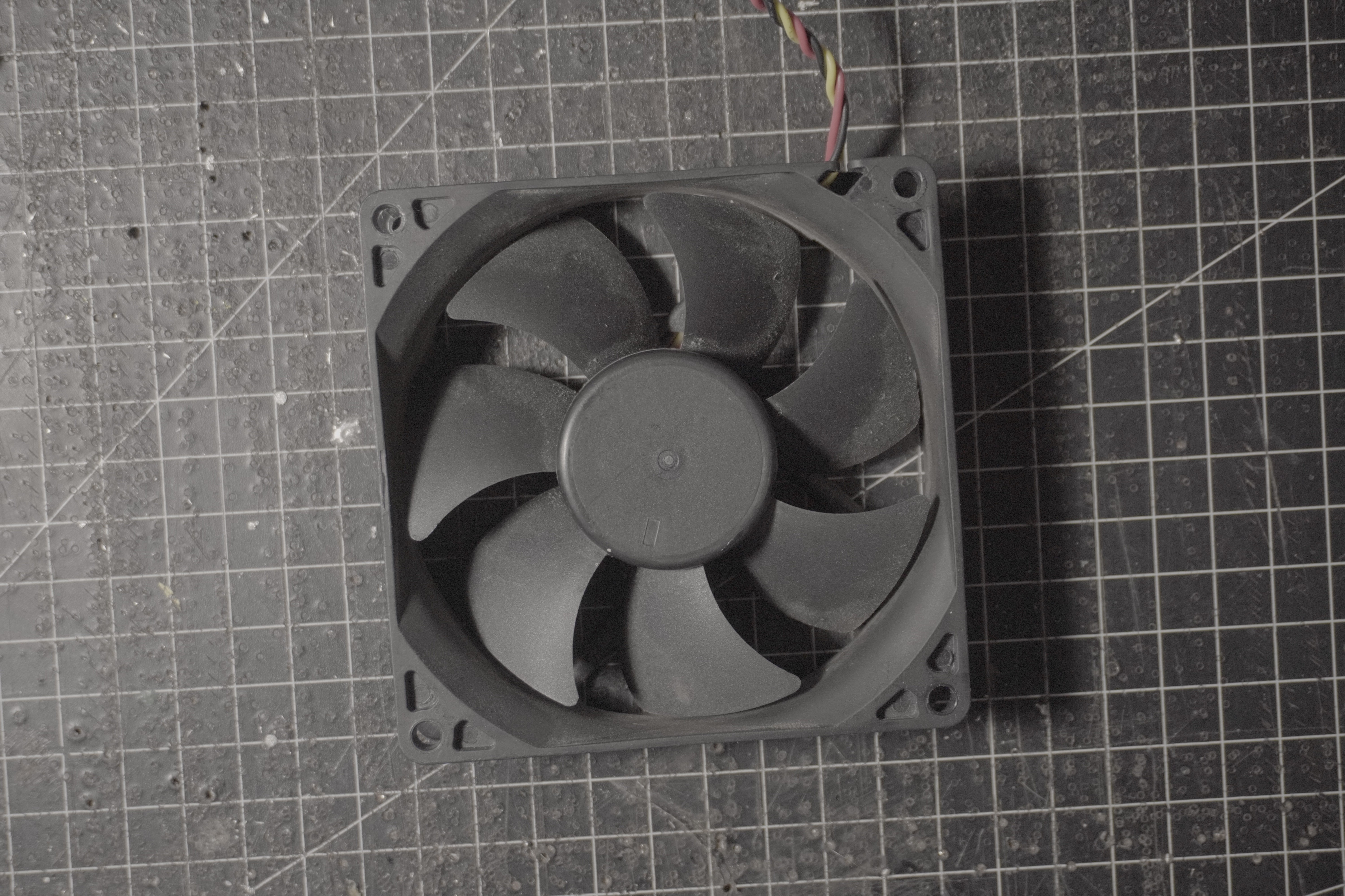

This is the old PC fan that I used as reference to design all the project's component.
