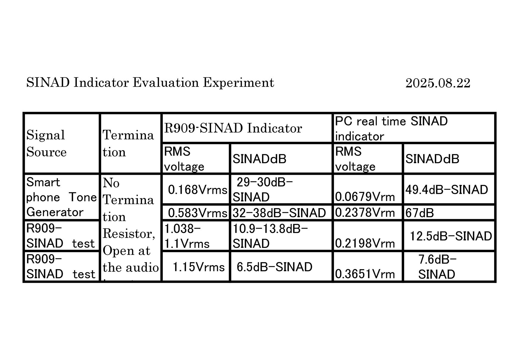

The tinySA now has an SG function. I needed a SINAD meter for receiver sensitivity tests. So I built one on an ESP32-C3 and also on a Raspberry Pi Pico.
What it does
- SINAD measurement: 10kHz sampling, 1kHz digital notch filter (IIR)
- Waveform display: Real-time audio waveform
- FFT spectrum: Visualize noise and distortion
Why SINAD?
(Signal + Noise + Distortion) / (Noise + Distortion). Includes distortion. Tells you about usable signal quality. Works for FM, AM, and SSB.
The setup
tinySA ULTRA(SG) → Receiver under test → ESP32 SINAD meter or RPP SINAD meter
Code & hardware
Open source. { https://github.com/Nobcha/R909-SINAD/blob/main/}
This short video shows the ESP32-based SINAD meter in operation, including real-time SINAD readout and FFT display.
👉 https://www.youtube.com/watch?v=a2N7Uo3oPMg
In the video, notice how the SINAD value changes with signal level and how the FFT reveals noise and distortion components.
