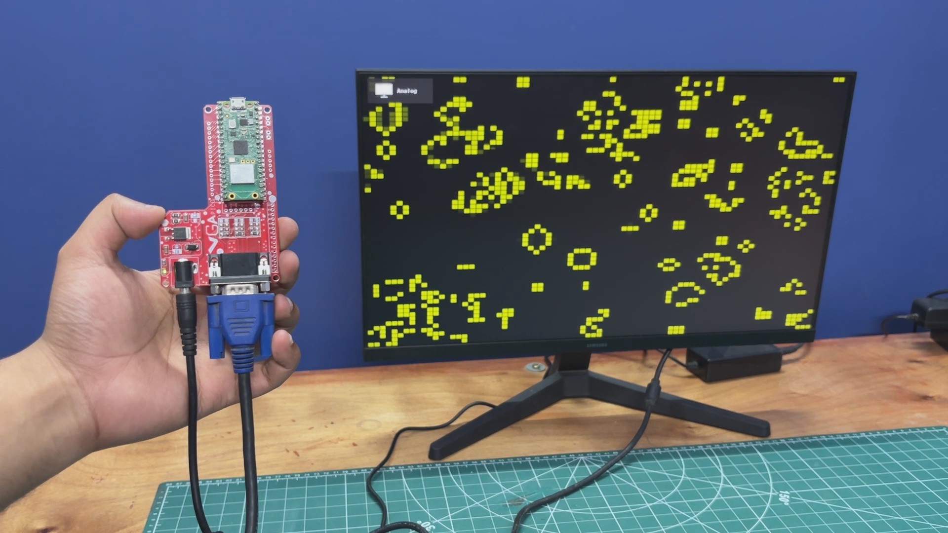

Today I’ve got something super interesting to show you — the Pico VGA Board.
The heart of this project is a Raspberry Pi PICO W paired with a D-SUB15 connector, and with this setup, we can use a regular TFT monitor as a massive display for pretty much anything we want.
Here's a demo of Conway’s Game of Life running on a full-sized monitor.
The whole project is loosely based around an existing VGA library for PICO, which was made to work with CRT monitors. I made some changes to it so it can be used with modern LCD VGA Monitors.

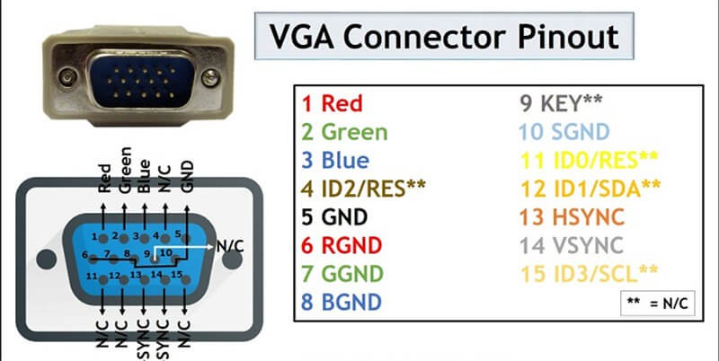

A VGA connector, also known as a D-Sub 15 (DB15) connector, consists of 15 pins. Pin 1 is for Red, Pin 2 for Green, Pin 3 for Blue, Pin 13 for HSYNC, and Pin 14 for VSYNC. The remaining pins are used for ground and other auxiliary functions.

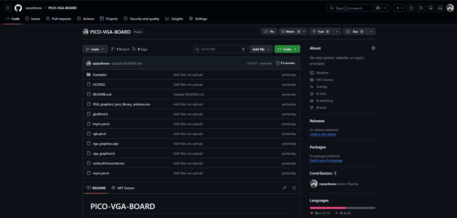

After making several modifications and adding a few example sketches, I created my own version of the library. This version is adapted for better compatibility with modern displays and can be easily installed and used from the GitHub link below.
https://github.com/razorArnov/PICO-VGA-BOARD

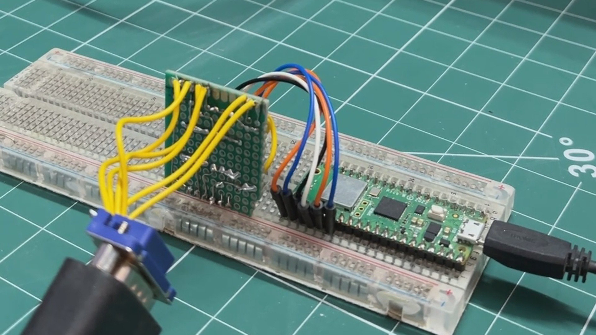

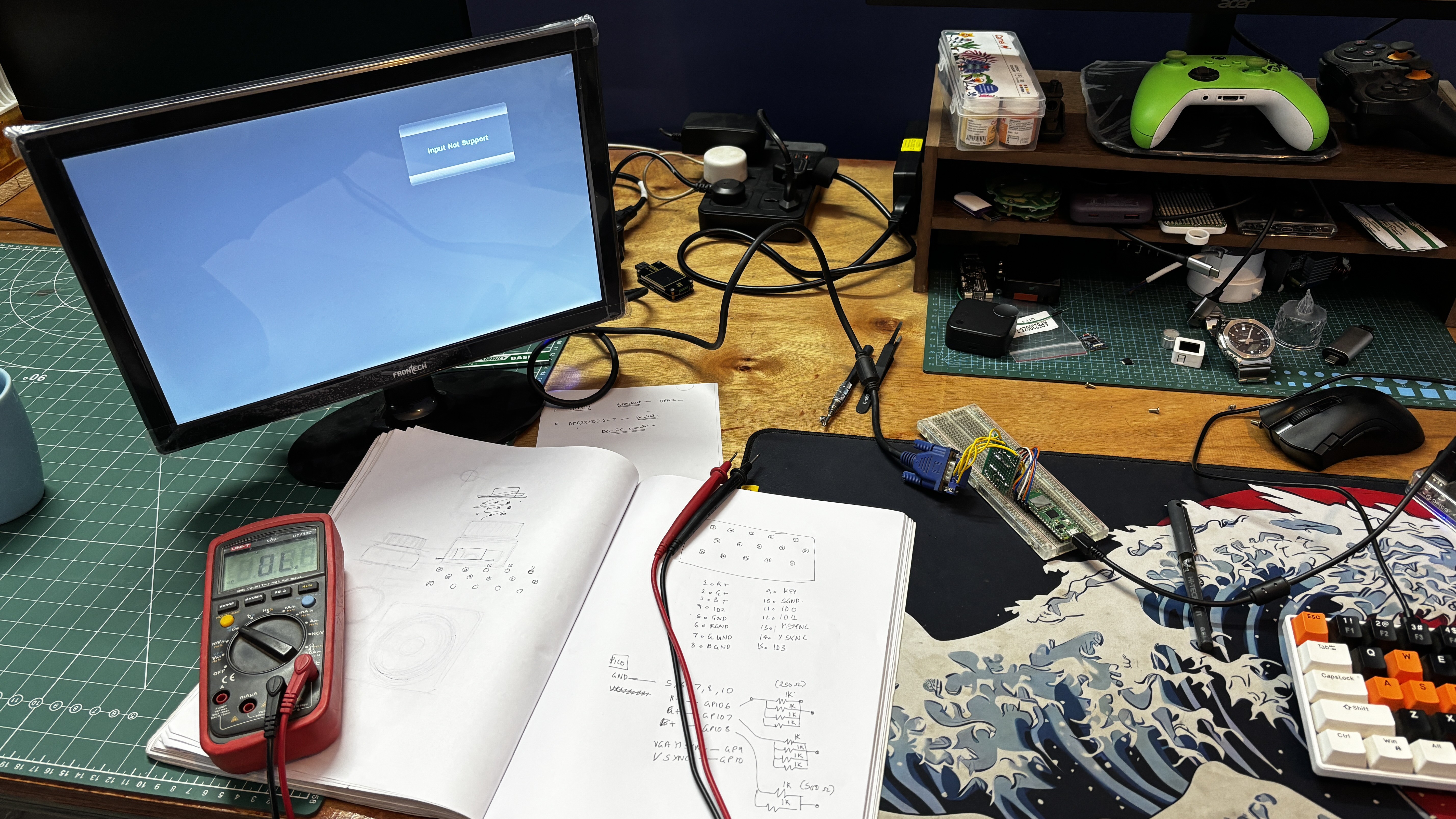

Using the VGA–Pico wiring diagram, we created a simple makeshift breadboard setup. A VGA connector was interfaced using jumper wires, which were connected to a prototype board containing resistor arrays for the RGB and sync lines. These signals were then linked to the Raspberry Pi Pico mounted on a breadboard, forming a complete test setup for VGA output.
BREADBOARD SETUP DEMO

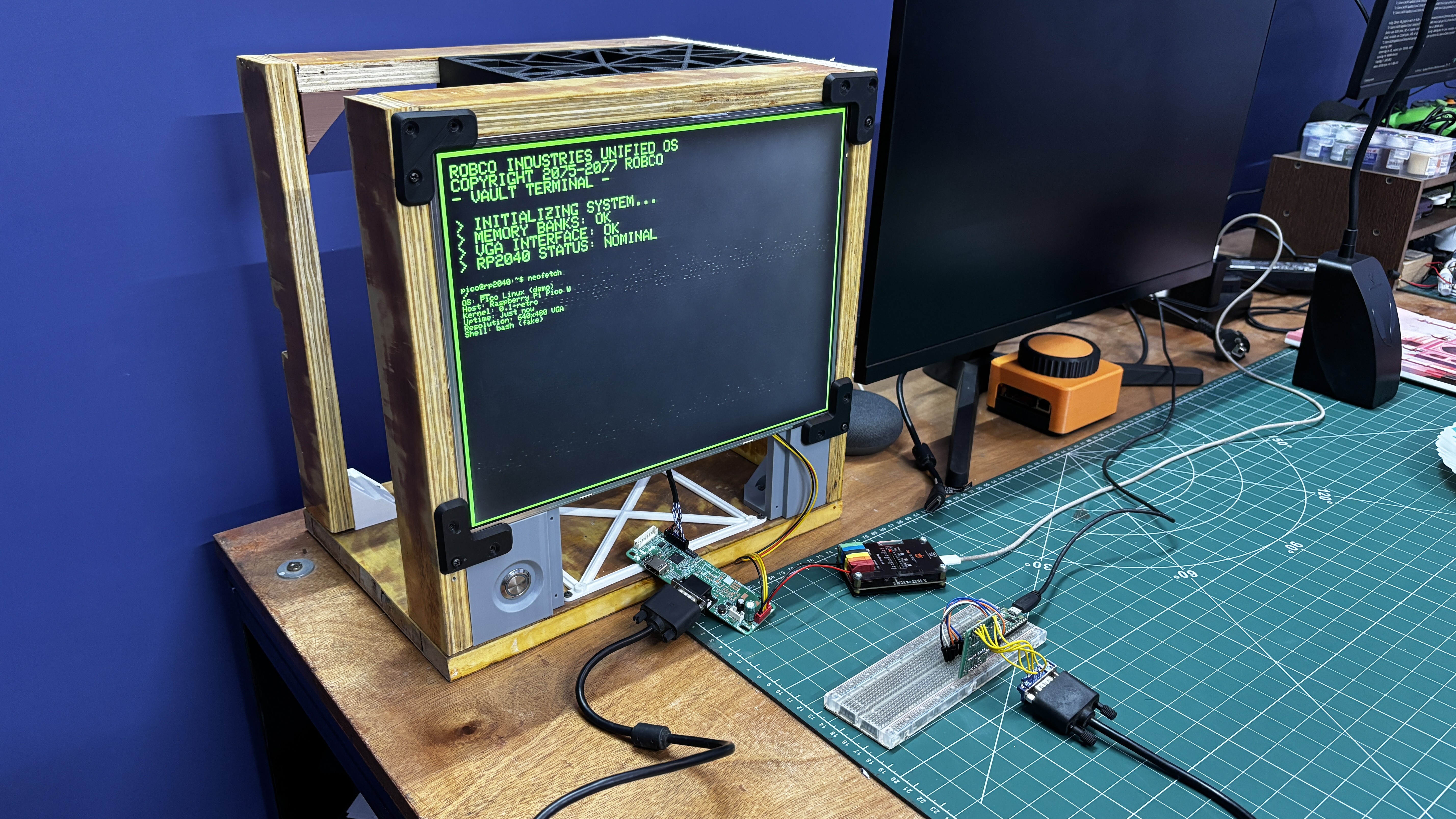

After completing the wiring, we uploaded a custom demo sketch that recreates a Linux-style terminal inspired by Fallout’s RobCo terminals, featuring the same iconic green color theme.
Below is the demo code.
#include "vga_graphics.h"...

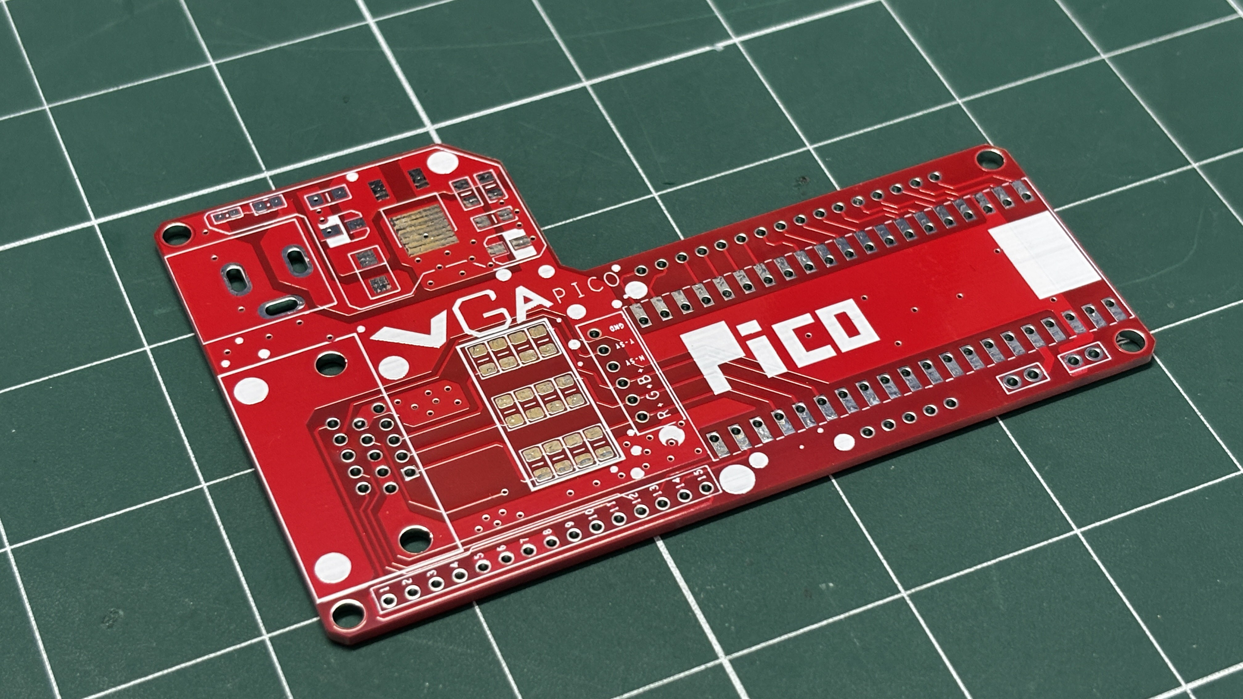

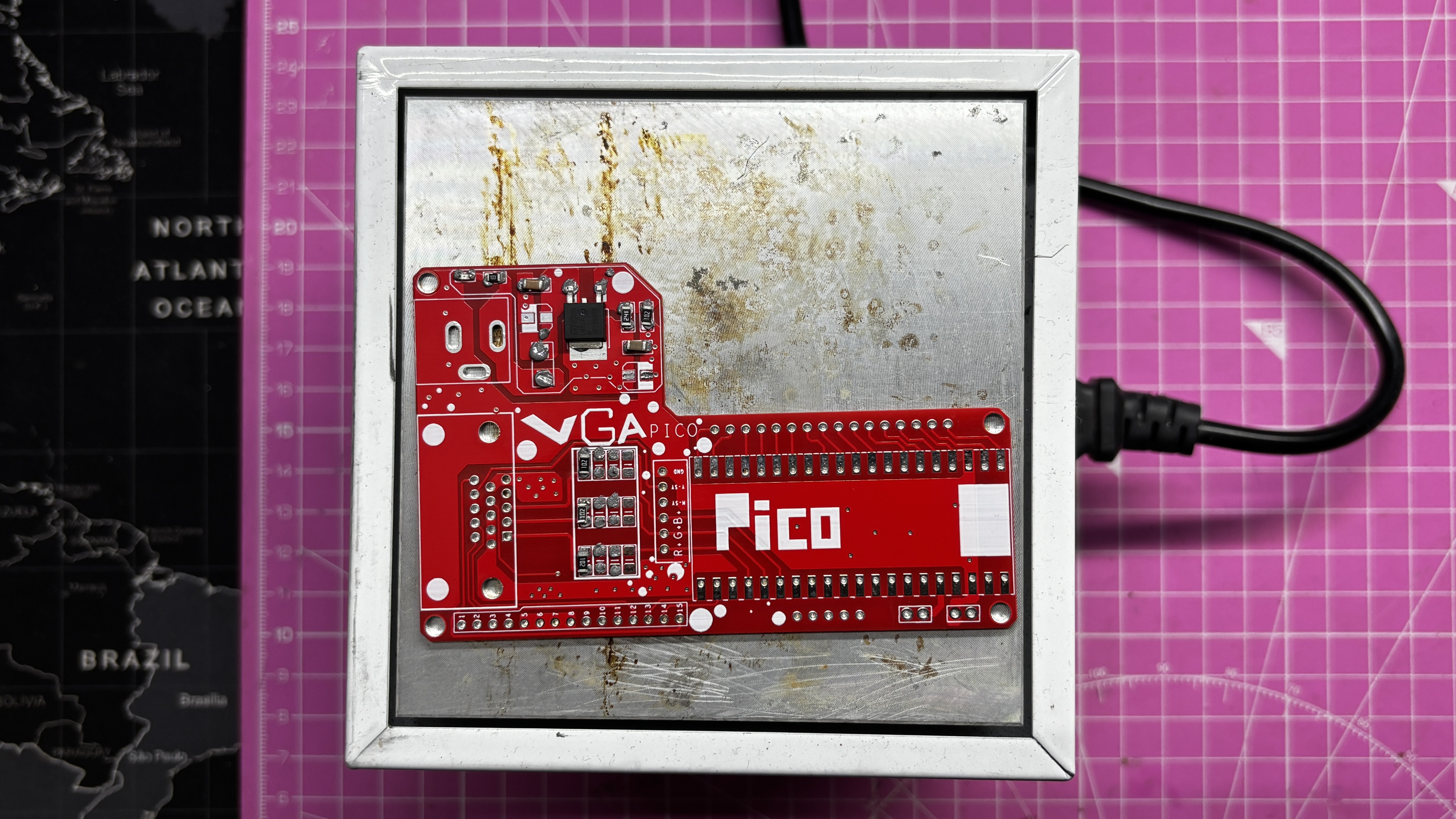

    PCB ASSEMBLY PROCESS

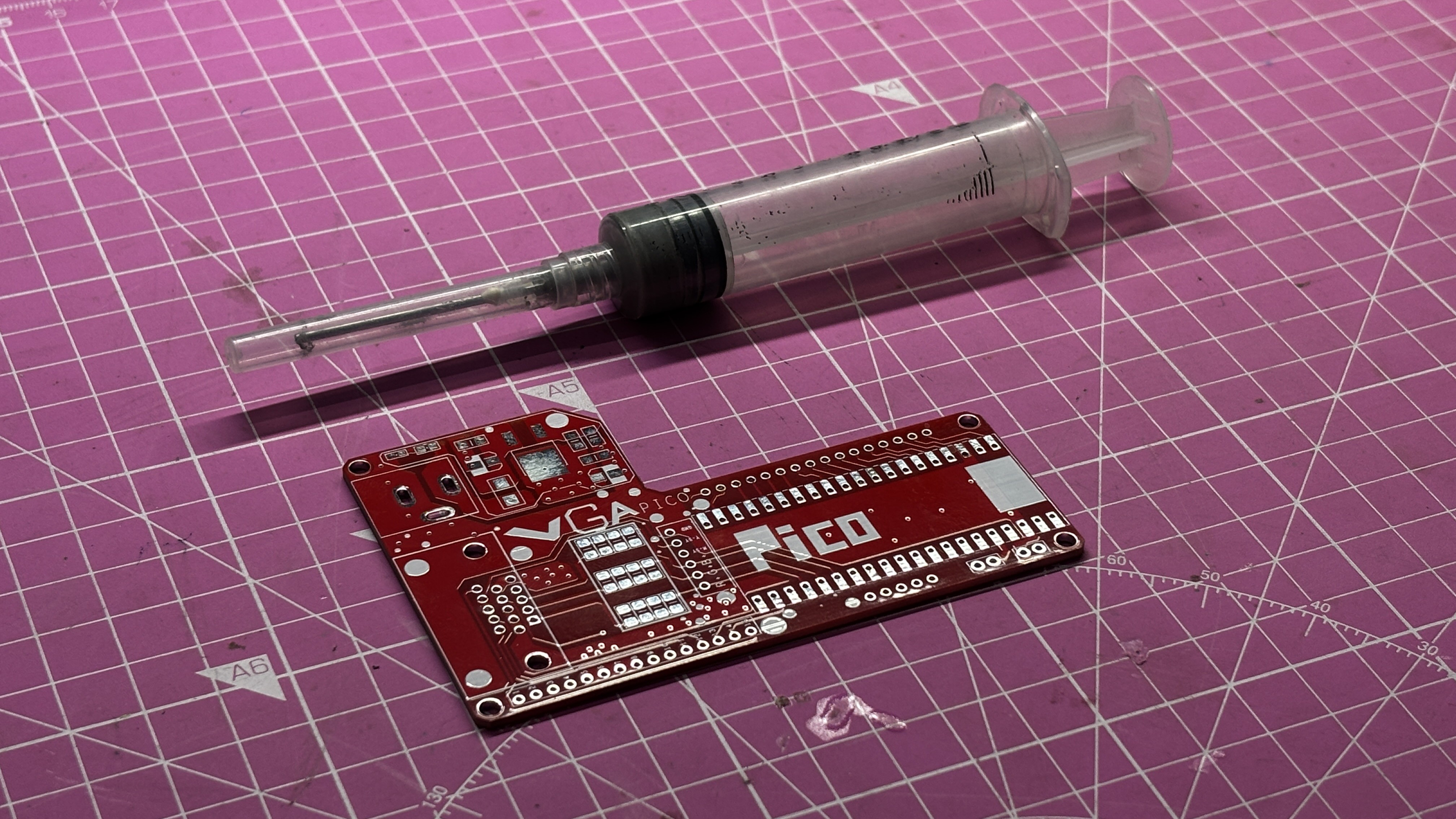

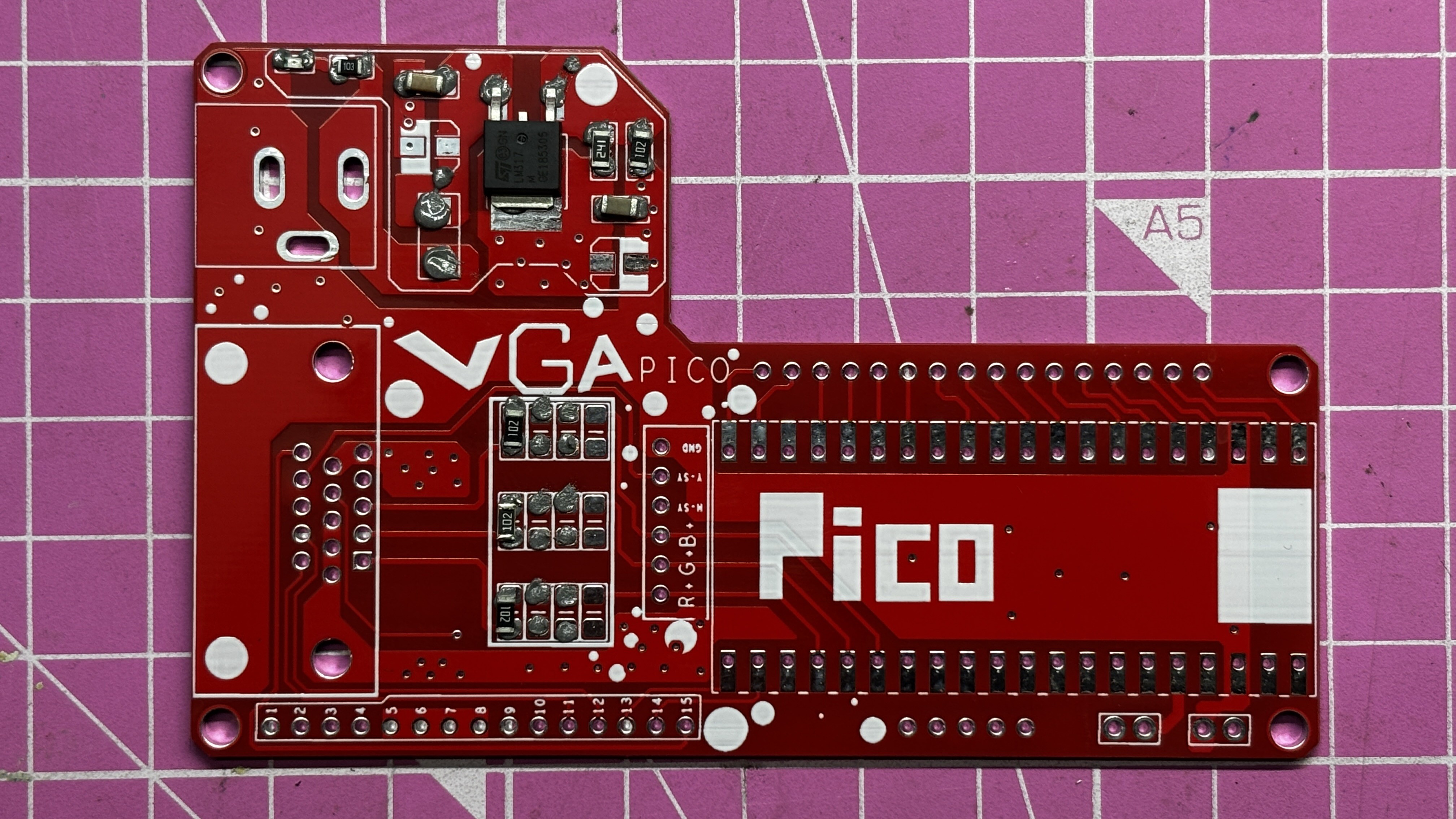

    • We begin the PCB assembly process by first adding solder paste to each component’s pads one by one using a solder paste dispensing needle. Here, we are using 63/37 SnPb solder paste.
    • We then pick and place each SMD component in its correct location.
    • The PCB is then placed on a reflow hotplate, which heats the PCB from below up to the solder paste melting temperature. As soon as the PCB reaches that temperature, the solder paste melts, and all components are secured in their positions.

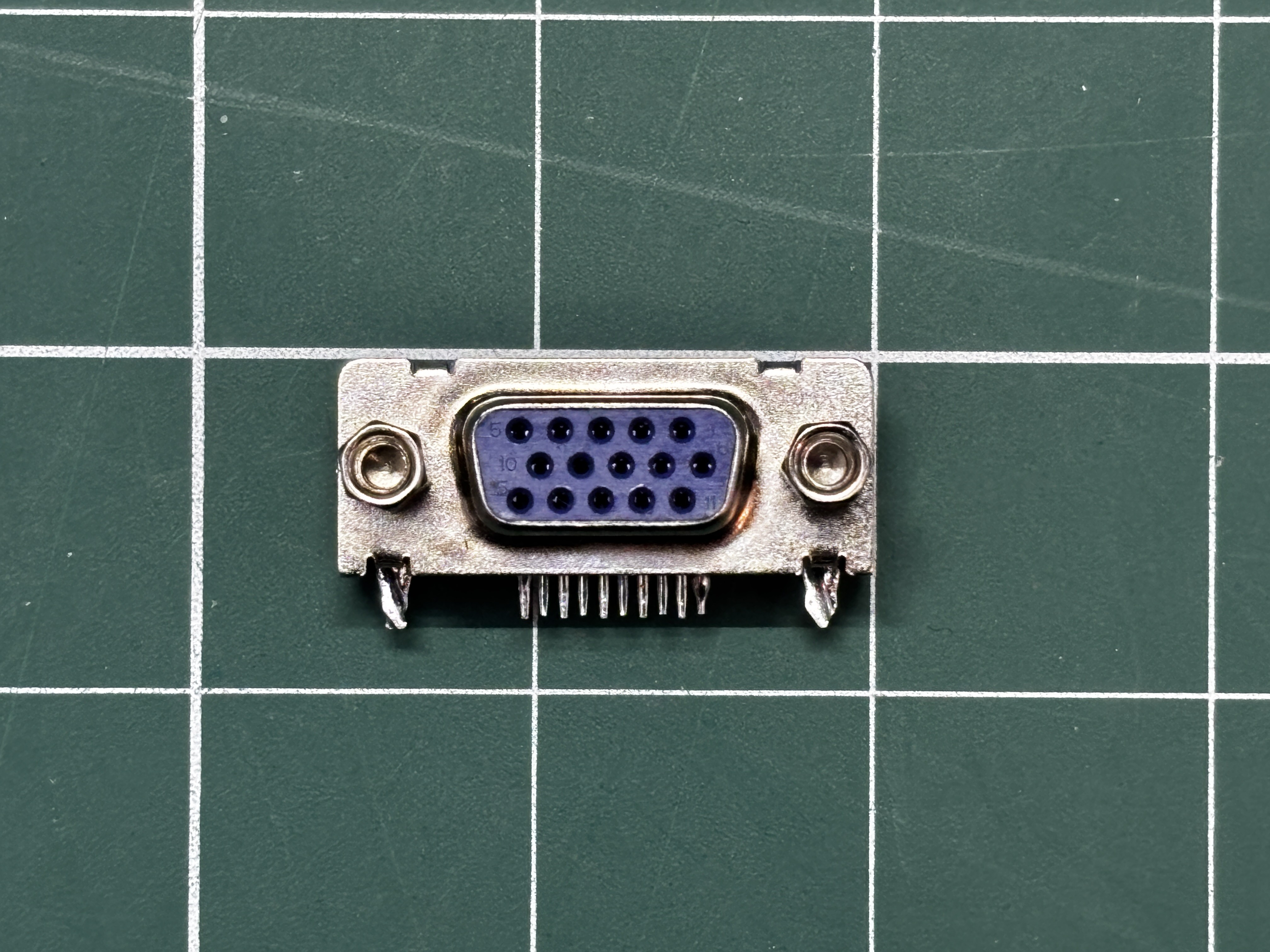

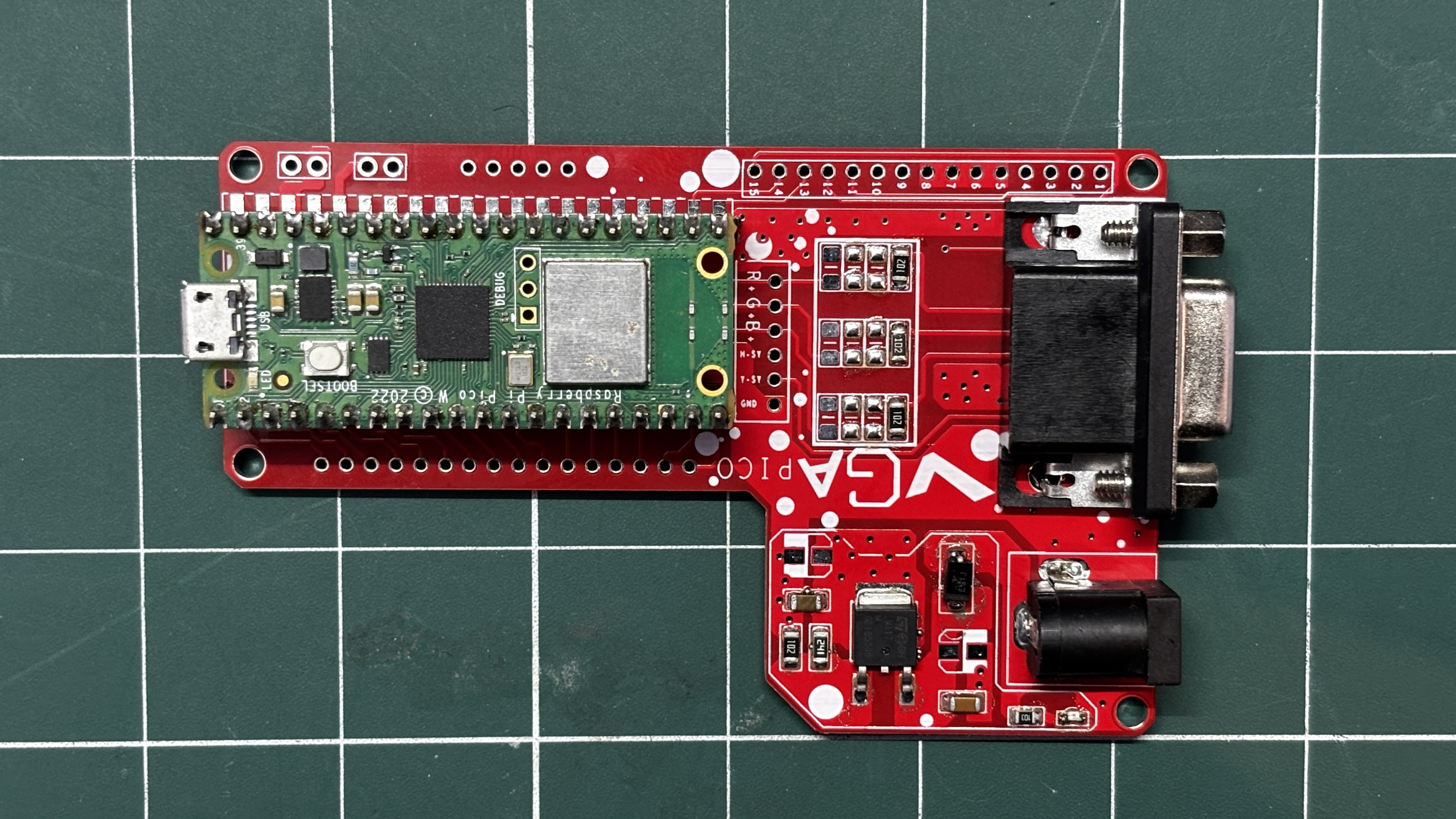

    • For the through-hole assembly process, we added the D-Sub 15 connector in its position, followed by the barrel DC jack and two CON20 female header pins in place of the Pico. By turning the board over and using a soldering iron, we solder all the through-hole component leads, securing everything in position.
    • At last, we place the Pico W in its position over the female header pins. This completes the assembly process of the driver board.
  • 2

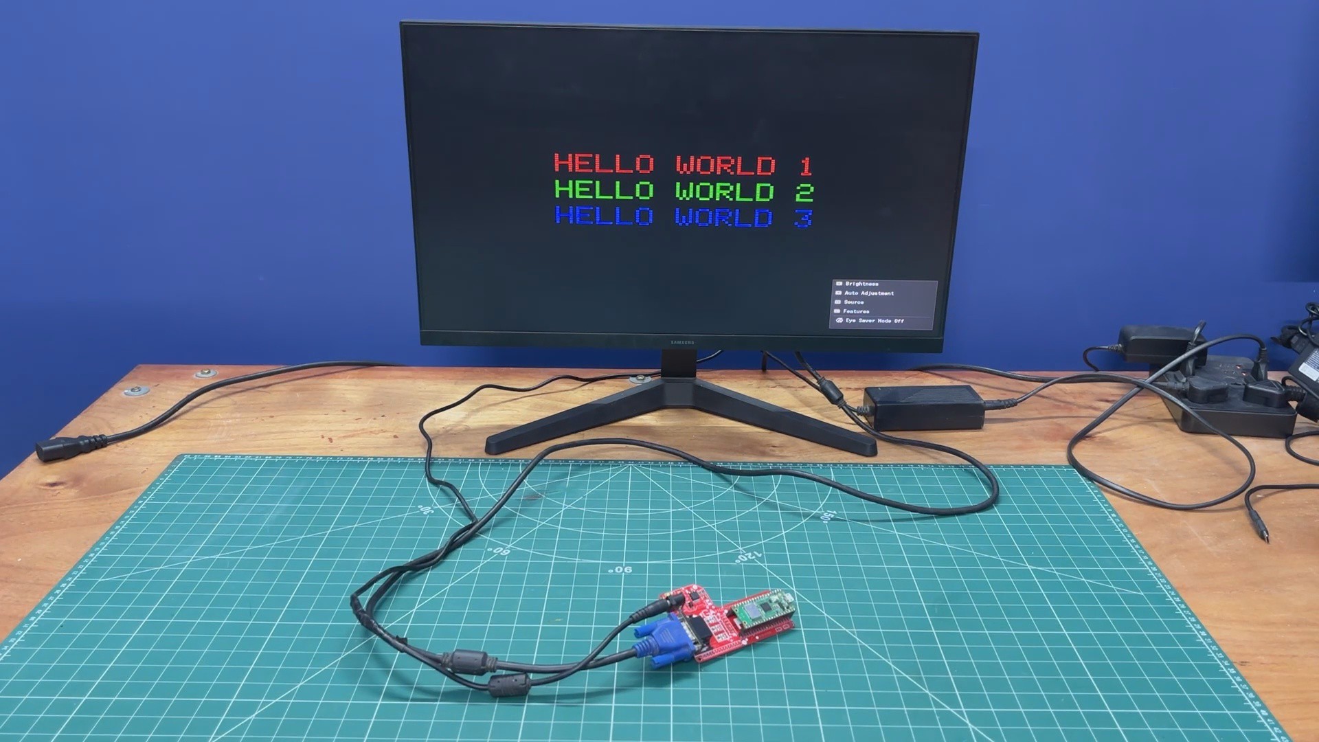

    GETTING VGA PICO BOARD READY
    Before getting started with the code, we connect our Pico VGA Board to a 24-inch monitor using a VGA cable. We plug the VGA cable from the monitor into the VGA port of our circuit, and then connect the power adapter via the DC barrel jack connector.
  • 3
    DEMO 1- Hello World
    We begin the demo of our setup by flashing PICO W with a Hello World code first.
    This was a simple print statement like skeytch that prints hello world in three different colours, R, G, and B.
