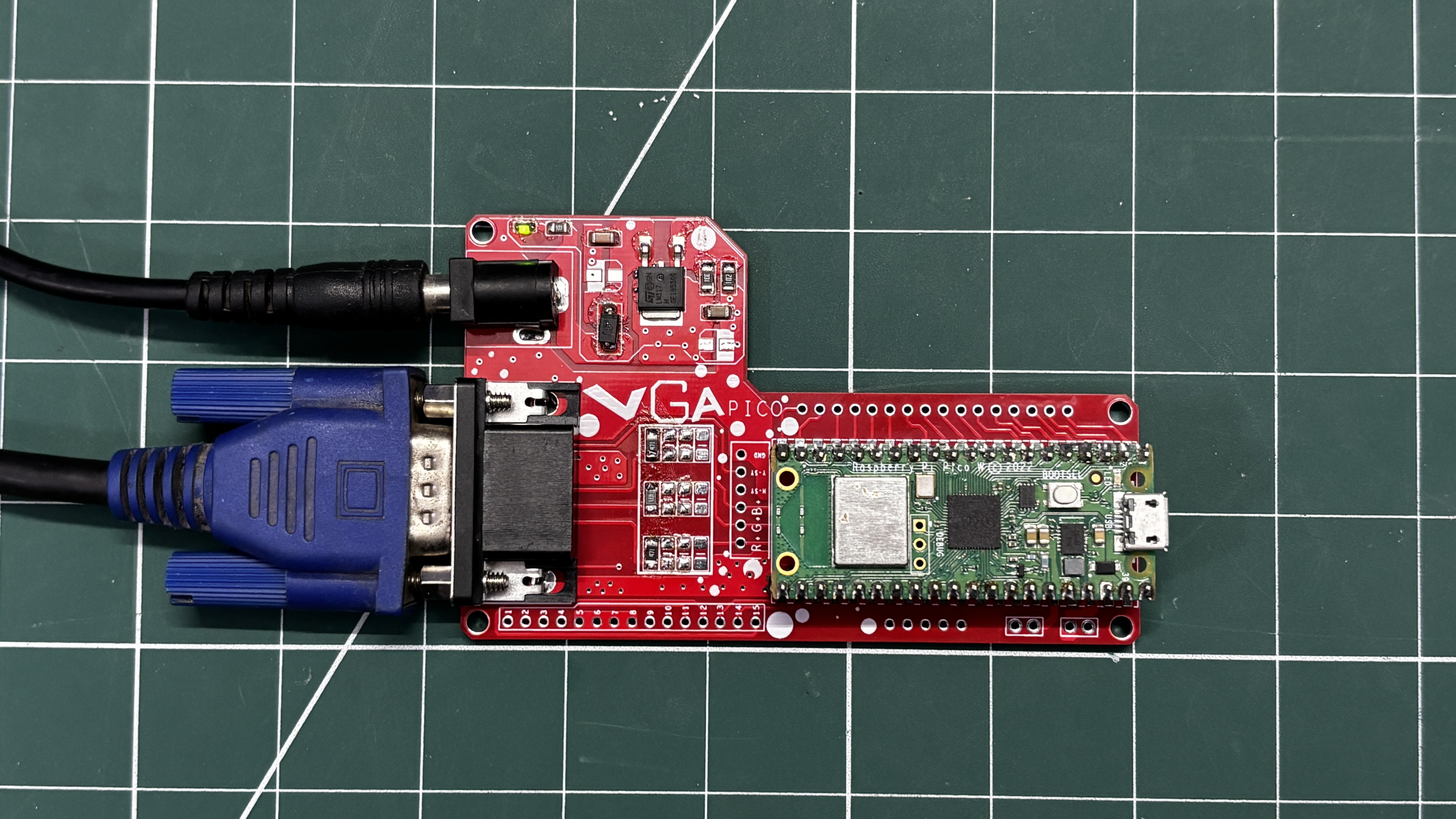

1PCB ASSEMBLY PROCESS
- We begin the PCB assembly process by first adding solder paste to each component’s pads one by one using a solder paste dispensing needle. Here, we are using 63/37 SnPb solder paste.
- We then pick and place each SMD component in its correct location.
- The PCB is then placed on a reflow hotplate, which heats the PCB from below up to the solder paste melting temperature. As soon as the PCB reaches that temperature, the solder paste melts, and all components are secured in their positions.
- For the through-hole assembly process, we added the D-Sub 15 connector in its position, followed by the barrel DC jack and two CON20 female header pins in place of the Pico. By turning the board over and using a soldering iron, we solder all the through-hole component leads, securing everything in position.
- At last, we place the Pico W in its position over the female header pins. This completes the assembly process of the driver board.
2GETTING VGA PICO BOARD READY
Before getting started with the code, we connect our Pico VGA Board to a 24-inch monitor using a VGA cable. We plug the VGA cable from the monitor into the VGA port of our circuit, and then connect the power adapter via the DC barrel jack connector.

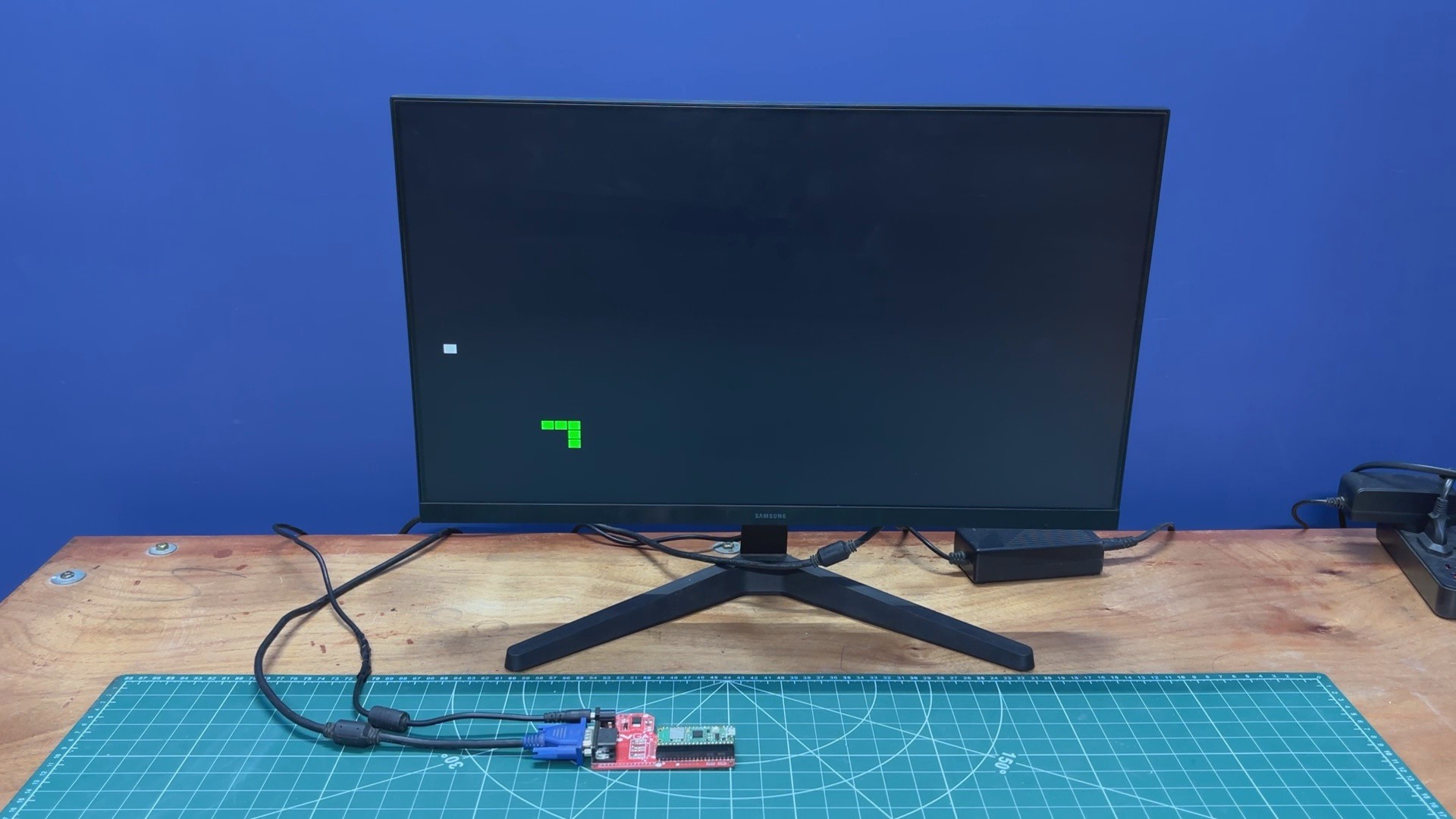

4DEMO 2- Snake Game
We then prepared a snake game sketch for this setup. The snake game code was taken from one of my previously created snake game console projects, in which we are able to control the movement of the snake.
For this VGA demo, we made the snake move randomly, but button controls can be added, and perhaps we can prepare a Snake Game Console XL project with this setup, but that’s a bit off topic.
Here’s the code breakdown.
#include "vga_graphics.h" /* ── Screen ───────────────── */ #define SW 640 #define SH 480 /* ── Grid ───────────────── */ #define CELL 12 #define GRID_W (SW / CELL) #define GRID_H (SH / CELL) /* ── Snake ─────────────── */ struct Segment { int x; int y; }; Segment snake[200]; int snakeLength = 5; int dx = 1, dy = 0; int foodX, foodY; int prevTailX, prevTailY; /* ── Random food ───────── */ void placeFood() { foodX = random(2, GRID_W - 2); foodY = random(2, GRID_H - 2); } /* ── Reset ─────────────── */ void resetGame() { clearScreen(); snakeLength = 5; dx = 1; dy = 0; for (int i = 0; i < snakeLength; i++) { snake[i].x = GRID_W / 2 - i; snake[i].y = GRID_H / 2; } placeFood(); } /* ── Random movement ───── */ void randomMove() { if (random(0, 10) < 3) { // 30% chance int dir = random(0, 4); if (dir == 0 && dy == 0) { dx = 0; dy = -1; } // up if (dir == 1 && dy == 0) { dx = 0; dy = 1; } // down if (dir == 2 && dx == 0) { dx = -1; dy = 0; } // left if (dir == 3 && dx == 0) { dx = 1; dy = 0; } // right } } /* ── Collision ─────────── */ bool selfCollision() { for (int i = 1; i < snakeLength; i++) { if (snake[0].x == snake[i].x && snake[0].y == snake[i].y) { return true; } } return false; } /* ── Draw one cell ─────── */ void drawCell(int gx, int gy, char color) { fillRect(gx * CELL, gy * CELL, CELL - 1, CELL - 1, color); } /* ── Setup ─────────────── */ void setup() { initVGA(); clearScreen(); randomSeed(analogRead(26)); // Pico randomness resetGame(); } /* ── Loop ─────────────── */ void loop() { // random AI movement randomMove(); // store tail prevTailX = snake[snakeLength - 1].x; prevTailY = snake[snakeLength - 1].y; // move body for (int i = snakeLength - 1; i > 0; i--) { snake[i] = snake[i - 1]; } // move head snake[0].x += dx; snake[0].y += dy; // wrap screen if (snake[0].x >= GRID_W) snake[0].x = 0; if (snake[0].x < 0) snake[0].x = GRID_W - 1; if (snake[0].y >= GRID_H) snake[0].y = 0; if (snake[0].y < 0) snake[0].y = GRID_H - 1; // self collision if (selfCollision()) { delay(500); resetGame(); return; } // food if (snake[0].x == foodX && snake[0].y == foodY) { snakeLength++; placeFood(); } // erase tail drawCell(prevTailX, prevTailY, BLACK); // draw snake for (int i = 0; i < snakeLength; i++) { drawCell(snake[i].x, snake[i].y, GREEN); } // draw food drawCell(foodX, foodY, WHITE); delay(120); }We first define the screen and grid setup.
#define SW 640#define SH 480
We also define VGA Resolution, where each cell consists of 12x12 pixels, and each grid becomes 53 columns x 40 rows.
#define CELL 12#define GRID_W (SW / CELL)#define GRID_H (SH / CELL)
Here is the structure of a snake.
struct Segment { int x; int y;};Each snake segment stores its position.
Segment snake[200];int snakeLength = 5;
Snake can grow up to 200 segments and start with a length of 5.
This is the Movement variables.
int dx = 1, dy = 0;
This places food randomly with safe grid bounds, also avoiding edges slightly.
void placeFood()
This is the Reset Game function that clears the screen, resets the snake's length and direction, places the snake at the center, and spawns new food.
void resetGame()
This is the Random Movement function, which has like 30% chance to change direction, and the setup prevents reversing direction.
void randomMove()if (random(0, 10) < 3)
Food is drawn by the following section.
We control the speed of snake using delay(120);

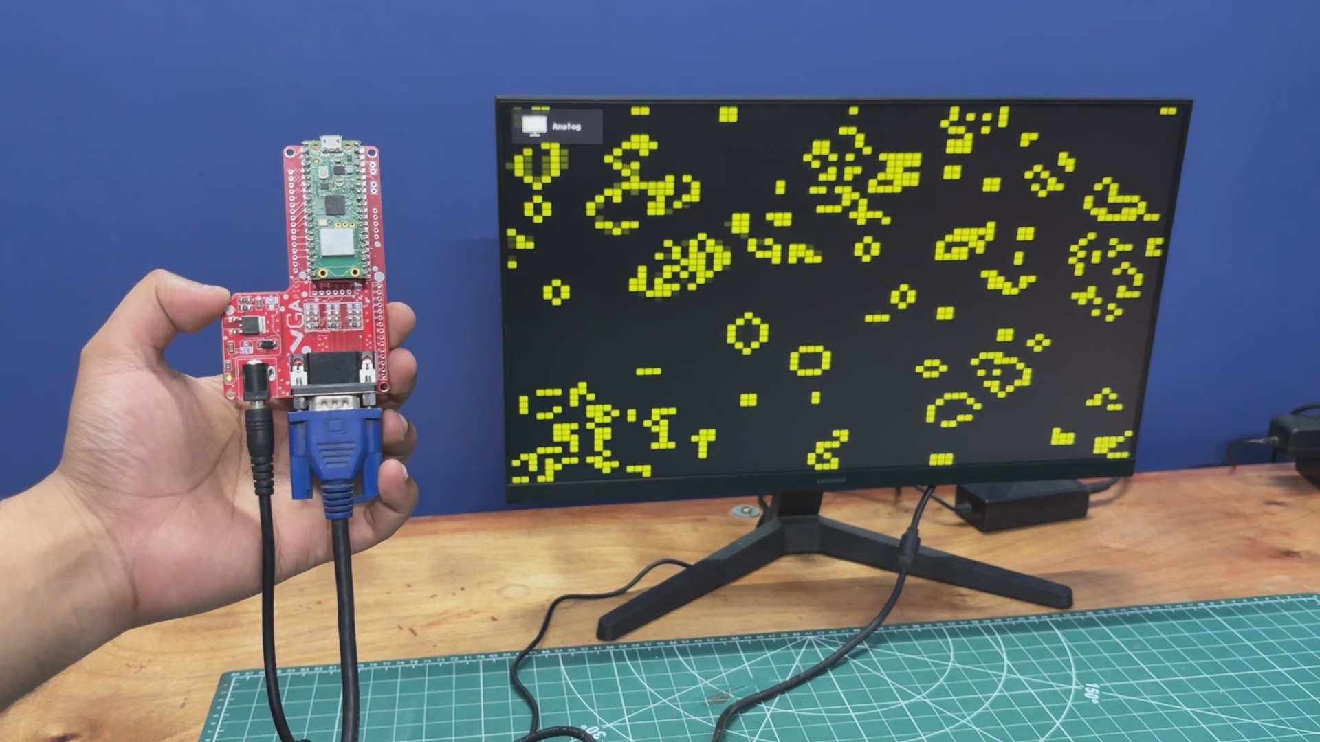

5DEMO 3- Conway's Game of Life
Next is the Game of Life sketch, and here's a little code breakdown.
#include "vga_graphics.h" /* ── Screen ───────────────── */ #define SW 640 #define SH 480 /* ── Grid ───────────────── */ #define CELL 8 #define GRID_W (SW / CELL) #define GRID_H (SH / CELL) /* ── Buffers ───────────── */ bool grid[GRID_W][GRID_H]; bool nextGrid[GRID_W][GRID_H]; /* ── Draw cell ─────────── */ void drawCell(int x, int y, bool alive) { fillRect( x * CELL, y * CELL, CELL - 1, CELL - 1, alive ? YELLOW : BLACK ); } /* ── Random init ───────── */ void randomizeGrid() { for (int x = 0; x < GRID_W; x++) { for (int y = 0; y < GRID_H; y++) { grid[x][y] = random(0, 2); drawCell(x, y, grid[x][y]); } } } /* ── Count neighbors ───── */ int countNeighbors(int x, int y) { int count = 0; for (int dx = -1; dx <= 1; dx++) { for (int dy = -1; dy <= 1; dy++) { if (dx == 0 && dy == 0) continue; int nx = x + dx; int ny = y + dy; // wrap around edges if (nx < 0) nx = GRID_W - 1; if (nx >= GRID_W) nx = 0; if (ny < 0) ny = GRID_H - 1; if (ny >= GRID_H) ny = 0; if (grid[nx][ny]) count++; } } return count; } /* ── Update simulation ─── */ void updateGrid() { for (int x = 0; x < GRID_W; x++) { for (int y = 0; y < GRID_H; y++) { int neighbors = countNeighbors(x, y); if (grid[x][y]) { // alive nextGrid[x][y] = (neighbors == 2 || neighbors == 3); } else { // dead nextGrid[x][y] = (neighbors == 3); } } } // apply + redraw only changes for (int x = 0; x < GRID_W; x++) { for (int y = 0; y < GRID_H; y++) { if (grid[x][y] != nextGrid[x][y]) { drawCell(x, y, nextGrid[x][y]); } grid[x][y] = nextGrid[x][y]; } } } /* ── Setup ─────────────── */ void setup() { initVGA(); clearScreen(); randomSeed(analogRead(26)); // Pico randomness randomizeGrid(); } /* ── Loop ─────────────── */ void loop() { updateGrid(); delay(80); // speed control }Code begins by defining the screen resolution, which is the following.
We next define the grid size for cells. Each cell is 8x8 Pixels, the grid becomes 640/8 = 80 columns and 480/8 = 60 rows.
#define CELL 8#define GRID_W (SW / CELL)#define GRID_H (SH / CELL)
Below is the buffer or core of our simulation. This prevents overwriting data while calculating.
bool grid[GRID_W][GRID_H];bool nextGrid[GRID_W][GRID_H];
Next up is drawing a cell logic. This first converts the grid position into screen pixels.
Using this, a square is drawn.
x * CELL, y * CELL
This is a random function that fills the grid randomly when the code starts.
This is the core logic of the game of life, which is counting neighbours. It checks all 8 surrounding cells.
Game Rules are set with the following.
Alive Cell survives if there are 2 or 3 neighbours. Dead cells become alive if there are exactly 3 neighbours.
if (grid[x][y]) { nextGrid[x][y] = (neighbors == 2 || neighbors == 3);} else { nextGrid[x][y] = (neighbors == 3);}Using the section below, we only redraw the cells that are changed instead of a full-screen redraw.
if (grid[x][y] != nextGrid[x][y]) { drawCell(x, y, nextGrid[x][y]);}This is the copy state that moves next from the current frame.
In the setup, VGA is initialized, randomness is added, and the simulation starts.
initVGA();clearScreen();randomSeed(analogRead(26));randomizeGrid();
In the loop, the simulation is updated continuously, and its speed is controlled. Lower delay means fast evolution, and higher delay results in a slower, easier-to-see evolution.
updateGrid();delay(80);
